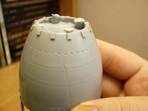

captain america Posted August 31, 2004 Posted August 31, 2004 This pic makes the part look fairly rough, but in reality, there are only a couple small bubbles to fill at the top. Quote

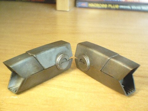

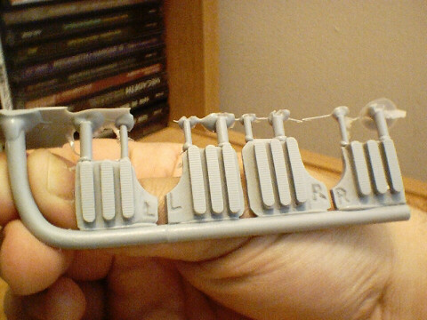

captain america Posted August 31, 2004 Posted August 31, 2004 Airflow grills. Perfect castings, and molded separately for easy painting. Quote

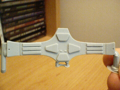

captain america Posted August 31, 2004 Posted August 31, 2004 The rear bulkhead. Again, no problems Quote

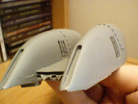

captain america Posted August 31, 2004 Posted August 31, 2004 Upper fuselage. The flash in the pic looks worse than it really is; you can strip it right off with a sharp knife. The airflow grill holes were casting-up a little bit rougher than I care for, so before I sent the masters to Jesse for casting, I re-worked the part slightly to eliminate that problem. Quote

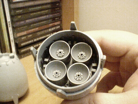

captain america Posted August 31, 2004 Posted August 31, 2004 Same part, rear view. Excellent casting Quote

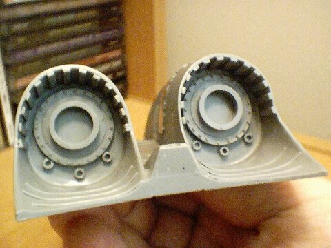

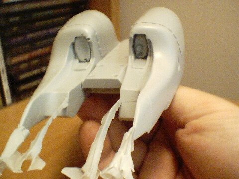

captain america Posted August 31, 2004 Posted August 31, 2004 Lower fuselage, foreward view. This is about the only part I was a bit disappointed with. As you can see in the pic, the foot holes have extra resin in them. Though these can easily be ground-out and sanded, I also took some steps to correct this in the molding process on Jesse's end; basically re-positioning the part to better release entrapped air in the mold material. The part is a bit more complex to mold than it appears, as it has detailed indentations fore and aft. However, this should be remedied in the actual production parts. Quote

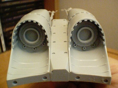

captain america Posted August 31, 2004 Posted August 31, 2004 Last pic. Lower fuselage, rear view. Very nice detail capture. Quote

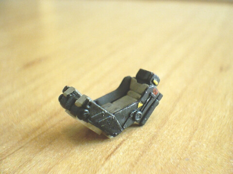

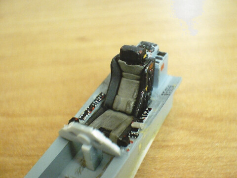

captain america Posted September 1, 2004 Posted September 1, 2004 Hi guys, update time again. Basically, this will be a catalogue of highlights involving the actual Valk/Booster model grand prize build-up. WM cheng already did a fabulous step-by-step article on the VF-1, so I won't bore you with the same ol' "glue part A to B, and putty". Rather, I'll just hit the highlights. Pic one is of the ejection seat. Painted up in a more real-world military scheme of black frame & olive cushion. The cushion was made to look worn with some black/brown chalk pastel, and the frame recieved a few little nicks of silver to simulate chipped paint. I also added a few hand-painted warning symbols. Quote

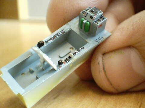

captain america Posted September 1, 2004 Posted September 1, 2004 Pic 2: cockpit tub. More or less stock, but after painting it initially, I was left rather flat by the bare side consoles, so I pulled out my Perfect Memory, and sure enough, there are supposed to be placards in there, so I just made some out of styrene and added a few little switches & buttons with paint. Quote

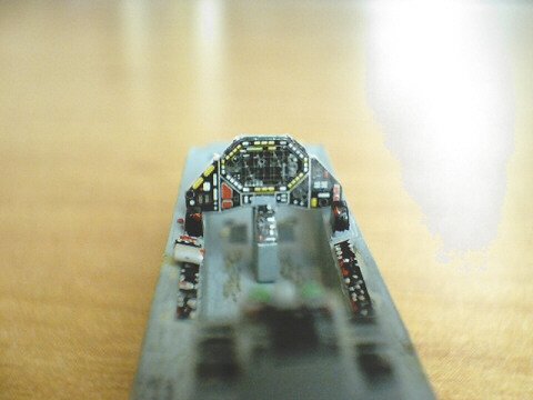

captain america Posted September 1, 2004 Posted September 1, 2004 The tub from the pilot's view. The cockpit displays are the kit decal, but in stead of using it as a whole piece, which didn't look right, I cut it out into placards and mounted them individually. I then coated them with some FUTURE floor wax to make them shiny... Essentially a "glass" cockpit. Also, the tub was initially painted in Zinc Chromate yellow-green, and then overcoated with grey. I then scraped off a bit of the gray in the footwells & on the corners of the consoles to make the tub look like it's seen its fair share of action. Quote
captain america Posted September 1, 2004 Posted September 1, 2004 The assembled cockpit. Sadly, a lot of the nice detail will be obscured when it's all encased within the fuselage. Quote
