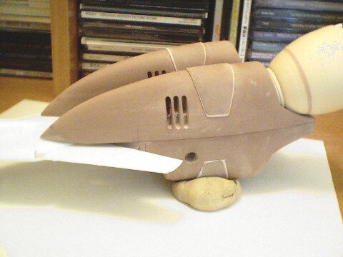

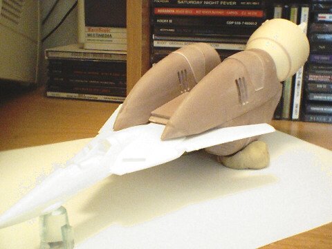

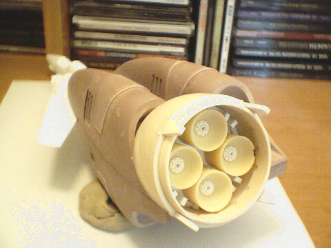

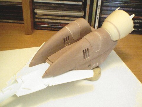

captain america Posted August 2, 2004 Posted August 2, 2004 Hi guys, I'm exhausted... Time for an update To answer Noyhauser's question, I really don't know, as I don't have a super O kit. It may very well fit with some veeeery minor modification to the center fuselage on the booster. The booster is designed to accept a VF-1 with its backpack deployed "atmospheric" mode and its V-tails flat. Anyway, onto the pics... As you can see, the once flat blocks of modelling board have now been fleshed-out into a more familiar form. My webcam's lens produces a tremendous fish-eye effect on objects that I shoot from a short distance, and as a result, makes the booster look much more slender than it really is; it's actually spot-on with the side-view Rob posted at the beginning of the thread. All the parts fit perfectly, and tolerances are being kept tight. As Valkyrie had noticed earlier on, the foreward, upper tips of the booster will need to be cut-back and enlarged... I left them longer for the time being, as I'll need to adjust that entire area to conform precisely to the Hasegawa kit's surface. In a nutshell, things are going exactly as planned. Quote
captain america Posted August 2, 2004 Posted August 2, 2004 (edited) 3 of 4. Edited August 2, 2004 by captain america Quote

robokochan Posted August 3, 2004 Author Posted August 3, 2004 Simply amazing! I am speechless. That Booster is a work of art! excellent work John! Rob Quote
Grayson72 Posted August 3, 2004 Posted August 3, 2004 Monkey-N said: Simply amazing! I am speechless. That Booster is a work of art! excellent work John!Rob You gotta be excited and relieved Rob, progress and pictures to prove it! Quote
Batou Posted August 3, 2004 Posted August 3, 2004 (edited) This looks just complely unbelievable so far, John. Outstanding. I'm only waiting for payday to make my contribution. Any idea as to how much this sucker is going to cost us when all is said and done? I love the idea of that launch vehicle, too, but I'm afraid it might make the price a little out of reach for some of us - from the pics I'm looking at in Perfect Memory, that addition would make this one BIG kit. I'm in either way. Edited August 3, 2004 by Batou Quote
captain america Posted August 3, 2004 Posted August 3, 2004 Hi Batou. Actually, Rob is the one handling the marketing aspect of the model, so would be the one to best answer your question regarding price. However, I can assure you that it'll be cheaper than a japanese kit of similar detail/size. As for the launch vehicle, we both decided that precisely for cost purposes, we would market them as separate kits; basically give people a chance to save-up for them. Quote
