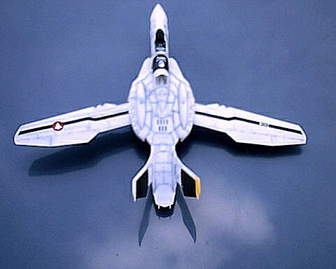

HWR MKII Posted August 16, 2004 Posted August 16, 2004 (edited) ill try first thing tomorrow when i get home from work. its 1130 pm here in the uk so it wont be until about 10 or 11 am eastern standard time until they get posted well here are some pics of my pastel technique im sorry if they are a little blurry im trying to get a handle of my new digicam Edited August 17, 2004 by HWR MKII Quote

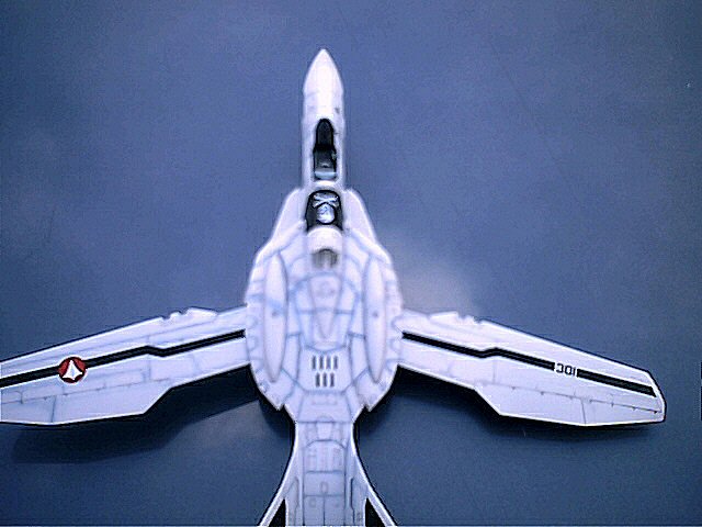

HWR MKII Posted August 17, 2004 Posted August 17, 2004 heres another pic i hope its a little sharper Quote

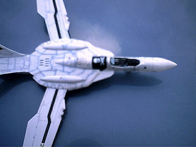

HWR MKII Posted August 17, 2004 Posted August 17, 2004 and a final one this cam is really irking me Quote
HWR MKII Posted August 17, 2004 Posted August 17, 2004 the last one was the best i could get i took 50+ shots all in all but it does show best the contrast in the finished and unfinished wings and alot of the panel lines are sharper. the pastels dont show as much on the actual model. give it a shot you might like the end result sean Quote
