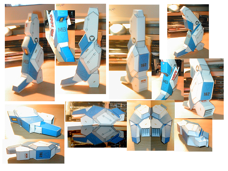

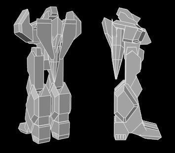

Here's some more colorfull joy! If you take a look at the photo you can't notice the gaps between the missile hatches... but in reality if you take a look at the whole leg it's not that bad at all. :) (landing gear is going to be added in the future... no space actually). This time the pics look a bit betterusing nightflash setting.
btw... those missiles are the easiest to make... ;)

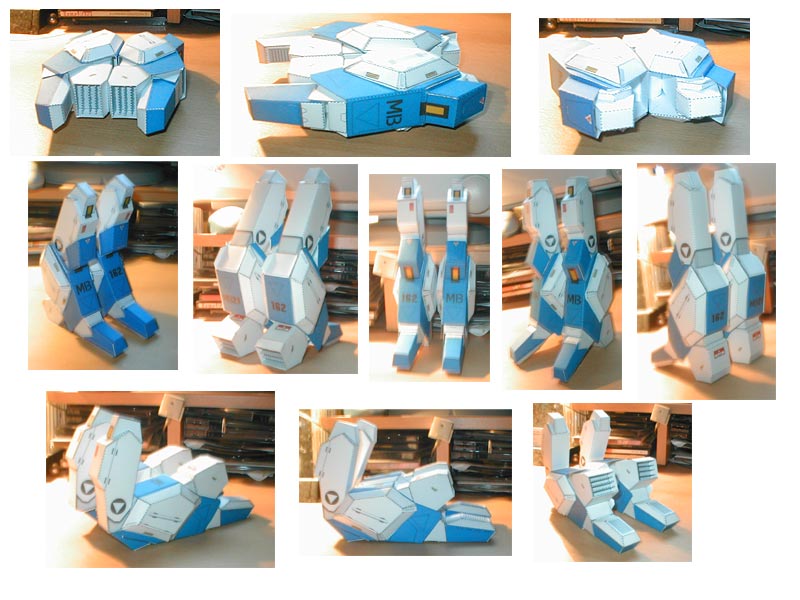

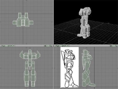

Sigh* finally I've finished building the legs and attaching system. I've made a duplicate of the folding system and scan it later on. :)
Next step is to model the bodypart. The test version proven to be too short so I've decided to add some lenght. (the collapsed legs in fightermode shown below is 16cm long)
The last one is for Florida... let's pray!
Edited by Kin

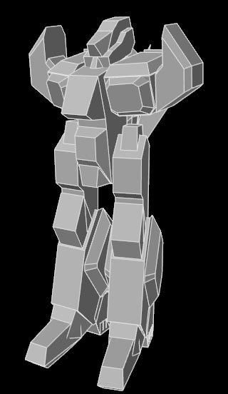

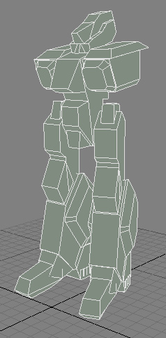

I'm busy sculpturing the body part in soldier mode. The size shouldn't be a problem in fightermode and the chestplate can retract inside so you get a flat bottom. Some parts need little scale corrections.
Edited by Kin

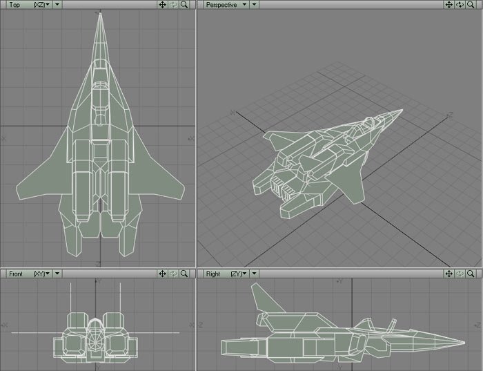

I'm currently working in two modes... fighter and soldier, using the same parts and scale/fit them to get the right proportions. The most difficult one is the canopy... in soldiermode it sticks out too long... but in fightermode I can't make it shorter than it is.
As for the rest there should be no problem at all. This time you can open the window on the canopy. Some parts are to be covered with transparent film.

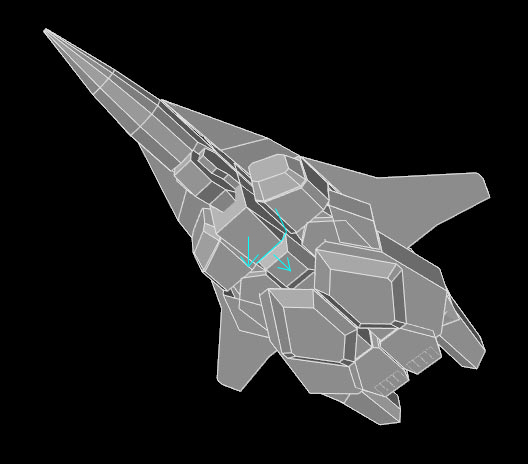

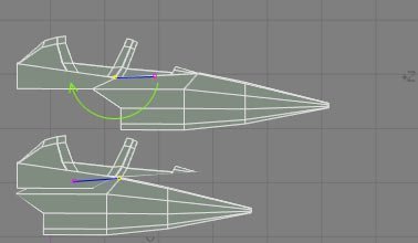

I got a nice solution to the "nosecone" problem, but it's gonna cost our interior but even increases the accuracy:
and ofcourse the technique, in fightermode this should be very solid since the head is tightly against the bodypart and pushing the canopy with upward pressure:

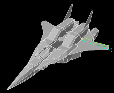

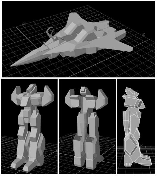

OK... I'm still busy scaling and fitting parts in 3D. I want the model to be as accurate like the anime as possible. In the anime the fighter looks very small... and it has small wings, in soldier mode it kinda looks bulky.
The intake/engine is shorten so the leg and kneecap can move more compact, therefore the bodypart can collaps. The wings are the same size as in the anime.
The wings are quite a problem. I've found a great sollution and it's something I actually hoped the original designers had done. In soldier mode the flaps of the wings fold 45 degrees inwards fitting between the bodypart and nosecone so making it shorter.
As for the nosecone itself... it is collapsable too.
