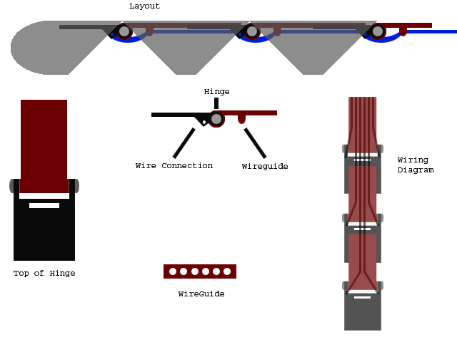

Darrtallion Posted April 19, 2008 Posted April 19, 2008 ok here is a quick sketch on a fingers part of the mechanism. Just for an Idea I will try to explain some parts of it as well. Now normally I would just fabricate something like this but I am not sure if you will be able too but its a diagram for it and might be of some help or ideas. Now in the picture I have a spot for adding a top piece that would straighten the fingers out on release of the button but I have not put it in. Something elastic and keep taunt would work. I will show more later when I start on the other part of the mechanics of the connection to a trigger system. Quote

Darrtallion Posted April 19, 2008 Posted April 19, 2008 yea that is was what I was thinking because to move the fingers the distance needed you have to pull the length of the cable. I was trying to design something that would have a short rotation requiring a short distance of cable movement. I believe the length I had to pull the cable when I measured last was about 2 to 3 cm but with yours I think you will have to pull half the length of the fingers. Not to seem critical cause you have a lot of talent just trying to explain the mechanics of things. And if you use a trigger system I am not sure how much distance you will be able to press the button. But I myself haven't finished the full mechanics of the thing. I know I can still shorten the length of the rotation needed by a little. Honestly my first Idea was to just make it work on a electrical setting using batteries and components from airplanes using servos but I figured that might be a little to expensive since I am unsure of your budget lol. Maybe we should do a fund raiser to help out the VF girl project hehehehe. But all needed components and ship them to you and have instructions on how to make it electrical lol. But I really hope that the simplicity works over the complexity. Either way you still have a great looking piece of work. It has inspired me to work on one as well for my Girl and even maybe my cousins. Time to put the old Crafts to work. Of course I think I might make it out of different materials I can carve foam but oddly enough I have hard time shaping it the way you do. I will also finish the design and see if I can layout how to make it. Not sure because its well its just one of those things I can see in my head I just have a hard time laying out lol. Quote
