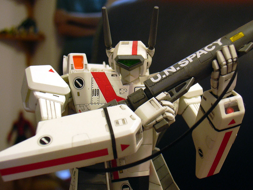

rarityraider Posted July 14, 2004 Posted July 14, 2004 Hi All, Here a VF-1J Battroid want to share I had made it long time ago... It is not a completed very well model since I've only spend a few days to finish. Maybe easy to find many defects of my works But its a very perfect model from Hasegawa Macross lines. Quote

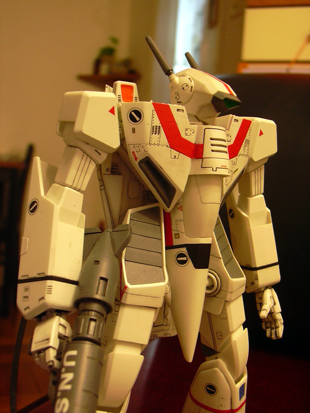

rarityraider Posted July 14, 2004 Author Posted July 14, 2004 (edited) Pic 2 Edited July 14, 2004 by rarityraider Quote
Neova Posted July 14, 2004 Posted July 14, 2004 Wow! You are very good! The two lights on the legs are off I think. One should be red and one blue. Otherwise, I think you've got some really freaking good skills. Also, since you also live in HK like I do, can I ask you how your paint setup is? Airbrush? Paint outside? Paint Booth? Spray Cans? Quote
ChristopherB Posted July 14, 2004 Posted July 14, 2004 Defects... Try as I might, I found none. You did a damn good job, thank you for sharing. Quote

Stamen0083 Posted July 14, 2004 Posted July 14, 2004 Seam on the front of the forearm, near the clear lens, and nasty mold lines on the hands. The clear blue lenses would have been interesting, if they were allowed to remain clear blue. Otherwise, not a bad job. Quote
jardann Posted July 14, 2004 Posted July 14, 2004 Thanks for the great pics of your model! This is a great job! You should be proud of this model. I don't think you need to be self-conscious about your work. We can all stand to improve our skills, and yours are already very good. I do see a couple of decals (on the arms) that look like they need to lay down better, and the landing lights on the legs may be wrong (picky). I like this model alot and the most important thing is that you have fun building it and looking at it now. You are having fun with your hobby aren't you?!? Keep up the good work and please post more examples of your work! Quote

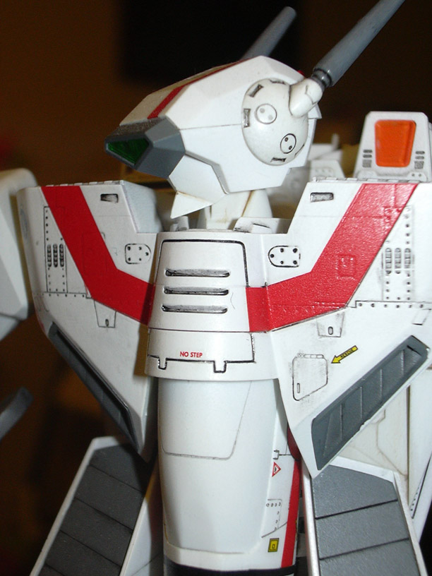

tetsujin Posted July 15, 2004 Posted July 15, 2004 Yeah, there are some issues but I think it looks nice. The most distracting to me is the red stripe on the chest - you can see where the decal sits on top of all the panel lines, and where there isn't a wash there... I think it's a good idea to mask and paint simple stripes like that when possible. And I saw the seam on the forearm that Stamen caught. But like I said, looks nice. Quote
rarityraider Posted July 16, 2004 Author Posted July 16, 2004 (edited) Yeah, there are some issues but I think it looks nice. The most distracting to me is the red stripe on the chest - you can see where the decal sits on top of all the panel lines, and where there isn't a wash there... I think it's a good idea to mask and paint simple stripes like that when possible. And I saw the seam on the forearm that Stamen caught. But like I said, looks nice. Yes, that is all the defects I said and you and Stamen found out I used to do washing on the red stripe on the chest but it's not work very well. Since that part were given in red color and I spray white on it and then stamp the decal on the top, so that the surface with panel lines became very thick to do washing even though I put mask softer after. Edited July 16, 2004 by rarityraider Quote
Stamen0083 Posted July 16, 2004 Posted July 16, 2004 Heh, forgot to catch the solid laser cannons :-P How did you say you sprayed the white? Airbrush? If you can find them, you should invest in some Hasegawa scriber saws. You can use them to deepen the panel lines so they won't disappear after a few coats of paint. Quote
