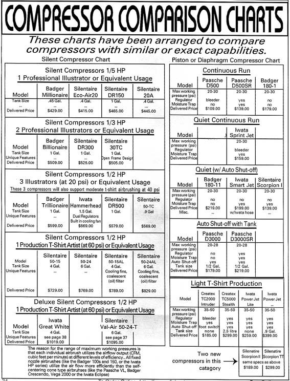

Neova Posted June 27, 2004 Posted June 27, 2004 Master Cheng, I was looking at compressors myself at dixieart and was looking at the silentair scorpion 1. Is this the one you had purchased? Is 20 PSI enough? At 139 it seems like a deal. Quote
ScrubbyMonkey Posted June 28, 2004 Posted June 28, 2004 (edited) Air source is a big point with me...does anybody know of a good, relatively quiet airsource that isn't too expensive. Other members of the family might not be too happy to hear a loud compressor going at 2am (when i do most of my work). I've thought about rigging a CO2 tank for airbrushing, has anybody tried this? Or does anybody have any more suggestions? Edited June 28, 2004 by ScrubbyMonkey Quote
tetsujin Posted June 28, 2004 Posted June 28, 2004 PS--I did find the Campbell-Hausfield compressor at Wal-Mart today. Only $68. Wonder if it's the right one, most people report them more expensive than that. 100PSI max, 2 gallon tank, and regulator. Add water trap and it's ready to go. Maybe it's not the "quiet" one, though from what I hear "quiet" means like 90 decibels. I think my CH said something about being "quiet" on the packaging - that's probably relative to compressors made for power tools and the like. Tough to say. Otherwise it sounds comparable to mine. Maybe ask the folks in Wal-Mart if you can turn it on in the store - that's what I did. Quote
