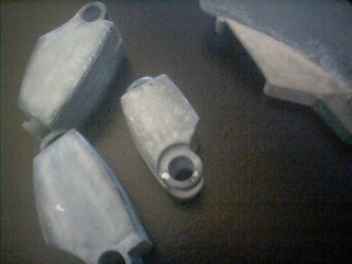

SpacePirateNeko Posted June 11, 2004 Author Share Posted June 11, 2004 and heres the pieces that have been airbushed already ---pre primed with shadow grey Quote Link to comment Share on other sites More sharing options...
