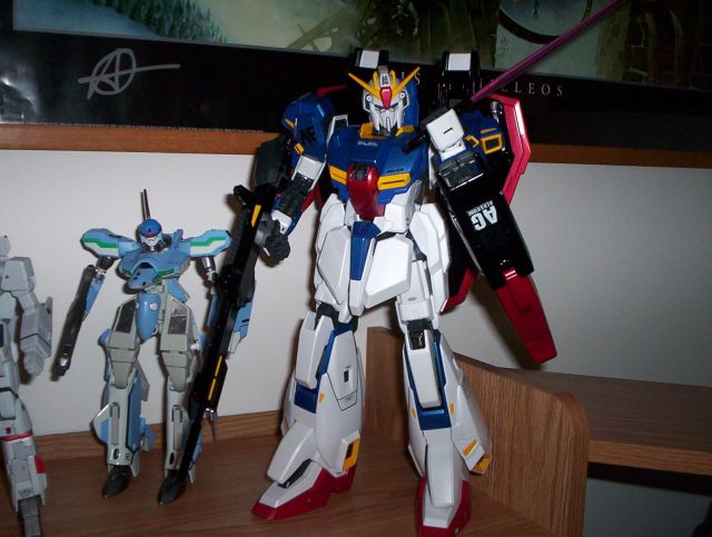

Anubis Posted June 15, 2004 Posted June 15, 2004 (edited) For my PG Zeta Gundam, I used Tamiya Spray Paint cans to paint the parts runners. As an inexperienced painter, this was the easiest solutution I could think of. Then be careful with good sprue cutters to remove the parts, and if the sprue point leaves an unpleasant mark on the finished limb, you can use some touch up paint to cover the spot if you desire. I didn't have to on mine thankfully. For the obvious black lines on the mobile suit I used a Gundam Marker. Use the smallest tip one of course. Wipe off any excess with a very-slightly-damp-at-the-tip paper towel. Do try to be careful to get the line right the first time though if possible. As a rule for me, if I paint in metallic anyway, I don't use many panel lines, only the areas that really need it on the white parts, like I did there. The gundam marker doesn't show up real well against the metallic paint anyway, so I consider it kind of a waste to panel line dark blue or red. Viola, your PG will look like this: I like how the Tamiya cans spray much better than the Testors cans did. The colors look very good as well, just make sure you paint all the parts evenly and get all sides. May take a few coats to do it. I don't know if this was the more expensive way to do it or not, but for now it worked, and I too don't have an airbrush. I spent a fair amount on the cans though, at 5 bucks a pop almost. I used 1 Metallic Red, 1 Metallic Blue, 2 Black, 2 Pearl White, and part of 1 Yellow can to make the model. The internal components I didn't bother to paint. They look good as they are, and I won't display it with panels open anyway. Before I touched my PG Zeta I used the same process to make my failed HG Freedom (damn all blue wings, and I didn't thin the black before I hand painted that), and then sucessfully sprayed my HG Providence, HGUC Char's Zaku, and SDF-1's. If your not used to painting or lining, I suggest picking up an expendable HGUC kit or two and trying that first. Edited June 15, 2004 by Anubis Quote
