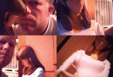

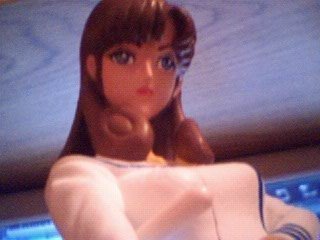

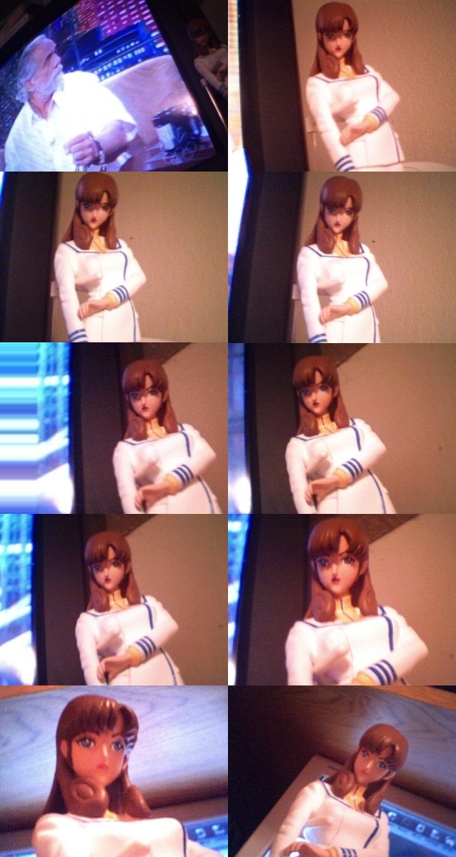

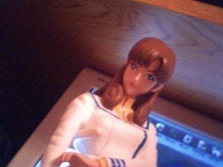

geecie30 Posted July 17, 2004 Author Posted July 17, 2004 (edited) And finally after all the advice I have completed my first figure model kit in pvc I think it's taken a couple months now.I think if I had better tools, I could have done better.If I did this again it would be considerably easier.Honestly,unless I had a model buddy that lived near by I would not do this kit without the guidance of a more practiced and polished model maker ,never-the-less she is complete, apart from the clear coat that I will put on tommorro after the fog clears in my area. Edited July 17, 2004 by geecie30 Quote
valkyrietestpilot Posted July 20, 2004 Posted July 20, 2004 wow dude.misa looks great.i had the same problem w/ pvc's a few years ago.damn enamel turns the upper layer of plastic to goo,thereby ruining your figure as well as your paint job. Quote
geecie30 Posted July 20, 2004 Author Posted July 20, 2004 (edited) Yeah I was lucky I stripped down the paint with oven cleaner and reprimed it and I painted the whole thing with acrlylic. A little secret ,even though I painted her dress with acrylic I shouldn't have. While acrylic works great(I used wicker white acrylic),the krylon white primer is the ultimate color and it is very tough,I recomend only using krylon white for the dress it is the right color and it will save you alot of painting time(one lesson learned) As I said before, this was my first model ever but I'm a perfectionist kind of ,and a bit artsy ,some times tenacious this is why I kept going when I really wanted to scrap the whole idea and maybe even turn on the garbage disposalIts misa however I owe her alot more. I think I hate enamel(solvent based) paint,the stuff never drys on almost anything to me its like using pigment mixed with pancake syrup.Yes it is paint and yes it is color.yes it is sticky and never drys........................................need I say more. It finally turned out ok and now I can work with pvc a bit more confidently Edited July 21, 2004 by geecie30 Quote
