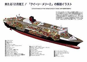

KingNor Posted May 24, 2004 Posted May 24, 2004 anyone seen the Queen Mary 2? its got a thing called... well i don't know what its called, but it looks alot like the "thumbs" on the SDF Macross. what it does is make a false wave infront of the ship and allows it to "slip" through the water as opposed to "cut" very neat to see it in action as the water just glides up the hull and back down with almost no "wave" effect. very cool, anyway. thought it looked like something MWers would be intrested in. this is the BEST pic i could get of the thing, they recently ran a documentary about the ship on history/science channel or something. look for it. Quote

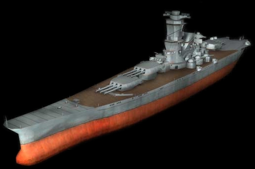

ewilen Posted May 24, 2004 Posted May 24, 2004 The Yamato had something similar, as illustrated in this model. The Iowas and some other battleships also have a somewhat bulbous bow. These links explain what the design is supposed to accomplish: http://www.warships1.com/index_tech/tech-004.htm http://www.chuckhawks.com/post_treaty_battleships2.htm And still more here: http://members.shaw.ca/diesel-duck/library...ulbous_bows.htm You can do a search on "bulbous bow" for many more links. Quote
