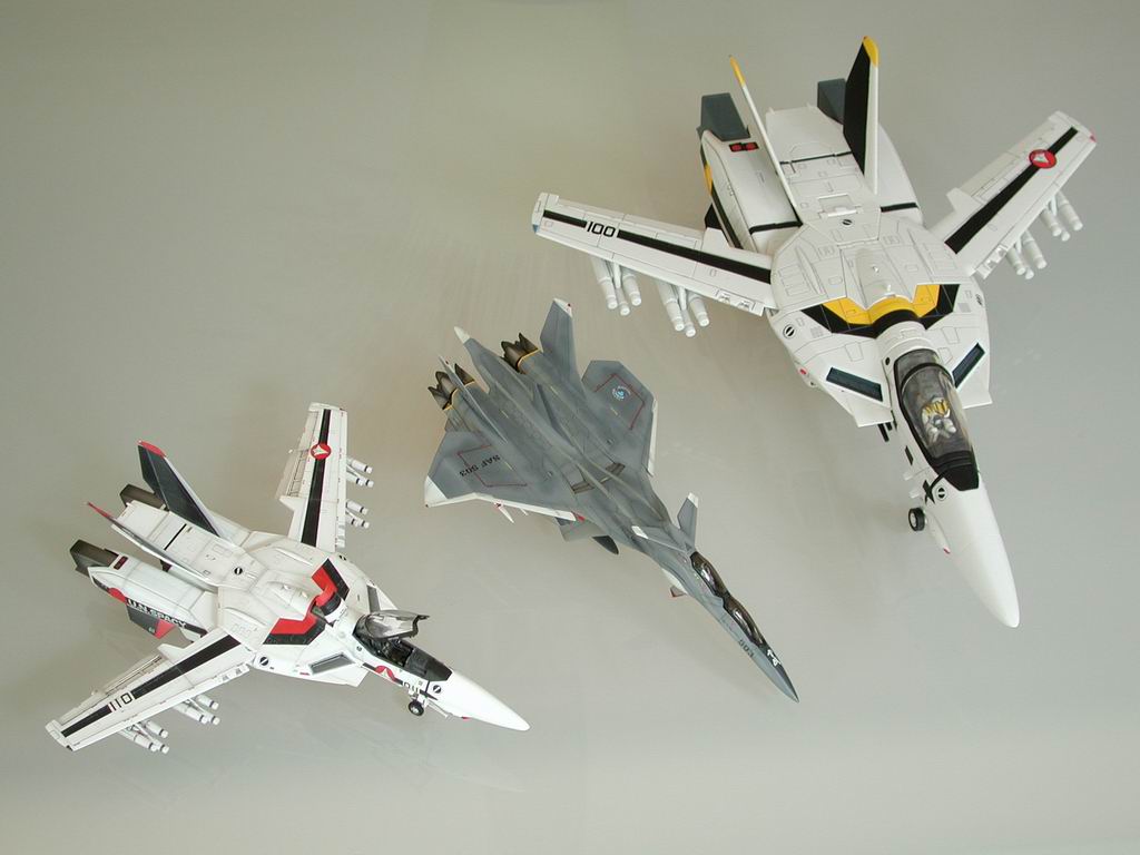

wm cheng Posted September 5, 2003 Posted September 5, 2003 I did mine the same way I do my models - I used a thinned oil wash. I mixed a light grey thinned down mixture of artist oil paints and odourless/low odour varsol (its weaker) and let it flow into the lines. I wiped away any excess. I find this light grey to be more subtle. Sorry old photo from another thread - I'll take photos of the 1/48 after I get Anasazi37's water slide decals. Quote

Etrigan Posted September 5, 2003 Posted September 5, 2003 Beautiful work WM. To clarify, you used oil canvas paints and varsol? What ratio? Quote
wm cheng Posted September 5, 2003 Posted September 5, 2003 Yes, oil canvas paints - in a very thin mixture so that if would run very easily. I'd say more varsol than paint. Quote

recon Posted September 6, 2003 Posted September 6, 2003 I did mine the same way I do my models - I used a thinned oil wash. I mixed a light grey thinned down mixture of artist oil paints and odourless/low odour varsol (its weaker) and let it flow into the lines. I wiped away any excess. I find this light grey to be more subtle.Sorry old photo from another thread - I'll take photos of the 1/48 after I get Anasazi37's water slide decals. Hiya Wmcheng, Always love the subtle approach. Have a question to ask ya, did you pre coat your 1/48 VF-1S with a semi gloss or flat clear coat before panel washing or you just applied it just like that? You intend to do a light clear aftercoat after the application of decals to sealed them in and protect the valk surface as well? Hope to see pictures of your finished work soon Cheers Quote

wm cheng Posted September 6, 2003 Posted September 6, 2003 I just did it right on the bare plastic and wiped off. The only thing was that a bit of the yellow or black did come off on my cloth/towel when I wiped down, but I couldn't tell on the toy itself. So I would suggest using very little varsol (remember low odour or odourless since its weaker) and being careful when you are panelling over the black or coloured lines - but everything else went great. Yes, I do intend to clear-coat the toy to protect the decals when I am done - but I am still waiting for the set from our friend Anasazi I haven't decided whether to do a light post-shading on the toy yet before I seal it in with the clear coat. It is a toy after all - I haven't decided yet - where would I stop - I don't want to start filling all the seams now Quote
