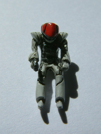

GunnerX Posted September 5, 2003 Author Posted September 5, 2003 Here's the pilot, didn't expect it to be so small! Quite a challenge to paint! Quote

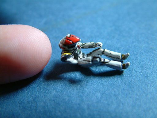

GunnerX Posted September 5, 2003 Author Posted September 5, 2003 Here's the pilot with the decals added, The MicroSet comes in useful here. And that's my pinkie for size comparison! It looks pretty rough in the photos, but looks quite ok to the naked eye actually! Quote

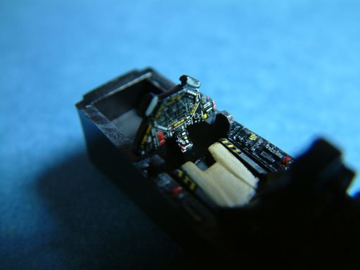

GunnerX Posted September 5, 2003 Author Posted September 5, 2003 The Cockpit painted! (Sorry about the Yellow and Black stripes!, borrowed idea!) dabbed MicroSol on the panel to get the decal to conform. Quote

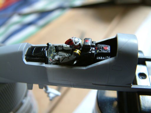

GunnerX Posted September 5, 2003 Author Posted September 5, 2003 Had to put in the pilot to see how he'd fit! Quote

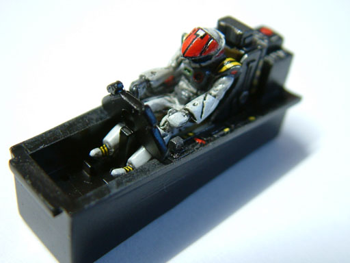

GunnerX Posted September 5, 2003 Author Posted September 5, 2003 I bought a couple of the photoetch sets, but i decided to leave them out this round! I'm basically using this as my testbed for my future kits, so i'm not expecting anything great. Quote

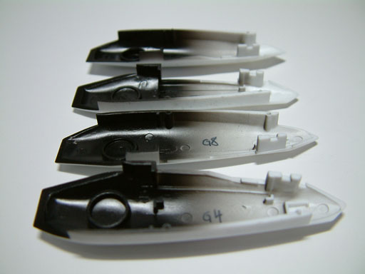

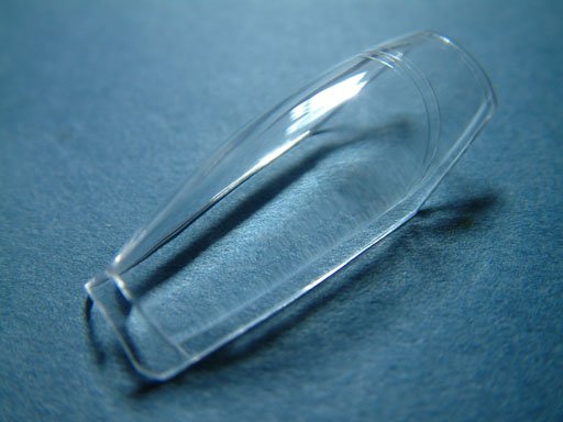

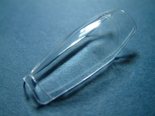

GunnerX Posted September 5, 2003 Author Posted September 5, 2003 WM CHENG'S canopy polishing tips were invaluable here! Using about 800 sandpaper till the finest at 2000 to get rid of the line, then using TAMIYA polish (1000 grit) and another type called modeller's polish (2000 grit). It looked pretty good, but i wanted to see the effect of Future Polish that everyone's been talking about! So i dipped it in the stuff and it looks great! Quote
recon Posted September 5, 2003 Posted September 5, 2003 Looks awesome for your first try!! Keep up the good work. By the way what do you use for the extra details on the side panels of your cockpit, are they photo etched parts from a military aircraft or hand painted details? cant wait to see the finish product. Im also finishing up on my first valk a 1/72 Hasegawa VF-1S Hikaru Valk. Sorry no pictures to post as i aint got no digicam Cheers Quote
GunnerX Posted September 5, 2003 Author Posted September 5, 2003 (edited) Looks awesome for your first try!! Keep up the good work. By the way what do you use for the extra details on the side panels of your cockpit, are they photo etched parts from a military aircraft or hand painted details? cant wait to see the finish product. Im also finishing up on my first valk a 1/72 Hasegawa VF-1S Hikaru Valk. Sorry no pictures to post as i aint got no digicam Cheers Hi! Thanks! Hope it'll turn out ok! I found the side panels sooooooo bare, so i cut up little strips of tamiya pla-plate and just glued them on! Hope to see your kit too k? Cheers! Edited September 5, 2003 by GunnerX Quote
recon Posted September 5, 2003 Posted September 5, 2003 Looks awesome for your first try!! Keep up the good work. By the way what do you use for the extra details on the side panels of your cockpit, are they photo etched parts from a military aircraft or hand painted details? cant wait to see the finish product. Im also finishing up on my first valk a 1/72 Hasegawa VF-1S Hikaru Valk. Sorry no pictures to post as i aint got no digicam Cheers Hi! Thanks! Hope it'll turn out ok! I found the side panels sooooooo bare, so i cut up little strips of tamiya pla-plate and just glued them on! Hope to see your kit too k? Cheers! What are pla plate? Any pictures for reference as i seldom see or heard of stuff like this? Cheers Quote
wm cheng Posted September 5, 2003 Posted September 5, 2003 Fantastic work GunnerX!! Great to see all the modellers starting to come out of the woodworks! The cockpit is lookng great. I also put some photoetched instrumentations on the side panels when I did my first cockpit form left over spare photo-etched parts - but later found out that the actual TV version of the cockpit had olive green smooth arm-rest on the side panels!! Wierd eh. Quote
TheFrenchOne Posted September 5, 2003 Posted September 5, 2003 Had to put in the pilot to see how he'd fit! Look great ! Congrats! Just for info : How many hours for making this? Quote
GunnerX Posted September 6, 2003 Author Posted September 6, 2003 RECON - > It's just pieces of polystyrene strips, you can purchase these plastic sheets at most model shops WM CHENG -> Thank you so much! i'm hoping that more people will do their model kits up because i don't want it to be a dying art! Especially with all these prebuilt toys out there now TheFrenchOne -> Thanks thefrenchone! lessee... about 4 to 5 hours for the pilot (waiting for paint to dry and decaling it) and about slightly longer for the cockpit? It do the model only on weekends though! Work cuts into my building time a lot! Quote

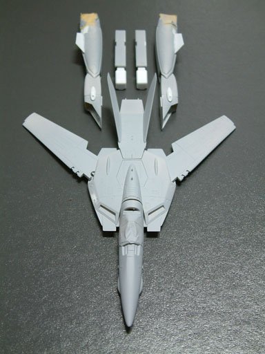

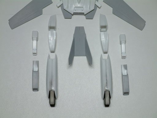

GunnerX Posted September 6, 2003 Author Posted September 6, 2003 Ok, here's the base body. The grey stuff over the whole thing is Gunze Surfacer, a sort of base coat i use. Quote

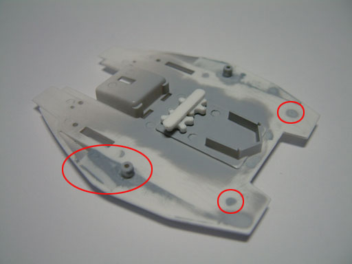

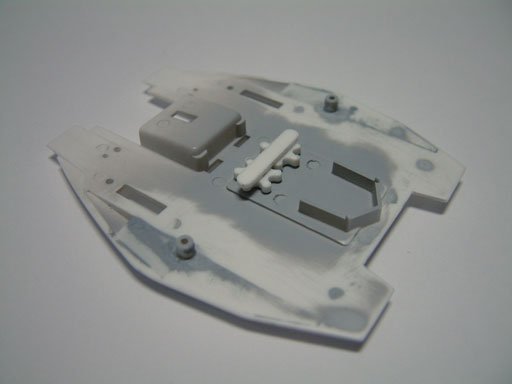

GunnerX Posted September 6, 2003 Author Posted September 6, 2003 Remember to fill up the spots ( circled red ) with putty! These are not hidden and will show up quite clearly. Also, place and pice of styrene plate in the gap ( oval circle ) and cover it up, if not, there'll also be a gap when the wings are swept back. Quote

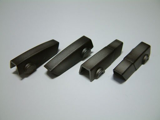

GunnerX Posted September 9, 2003 Author Posted September 9, 2003 Internal area of the leg painted black! Another hint i took from WM cheng. Quote
GunnerX Posted September 9, 2003 Author Posted September 9, 2003 Here i joined the foot/thrusters and the leg portions together. The fit wasn't very good! You can see the large gaps in the legs. Well, that's more puttying to do! Quote

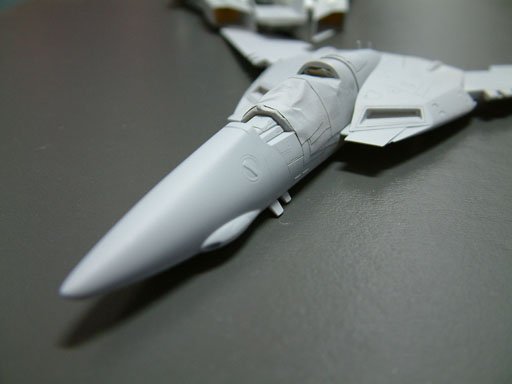

GunnerX Posted September 10, 2003 Author Posted September 10, 2003 I decided to mask the cockpit area then base-coat the rest, wasn't very comfortable with using the canopy cover as a mask! Quote

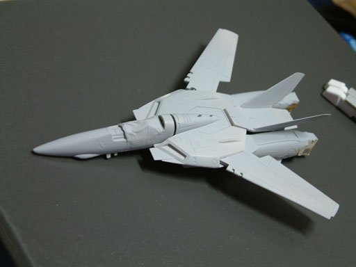

GunnerX Posted September 10, 2003 Author Posted September 10, 2003 A test fit for the kit! Wanted to see roughly how big it was! Quote
