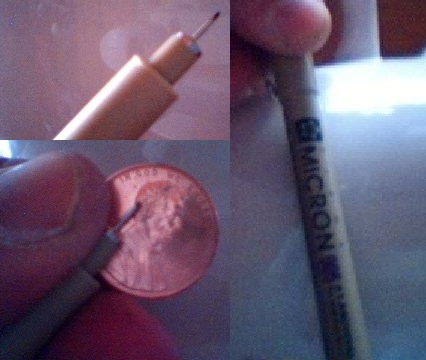

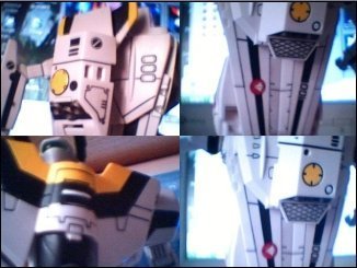

geecie30 Posted June 8, 2004 Posted June 8, 2004 (edited) I just used the Pigma Micron with the smallest tip(005)(.45mm linewidth), it was easy to clean up any slip in panel lines by using alcohol and a swab .If you want thin lines,a "once-over", is enough but, on some of the wider lines, simply go over it again for a bolder touch,unless you like subtle .The ink lines are waterproof but, will easily come off later with rubbing acohol,where needed in undoing a line(let say you wanted to sell it without the lines/reversible).It was hot one day, when doing this for myself, so ,I was thinking "my worst enemy would be my hands getting clammy or sweating due to the heat ,possibly smudging a little bit". That cant happen, however.These pens are forgiving and user friendly.If you decided to give this a try,The panel lines are deep enough that you wont have to worry about smudging too much.Again, check it out periodically while applying the pen and get out the cotton swab with alcohol should you jump off the panel line notches ,as some lines aren't as deep as others,in places.I drink coffee alot ,so I was jittery while doing this project,I made a couple errors that the alcohol dipped swabs easily corrected. I know that everyone can do it unless you got (ALS) Lou Gehrig's Disease or parkinsons disorder. Iam all thumbs ,and my detail job looks perfect.The lines take 5 minutes to dry probably. Edited June 8, 2004 by geecie30 Quote
Neova Posted June 8, 2004 Posted June 8, 2004 Geecie30, Looks REALLY good. Anime line art look. I need to try this technique out. Thanks for sharing. Quote
geecie30 Posted June 8, 2004 Posted June 8, 2004 Thanks ,I give credit to area seven for the idea .Those pens are at every hobbystore.The yellow radar thing?on the backpack it permanent sharpie ink with 2 applications . I woudn't mind trying the indian ink mixed into alcohol/weathering effect some day . Quote
