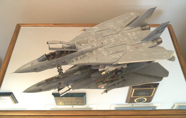

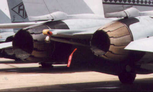

captain america Posted April 27, 2004 Posted April 27, 2004 Hi David. I actually have the 1/32 Tamiya Tomcat ( 1994 re-issue.) All in all, I firmly believe that it has more potential than any other Tomcat kit out there on the market at the moment. The lack of scribed detail on the aft fuselage is a blessing in my eyes: considering tamiya's tendancy to carve very deep trenches in offerings like the 1/32 Eagle and Phantoms, I'll gladly do my own scribing in the proper size. Regarding the Cutting Edge fuselage/engine nozzle update set, I think it falls rather short in my eyes: there's absolutely no need to cut away the aft fuselage to make it correct, you just need some putty to square-off the outer fairing and re-model the adaptor fitting aft of the alligator plates, which is really just a bare carbon-fiber part. Even worse, the update kit completely ignores the fact that you need new burner cans to go with the GE nozzles, so scratchbuilding skills are necessary if you want to do it right. Having said that, it's still my pick as the best F-14 kit out there, with the 1/48 Hasegawa a close second. The latter definitely provides more bang for the buck and gives you more lattitude to build alternate versions, but they did screw-up in the shaping of the upper portion of the LEX/wing glove, which is a tad too flat, and the lower aft fuselage just foreward of the engine nozzles is improperly shaped.
David Hingtgen Posted April 27, 2004 Author Posted April 27, 2004 (edited) I will have to take a look at that on the 1/72 Hase and see if it's the same (haven't put that part together yet! ). So the GE nozzle's new parts are carbon fibre? Yeesh, I have almost every F-14 book you can buy and none ever said that. Makes perfect sense though, being all black and smooth. I'm going book-shopping tomorrow, and plan to buy any Tomcat book I find. Anyways--I was actually talking about the Teknics conversion, which is much better than the Cutting Edge one (from pics, I don't own a set). Grey resin is almost always better than yellow, from my experience. They mold the fairings with the carbon-fiber area together. http://greatmodels.com/cgi/display.cgi?item_num=tk32011 http://www.internetmodeler.com/2001/octobe...s/tk_detail.htm I personally hate puttying, and hate sculpting with putty even more, so I will gladly slice the heck out of a kit and add a new resin part, as opposed to modify what's there. But if you can sculpt putty well, probably the way to ge to ensure nice a square fairings. (I don't recall hearing the term alligator plates before, but it makes sense--there's SO many Tomcat back-end terms. Rear deckincg/boattail/beavertail just for starters) IMHO, the burner cans themselves are nigh-identical internally (for I have stuck my head up both types--they may have differnet dimensions, but the proportions and look are awfully similar--many circumferential rings in a row). But the flamer-holders/exhaust bullet etc are of course very very different. (and a point of contention in the Fuji kit, they appear too small, but being a full inch inside the nozzle, it's not obvious unless you do a side-by-side compaison--hase's are definitely better and bigger) Any 1/32 F-16C GE burners out there? PS--that brings up another point. Fujimi burner interior is much nicer than Hase. Hase has very visible pins to hold it together, and the "rings" inside don't line up at all. PPS--I have looked at the local shops' Tamiya F-14 many times. They must have just sold it, gone last time I was there. (I was close to buying it--I came into some cash). I would make it a Sundowners CAG though, my fave F-14 by far. (but NOT Miss Molly, which is the most overdone F-14 after Jolly Rogers high-vis) Edited April 27, 2004 by David Hingtgen

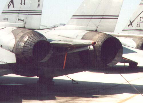

David Hingtgen Posted April 27, 2004 Author Posted April 27, 2004 (edited) B's have identical back-ends to D's. All the B vs D changes are the cockpit, chin-pod, and the ECM bumps. All in all, the Hase B/D's are pretty darn close, but my feelings are that for the time and effort to build ANY version of a Hase, it's a lot less work to modify a Fujimi, for 99% of the accuracy of the Hase. And a LOT better engines. I could care less that the Hase has a photoetched cockpit and chaff dispensers, if the engine nozzles totally suck. (I like engines, some(most) people like cockpits above all else) (Well, and no intake ducting, but since most jets in 1/72 don't have it, I don't mind much) If you're going to build just 1 or 2 Tomcats, get Hase's and detail the heck out of them. But I have no less than 7 A's, 2 B's, and 3 D's planned. Time/effort (and fragility, I plan to move at least twice in the next few years) is a factor. (If I had all the time and energy in the world, I would build the ENTIRE Iowa class, not just one ship--heck, I'd build every US battleship built from 1930 on) Might as well just edit, than add more replies! wm_cheng--what, you want pics of taped together un-primed dry-fits? I've spent many hours comparing the kits, to decide "how am I going to build my future fleet of Tomcats". It'll be a while before they all actually get bought and built. (Have lots of decals, and a few kits). I still plan to build that Italeri 1/48 I have for practice very soon. (just need to buy some new decals---the kit's are very nice, I just hate the schemes) Might even weather it a little! cambodian tire---Mostof my Fujimi kits are the original kits from a decade ago--the decals haven't seem to deteriorate, and plastic generally doesn't. Build away! And yes the canopy is bubbled too wide (probably why the instrument coaming is wider in the Fuji). Canopy/cockpit area is definitely the area where Hase is better than Fuji, though I still say the nosecone itself is better on the Fujimi (and the cross-section of the forward fuselage). PS--more Fuji/Hase differences. The Hase is noticeably wider between the nacelles at the back end. (I noticed this because the boattail widths are decidedly different between the kits). Hase's Flanker also has this problem. I think Fuji's correct on this issue. So the Fuji's intakes are too far apart up front, the Hase's are too far apart in the back. Fuji gets points for having a cat hold-back on the compressed nose-gear. Edited April 27, 2004 by David Hingtgen

newca Posted April 27, 2004 Posted April 27, 2004 this is a B(VF-102) not D, althouth the engine is same. I have one Fujimi Royal Collection F-14D prototype, with F101 nozzles and different type stabilizer. I don't know much about that red-white colored prototype, can't tell what's right or wrong...
David Hingtgen Posted April 27, 2004 Author Posted April 27, 2004 (edited) Yes, I know it's a B, I was hoping nobody'd notice. There's no physical way to tell in that pic, it's only the paintjob that lets people know. (Darn their way-too-obvious diamond-pattern insignia) PS--you've got the Red/white Fuji F-14 with the different stabs? That is exactly the one I've been talking about. The one I suspect Shin's is modeled off it. (well, add a dual chin-pod). Funky fairings and all. (The new stabs are because the duct area is so short on that variant, the nozzles would get in the way of the stabs) PPS---since you have that variant, what exact sprues does it have? Does it have sprue J? Specifically, does it have a dual chin pod, or the late-style gunvents? Edited April 27, 2004 by David Hingtgen
