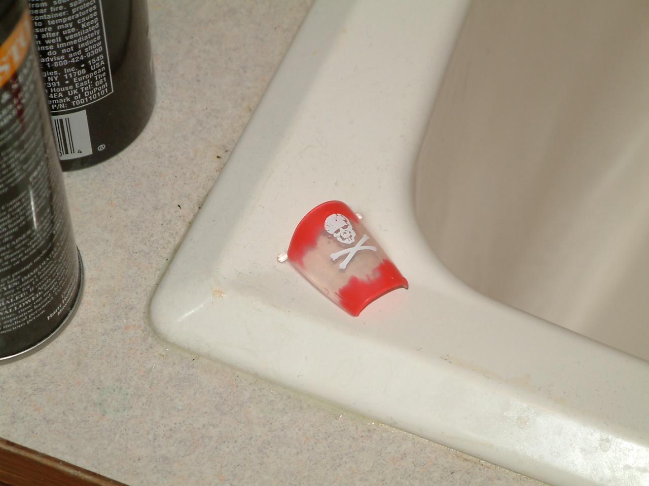

Godzilla Posted May 10, 2004 Author Posted May 10, 2004 Ok, Here are the results. Haterist is right. Problem is that I have been rubbing for about 30min to 1 hour. not bad. Here is a pic. Quote
do not disturb Posted May 10, 2004 Posted May 10, 2004 30 min? and hour? if you're doing it correctly, it shouldn't take more than 15-20 seconds. be sure to rub the painted piece on the cloth DO NOT rub the cloth on the painted piece or you'll be sitting there forever! also a napkin won't cut it....i've tried that and it just tears into pieces. take a old cotton t-shirt and use that. you can fit it into the heatshield and slide it back and forth with enough pressure to remove the paint very quickly. either way, whatever works for you i guess but it really should take that long. Quote
Godzilla Posted May 10, 2004 Author Posted May 10, 2004 30 min? and hour? if you're doing it correctly, it shouldn't take more than 15-20 seconds. be sure to rub the painted piece on the cloth DO NOT rub the cloth on the painted piece or you'll be sitting there forever! also a napkin won't cut it....i've tried that and it just tears into pieces. take a old cotton t-shirt and use that. you can fit it into the heatshield and slide it back and forth with enough pressure to remove the paint very quickly. either way, whatever works for you i guess but it really should take that long. Actually is it gotten better as time progressed. I was rubbing the cloth on the shield. Yes I switched to cloth. I wanted to try it out with a napkin. Prolly total time was 1 hour- 1/2 hour. I got 90% of the paint off but I need to work on the rest later tonight. 15-20sec. Paint does come off immediately but I think the paint is pretty thick. Conclusion: Brasso does indeed work. Thought there is fog on the clear plastic like the heat shield on these Valks, it does the job. I will see if I can get the rest off. It is at the edges of the shield. Quote

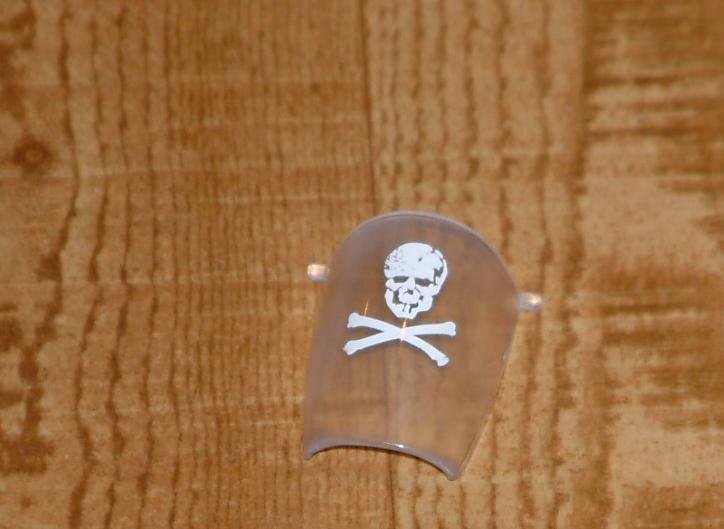

Godzilla Posted May 11, 2004 Author Posted May 11, 2004 (edited) look at the clear heat shield from the vf-1s hikaru. Thanks for the tip Haterist. 99.9% of the paint is gone. There is a tiny bit of red left... little streaks here and there. Actually 2 places. Me being the perfectionist, I will get the rest off by using a toothbrush. It works using the toothbrush as I got the rest of the rest out at the edges. Edited May 11, 2004 by Godzilla Quote
