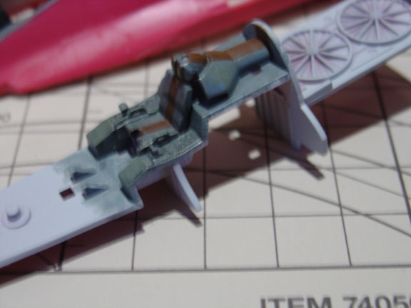

Jinnai Posted April 11, 2004 Author Posted April 11, 2004 I then lightly drybrushed the original grey I used (Tamiya XF-66) over the top after wiping away excess wash. As not much is seen after applying the canopy, I kept it as basic as possible. Quote

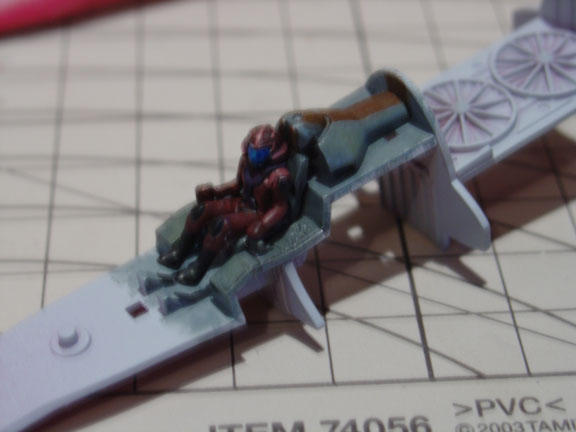

Jinnai Posted April 11, 2004 Author Posted April 11, 2004 With the cockpit completed in my opinion, the next natural step was to finally glue Nora into place. The past couple of steps seemed to have taken forever, but then I reminded myself that I still have the main body to be painted.. which will take far longer than just doing the cockpit. Quote

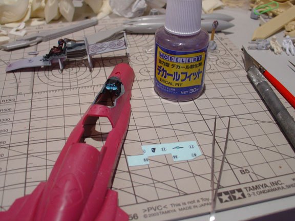

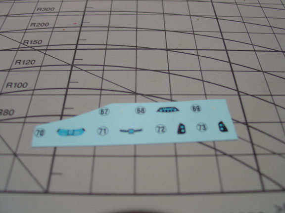

Jinnai Posted April 11, 2004 Author Posted April 11, 2004 And here are the decals used to put over the instrument panel. Something that scares me about this is the fact that the mirrors are small and single parts, and the whole panel is broken up into smaller pieces. It should be ok though.. I hope. Quote
Jinnai Posted April 11, 2004 Author Posted April 11, 2004 And sure enough.. disaster did strike. While I was applying the decal for the lower right hand side near Nora's leg, I put on my decal set (shown in the image) however, the decal wasn't quite attached to the surface of the kit, and stuck to the brush that had my decal solvent on it. By the time I got it off, it had disintergrated. No major loss, as I still have 2 SV-51 kits of my own to arrive, so I'll just steal the decal from there. Quote
Jinnai Posted April 11, 2004 Author Posted April 11, 2004 And once again, disaster struck. With the right hand side mirror, I lost that one to the same problem that occured in the previous step. This 2nd kit of mine will be short some decals. Might have to sell it to my mate to make a Battroid. Here's the instrument panel decaled, minus the two that.. were KIA. Quote

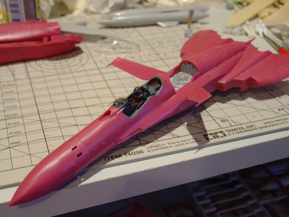

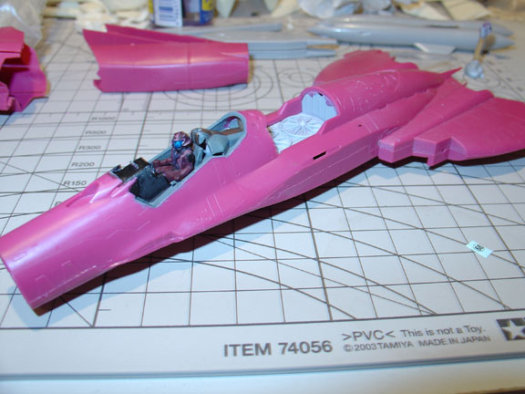

Jinnai Posted April 11, 2004 Author Posted April 11, 2004 So with the cockpit complete (I can add the decals later), it was time to finally seal her up between the fuselage pieces. My method of gluing usually involves putting down an excess layer on one half, then I'll put the parts together and squeeze, so excess melted plastic will ooze out. That way, I can sand down to begin with, and if I've done it correctly, I won't need to putty, or reduce the need to putty. Quote

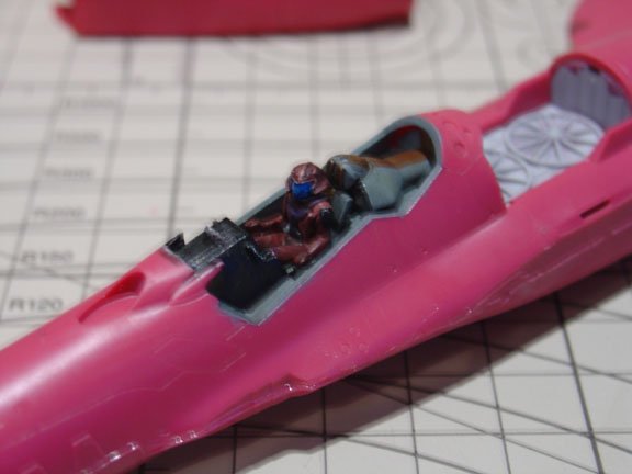

Jinnai Posted April 11, 2004 Author Posted April 11, 2004 Shown in place is Nora, sitting in the cockpit, looking for that elusive VF-0D.. I say give it til October! Quote

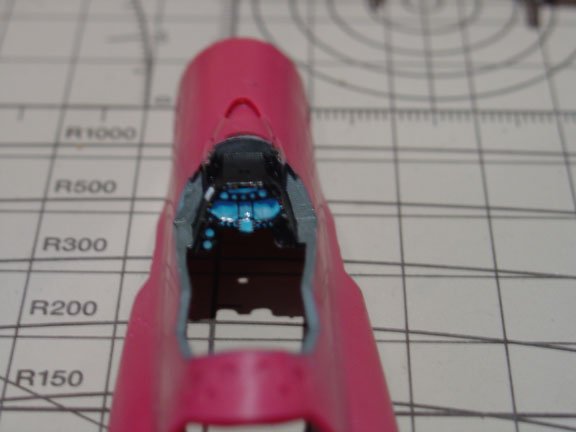

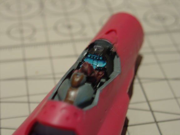

Jinnai Posted April 11, 2004 Author Posted April 11, 2004 Another beauty shot, straight into the cockpit, showing the instrument panel and the HUD. Quote

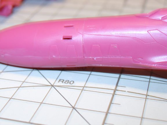

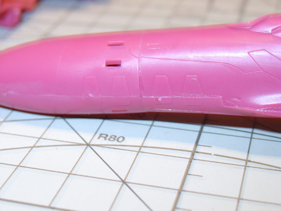

Jinnai Posted April 11, 2004 Author Posted April 11, 2004 So the next step was to start assembling the body of the kit. I already had the nosecone glued together to help keep the nose landing gear flush, however either I did something wrong, or the kit was engineered slightly badly, but there's a rather large size difference between the nose and the fuselage. It's about 0.5-1mm deep, and either fill it with a lot of putty, or sand it back so the nose is flush. The thing that scares me is the raised panels on either side. If I accidently sand them down, I might be able to remake them using sheet styrene, but that's unnessesary if I'm careful. More to come. Quote

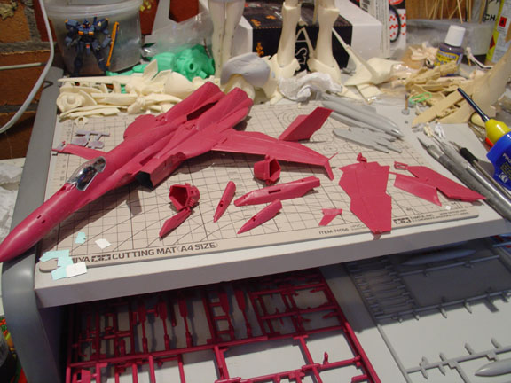

Jinnai Posted April 11, 2004 Author Posted April 11, 2004 Two more updates, and that'll probably be it for the night.. but then again, I have an itch to keep building, and right now it's not going away, despite how often I'm scratching.. Seriously, this photo doesn't give the size of the kit justice. This is one huge bird. I think I'll have to pull my VF-0S out of the cupboard for one last shot, just for a size comparison. Maybe a VF-1 also.. But here she is again, most of the preassembly for this part of the fuselage is done. Next will be to start sanding down seams, and applying Mr. Surfacer for spot checks. I used to be an avid Tamiya Putty user, but about 8 months ago I realised just how good Mr. Surfacer 500 was for puttying reasons, and easier to use. So now I use that exclusively. Quote

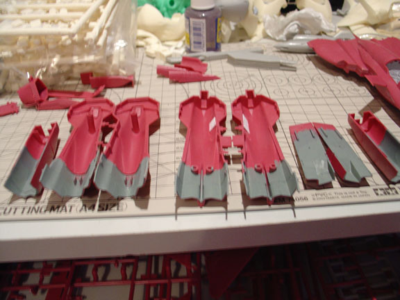

Jinnai Posted April 11, 2004 Author Posted April 11, 2004 Here I've done some pre-painting onto the bare plastic, in areas that'll be harder to reach when I've started more gluing. These are the intakes and the legs. I've done a lot of dry fitting with this while waiting for parts of the cockpit to dry, and I found that nearly all of the injector marks are covered by other parts, so I didn't need to fill them. Those that do need to be filled I'll do when I cover the inside seams with Mr. Surfacer, and sand back them. Then reapply the paint. I used Tamiya XF-25 (Light Sea Grey) for this, as it contrasted well with the purple I've pre-mixed for the base coat of the fighter. Quote

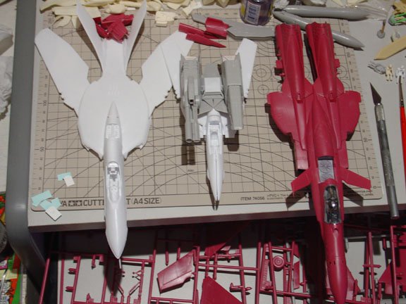

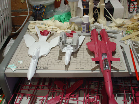

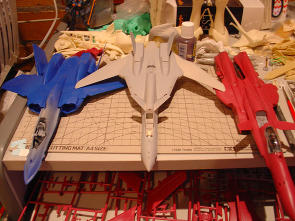

Jinnai Posted April 11, 2004 Author Posted April 11, 2004 Last two photos for the night. I just had to take a photo of this. Seriously, no wonder Nora loves fighting in this thing. Quote
Jinnai Posted April 11, 2004 Author Posted April 11, 2004 I think Claudia told Roy that flying a big VF-0S was overcompensating for a lack of something.. that's why he then moved into the VF-1S. I'll update more later, as I work on it. Quote
Jinnai Posted April 11, 2004 Author Posted April 11, 2004 Ok, it just wasn't right to not include the Mac Plus 1/72's.. Quote
Aurora-7 Posted April 11, 2004 Posted April 11, 2004 My God! I did not realize how much bigger the VF-0 is to the VF-1. I wonder if it was intentional to illustrate the technology differences between concept and production aircraft. Quote

David Hingtgen Posted April 14, 2004 Posted April 14, 2004 I'm fond of the "sand and dry fit as much as possible BEFORE gluing together" method. I'd much rather sand plastic than any sort of filler. Of course, there's only so much you can do without filler. (For the first time in oh, a decade, I glued together some F-14 parts yesterday) PS--do you plan to paint the lift-fan blades? I know Hase says grey like their surrounding bay and the cockpit, but that just seems so wrong to me, though I haven't seen them in the animation. Quote
Jinnai Posted April 14, 2004 Author Posted April 14, 2004 It's a good thing I did do a lot of dry fitting and seam elimination with glue before using filler, as there were some areas that really, really freaked me out, especially with sanding. I've just finished sanding back the most annoying area I've noticed sofar (where the nose joins the fuselage) and I started freaking thinking I had removed most of the raise panels around the end of the nose. After sanding back with 1000 grit, they were still very prominant. So I'm happy there, I'm about to do a test prime to see if I missed anywhere on the nose. As for the VTOL fans.. my client asked me if there was any way I could make the cowling for those fans to be opened and closed, but without fiddling around a lot, I couldn't. So I'm not painting them. Maybe on one of my own I will, but I'm fairly sure there's some scenes with D.D in gerwalk (either OVA 2 or 3) where the cover does go up during Gerwalk mode. With wings and the fuel/missile pods attached to the wings, she's a really, really big beast.. I just can't get over the size. Quote
