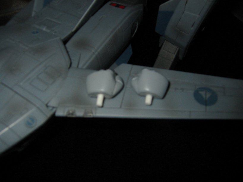

I painted Rohby's recast hands for my Low -Vis using Orchard Supplies primer grey. Then i spayed a gloss clear coat on it. I tried gun metal grey, too dark..this is kinda of light though but close.
to177
Edited by to177
well the hands (as far as i know) are always portrayed in the show as white. so makeing them a llighter grey than the rest of the plane probably won't matter, remember, in most cases they will be in close contact with the WHITE gun pod, any subtle diffrences won't be too noticeable next to that kind of contrast.
i just left my hands white on my low viz, i'm cool with that. they look good to me.
