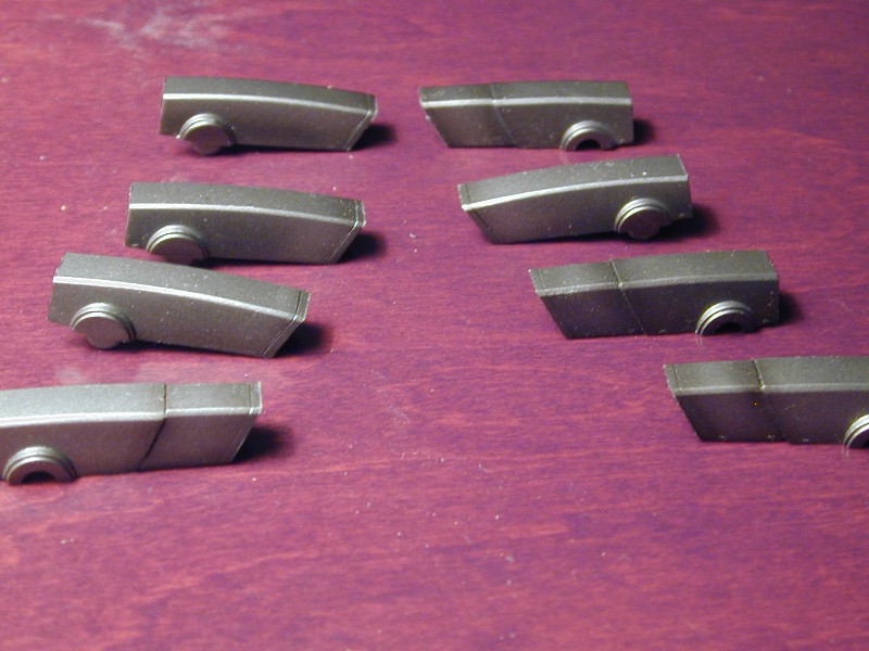

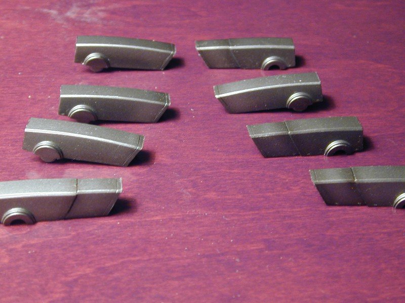

Grayson72 Posted September 2, 2003 Posted September 2, 2003 (edited) Speaking of airbrushing here's my first attempt at preshading, some of it doesn't show up well in the photo but all of them are done. I'm just glad it didn't come out all splattery. Edited September 2, 2003 by Grayson72 Quote
Commander McBride Posted September 2, 2003 Posted September 2, 2003 Aw, man, i've been trying to preshade for years, and I havent even been able to make it recognizable as preshading! Quote
