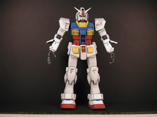

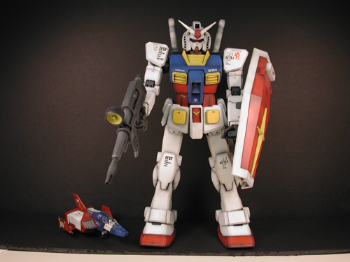

Kurt Posted September 3, 2003 Author Posted September 3, 2003 I know this is not Macross and not a "how to", but someone mentioned Bandai models and I thought I would show you this. Quote
bigkid24 Posted September 9, 2003 Posted September 9, 2003 Kurt In the pictures of that Gundam that you built, the white parts aren't that white but look "dirty." Is that what you guys mean when you say "wash?" Obviously, I'm a toy collector not a modeler. Quote

Kurt Posted September 9, 2003 Author Posted September 9, 2003 bigkid24 - The white areas on the Gundam where first Pre-shaded, then the white was painted on. Then a several washes were applied followed up with drybrushing. As a final touch I use pastel chalk to obtain a few effects. David Hinggen - I will put together a description on how I hide seam lines. It is very similar to wm cheng's technique. Quote
bigkid24 Posted September 9, 2003 Posted September 9, 2003 bigkid24 - The white areas on the Gundam where first Pre-shaded, then the white was painted on. Then a several washes were applied followed up with drybrushing. As a final touch I use pastel chalk to obtain a few effects. Can you explain pre-shading when you get the time? I've read articles on most of those techniques except for pre-shading. I think Seichii at the MW con mentioned that's what he did too. It looks like a very effect technique. Quote

Kurt Posted September 11, 2003 Author Posted September 11, 2003 bigkid24 - Everyone has their own technique for pre-shading. Pre-shading means that you shade all of the shadow areas of the model before you apply the main color. Most people people suggest using a darker mix of the main color, I like to use a very dark grey or even straight black regardless of the intended color of the model. I used black on that Gundam model even though I was using pure white as my main color. I found that using black to pre-shade you can tone down the contrast to your liking when applying the main color. This also saves time because I can pre-shade an entire model without considering what the color will end up being for each area. However a word of warning. If the main color is dark, like a dark blue or grey, I have found that the pre-shading tends to get lost when applying that color. That is when it is necessary to post-shade, meaning to shade after painting the main color. I will also use this time to go over any areas that I toned down to much and add more shadow. I also like to post shade in select areas with pastel chalk. I have actually post shaded entire models with chalk and had excellent results. But I really like to use a mixture of all three in addition to the usual washes. Quote
