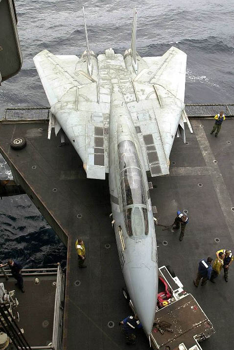

rdenham Posted March 24, 2004 Posted March 24, 2004 Although the yf-19’s rearward swept wing position may have some aerodynamic function it would also help to conserve space in much the same way as the F-14’s oversweep wing position of 75 degrees. Quote

ewilen Posted March 25, 2004 Posted March 25, 2004 rdenham, that's a beautiful picture. (I'm referring to the F-14, not your avatar )Great reference to see what "realistic" panel lining should hope to achieve. Quote

Skull Leader Posted March 25, 2004 Posted March 25, 2004 they SO need to wash that F-14, it looks damn near disgraceful..... Yeah, I'm kinda interested in this X-plane simulator and I've never heard of it.... any info? Quote

KingNor Posted March 25, 2004 Posted March 25, 2004 they SO need to wash that F-14, it looks damn near disgraceful..... Yeah, I'm kinda interested in this X-plane simulator and I've never heard of it.... any info? i thought the f-14 looked kinda neat like that. i like the texture in contrast with the polished canopy. makes the jet look ancient. Quote
David Hingtgen Posted March 25, 2004 Posted March 25, 2004 Any low-vis Tomcat looks just like that pic. Sometimes nicer, sometimes worse. It's simple--corrosion control/prevention. Any little spot that looks less than perfect, gets sanded/primed/painted right away at sea. And they only paint the exact little spot, not the whole panel, so it looks really patchy pretty soon. (Crews would like to do a whole panel at a time, it'd make the planes look a lot better, but the Navy says no) And paint batches don't match anyway. And sometimes you're out of Dark Ghost Gray and need to use Light Ghost Grey. AC4's X-02: It's a YF-23 with switchblade wings embedded in the leading edges. (And new engines, ventral fins, folding stabs). But it's 80% YF-23, much like AC2's XFA-27 was mainly an F-14. Angel's Fury: a quick explanation of canards is that they are basically the opposite of horiz. stabs. Unless you're an F-16 or X-29 or anything else purposely realyl unstable, a plane's center of lift is aft of its center of gravity. That is basic stability---if lift is forward of center of gravity, you're unstable. ::tries to find pic:: Ok, more extra stuff than I wanted, but it shows it well: Big black vertical line (W): center of lift from wings. Yellow dot: center of gravity. Lift pulls up, gravity pulls down. Imagine if you attached strings to the center of lift and center of gravity, and pulled in opposite directions (down from gravity, and up from lift). Since lift is aft of gravity, the plane will tip nose-down. Not good. Now look at the h. stabs---the big black line labled T. That's the force from the tail. It is small, but aft of the wings, and pulls down, thus righting the aircraft, thus level flight. That is how most planes fly. If a plane weighs 100,000lbs, you actually need like 120,000lbs of lift from the wings, since the tail will probably be pushing DOWN with 20,000lbs of force, to keep the plane level. So---what's another way to keep the plane level? The exact opposite--a small tail pulling UP, AHEAD of the wings. Which would be canards. Generally seen as superior, since they add to the lift of the wings, rather than trying to oppose them from behind. Best example is takeoff--you're at the end of a runway, trying to get lift to get off the ground--then to pull up, you push DOWN with thousands of pounds of force on the tail----not the best way to get UP. You can kind of think of it like this--to make a balanced force against gravity, you can have either a huge lifting force from the wings and a downforce from the tail, or a medium lift from the wings and a small lift from the canards. Tailplane downforce generally is more stable, but canards are lighter and quicker. Thus you see airliners with tailplanes, and many fighters with canards. You also see many modern fighters with tailplanes instead of canards--why? Well, some designers just don't like canards (this is why F-16's don't have them). Heck, it's the reason most don't have them. Also---it is easy to add a canard for additional stability/control, like you see on the X-29 or S-37 or the XB-70. It is however very easy to add a "bad" canard and have a really messed up plane if its the ONLY source of pitch stability. SAAB is certainly good at it, but many companies/designers are not experienced with it. Canard-only designs are AFAIK harder to design than tailplane/h.stab designs. Finally---you're much more likely to see canards on a delta-winged plane. Look at XB-70, most modern European fighters, etc. It mainly has to do with how elevons work on delta-winged planes, and especially the "takeoff" situation I mentioned. Also, since delta-winged planes are generally quite stable in pitch anyway since they have such huge wings and a spread center of lift (unless you design it not to be), they usually use canards as a supplement, not the only source for pitch control. (Since it's usually the wing itself for pitch control----look at a Concorde---nothing but the wing). So in summary a YF-19 would probably use its small canards simply as an additional source of pitch control, since it has thrust-vectoring like almost every other valk for its primary source of pitch stability/control. Canards (like most any control surface if you want) can also be used differentially for roll control, but the -19's are so small it's probably pointless. "Supplemental" canards are awesome to quickly pitch-up (the main move fighters do) because if you have a normal tailplane--that means you've got a downforce at one end of the plane, and an upforce at the other--and you will very quickly rotate the aircraft about its axis like that. Quote
