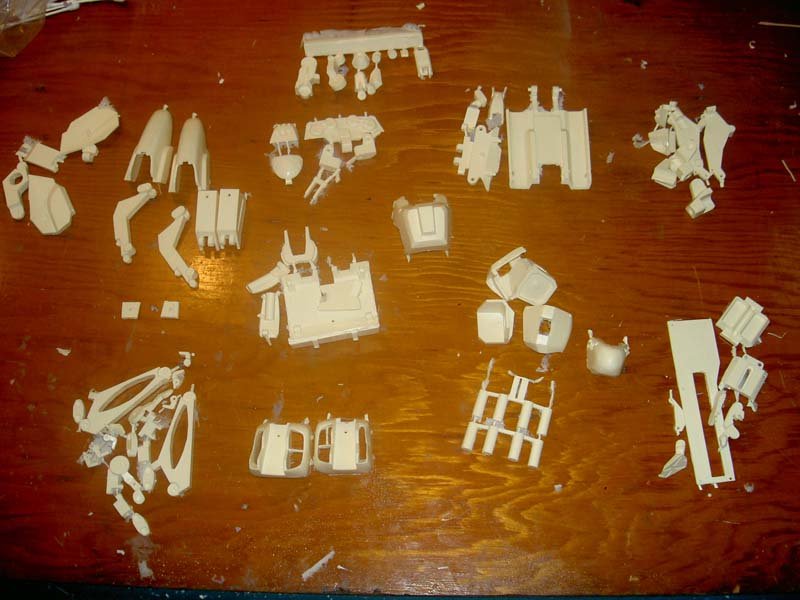

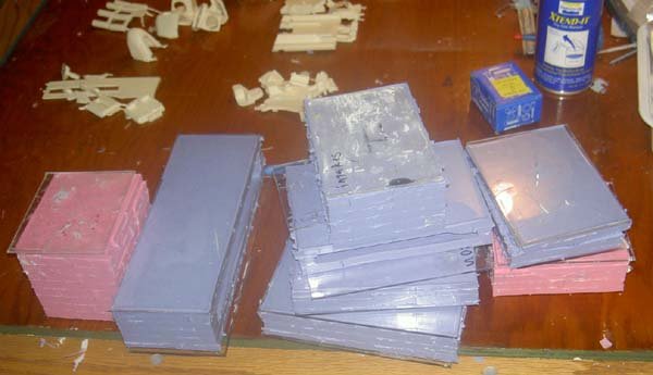

Valkyrie Posted April 4, 2005 Posted April 4, 2005 Sorry once again to have kept you guys waiting. Things have been a bit crazy... But it's almost done. I should just have one more mold to make (the 4-gang mold of the barrels), and pretty much everything else should be only casting work. The hard part is done. And there were some rather difficult molds in there... I'll start with a pic of the first successful casts from some of the molds. This is what's going to become Carl's kit. I promised him the first one. Quote

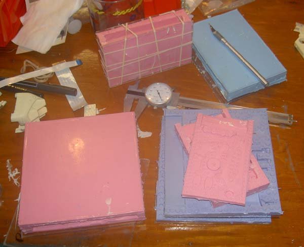

Valkyrie Posted April 4, 2005 Posted April 4, 2005 The molds that were used to make those parts... Quote

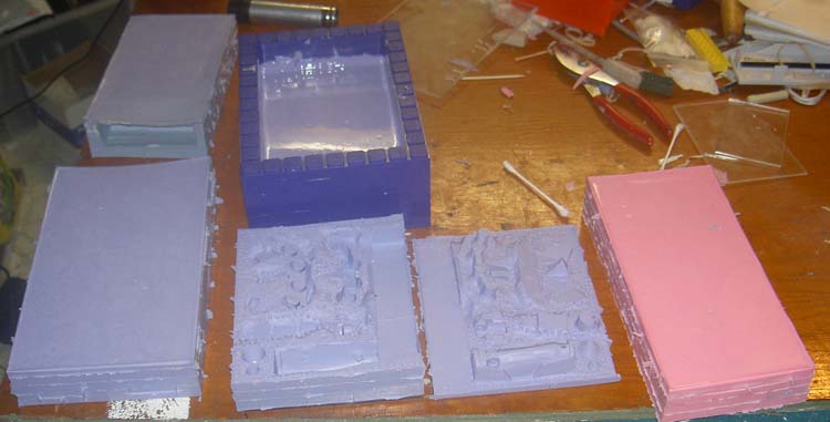

Valkyrie Posted April 4, 2005 Posted April 4, 2005 (edited) A few more molds... Edited April 4, 2005 by Valkyrie Quote
Valkyrie Posted April 4, 2005 Posted April 4, 2005 And the last of the molds, including the latest one, which I haven't removed from its box yet. Quote

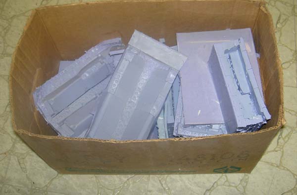

Valkyrie Posted April 4, 2005 Posted April 4, 2005 And speaking of molds, here's the big box of molds from the first round of the Monster project. They've served their purpose, so they're pretty much useless to me now. But it pains me to think how much time and money is in that box... Anyway, if anyone needs some Oomoo 30 to chop up and use as filler in their molds, let me know. Quote

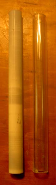

Valkyrie Posted April 4, 2005 Posted April 4, 2005 And finally, my scratchbuilt cannon barrel, next to the plain acrylic tube that the original kit came with. I think is came out quite well. You may notice that it's a bit longer than the original, but it's intentional. The final barrel casts will all be individually machined to their proper lengths, and probably bored out from the rear to reduce their weight. Quote

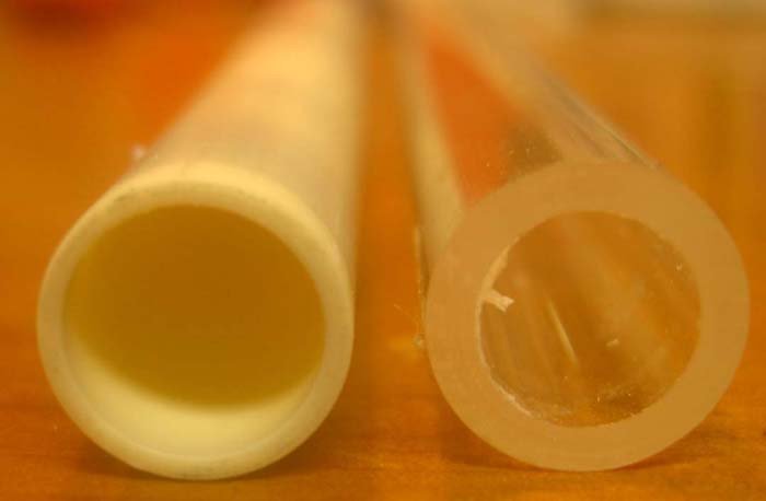

Valkyrie Posted April 4, 2005 Posted April 4, 2005 A frontal shot, to give you all a clearer look at their differences. The original is way too thick-walled for my tastes, so I made it a lot thinner. I also made it only partially hollow, so it'll be easier to paint, while still looking realistic. Quote

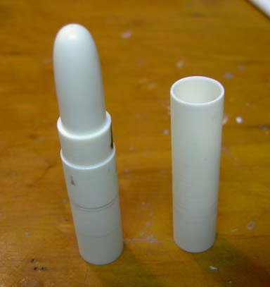

Valkyrie Posted April 4, 2005 Posted April 4, 2005 And to give you a clearer idea of the inside of the barrel (i hope), here's the 'mold' I made to create the inside of the forward section of the barrel. That bullet-looking piece on the left is the negative shape of the front inch or so of the barrel. Quote
