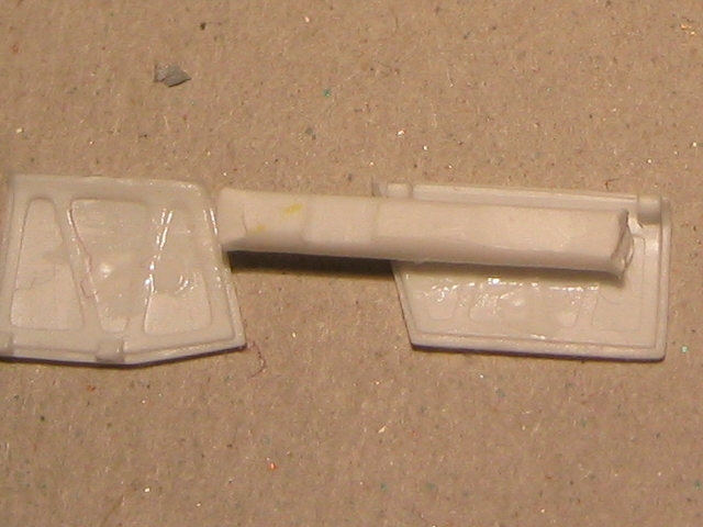

Gabe Q Posted March 5, 2004 Posted March 5, 2004 Hi everybody! (You respond, "Hi Dr. Nick!") Anyway, I've been inspired to start building one of my many Hasegawa VF-1s. Thank you to WM for his really great build-ups. My problem is, I want to build the valk with the landing gear doors closed. I'm having trouble because they don't fit quite right. Also, I don't think they will be supported very well. Any suggestions? I tried this so far. I just tried to glue a spare piece of sprue to the back of the door to attach them to. Quote

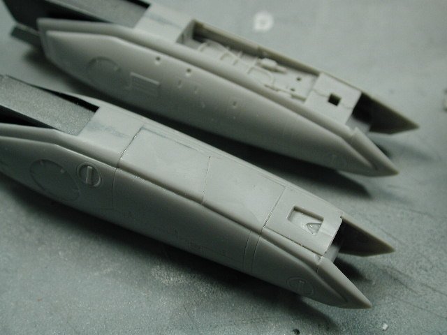

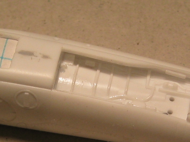

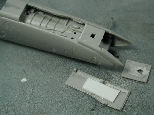

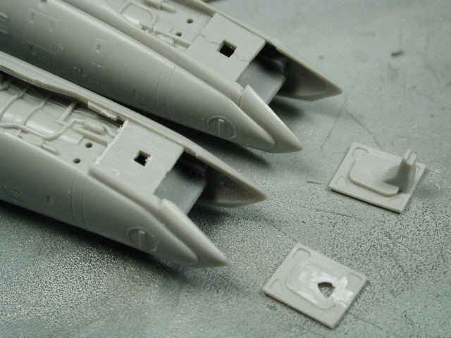

wm cheng Posted March 7, 2004 Posted March 7, 2004 Its too bad the old site isn't up anymore, I've done a step-by-step walk through on the VF-1 for closing the gear doors - I'll just post some pictures here... Quote

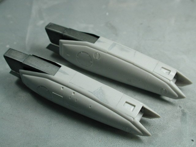

wm cheng Posted March 7, 2004 Posted March 7, 2004 With some putty to help smooth out the contours... Quote
dodgethis Posted March 11, 2004 Posted March 11, 2004 If you fill up the gaps with putty, won't the gaps showing where the bay doors be filled up as well? Quote
The_Major Posted March 11, 2004 Posted March 11, 2004 once you fill the gaps and shim it up. then its pretty easy to go back in and re-scribe the panel lines Quote
