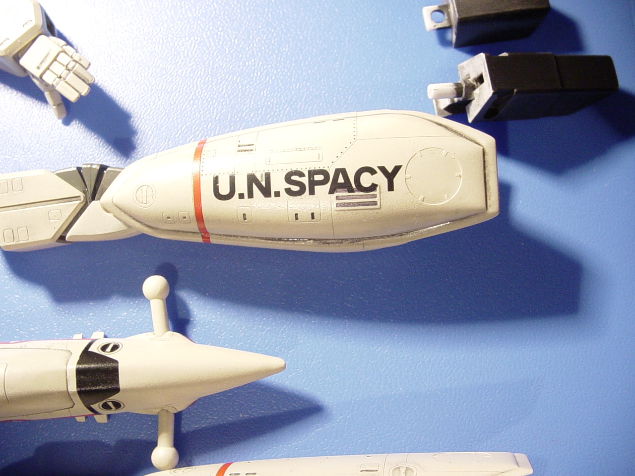

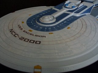

David Hingtgen Posted September 2, 2003 Posted September 2, 2003 Gerwalker--very nice battroid. As for bare finger--not totally bare, covered in microset. Info about my USS Lakota: Ertl kit of course, which is basically an Excelsior with aftermarket parts. (They DON'T fit well, I used 1/8" styrene to fill gaps, not .020 or something). Clear resin replacement planetary sensor dome (clear lights on saucer bottom), replacement impulse crystals (light blue), replacement bussard ramscoops (deep blue), replacement torpedo tubes and launcer, fore and aft, replacement deflector dish (deep blue). Carved out the trench in the deflector dish (missing from the kit), and carved out all the opaque parts to replace the pieces mentioned about. Resin parts here: http://www.federationmodels.com/products/d...dlm/default.htm (quite a ways down for Ent-B parts) Most importantly, I lit it up. There's dozens of wires in the thing, but only 1 resistor. Lit via lightsheet, which is the ACTUAL WARP ENGINE GLOW stuff used for Excelsior class ships on DS9. It's the perfect color, amazing stuff. It's paper thin, but glows as bright as flourescent bulbs, is naturally light blue, doesn't heat up. And easy to wire. Warp engines, ramscoops, and deflector dish have this. Impulse engines and saucer use micro-bulbs, crystals have full-size bulbs run at lower power. (Was going to use LED's, but it was easier to just use bulbs at low power due to how the saucer is wired). I really wished I'd take some pics of the wiring before I sealed it up, the thing is PACKED with electronics. (I had to sand the interior of the warp engines to stuff the wires in---24 vs 26 gauge wire made the difference-it's THAT packed in there). If something truly horrific ever happens to the model, there are quick disconnects from the saucer just above the deflector, and forward of the nacelle mount above the shuttlebay. Anyways---decals are from http://www.thomasmodels.com/. VERY complete, as I said, I didn't paint any blue or grey. (Except for 2 stripes on the pylons). You can order any ship there is (Ent-B and Lakota being the most popular for the Modified Excelsior clas) Windows are decals, (only about 4 per side, I wasn't to cut the clear from hundreds of black dots). THAT was a lot of work to get what is basically a big clear decal with black specs to lay down over the grid pattern of the hull painted flat white. Saucer windows generally in groups of 6. Here's the decals: Quote
David Hingtgen Posted September 2, 2003 Posted September 2, 2003 Only shot I have of the grey (and the ship is dark when not lit up--the warp engines are hand-polished inside and out with buffed transparent blue paint, BTW, they look amazing when the sun hits it--like sapphires) (impulse engines are not buffed, they're too inset to catch the light) Quote
David Hingtgen Posted September 2, 2003 Posted September 2, 2003 (edited) Last pic for now, will post shots of it all lit up later. (.8 amps to light it up, BTW) (might move to a new thread, this is getting OT) (it's REALLY hard to photograph at night lit up---comes out very dark no matter what--trust me, the thing is blazing bright at night, can light up the room--it's not just your standard bulbs, it's flourescent bright---it's actually the same tech used by the Air Force for those bright glowing position light strips on the wingtips and tail) (yes, the underside of the pylon joints are ugly with visible seams---they're not designed to have wires run through them, nor do they fit at all well in the first place--so they are as they are (and most people don't look at the bottom of the pylons anyway)--it's the one place I simply couldn't fill the seams without really messing up detail/wiring) Edited September 2, 2003 by David Hingtgen Quote
wm cheng Posted September 2, 2003 Posted September 2, 2003 Omigod!! It looks great - can't wait to see it lit up. Man I wish we had decals like those 10 years ago - arrgh I had to mask everything back then all the blue patterns were masked - I even created a template in CAD and masked the aztec pattern on the saucer in a different shade as well as different panels for the hull and nacelles for my Excelsior. I drilled out all the windows back then too! Just too crazy - I'll never do that again especially to such a crappy kit! Quote
David Hingtgen Posted September 2, 2003 Posted September 2, 2003 Well, nowadays they make brass templates for the aztec pattern, too. Covers the whole kit--just spray the whole kit white, then apply the templats, and spray your "not white" and you're done. (The trick is getting them all lined up--it's like 16 segments for the saucer). And the Excelsior kit is small/bad enough it's usually not worth it. I've only seen two lit-up aztec-ed Excelsiors ever. (Both were Modified Ent-B styles however, like mine) Unlit: Quote

David Hingtgen Posted September 7, 2003 Posted September 7, 2003 I'll just add that I think one of the most important steps is to PRESS the decal down to squeeze all the air bubbles out. Don't just soak up the excess water, that's not enough. I use paper towels+fingers (soaked in microset) to really rub them down. You practically want to burnish them into the surface (without damaging them, of course). Quote
