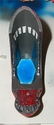

007-vf1 Posted March 1, 2004 Posted March 1, 2004 I use mine for cockpit screens and panels and lighting effects Here's the main panel on the 1/72 Queadlunn-R. there's very little choice left to get an effect like this one.. Quote
