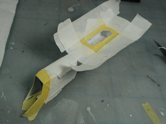

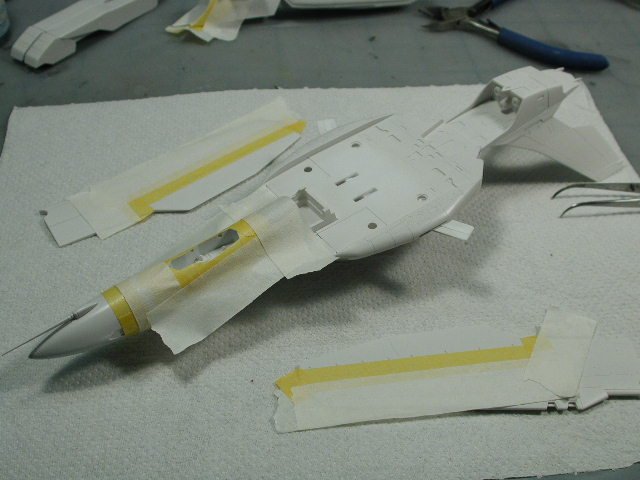

wm cheng Posted April 20, 2004 Author Posted April 20, 2004 I've decided to mask the areas that I will spray gloss white. Quote
wm cheng Posted April 20, 2004 Author Posted April 20, 2004 I'd decided it might be nice to spray the radome and flaps in gloss white too like the old Tomcats, plus it will differentiates the greys on the aircraft. Anywhere where I can liven up the straight white/grey paint scheme would be nice without going against canon art. Quote

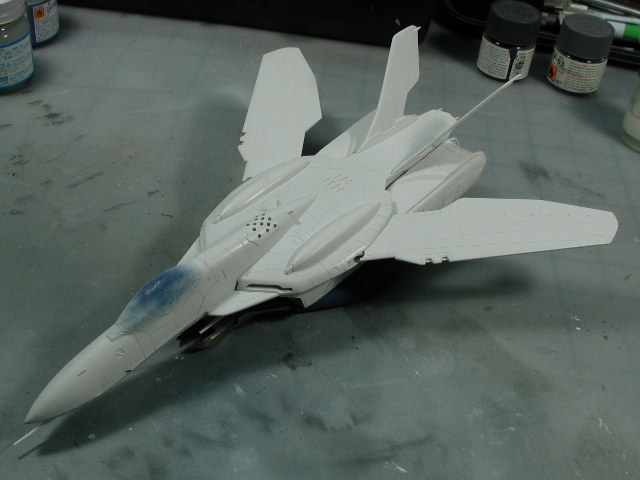

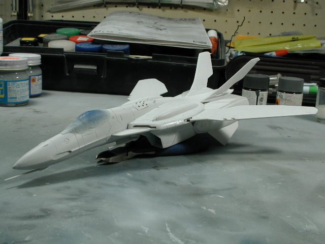

wm cheng Posted April 20, 2004 Author Posted April 20, 2004 Here's a shot after the white spray on all the parts. Must leave to dry - DO NOT FIDDLE WITH IT! This is my most vunerable time - when I start to paint the different colours, and I loose patience and start to mask and handle the plane before the last coat is completely dry. I can't count how many scratches or finger prints I've had to sand off and re-paint over the years! I always try to do this late at night, so I have to go to sleep to let the paint cure. Or find something to do on another part of the model while the paint cures. Quote

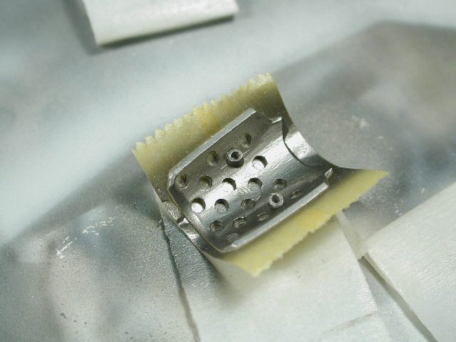

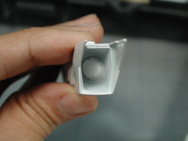

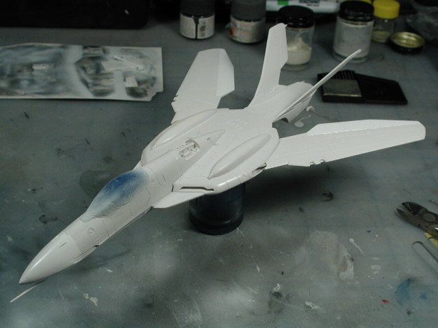

wm cheng Posted April 20, 2004 Author Posted April 20, 2004 Here's a shot of the white interior which looks good against the light grey exterior of the intakes. You can see the original coat of sky grey inside feathered out to the gloss white - this exaggerates the apparent depth of the intake - kind of like painting a shadow. When the top is glued on, and the actual intake falls into shadow - the effect looks better. Quote

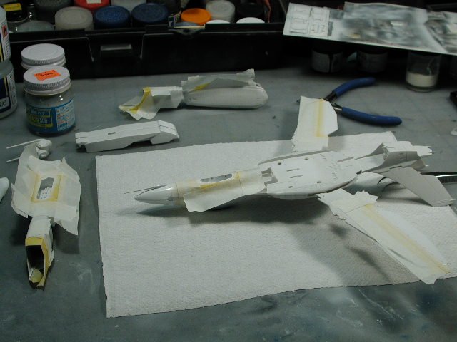

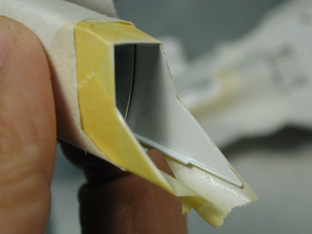

wm cheng Posted April 20, 2004 Author Posted April 20, 2004 Here's a shot of the masking I did around the edges to separate the gloss white interior from the light grey exterior. Quote

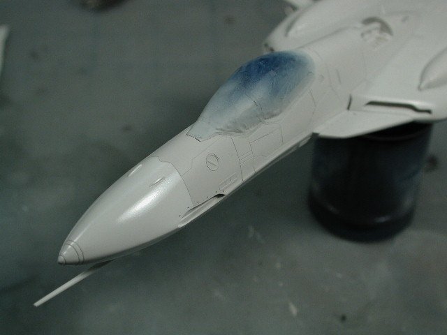

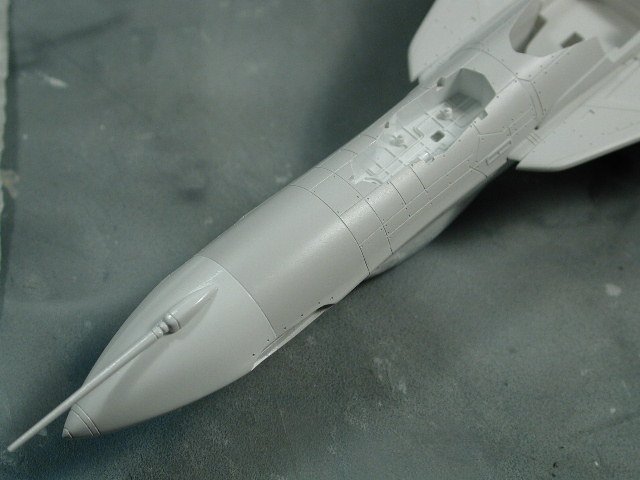

wm cheng Posted April 20, 2004 Author Posted April 20, 2004 A shot of the white nose cone against the light grey body. Quote

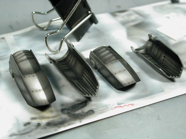

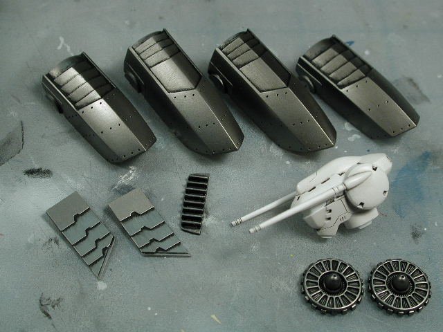

wm cheng Posted April 20, 2004 Author Posted April 20, 2004 I hand painted the rear interior of the legs black. Then I applied a wash of pure black to the metallic objects. I love the head sculpt - its too bad that you will see almost nothing of it when its buried into the fuselage. Its too bad that there was no clear piece for the top of the head which is supposed to have a red light at the front. Quote

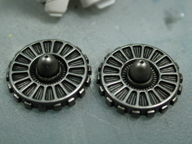

wm cheng Posted April 20, 2004 Author Posted April 20, 2004 I just love the detail on these afterburners !! I hope you can still see them once the feet are on the legs - a black wash really brings out the effort Hasegawa puts into them. Ok, must leave the model to dry for the time being. I might assemble the landing gears to prep them for a spray of gloss white too. (in case you're wondering why I have time to work on this during the week - my film production went down and I got laid off again so its time to hunt for work again - at least I can devote more time to this baby and update more regularly) Quote
David Hingtgen Posted April 20, 2004 Posted April 20, 2004 I *love* those afterburners. I just painted my SR-71's burners last night, but you can't really do much on a Blackbird, being ceramic white and all--no metal paint there! (Though I did drybrush some steel, for that "blasted porcelain" look) Anyways---the white paint helps a LOT IMHO. You can't really tell it's overall grey without out it. Yes, it's Tomcat-esque (and the pureness of the white makes the grey look warm, rather than cool, IMHO---even more Tomcat-esque). However, with that white nose, it instantly reminded me of the standard Su-24 scheme. (one of my fave Russian schemes) See here: (Bad pic, but all the good ones are 150K plus--but this shows the pale grey w/white nose well enough) Quote
wm cheng Posted April 20, 2004 Author Posted April 20, 2004 Hey a tip, Don't do a black artist oil wash over anything painted with the silver chrome Tamiya Markers. I just did that to the intake fans, and the Varsol in the thinned down oil paints ate away at the Tamiya silver and I got a mucky mess. Luckily I cleaned it up and plan on sealing it first next time. Hey any takes on different glues - what about you David? Cool pic of that old SU-24 - you're right, you don't really realize its grey until you get a pure white next to it. Hey I didn't know the tailcones on the SR-71 are ceramic and are white, cool, lets see some pictures. Quote

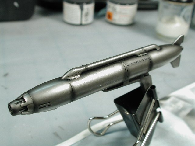

wm cheng Posted April 21, 2004 Author Posted April 21, 2004 Here's the gun pod with a bit of shading. Quote

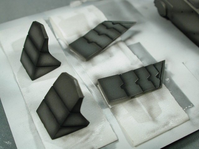

wm cheng Posted April 21, 2004 Author Posted April 21, 2004 (edited) Here's the intake vanes, I've tried to bend the ends up slightly, and I am going to glue them in at a slight downward angle like the F-14 excess bleed ramps in the intakes, plus it will partially obscure the fans and the interior of the intakes. The back of the knees are shaded now, but you really don't see much of them once the legs are glued in place. I've given the entire thing a coat of ModelMaster Clear-coat of semi-gloss mixed with gloss finish to seal in the paint so far (letting it dry overnight), so I can do an oil wash tomorrow and hopefully some post-shading. Edited April 21, 2004 by wm cheng Quote

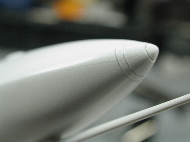

wm cheng Posted April 21, 2004 Author Posted April 21, 2004 AARRGHH! Wha, what happened, it looks like the clear-coat shrank and peeled away from the gloss white undercoat leaving this crack I don't know exactly what happened, I'd guess I laid the clear-coat on too thick and maybe the undercoat wasn't completely dried yet? Man I hate it when this happens, I am going to try to very gently sand the clear coat down with 2000 grit sanding film (I hope the crack doesn't extend down to the plastic) to eliminate the crack and will have to put the white gloss over it again and a careful light clear coat. Quote

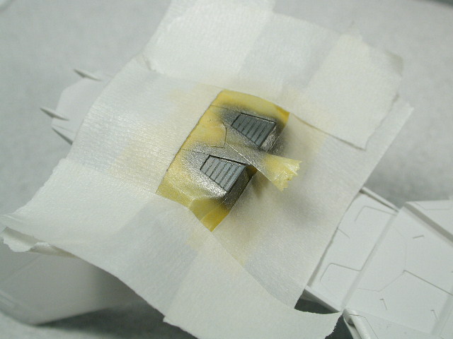

wm cheng Posted April 21, 2004 Author Posted April 21, 2004 In the meanwhile, I am masking all the steel parts on the fuselage. Quote
wm cheng Posted April 21, 2004 Author Posted April 21, 2004 Again, I am using this Alclad steel metalizer stuff - the tape protects the light grey/white on the exterior. Doing it in this order, exterior paint first, then interior metallics will bring the steel colour up to the light grey creating the illusion that the metal is thinner. Quote
