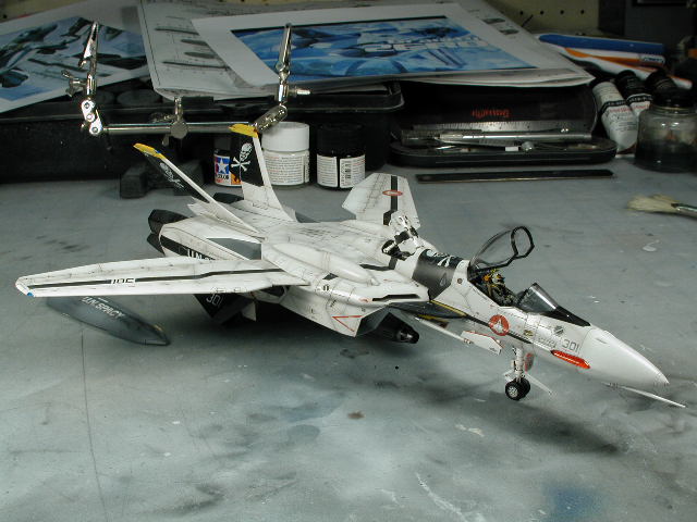

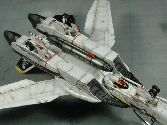

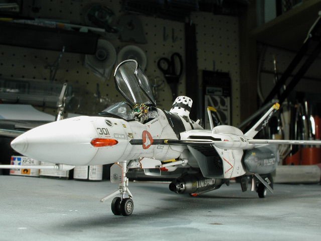

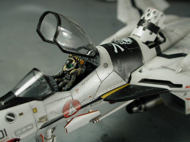

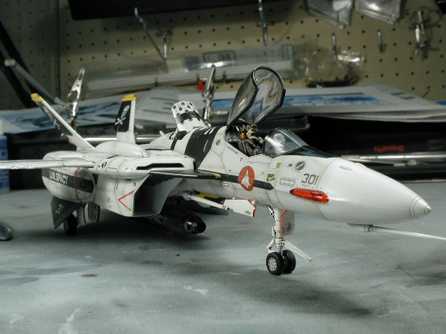

wm cheng Posted May 8, 2004 Author Posted May 8, 2004 Hey everybody, finally finished!! Woohoo That's a rather long explaination tetsujin - thanks, but some diagrams or pictures would be more helpful Actually, what would be better is if you can make a few tiny double hinges - I would be glad to buy them off you (seriously though). I think it will be a while before I can graduate to building small canopy hinges - I think metal is the way to go for such a small scale, but I don't have a proper machine shop yet. I am just looking for a double jointed hinge 1/16" wide by 1/8" long - is that so hard?! Thanks for the tips on the wheels, I did sand them down a bit and it looks good (at least I am happy with them). As I feared, the sanded down surface isn't perfectly flat, but close enough. I don't tend to use the melting method on jet aircraft, like David has said before, the low PSI tires may bulge on older WWII prop aircraft (that may land on fields), but newer jets are high PSI tires and do not bulge appreciably when the plane sits on them. They do flatten out a bit though - see how you guys like my interpretation of it on the VF-0. Here's a series of shot I took on the work bench for now to close off this thread. I will post better pictures to the Model thread (higher traffic ) as before when I get a nice sunny day around here. Quote

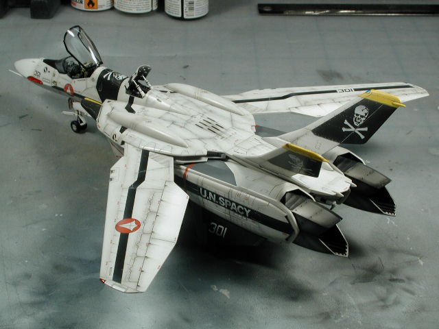

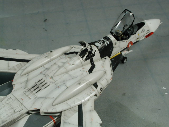

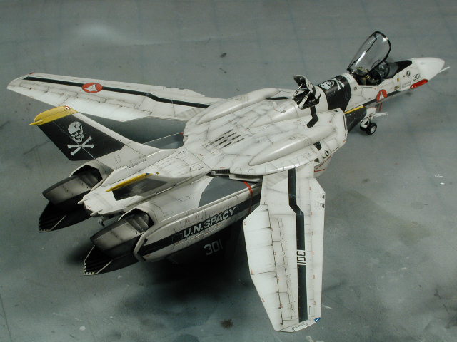

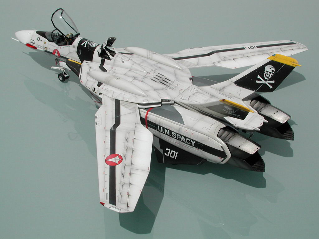

wm cheng Posted May 8, 2004 Author Posted May 8, 2004 Detail shot of the back weathering which I am most proud of. Quote

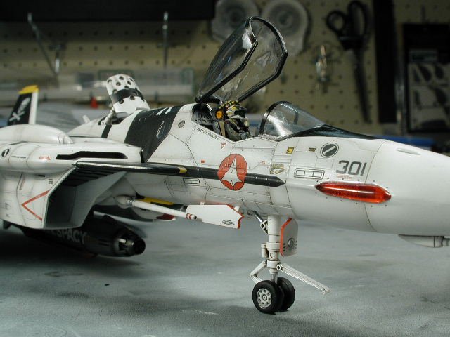

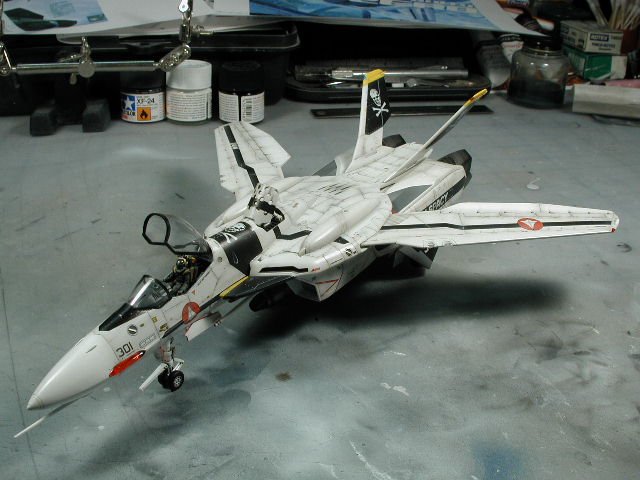

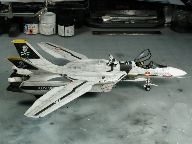

wm cheng Posted May 8, 2004 Author Posted May 8, 2004 (edited) Ground crew view with the packs on. Let's see... parting tips: don't glue the front pilots tube till the very end (you will snap it off otherwise ), Decal the lower ventral fins (grey & black) at the end, since the plane rests on these fins most of the time - before the gears are glued on - the grey tips will rub off and you need to touch them up. Can't wait for the VF-0D or a low-viz fodder to come out - will do that one with the gears up. Its so much bigger than the VF-1, they look out of scale when placed next to each other - hmm, kind of like a 1/72 next to a 1/100. I'll post some shots of the flight line up soon. I would like to say again a big thank you to Myersjessee for sending me this kit - It was an unexpected surprise and I really appreciate it. Also I am most grateful for David H.'s expertise in aircraft - thanks for all the ideas and reference materials. Also thank you all for following along and providing input and feedback - it really made this model better than I could of done by myself (thanks Shawn & Graham for making this possible). I know... I can hear the music start up... - just 30 more seconds... Hasegawa really out done themselves this time - I think its their most detailed best kit yet. Come on, lets see everyone's VF-0 soon! Hey, any model contests comming up soon Wow, its been a long ride (with working in the middle there) - I'd really appreciate it if someone would edit this thread and turn it into a PDF file for me. Its too bad I lost some of the older threads on the old boards. Edited May 9, 2004 by wm cheng Quote
Nani?! Posted May 9, 2004 Posted May 9, 2004 sniff* God, it's perfect. your best so far William. Quote

J A Dare Posted May 9, 2004 Posted May 9, 2004 Detail shot of the back weathering which I am most proud of. I love this view so much.... The weathering streaks behind the vents. The wing sweep weathering lines. The airbreak metal struts. The panel & rivet fading on the black. etc. Those little bitty details and the rest, make it more than just a model. A masterpiece. Bravo! Quote
Myersjessee Posted May 9, 2004 Posted May 9, 2004 Wow...Im in tears! I just dragged my son over...I shall now quote him: "OH! ....WOW! ....MAN!!! ..THATS JUST COOL! ....IT LOOKS REAL! " Gorgeous work WM! My thanks for sharing the construction and the results. I hope you are enjoying it. Please pass on our thanks to your wife for sharing your time as well! Quote
Brianw76 Posted May 9, 2004 Posted May 9, 2004 man, the detail on that thing is amazing. i love how you added the dirt to the wings where they sweap back. bad ass! Quote

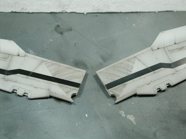

newca Posted May 10, 2004 Posted May 10, 2004 (edited) impressive as usual! one small question, should the bottom of wing has those "dirty area" also? Edited May 10, 2004 by newca Quote
David Hingtgen Posted May 10, 2004 Posted May 10, 2004 (edited) The underside does get wear, but very subtle, and not "streaked". Not really visible unless it's a VERY worn wing. (As in, the upper surface has flat-out BLACK STRIPES for wear--then the bottom would be worn enough to be readily apparent) The sealing surfaces are completely different for upper vs lower surfaces on that style of wing-sweep seal. The upper surface is many small metal plates, the lower is a single large inflatable bladder---they cause very different effects. The lower seal is the large dark grey area just aft of the wings. It's basically a very heavy-duty inflatable balloon. (Just going by F-14's, but the VF-0 has the most "F-14-esque" wing-sweep area of any VF by far--which is why I suggested it be done in the first place) Edited May 10, 2004 by David Hingtgen Quote
