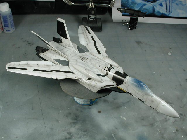

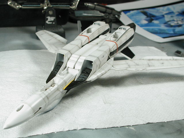

wm cheng Posted April 26, 2004 Author Posted April 26, 2004 Wooohoo! decalling stage - my next favourite step These decals are quite thin, compared to the other Hasegawa stuff. They are very good, but I was kind of used to the other stuff and lathered on the MicroSET liberally and was a bit rough with them, as a result, I ripped a few here and there before I got the hang of the new thinness of these decals. They are great, don't get me wrong, just a little thinner than I was used to from Hasegawa. They are also a bit over sized - I'm not sure whether they are actually oversized or that in combination with the MicroSET softening them and being thinner, that they stretched a little bit. As you can see here at the legs, the black stripe is supposed to end at the knees but there should be some white showing on the lower bulkhead - the black is only supposed to be on the part that bulges out. I already had too much MicroSET on them to neatly trim off the excess length, so I just kept them as clean as I could, luckily the profile of the black stripe matches the knee portion perfectly so to the "undecerning" eye it looks intentional. Unfortunately the photo doesn't show all the little details that must telegraph through these black stripes. I used a bit of MicroSOL on the panel lines and those triangular recesses near the knees to get them to show through the decals properly. I think the next time I do this, I might just mask and paint the black stripes on the legs - its a pretty easy shape and all the details will show through. I chose to decal this first since I want to glue the legs onto the fuselage as soon as possible (just anxious). I will probably omit the numerious warning stencils on the inside of these legs (keep them as spares for my decal box) since they are totally obscured when the legs are attached. The ones that do show are still accessible after the legs are glued in. Quote
wm cheng Posted April 26, 2004 Author Posted April 26, 2004 I thought I'd do all the big black areas first. Quote
wm cheng Posted April 26, 2004 Author Posted April 26, 2004 I love the fact that Hasegawa has thoughtfully provided so much of the black markings that otherwise would be another few days of masking. I finally glued the legs in!! I love how this plane looks! Its a shame I have to put landing gears on it and ruin the sleekness - oh well, I just might have to build another one with the gears up. Quote
wm cheng Posted April 26, 2004 Author Posted April 26, 2004 Here's a parting shot - maybe some more decalling tonight... Quote

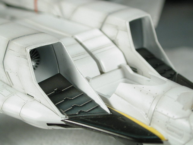

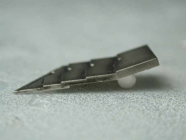

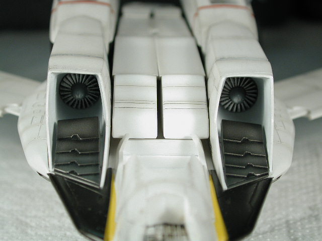

wm cheng Posted April 27, 2004 Author Posted April 27, 2004 I wanted to glue all those loose parts lying around on to the bird as soon as possible - I just know they'd be lost soon - plus I'm impatient I thought it might be cool to angle the intakes like the F-14 intake ramps a bit and partially obscure the intake spinners. What I didn't really like on the YF-19 was how flat these intake covers look when glued right up against the top of the intakes. So I bent the last segment of the cover up a bit (careful, you don't want to snap it off, just a bit) and I glued a cut-off piece of sprue underneath it to wedge it up a bit. Quote
wm cheng Posted April 27, 2004 Author Posted April 27, 2004 So now they look like a moveable piece. I wasn't anal enough to extend the width of the intake covers to both ends to meet the walls of the intake - but it just looks like something that moves in the intakes (artistic licence ) Quote
wm cheng Posted April 27, 2004 Author Posted April 27, 2004 Not huge difference, but I like it. Quote

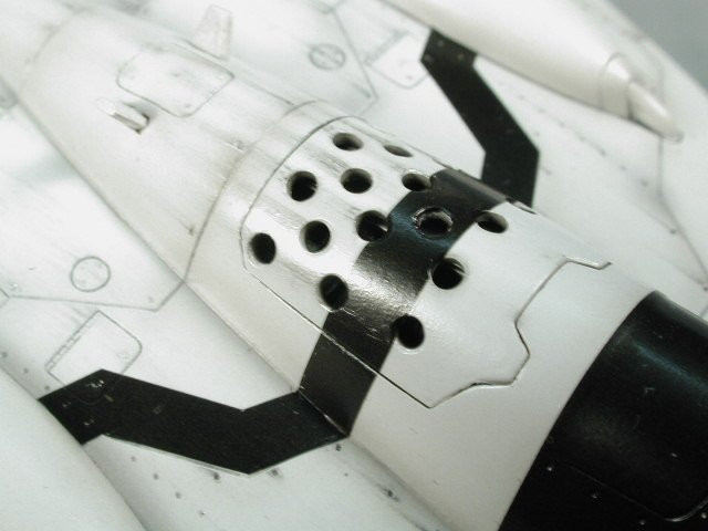

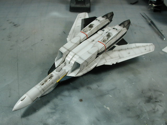

wm cheng Posted April 27, 2004 Author Posted April 27, 2004 Here's a close up of the airbrake, its easier to weather with it in place and decal it so that they all recieve the proper placement. I just decalled right over the holes - then when its semi-dry, I dabbed some MicroSOL right over the holes, and the perimeter decal just kind of "melted" right into the holes. Just the center hold remained, but a few more drops of MicroSOL, and a little encouragment from a small brush and the center hole gave way. Quote

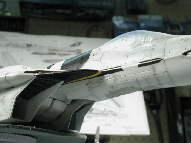

wm cheng Posted April 27, 2004 Author Posted April 27, 2004 Now here's a delema, and I still don't know which way to go if I were to do it again. These side stripes on the forward fuselage have two very fine black line tails that goes back towards the intakes - a shorter one above the black and yellow LEX/canards and a longer one under. Man were they a bitch to get on straight. The thin decals kept curling and going all over the place. It took 20mins each to get them in place properly (DO NOT USE ANY MicroSET or SOL on this) use tons of water to allow yourself plenty of play time to get these suckers in place. Now if the fuselage was not glued in, and was a separate piece, then it would be a piece of cake to get them positioned correctly without the intakes, chestpiece or LEX/canards in the way. But if the forward fuselage section did not mate with the main fuselage perfectly - then there would be really no real way to fill and sand this joint - since it would already be painted and decalled. The VF-1s mated perfectly - this kit doesn't, I may have glued my LEX/canards in at a slightly wrong angle, but I can't see a way to get the perfect angle. Anyways, I don't know which is the proper order of construction for this piece - again its six or one half dozen - but it worked out this way for me, just 40 minutes of holding my breath Quote
wm cheng Posted April 27, 2004 Author Posted April 27, 2004 Well... here we are tonight before I go to sleep. Nighty night VF-0, dry well without my medlesome hands and fingerprints all over you. Till tomorrow... Quote

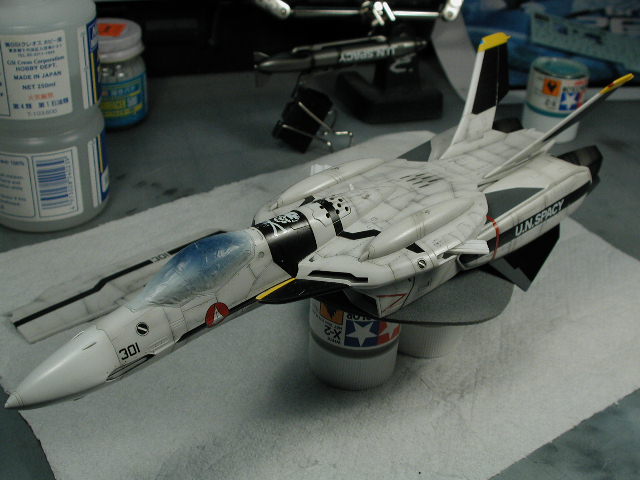

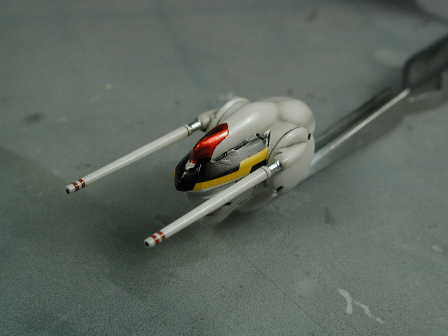

wm cheng Posted April 29, 2004 Author Posted April 29, 2004 Just more decalling... man are there ever a lot. Here's the head. I brushed the Tamiya chrome marker silver on the head light piece first, then brushed Tamiya clear red over it, it makes it catch the light a bit better than just clear red - it would of been nice if there was a clear part made for this. The black and yellow decal doesn't fit quite right - luckily this is the only piece that doesn't fit well, as I have mentioned before some of the other pieces are a bit oversized, but this piece is a bit undersized. Well its in the belly of the aircraft anyways, so I made sure the top of the head was aligned, which left a little white gap near the visor. I used a lot of MicroSET to get it to conform to all the irregular surfaces. Unfortunately, a excess piece of carrier film that I trimed away made it under the decal in this one spot, and I didn't notice it until it dried. When it catches the light in a certain way, you can just see it in the photo - oh well... no biggie. Quote

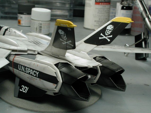

wm cheng Posted April 29, 2004 Author Posted April 29, 2004 Here's a progress shot with a few more decals on. I really love the yellow V.Stab tips, they fit like a glove. I recommend painting the nav lights silver first, then a clear red and blue. Then decal the yellow tips one side per fin first. The decal cleans up any mess painting the nav lights would of done - since the yellow will hide and make the red/blue areas perfectly straight. Doing one side of each fin, allows you to properly fold over the excess yellow to the other side. I used a lot of MicroSET first to soften up the decal and allow it to fold over properly. Then when most of the SET is semi-evapourated, but the decal is still soft and moist, I brush on MicroSOL along the edges (fold-over) panel lines/revits and the rear little antenna protrusion. Let it wrinkle up (DO NOT TOUCH AT THIS POINT) the wrinkles will dissappear when the SOL sets. Once one side is completely dry, then do the other side allowing the decal to fold-over the fin to connect up with the previous side. I find this is the best way to decal these two side conditions where the colour must wrap around to the other side. I love it, my only comment is the night formation lights on the tips do not line up exactly to the decals (no biggie) and the black fins are a little large, so if you line them up to the lower panel line on the V.stab, then they fall past the upper panel line by a smidge (which is what I did) but the yellow decal placed afterwards do straighten up this mis-alignment, however if you look very closely, you can make out the black underneath the yellow. Quote

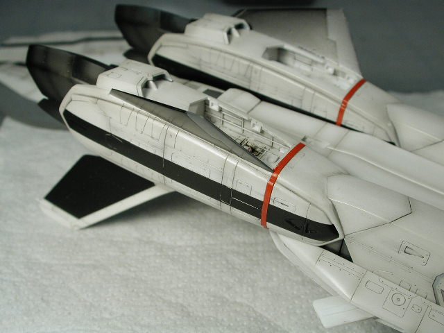

wm cheng Posted May 5, 2004 Author Posted May 5, 2004 Here's a shot of the tail decals in place - becareful to make sure you press the decals into the light engraved details, since those details has to read through at least two layers of decal. Quote
