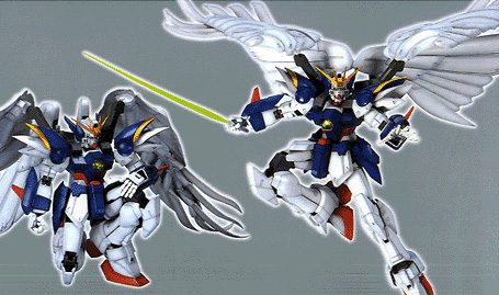

Ioda Posted February 26, 2004 Posted February 26, 2004 I'm working on the Perfect grade Wing 0 Gundam, but before you blast me for it not being Macross related, I'm not interested in views on the kit. What I need help with is getting the really rich Gold/Yellow paint that shows up on the shoulders and head of the Gundam. Has anyone found a good smooth gold paint that I can use without having an airbrush? Everything I've seen/used has been pretty flecked. Thanks. Quote

gnollman Posted February 26, 2004 Posted February 26, 2004 (edited) If you don't want to go the foil route, much as I hate to support anything Games Workshop, the Citadel paint gold colors are very nice.... two to choose from, one is shinier than the other.... Looking at that picture, I'd say that the Burnished Gold is the shade you'll want. Edited February 26, 2004 by gnollman Quote
