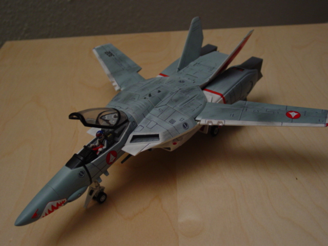

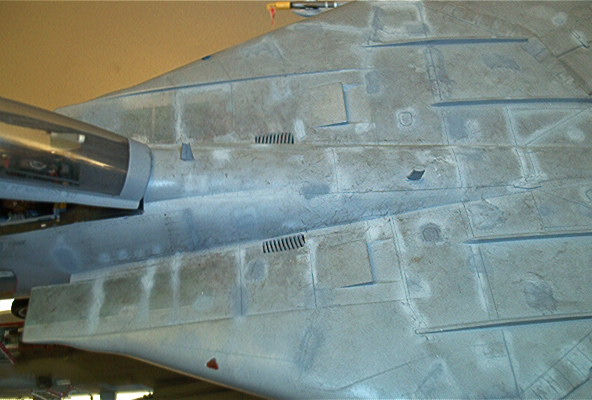

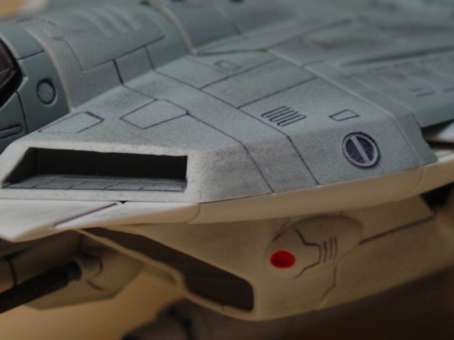

captain america Posted March 18, 2004 Posted March 18, 2004 I've seen the Max Wantabe pre-shading technique discussed earlier in the thread, and I just wanted to say that there are better ways of creating a weathered look that is infinitely more realistic. All you really need are acrylic paints, a good airbrish, some chalk pastels ( cheap ones are great) and a few Q-tips. You simply paint & decal your model as normal. No pre-shading or nonsense of that sort necessary. Once you're done, apply a flat clear overcoat and let dry. Now the fun begins... You take your airbrush ( a very fine spraying ability is necessary) and spray a slightly darker or lighter shade of the base coat, but in small, carefully-controlled patchwork shapes. You must absolutely be using flat paints for this. Once these small patches are dry, take a black or brown stick of chalk pastel & over a small shallow dish, gently scrape-off some of the chalk with a sharp hobby knife until you have a small pile of chalk powder. Now, take a Q-tip and swirl it into the chalk powder sparingly, being sure to wipe off the excess, and then rub the Q-tip gently in random areas to create a dirty look. A stippling motion works best, and don't worry: if you apply too much, just blow it off and start over. once you've covered all the desired areas with the chalk, proceed to re-airbrush some different colored patchwork over this to make your mecha look like it's been maintained/repaired. This technique mostly replicates the look of naval aircraft which have a worn & repaired look to them... Probably similar to what a Valkyrie would look like in service The pic below shows the technique applied tol a 1/48 Tomcat.
Neova Posted March 18, 2004 Posted March 18, 2004 John, That weathering looks FANTASTIC! I would love to see Roy's VF-0S at "veteran" status with that weathering! When you have time, can you do a step by step perhaps? Us model newbs need all the hand holding we can get! Keep it up!
