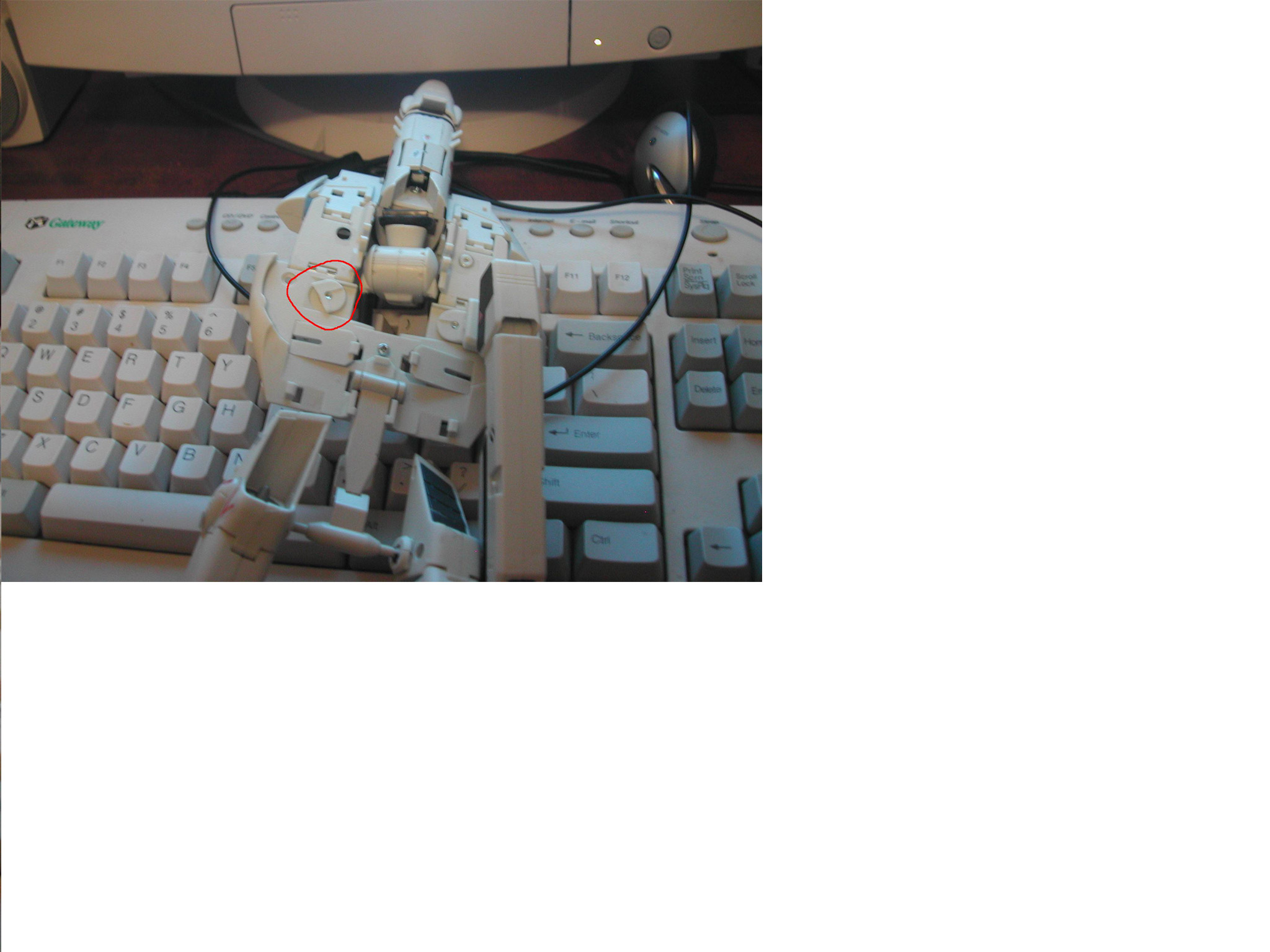

seventh-moon Posted February 18, 2004 Author Posted February 18, 2004 (edited) the broke area is circled in red. do you need pictures of the arm to? Edited February 18, 2004 by seventh-moon Quote

Mechamaniac Posted February 18, 2004 Posted February 18, 2004 Every time I transformed my 1/48 Hikaru 1A, I thought that tab was going to snap, it is an unfortunate weak point, and I'm surprised that more of these haven't broken. Quote
seventh-moon Posted February 18, 2004 Author Posted February 18, 2004 ill try to find a glue that might work, but if i dont im going to have to get on the horn with hlj. i cant afford a new one. the cause of this was a very very nasty fall in mid transformation. Quote
Eternal_D Posted February 18, 2004 Posted February 18, 2004 wow, that piece definitely looks tough to fix. my suggestion is........wait till Sebastian goes home to take a look at his valk, and tell you the same thing. but seriously, doesn't look like any type of simple glueing will solve that problem. you may be able to reinforce the two broken halves with cut piece of styrene. but if you do a lot of transformation, I don't think it'll hold up too well. Quote

Graham Posted February 18, 2004 Posted February 18, 2004 Hmm....first time ever I've seen that part break on a 1/48, strange! Need to check is it actually screwed or rivited in place as well. If it's rivited in place, you'd probably need to get a whole replacement backplate assembly. I wish people would stop calling the 1/48s fragile though. IMO, they are pretty tough toys, with the exception of part # BP8, which even I admit is too fragile and needs to be handled with care. The only parts I've ever heard of breaking on a 1/48 are several backpack hinges (part #BP8), a couple of head lasers, but that's usually through carelessness and I think on one or two occasions the canopy hinge. But considering the total quantities produced, there has been little to complain about generally. Still, it does suck though when something does break on such an expensive toy. Graham Quote
KingNor Posted February 18, 2004 Posted February 18, 2004 (edited) if you're going to glue it: go to an autoparts store, get JB weld, it takes a night to dry but when it does its hard like a rock and strong as all hell. **edit** practice on something first, its a little difficult to use, but its good stuff. good luck. Edited February 18, 2004 by KingNor Quote

soze Posted February 18, 2004 Posted February 18, 2004 Don't know if it's possible, but can you sand down the flat underside a bit... so it's a little thinner and put the pieces together and use a thin strip of metal for a brace? Like a thin strip of metal on the underside where you would have sanded it down, only you are using it to hold the broken piece together (with glue of course). Basically putting the 2 pieces together onto a thin metal plate and gluing it. Quote

Göönk Posted February 18, 2004 Posted February 18, 2004 (edited) If my valk break at that point, i will build a new piece out of aluminium sheet. I'm sure it's possible to do something correct and easily. If you look closely, you can see it can be thicker than the 2 mm near the arm hinge which allows the holes for the axe of the arm. Where can you fond aluminium? I don't know. try to look around your house for material. Then build. Then nobody will notice that it's custom made because it's under the valk in fighter/gerwalk mod or inside in battroid mod. [EDIT] LOL I found a piece of aluminium that would be PERFECT for this surgery in less than 2 minutes. The holes for the hinge may be difficulte to drill, i admit, but with patience and good tools it's possible. Edited February 18, 2004 by Göönk Quote

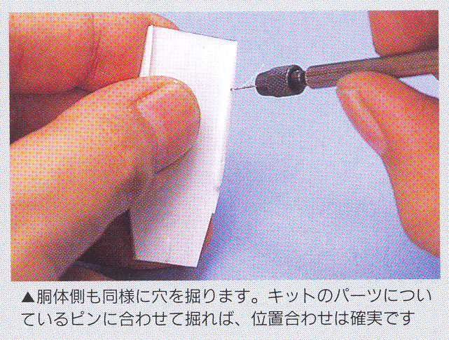

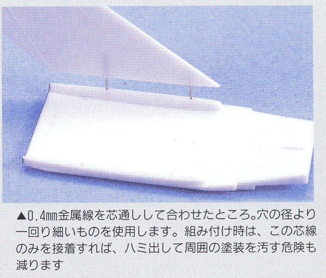

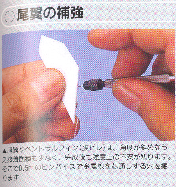

柿崎速雄 Posted February 20, 2004 Posted February 20, 2004 (edited) hope this can help you : no too difficult method but must buy some tools 1.)buy modeling drill , which can use a very little drill head for thin prastic broad 2.)buy some thin metal rod the most difficult part is drill the very accurate grip for each little hold between the two parts I suggest use a ruler and ink pen to mark the grip first than drill it carefully than use the metal rod to join the two parts don't forget to use the super glue ~ here is some demo pic for you I think this method is suitable for your case (and sorry for my poor english ) Edited February 20, 2004 by 柿崎速雄 Quote
柿崎速雄 Posted February 20, 2004 Posted February 20, 2004 (edited) 2. ( I think you can drill 3 to 4 hole for each parts to get a stronger bonding) Edited February 20, 2004 by 柿崎速雄 Quote
Stamen0083 Posted February 20, 2004 Posted February 20, 2004 It looks like you might be crap out of luck if you have never modded anything in your life, but if you have used hand tools, you will be able to get through this. Drill and pin. It looks like that part leaves just about enough room for a pin. Drill and pin it, then use superglue to join the pieces. Just make sure they match. If you have a hobby shop nearby, you can also buy some aluminum sheet, which you can cut and shape into that part. All you have to do is drill holes for the screw to go into. Quote
