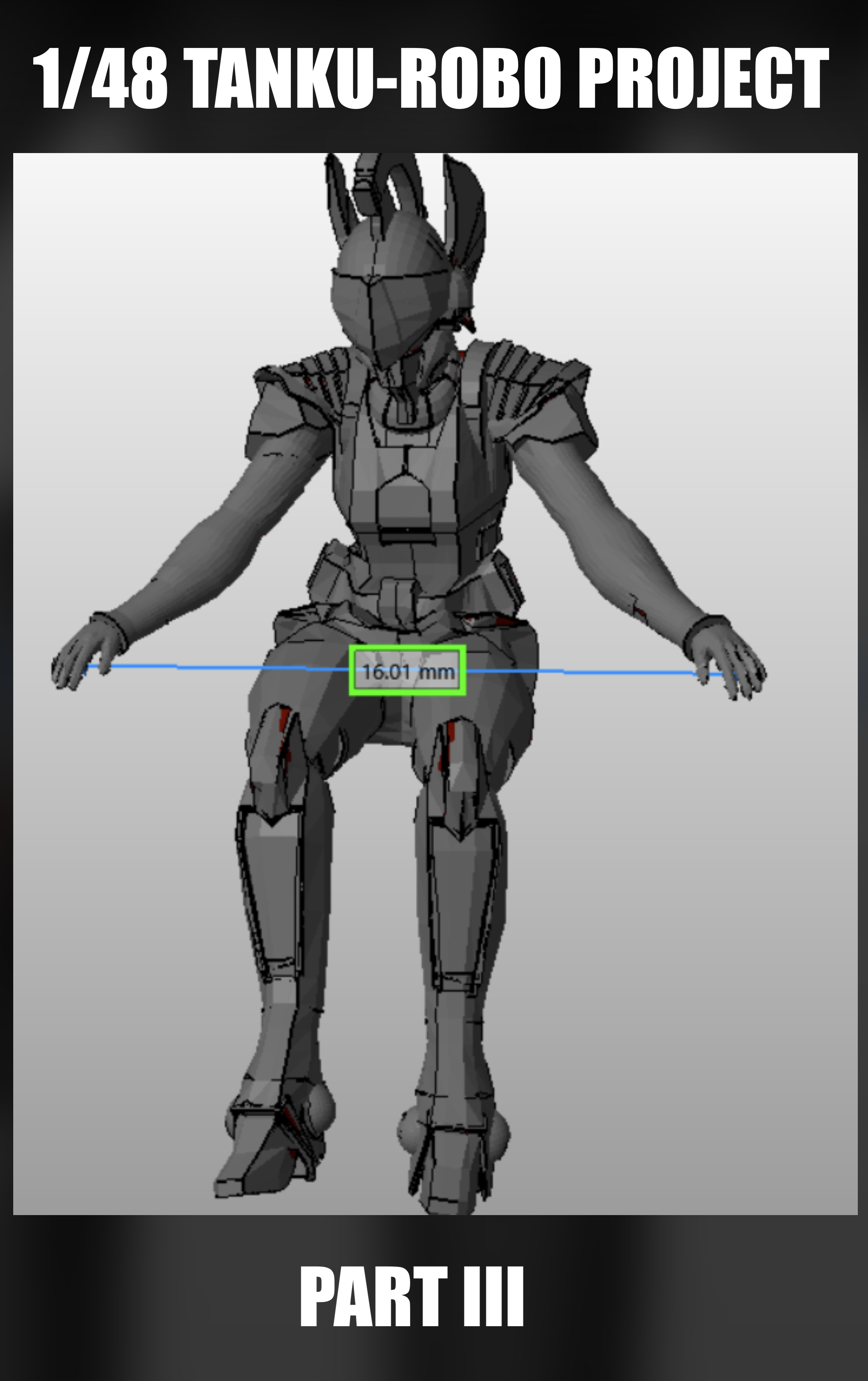

captain america Posted May 9, 2024 Author Posted May 9, 2024 Captain's log: Thursday, May 9th, 2024. I'll start this week's update with a quick image of the pilot figure (pic 27A), currently undergoing a serious 3D overhaul, courtesy of Carlos P. While Ted had pointed us to a pre-existing file, the file was probably intended to be much larger, owing to the fact that the creator had made the figure hollow—presumably to save on material when printing—the end result being a figure which is paper-thin in 1/48 scale, and as such requires a complete redo! The main mecha itself is coming along quite nicely! Pics 27 and 28 show the leg, and all the complex engineering which is going into it. The shin-guard holder is made collapsible, which will allow Transport mode to sit flatter without sacrificing the look in robot mode. What may not be immediately evident is how painstaking it is to create all these sharp angles on the lower leg armor. The parts are small, and one wrong swipe with the sanding block would mean at least an hour of puttying and refinishing. I will wait to show you all the range of motion when the parts are further along. Pics 29-31 (inclusive) show the arm, which is another wonderful clusterscrew. I'm talking specifically about the elbow. The good: I was able to retain a swivel at the shoulder, and reasonably good range of motion so it'll be able to hold its rifle up, though the joint itself may end up being rather fragile. Quote

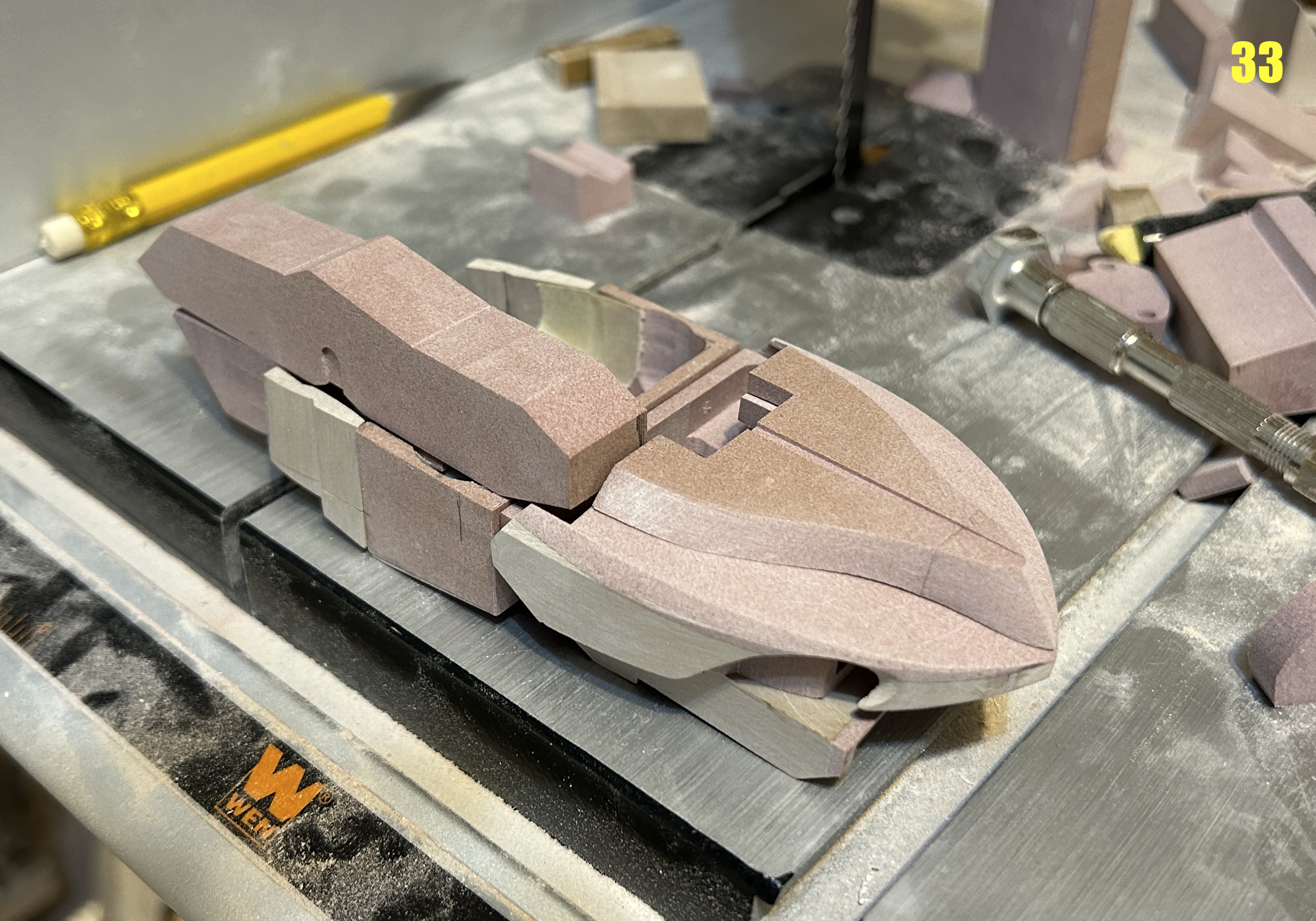

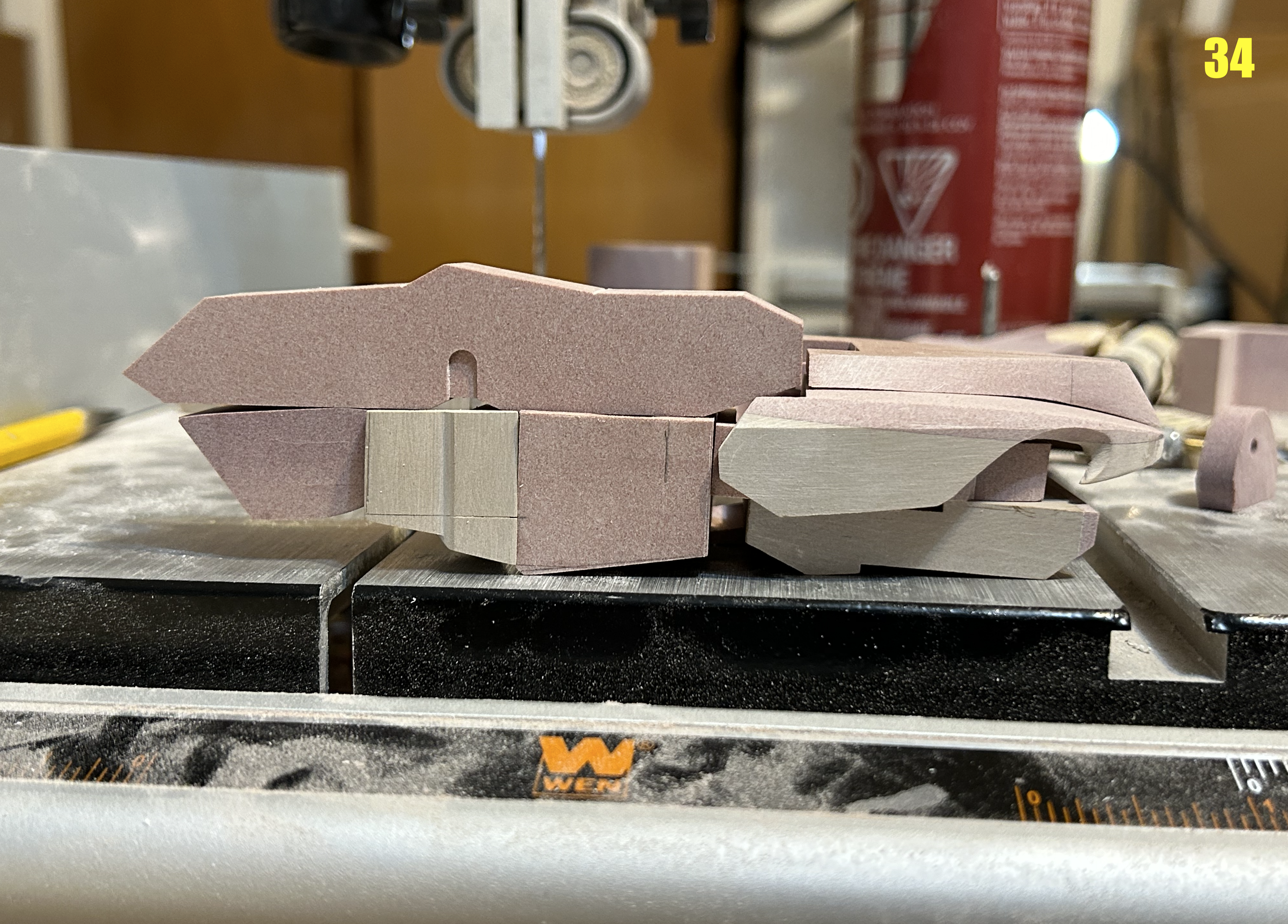

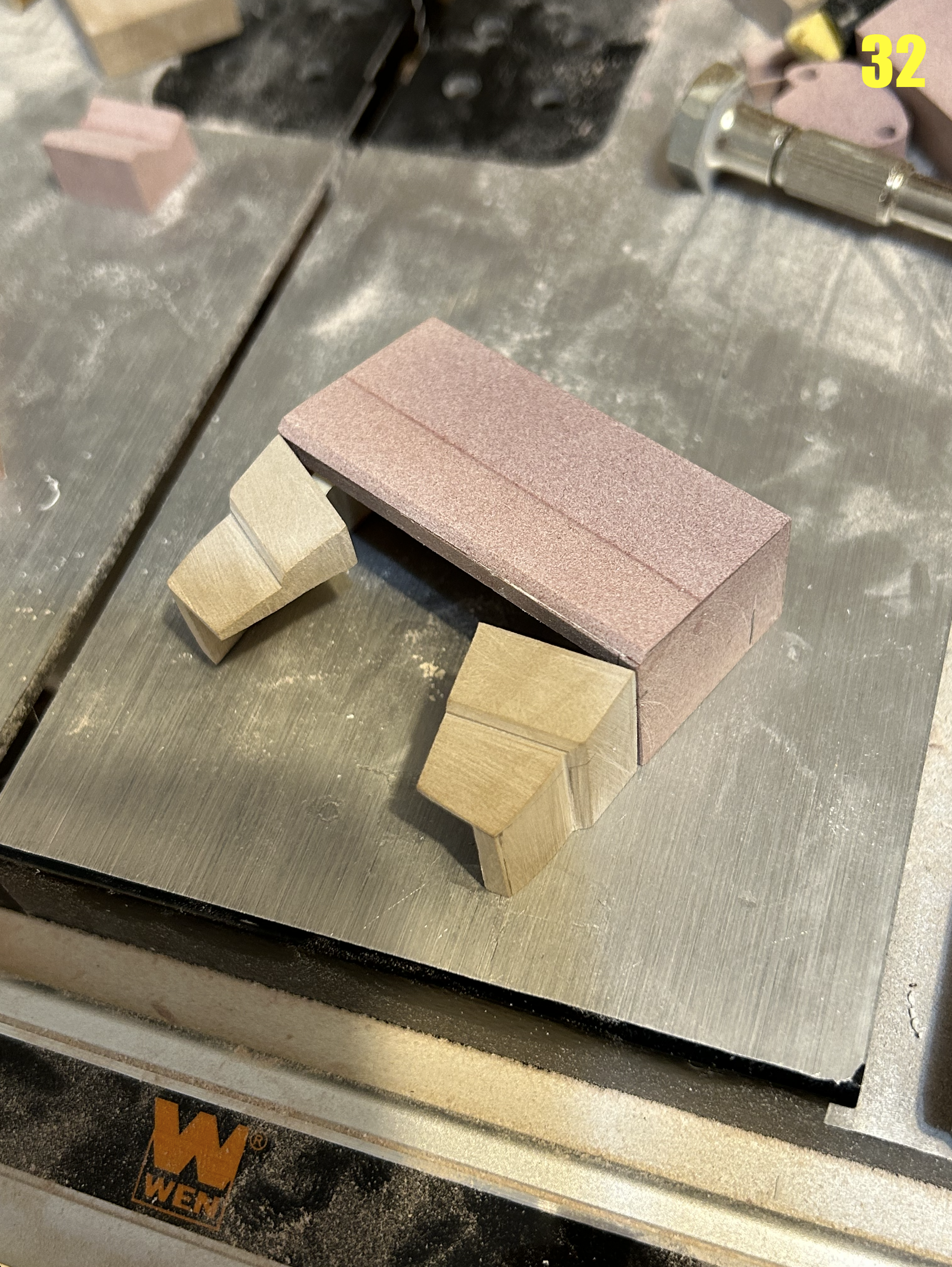

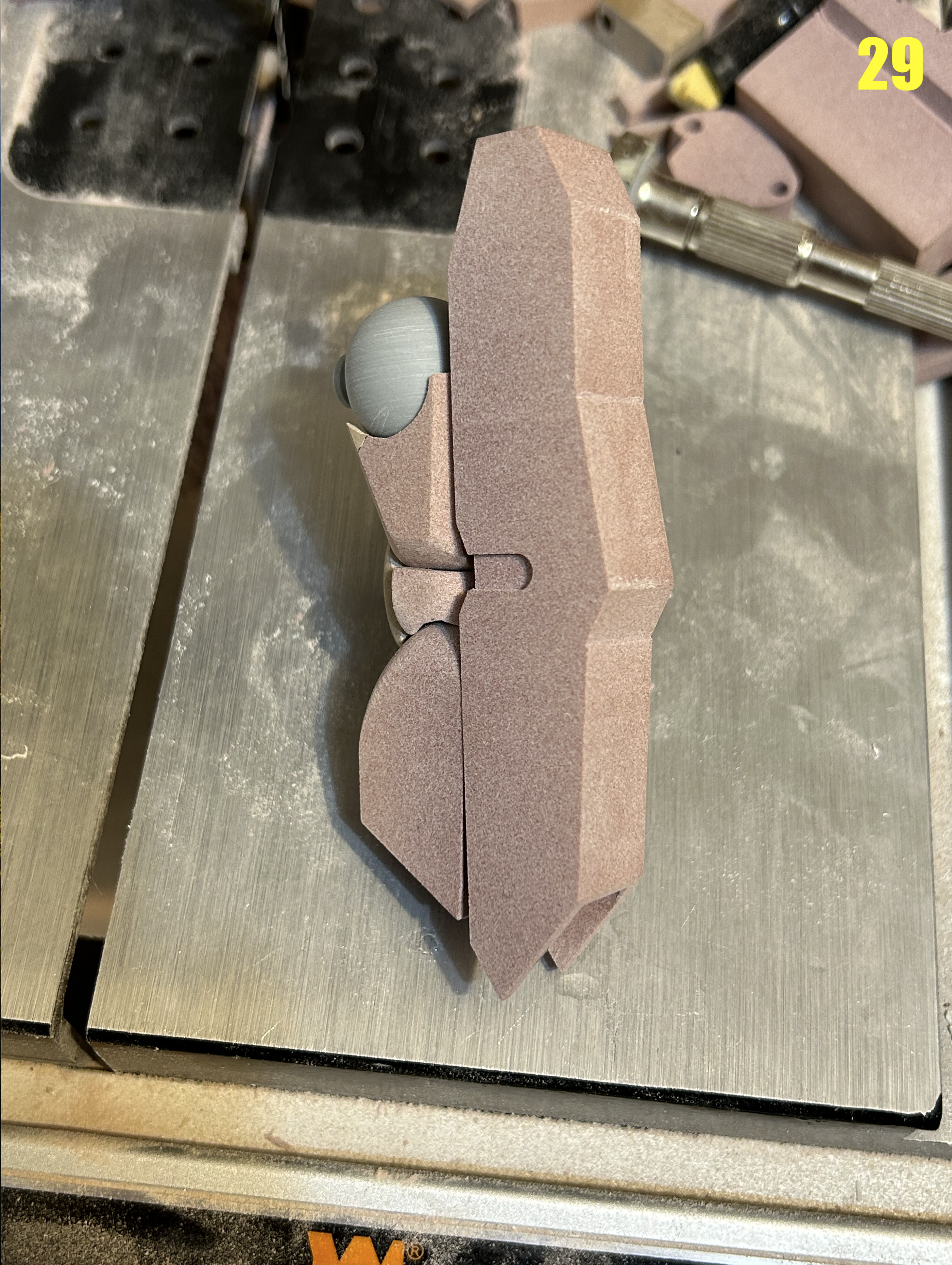

captain america Posted May 9, 2024 Author Posted May 9, 2024 (edited) Pic 32: in order to allow the mecha to have a smaller waist as well as have clearance for the arms inside the mid-torso in Transport mode, the abdomen panels are also collapsible. They were a veritable bear to make, but the end result was worth it! In fact, you can see in pics 33 and 34 how nicely the sides transition to accommodate the arms and still offer relatively flat sides. Pic 36: the front hood along with the lower part of the backpack and the two square openings at the bottom, which I assume are thrusters of some sort. Edited May 9, 2024 by captain america Quote

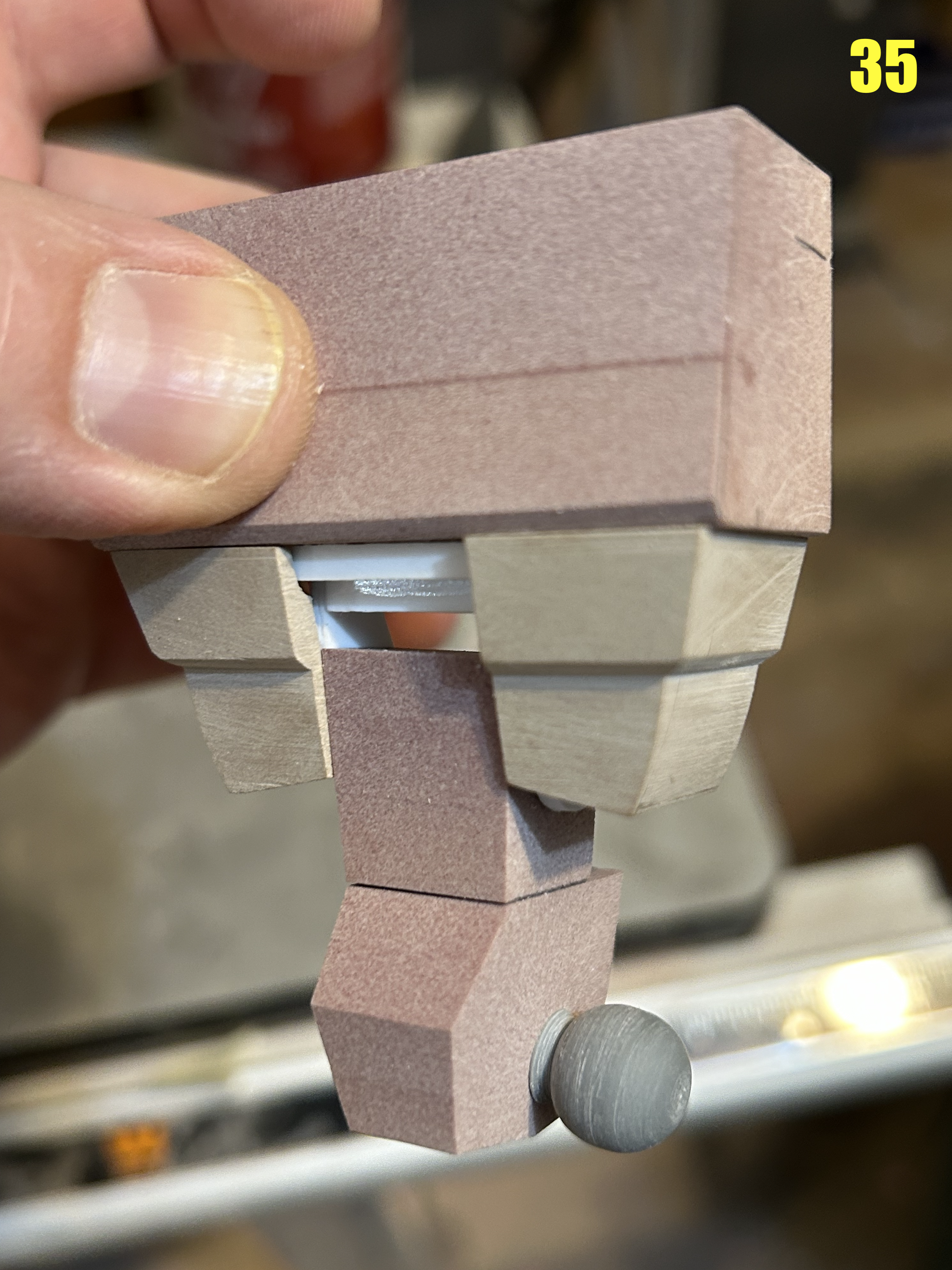

captain america Posted May 9, 2024 Author Posted May 9, 2024 Pic 35: another critical joint on the figure is the hinge at the solar plexus. I made the parts here from styrene for the sake of simplicity. What's interesting is that this can also serve as an ab-crunch joint, and I added a swivel at the waist, so robot mode will have an unusually decent range of motion. Pic 37: this is what I have after about 3 weeks of work. Once the feet and the extra armor parts are added, it will make much more visual sense. That's it for this week, and stay tuned for the next update Quote

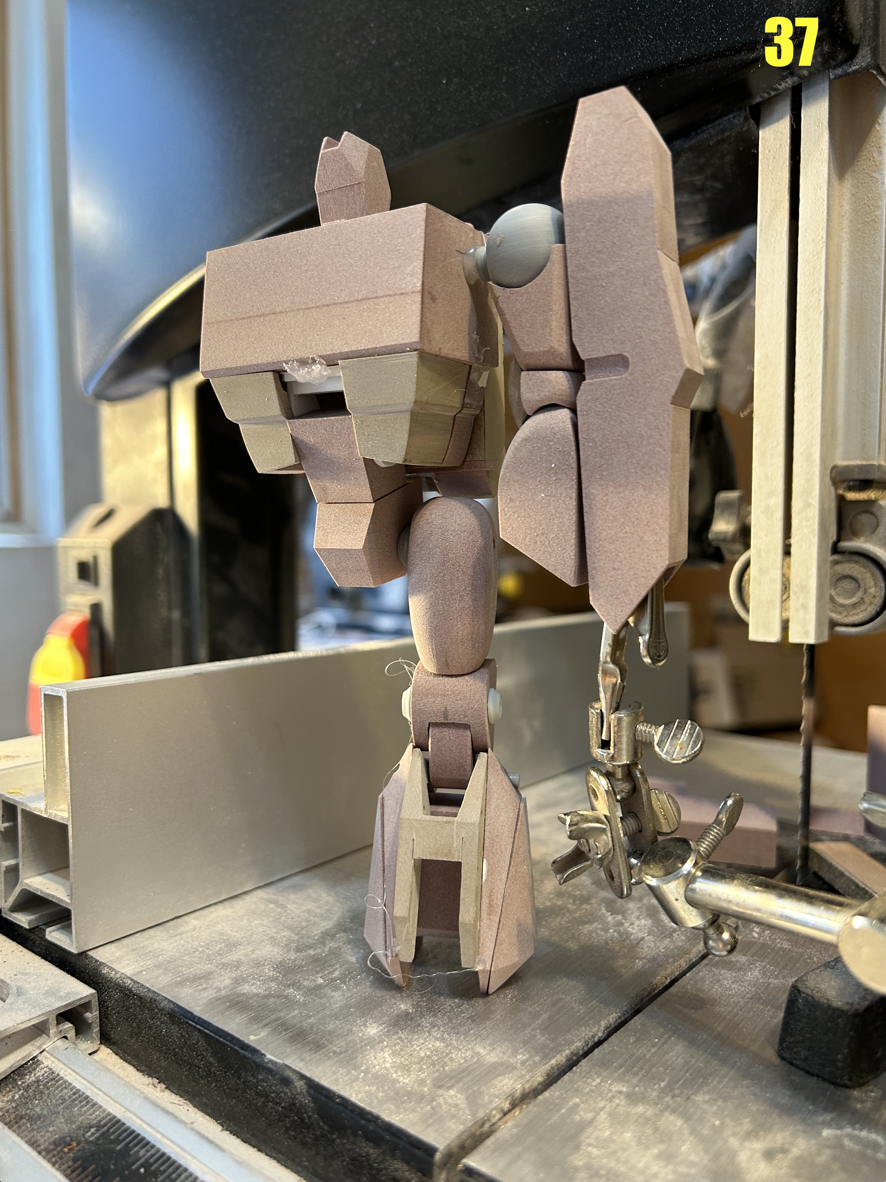

captain america Posted May 17, 2024 Author Posted May 17, 2024 Captain's Log: Friday, May 17th, 2024 Things are going well. VERY well! Considering I'm only a month into a variable-geometry model project, I have to say I'm quite surprised at the progress I've made in such a short time. Pics 38-42 show the hovercraft mode looking very nice indeed. I put in a lot of hours fiddling with the geometry: sanding a little here, removing a bit of material there, constantly going back and forth with some details to get everything nice and flat. This is something which takes up a stupid amount of man hours, but the proof is in the pudding: this thing looks like $$ and I'm far from done! Now comes robot mode, which is equally impressive! I received my order of aftermarket hands, and they fit perfectly in the forearms. Frankly, everything just looks... Wonderful! The only drawback is the parts count continues to rise, as I make improvements to the geometry in order to enhance posability and harmonize the two main modes. Frankly, it's worth it: no one has ever done justice to these mecha, so I'm going all the way. When I stop and consider how far I've come since the days of the 1/32 Legioss, which took me about a year, and here I am doing something almost as complex, but much smaller, in about a month. I can only give glory to God!! I may skip next week's update as I have some other commitments, but rest assured that I'll be back with a vengeance in 2 weeks! 38.HEIC 39.HEIC 40.HEIC 41.HEIC 42.HEIC 43.HEIC 44.HEIC 45.HEIC 46.HEIC 47.HEIC 48.HEIC Quote

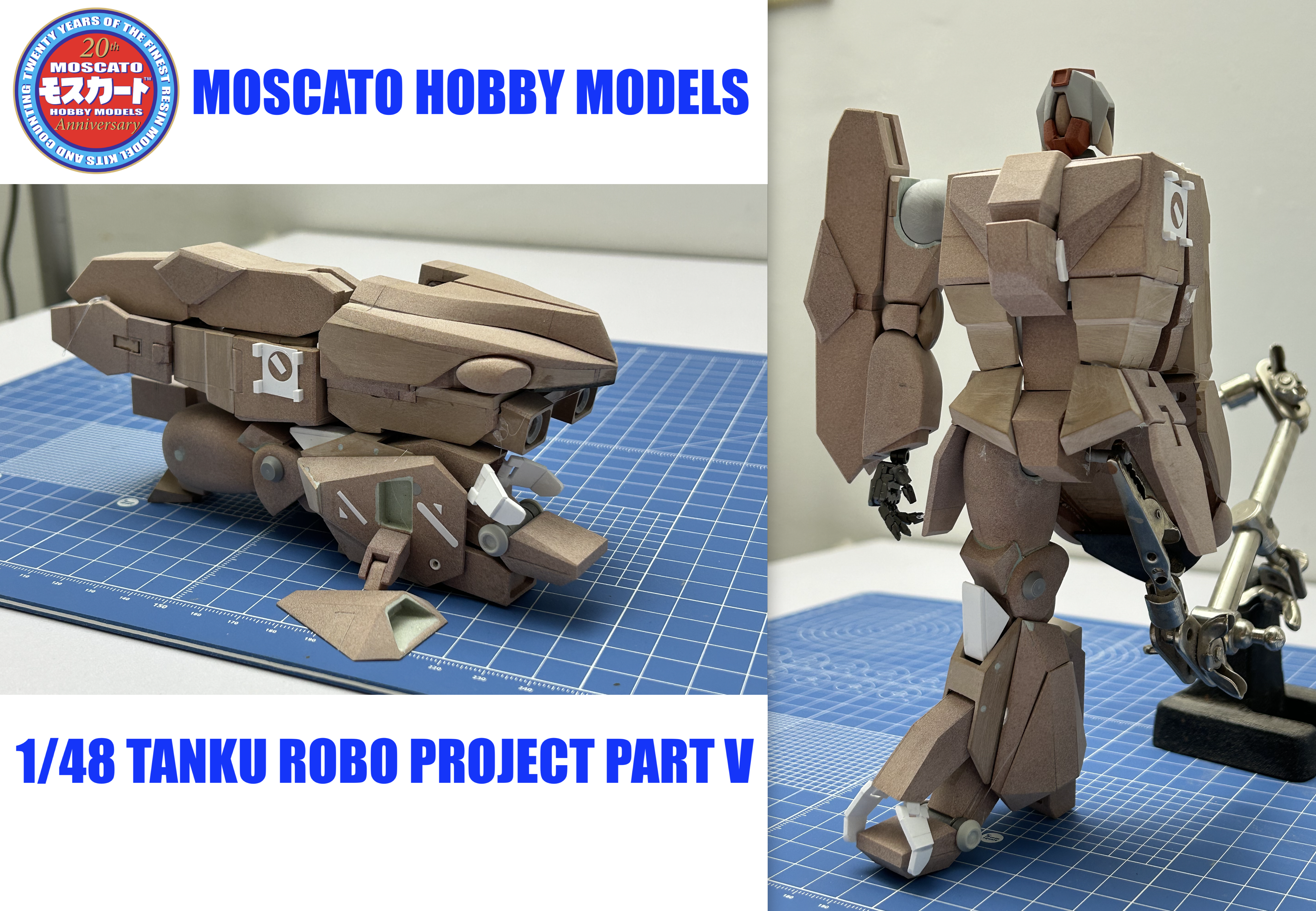

captain america Posted June 7, 2024 Author Posted June 7, 2024 Captain's log: Friday, June 7th, 2024. Closing stages of construction have arrived. I made a few alterations to some of the parts to make them more conformal to the source material, and am now at the priming stage, getting ready to mold all the parts which require duplication. The first is the foot armor cover thingamabob, which you can see in pics 68 and 69. Admittedly, the pieces you saw last week were place-holders, but now I have a far better solution which looks right! That was a bit of a sticking point for me, because the clearances in the lower leg/foot area are very tight. The lateral armor pieces are separate (held with tack putty!) which will be needed to avoid binding the foot in robot mode. Pics 70 and 71 show the deployed main gun and support autocannon. The kit will also include plugs to reproduce these in retracted mode inside the arm nacelles. Pic 72 shows the rifle unit in hovercraft (stowage) mode with the raised stock and retracted barrel, but will have the optional long (extended) barrel and lowered stock. Pics 73-75 shows the hood fairing, now sloped down as per the line-art. I did like the previous version with the squared nose, but apparently it was really bad for gas mileage!! With these mods done, I can now begin mold-prep for the duplicate parts as I await the arrival of the pilot figure from Carlos. If the castings aren't ready by next week, (which is doubtful) I may simply skip an update, though the odds are pretty good that I'll be able to show a fully finished figure in the next 7-10 days, so stay tuned!! 67B.HEIC 68.HEIC 69.HEIC 70.HEIC 71.HEIC 72.HEIC 73.HEIC 74.HEIC 75.HEIC Quote
