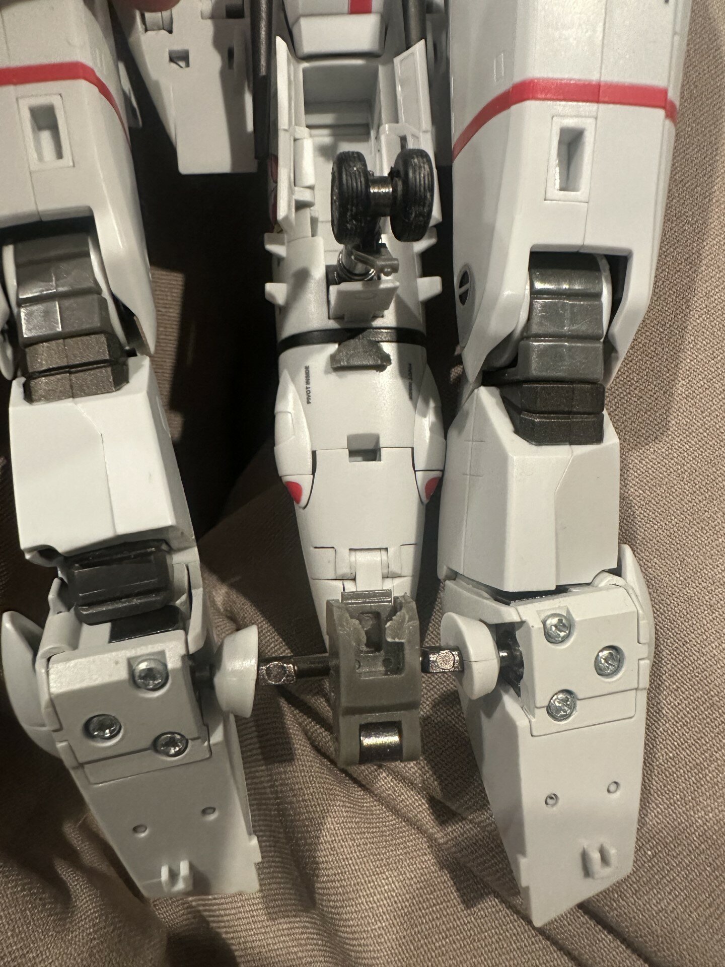

rocketblast Posted February 29, 2024 Author Posted February 29, 2024 Here's a photo of the part that is broken. Part of it is snapped into the fuselage and the other is between the legs. It is grey, do you think a clear epoxy would work? Or should I just try gorilla glue? Quote
pengbuzz Posted February 29, 2024 Posted February 29, 2024 29 minutes ago, rocketblast said: Here's a photo of the part that is broken. Part of it is snapped into the fuselage and the other is between the legs. It is grey, do you think a clear epoxy would work? Or should I just try gorilla glue? OK, I understand now. Epoxy is going to be far too brittle and won't hold that, while Gorilla glue simply won't have much to hang onto there. Try the Permatex Plastic Welder, and see about putting some behind the broken part in the space in there. I would try lightly sanding it to give the adhesive some "tooth" to cling onto when you glue it. Quote
nightmareB4macross Posted February 29, 2024 Posted February 29, 2024 (edited) 1 hour ago, rocketblast said: Here's a photo of the part that is broken. Part of it is snapped into the fuselage and the other is between the legs. It is grey, do you think a clear epoxy would work? Or should I just try gorilla glue? I think that part is made from POM. It is intended to be strong and has a high tendency of not working well with surface bonding glues. If you are lucky enough to get the parts to stick cool. But they will never be strong as the original part once was and break apart easily. Hopefully you can find a solution by doing a little research on the plastic and finding the right bonding chemical. Edited February 29, 2024 by nightmareB4macross Quote
