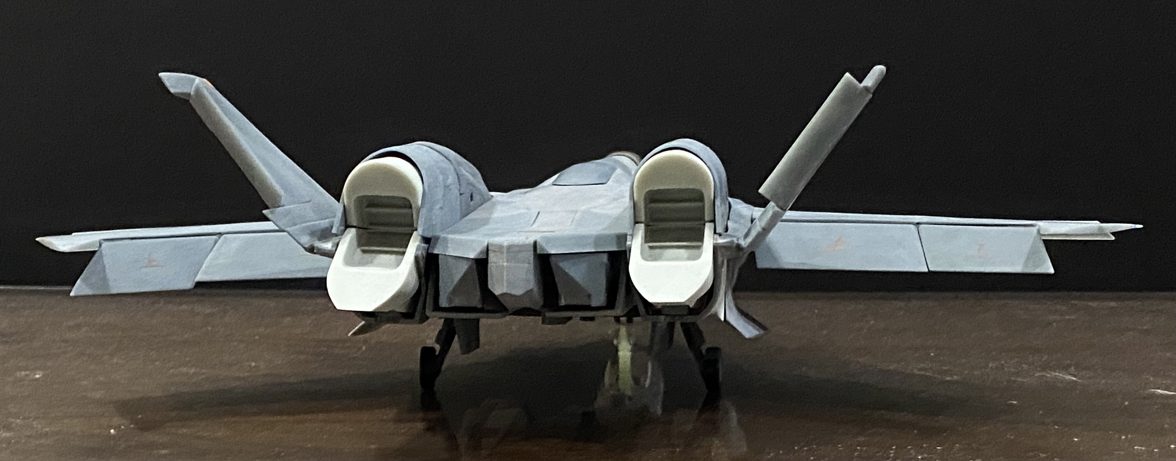

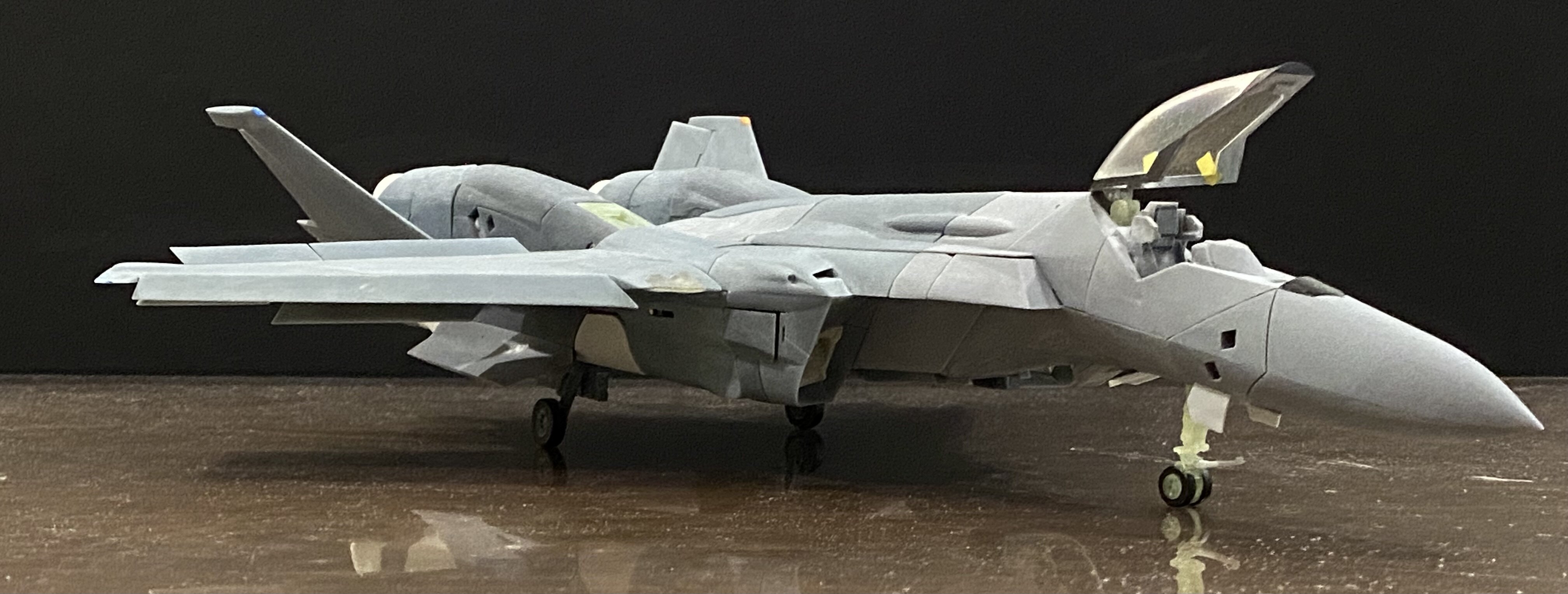

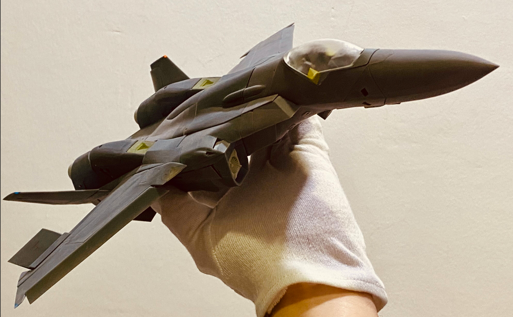

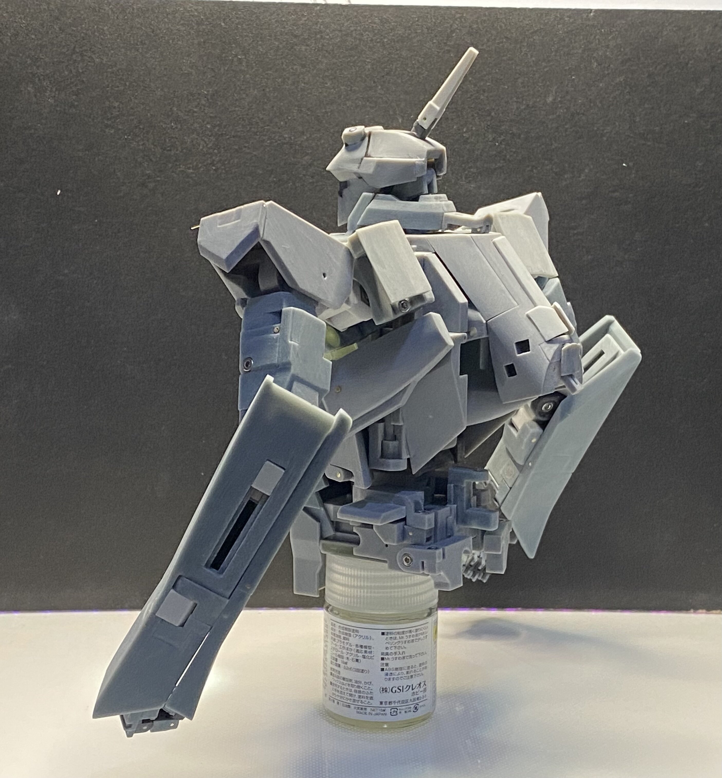

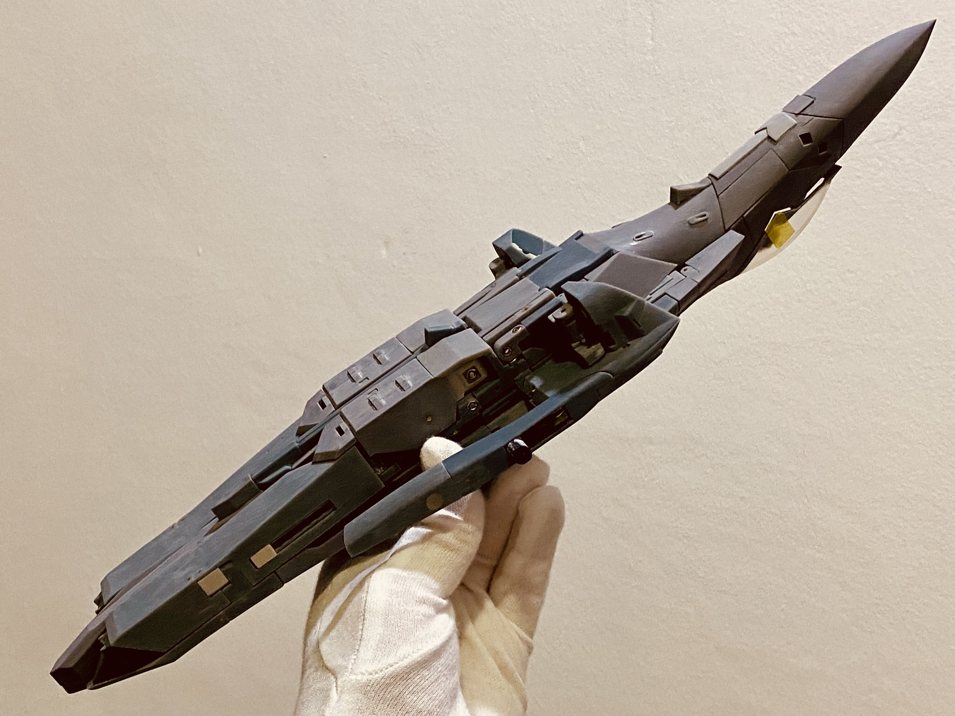

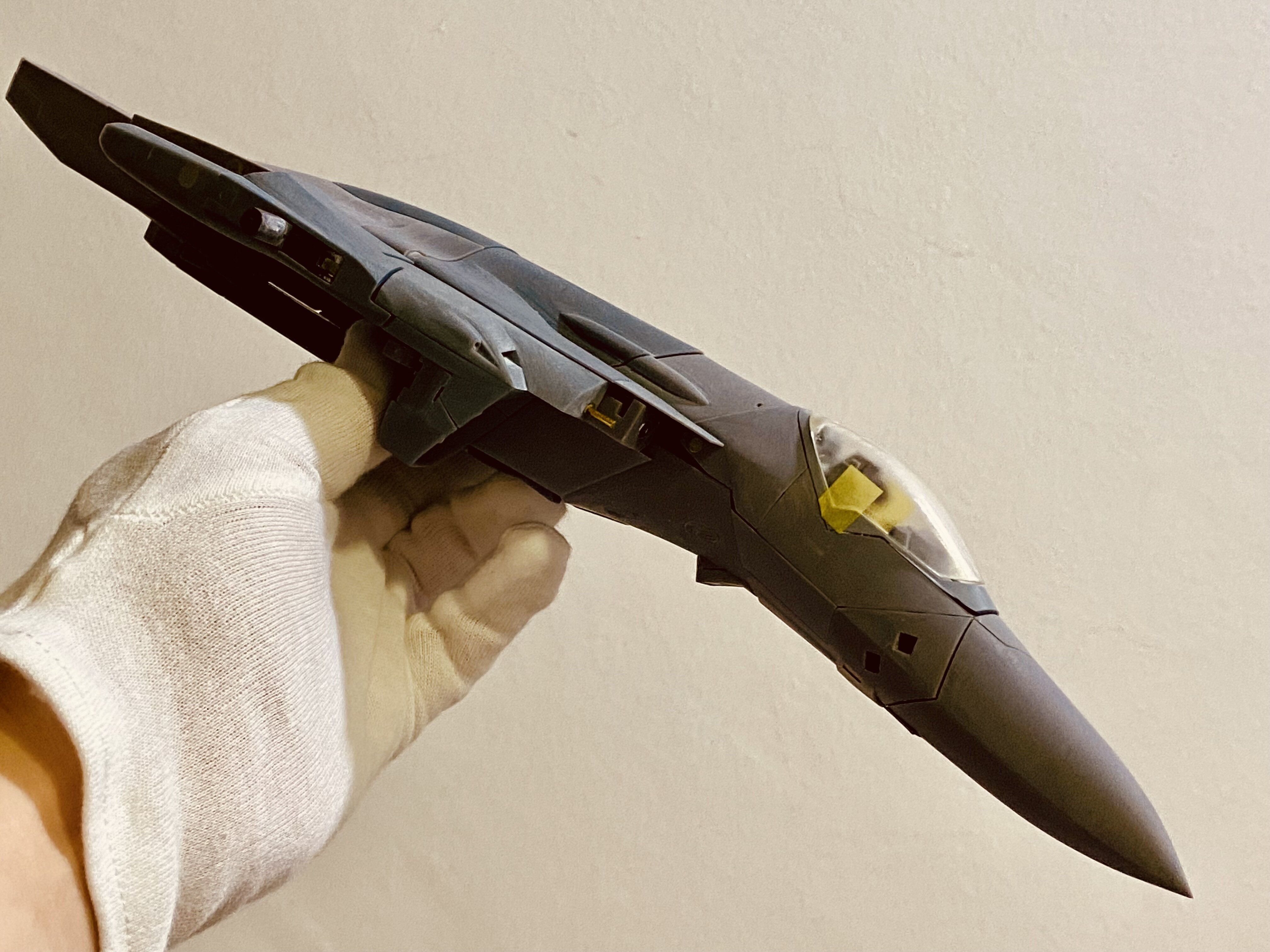

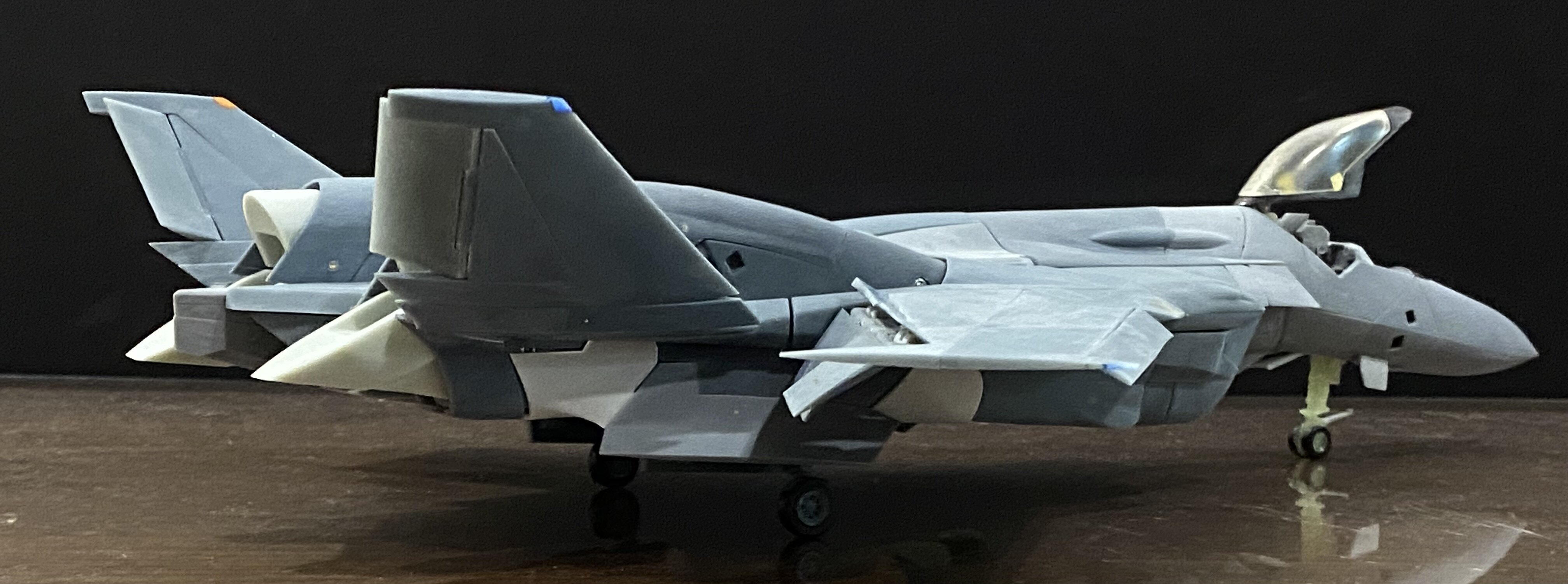

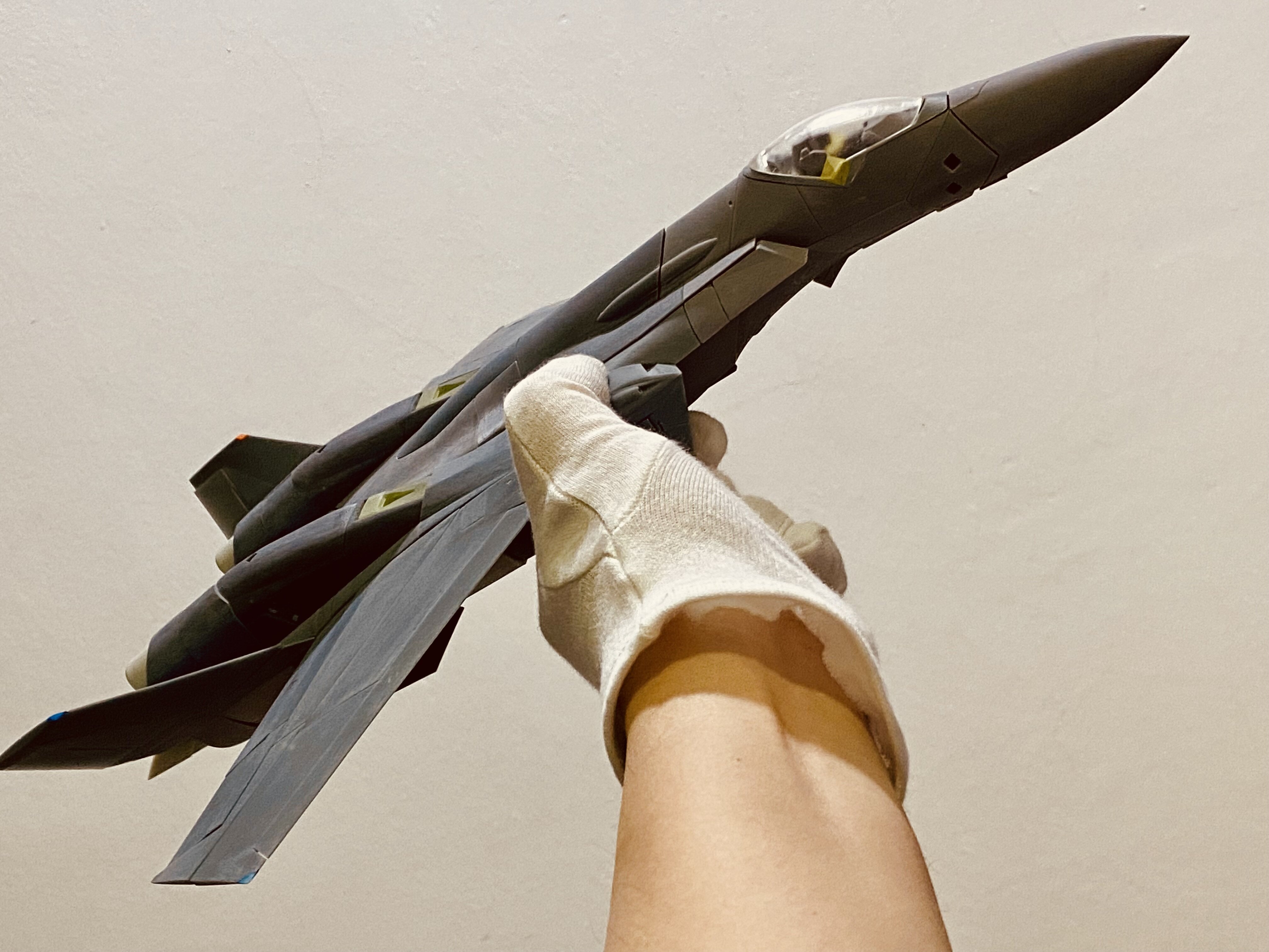

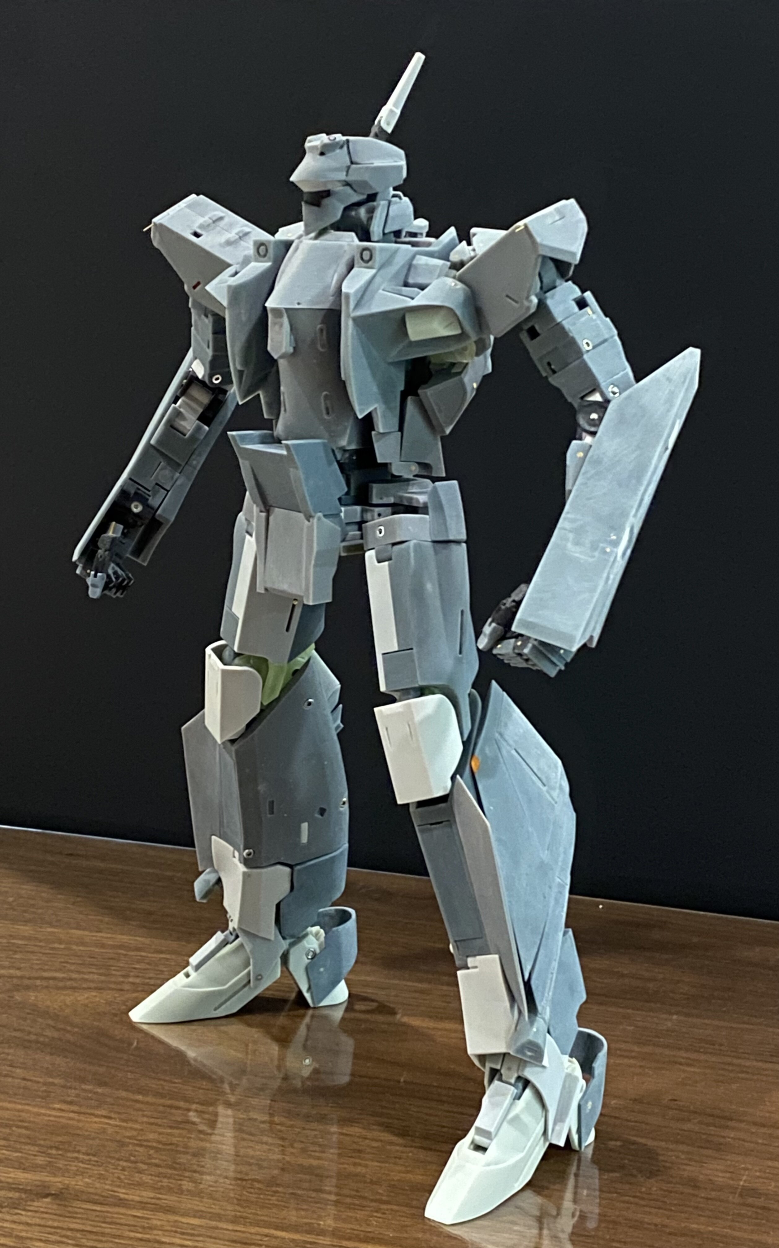

ImChris5115 Posted August 13 Author Posted August 13 (edited) Finalized Type 02 [Full Transformation-no parts swapping] [Interlocking, M2 Bolts and Nuts<no glue needed>, Brass rod 0.5mm, 1.0mm, 1.5mm, Magnet], Ball joint used only on neck [1 pc]. Painting in progress.... Starting Type 0ne & Type Three>>>>>> Edited August 15 by ImChris5115 Quote

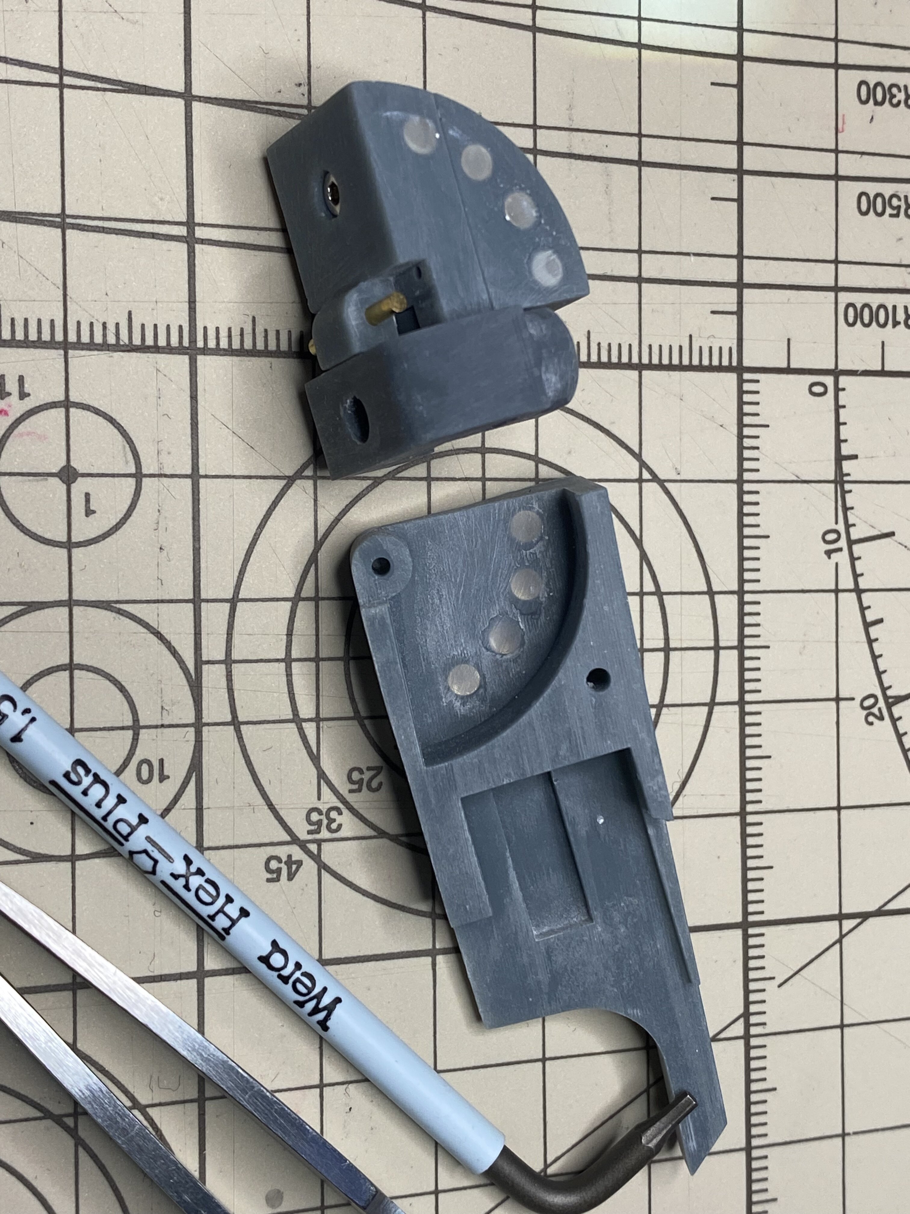

Chronocidal Posted August 26 Posted August 26 That is absolutely a work of art, bravo! And I'm guessing that joint is a magnetic ratchet? That's a really nice way to get smooth motion, and solid positions without having gears and teeth that can wear down over time. Quote
ImChris5115 Posted August 26 Author Posted August 26 19 hours ago, Shawn said: Have you ever considered selling these? I want this on my shelf next to my DX line up Hi Shawn, do you mean this 3D-printed resin version? Is it a completed model or a garage kit you prefer most? Quote
ImChris5115 Posted August 26 Author Posted August 26 2 hours ago, Chronocidal said: That is absolutely a work of art, bravo! And I'm guessing that joint is a magnetic ratchet? That's a really nice way to get smooth motion, and solid positions without having gears and teeth that can wear down over time. Thank you! Appreciated Yes, it's a magnetic ratchet ^^ Quote
