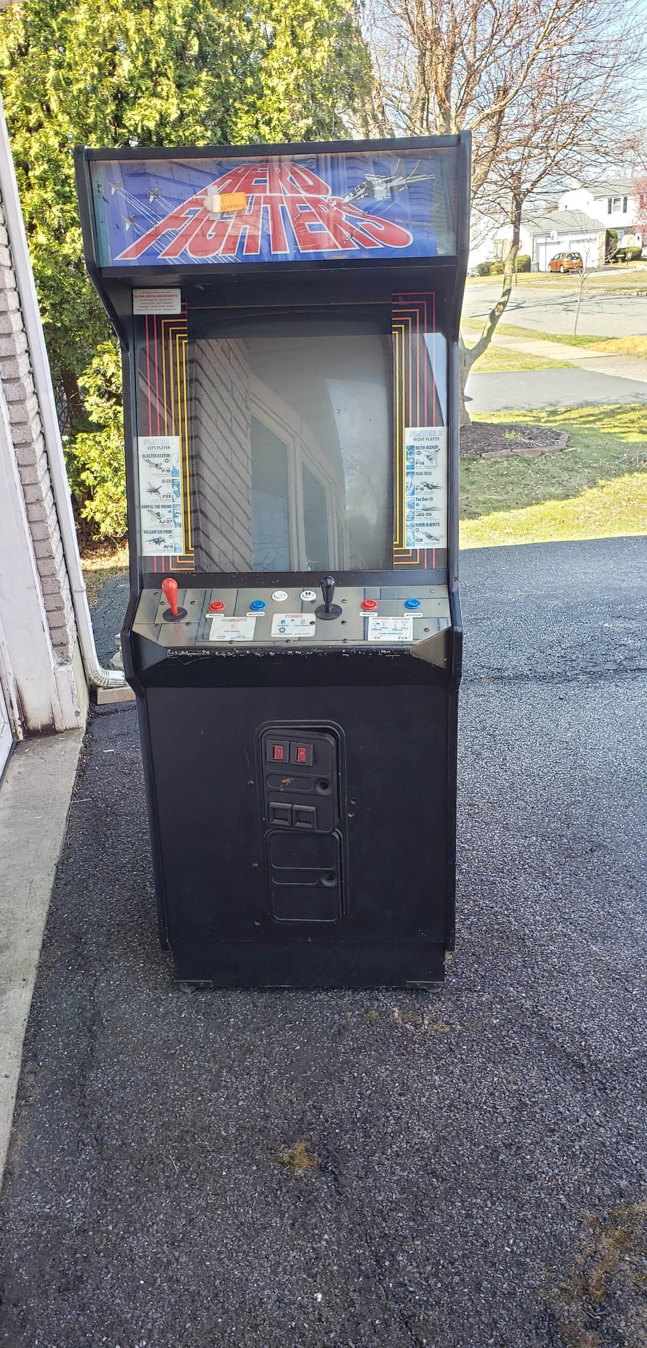

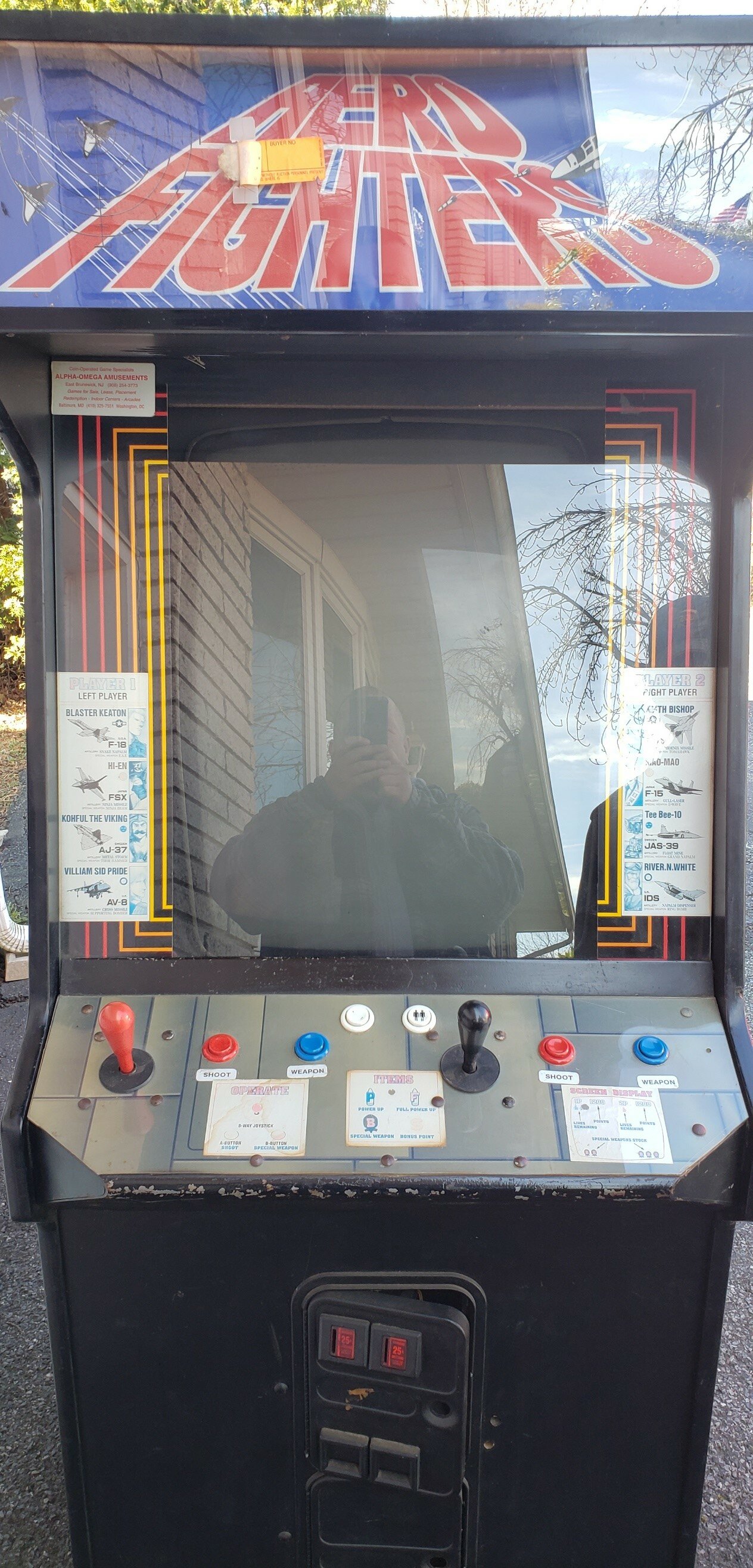

I located an "Aero Fighters" in a fairly good overall condition Dynamo HS-5 cab locally.    Not perfect but a very good starting point.
337011795_776909516965990_7787280599396686180_n.jpg.ddd1a9c06eae8fd6774e4d287eb8abe8.jpg
337017876_588671709843631_5959812060395172761_n.jpg.6fafb5308ad7ba14257e59769401f154.jpg
Other then being REALLY DIRTY,  my biggest gripe is button placement which will eventually be corrected.

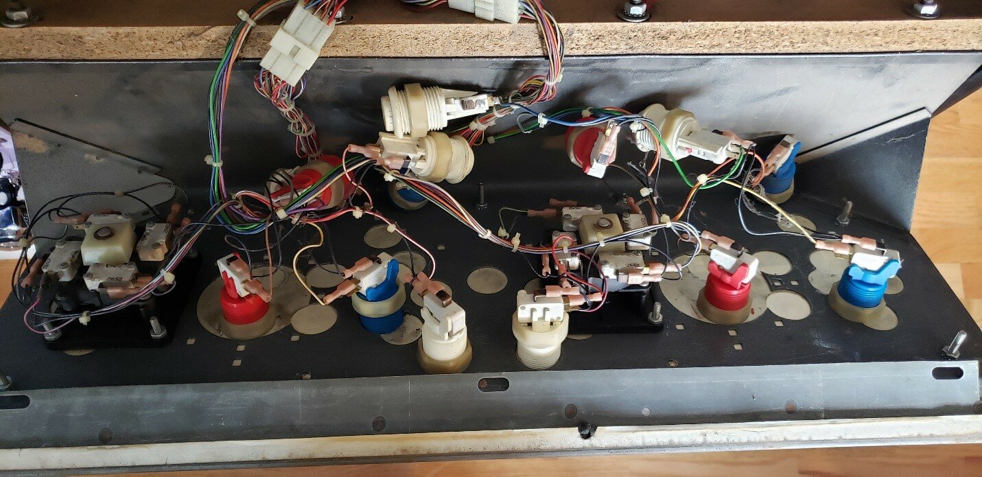

Control Panel,   not sure if I am going to keep the original,  as hole placement needs to be addressed.    At best I will need to strip and powder coat the metal backer and template.

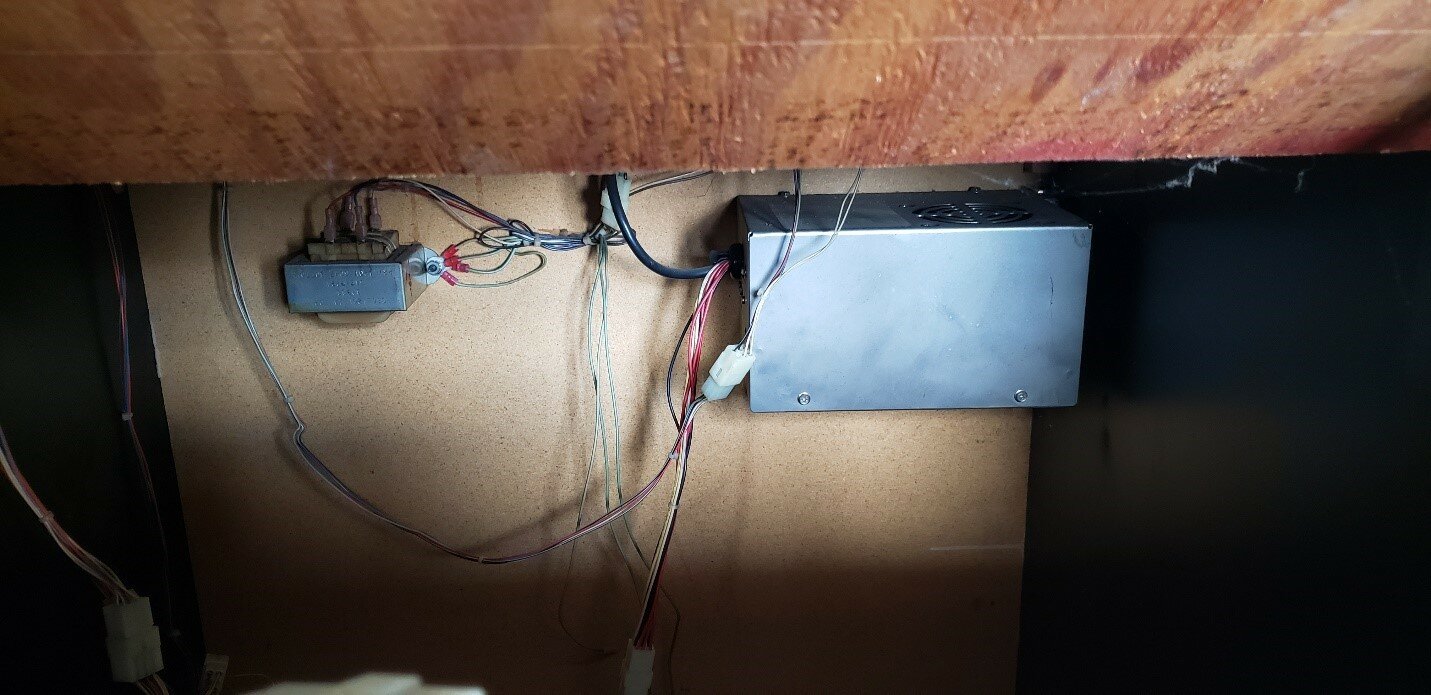

Powersupply,   I think this is original.   I hit outputs with a meter and its still running within spec.. so it stays.
I am curious what the transformer is doing,  not sure if the monitor needs it or if its for the Marquee..   anyone have any ideas?

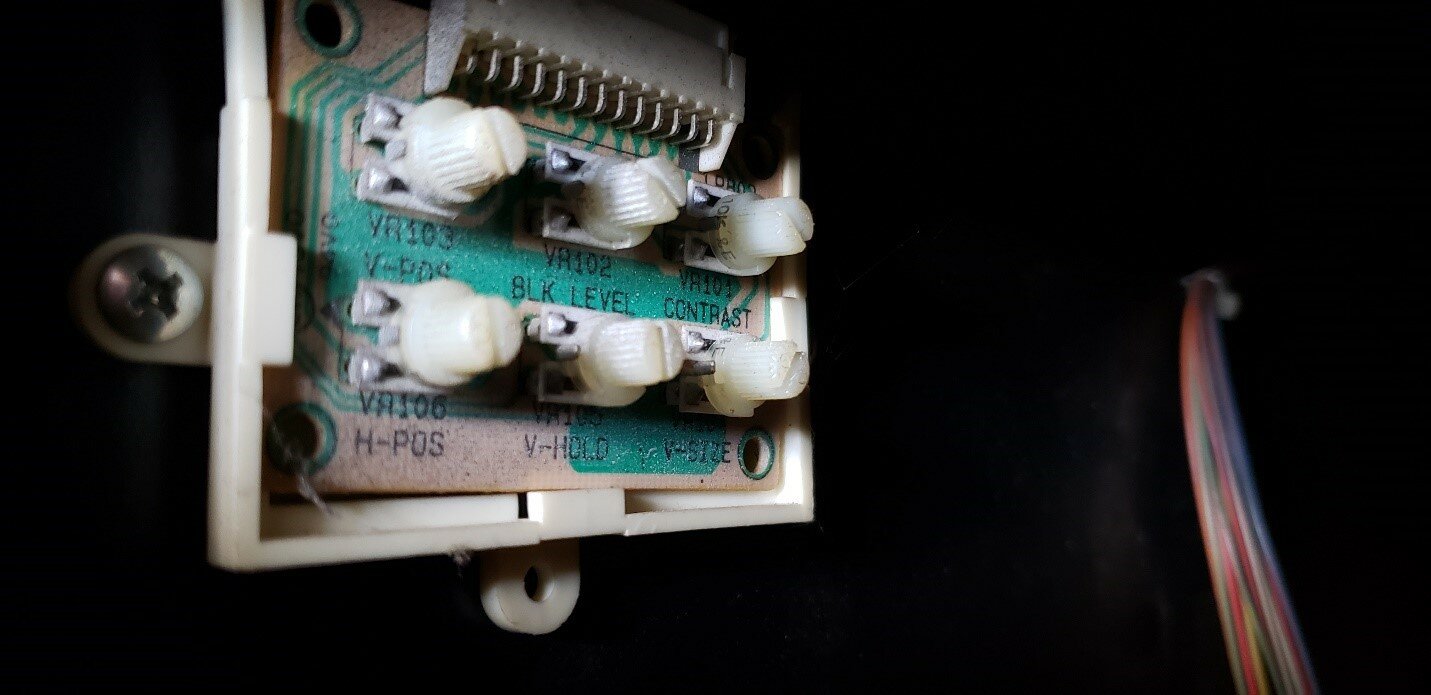

And lastly monitor controls..
337150360_668534645043217_3310188610899831020_n.jpg.34a84b0519e70ae98da7006315681b09.jpg
I had to make some minor adjustments to get the monitor to work properly,  but it appears to be pretty solid.     A cap kit might be needed down the road but right now its acceptable AS-IS.

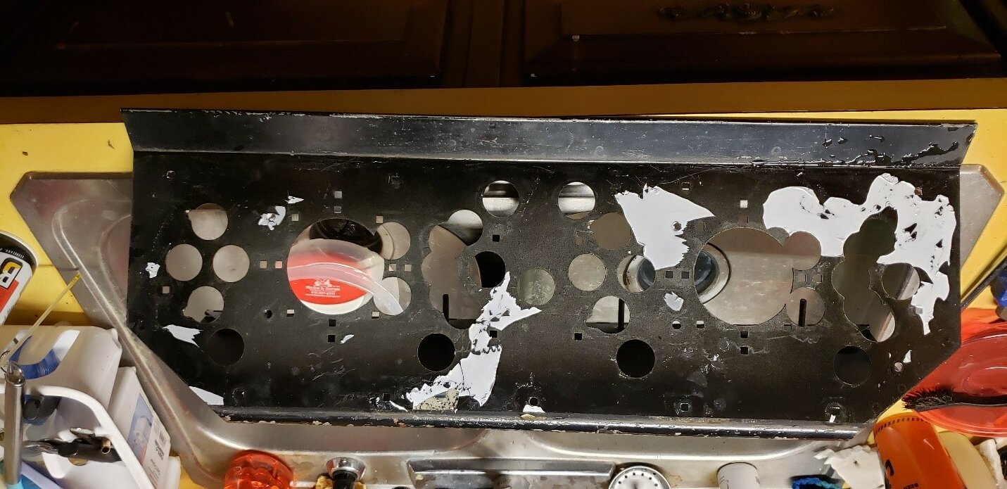

With that said.. I tore the control panel apart, since button configuration was really getting to me..   and I found Swiss Cheese..
This drove home the past lives of this cab..   This next picture is showing the Plexi overlay with button placement.
You can see how some buttons are completely unsupported.     Not 100% on if I am going to try and save this.     Or just order a replacement..

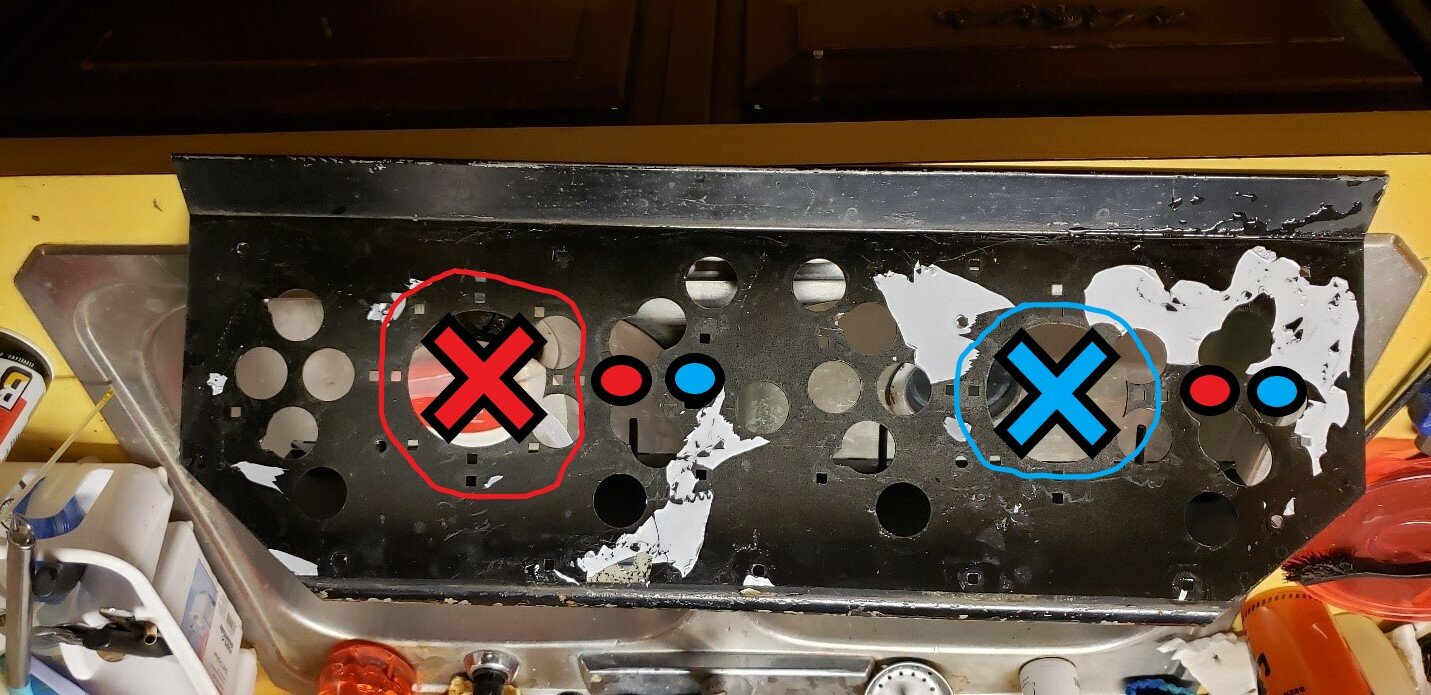

So doing some messing around with my MS Paint Skillz..
I found a way I could save this..  on the fence about it.    P1 has pretty much ALL the room,  and P2 feels like its hanging off the right side..    Max Deserves better if you ask me..   X marking joystick positions.

Cheers, Stampeed Valkyrie. I'm very enthused to get to follow along with your project! The Dynamo cab is really a great basis for it. Please keep the updates coming.
On the control panel, I don't think the swiss cheese factor is all that bad - the buttons don't need a ton more local support than a plexi overlay will provide on it's own, and it looks like you've still got some metal under them. I like your idea to shift the controls over to the right a bit and to tighten up the button spacing. I'd see how much panel flex you get with the sticks mounted where you've projected them in those large openings - I'll bet it works out fine with the existing panel.

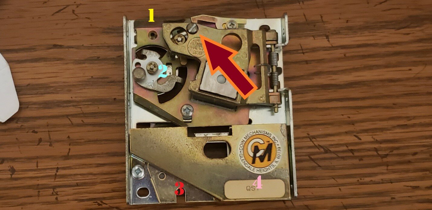

I have been chasing a phantom issue with the coin acceptors,  the right one works 100% everytime,  and the left one now takes coins,  but does not register a credit.   Been at it with a meter and everything is testing out..  its wierd.

Is there a mechanical component involved?
Ie: the coin forces a lever to move, and that lever pushes down into something (a 'touchpad') that activates the electrical switch?  If so, what is the state of that touchpad and does it register when the lever touches it?
Expand
It's an isolation transformer for the monitor.  They're important on old CRT monitors to protect your PCB and prevent electrical shocks.  Definitely keep it.

....  and the coin mech phantom problems persist.
The mechanism is a coin co version similar to this.
As I stated previously I have 2 issues.. 1 I think is wiring,  and the other is Mechanical in nature.
The mechanism randomly gets tokens stuck in the mechanism,  they get hung in the brass cradle or just after it.   I have adjusted and lubricated several parts but the issue is random,  could be fine today,  tomorrow, maybe next Saturday.   Then bam its back again.
The Electrical has to do with how credits are not getting registered after the coin falls past the relay switch after clearing the mechanism itself and falling into the bucket.
I have tested the relay and its good,  power is showing proper 5VDC and ground is good for common.     I think the problem is with the wiring harness for the cabinet itself.
My next step is to get a meter and test the harness for the P2 coin circuit,  possibly try to hunt down a wiring schematic for this cabinet assuming it has not been bubba'd.

It sounds like the parts may be worn down.  Ie the axle wobbles, and when the part goes out of alignment it gets stuck.
Is there any excessive "wiggle" in the parts?  Can you restore the metal parts with something like the modellers use here on wobbly joints (for example clear nail polish)?  Are there any perishables (eg rubber grommets) that are breaking down?
So I removed the mech,  quick overview..   1.) coin drops in here   2.) Sort Mechanism checks for weight and size.   coin then decends down ramp towards the sticker.  3.) Accepted coin chute  4.) Rejected coin chute.            The arrow is showing the adjustment screw for the magnet that "supposedly" slows the coin down during its path between #'s 2  and 3 or 4.
The mechanism itself is very simple,  I seem to be getting coins stuck in the chutes..  first was the "ramp" so I adjusted the magnet and that seems to have stopped.    Now I am getting them stuck in the acceptance chute.     Apparently there is a bumper it hits and I wonder if that is what is doing it.
So the coin Mech, is going the way of the trashbin.    I have a friend who is sending me a replacement mechanical unit.   I did some of the adjustments that the Vendor recommended and it still just Randomly decides to reject or Jam with no obvious culprit.
The next specter to hunt down is why the Coin 2 does not register a credit.    As I said previously the relay is working on both coin slots,  but only registers on P2.    I brought the meter out and I do have continuity on Both C1 and C2 circuits.     The coin counter also does not register on C2,  without digging into the box further I am scratching my head.
I am taking a WIN for today,  both issues with the coin box are resolved.    Original coin acceptor was completely out of calibration,  another one of my friends was able to take the unit apart,  reassemble and then locate what was wrong and adjust accordingly.
As for the electrical gremlin,   I cheated.   I ran both relays in series and now it registers no matter which slot you used.      I figured that is easier then tearing into the cabinet and trying to undo some whackery in the wiring.
