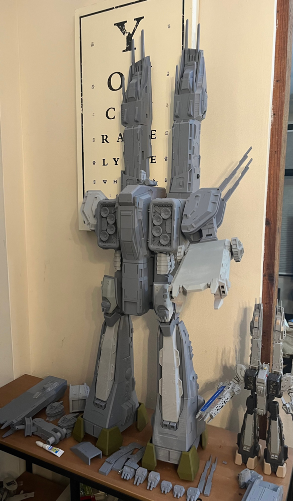

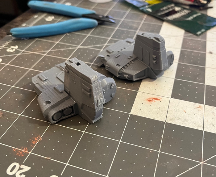

Sanity is Optional Posted February 23, 2023 Posted February 23, 2023 On 2/20/2023 at 5:01 PM, bzwacks said: Little brother and big brother together. As you can see, there is some misalignment between the front and back...The meshes line up exactly. One part was printed on an Ender and the other on a Prusa...may have had something to do with it. Ouch, did you calibrate the step size on the printers? I know it can vary a bit in practice, especially for larger prints. Quote
Anasazi37 Posted February 23, 2023 Posted February 23, 2023 (edited) 2 hours ago, Sanity is Optional said: Ouch, did you calibrate the step size on the printers? I know it can vary a bit in practice, especially for larger prints. Based on what I'm seeing in that picture, in terms of how the parts were oriented for printing, my best guess is that it comes down to differences in how the gcode for the sliced models was generated by the slicing program and interpreted by the two printers, plus differences in the hardware and programming for those printers. Edited February 23, 2023 by Anasazi37 Quote

bzwacks Posted February 23, 2023 Author Posted February 23, 2023 10 hours ago, Anasazi37 said: Based on what I'm seeing in that picture, in terms of how the parts were oriented for printing, my best guess is that it comes down to differences in how the gcode for the sliced models was generated by the slicing program and interpreted by the two printers, plus differences in the hardware and programming for those printers. You may be right. I use PrusaSlicer for both of my 3D Printers. Generally, I don't have misalignments that noticeable between different printers using this method, but this time it was there. My Prusa printers are at my office and my Enders are in my home. Maybe the difference in ambient temperature could have caused something weird? Quote

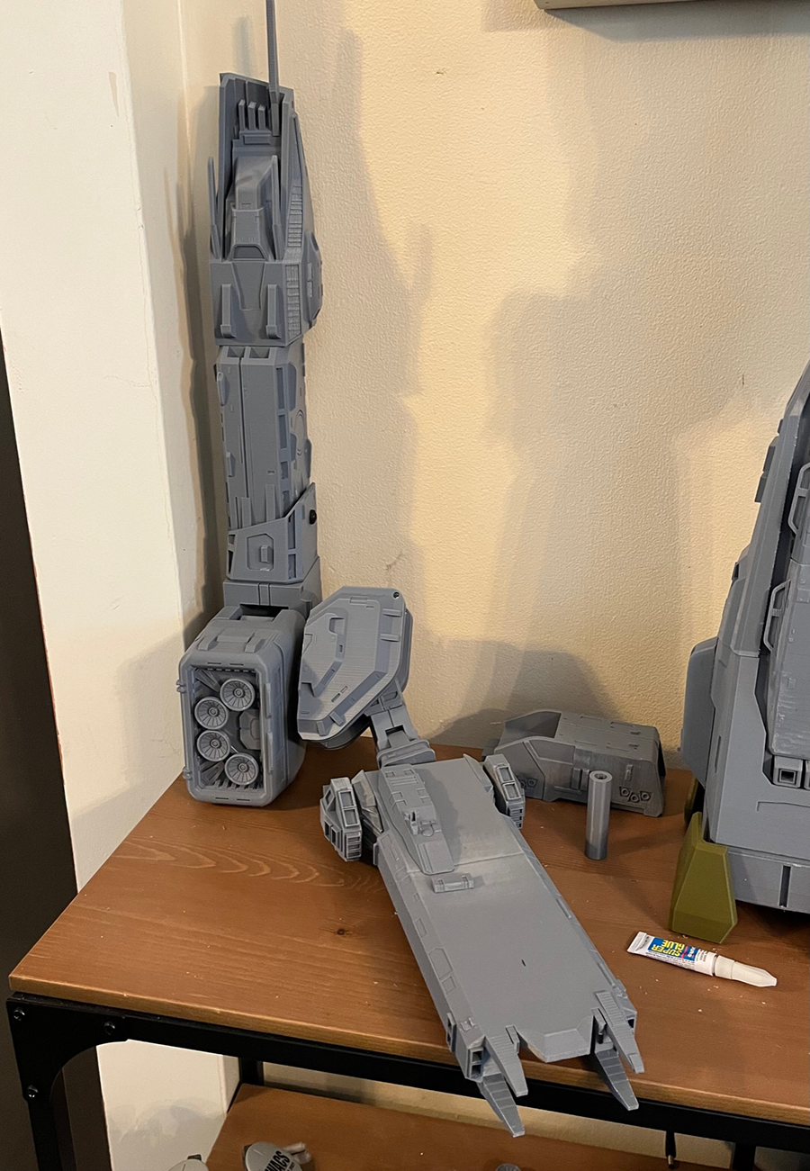

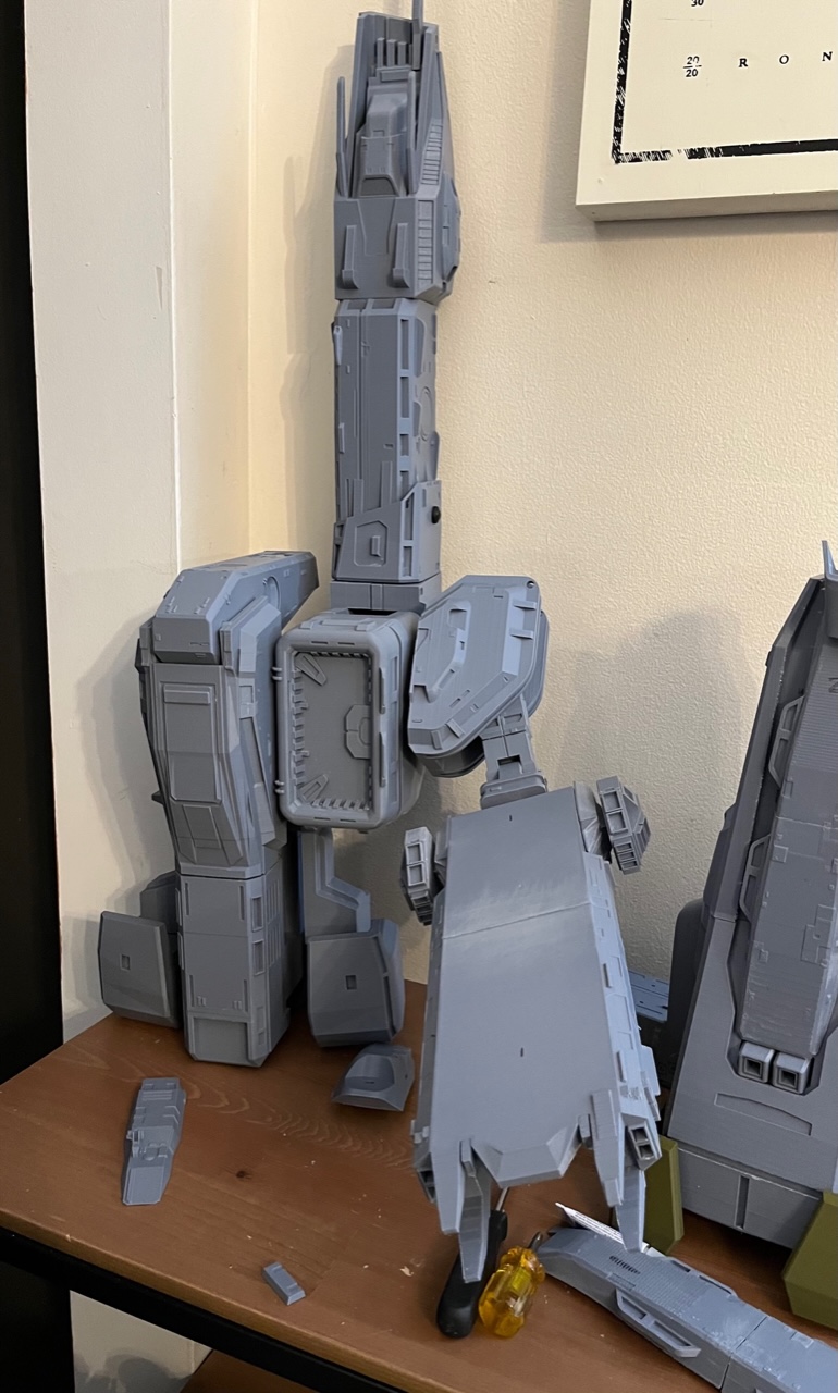

bzwacks Posted February 23, 2023 Author Posted February 23, 2023 Test fitting the body parts and seeing how the joints hold up. So far, so good. This is after doing some R&D to get the tension and the ratchet mechanisms dialed in. It's leaning against the wall, because it's off balance with half of it's body missing LOL. Quote
Anasazi37 Posted February 24, 2023 Posted February 24, 2023 1 hour ago, bzwacks said: You may be right. I use PrusaSlicer for both of my 3D Printers. Generally, I don't have misalignments that noticeable between different printers using this method, but this time it was there. My Prusa printers are at my office and my Enders are in my home. Maybe the difference in ambient temperature could have caused something weird? Yeah, you normally don't see differences that large if the printers are running at roughly the same specs. And I *love* that you mention your printers in the plural form in both office and home settings. Quote

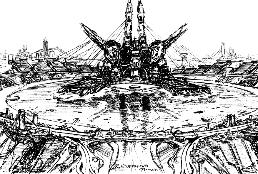

bzwacks Posted February 28, 2023 Author Posted February 28, 2023 Two bridges. One is based on the Yamato SDF-1 !/3000 toy and the other is based on the technical drawings of the SDF-1 Bridge. I think I like the technical drawing version better. Now, I have to make the antenna so that they are printable...they are very thin in the drawings, but will have to beef them up for 3d printing. Quote
Chronocidal Posted February 28, 2023 Posted February 28, 2023 Honestly, I know printing makes it easier, but at that scale, I think you could really do well just printing a frame to string with wire. Quote
Anasazi37 Posted February 28, 2023 Posted February 28, 2023 3 hours ago, bzwacks said: Two bridges. One is based on the Yamato SDF-1 !/3000 toy and the other is based on the technical drawings of the SDF-1 Bridge. I think I like the technical drawing version better. Now, I have to make the antenna so that they are printable...they are very thin in the drawings, but will have to beef them up for 3d printing. Would you be open to making two versions of the antenna? A resin printer could likely handle the finer detail of the original, but I can definitely see why you'd need to beef it up a bit for PLA printing. Quote

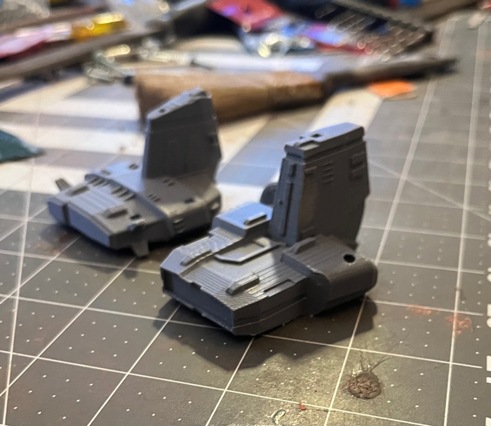

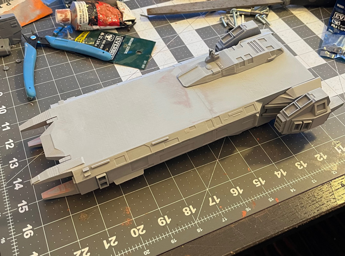

bzwacks Posted March 2, 2023 Author Posted March 2, 2023 (edited) Sometimes it's good to show the mistakes. I'm reprinting the top portions of the main gun. In this test fitting, I noticed they are a little too short, so I lengthened them a little. Even though I did orthographic modeling of the SDF-1, sometimes the compensation for lens curvature isn't totally correct. Not a big deal, because they'll be done printing by this time tomorrow. So far the balance is pretty good. In this photo, everything is held together by screws / bolts or tension fittings. I try not to use any glue on items this large. Only greeble will get the glue treatment . Edited March 2, 2023 by bzwacks Quote

Anasazi37 Posted March 2, 2023 Posted March 2, 2023 7 hours ago, bzwacks said: Sometimes it's good to show the mistakes. I'm reprinting the top portions of the main gun. In this test fitting, I noticed they are a little too short, so I lengthened them a little. Even though I did orthographic modeling of the SDF-1, sometimes the compensation for lens curvature isn't totally correct. Not a big deal, because they'll be done printing by this time tomorrow. So far the balance is pretty good. In this photo, everything is held together by screws / bolts or tension fittings. I try not to use any glue on items this large. Only greeble will get the glue treatment . That is coming together so nicely. As a professional photogrammetrist, I can say with confidence that most camera modeling software is crap. If they'd actually get the math right, the distortion you're talking about shouldn't be an issue--especially if you're tying together a large number of overlapping images of the same object taken from different perspectives to build a 3D representation. With that said, if the top portions of the guns are the only problem areas, that's great news. Quote

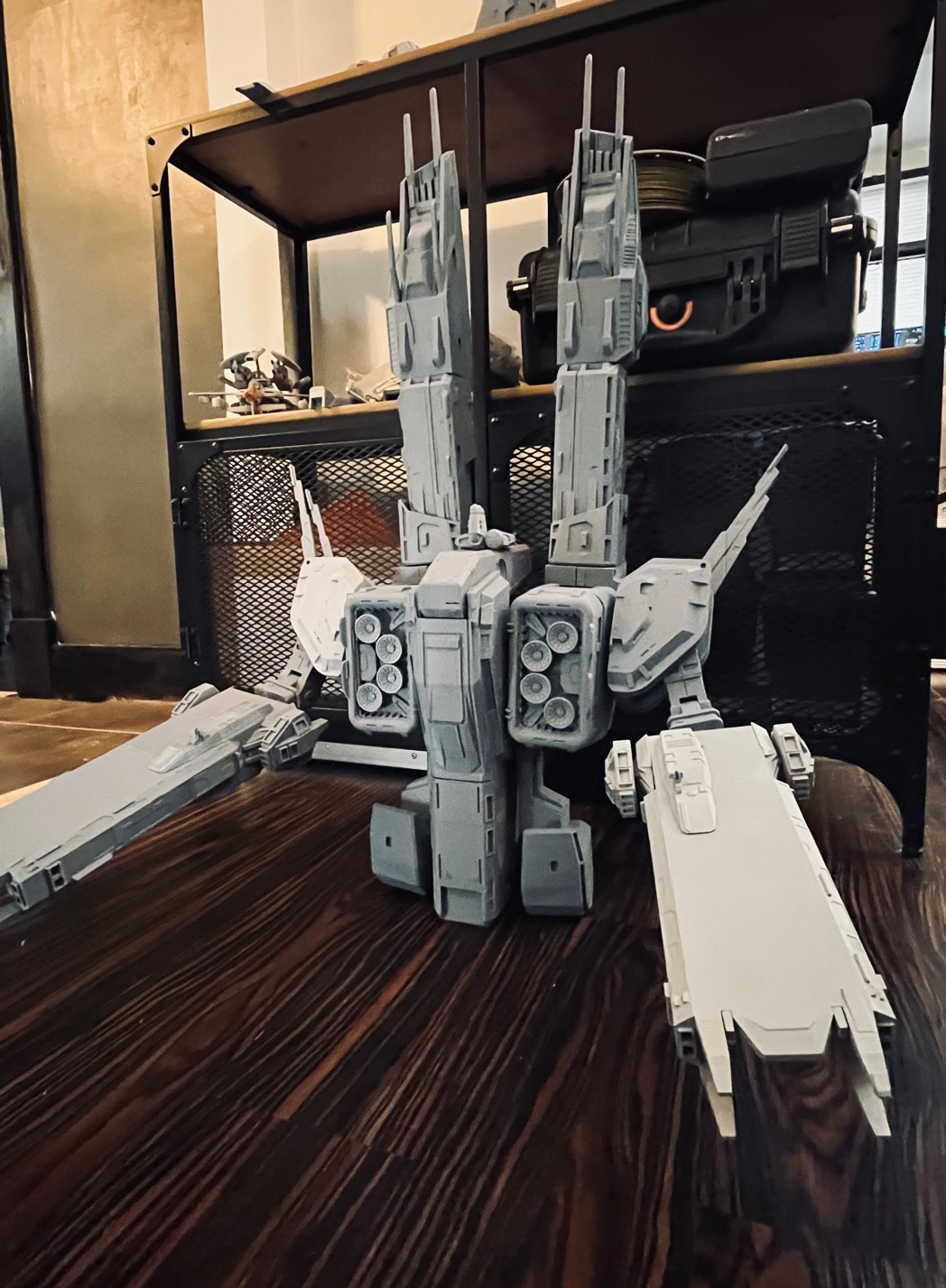

bzwacks Posted March 3, 2023 Author Posted March 3, 2023 New gun tips. Amazingly enough, it's perfectly balanced...even without legs. The main guns are splaying out a little bit. That's due to the lateral strain on the main frame. I need to either print a new support bar or make one out of metal. Quote
Bolt Posted March 3, 2023 Posted March 3, 2023 Very nice ! Great job👍🏼 Yes, a bracket to help relieve stress and slop makes perfect sense. So could this be disassembled and transformed? Quote
pengbuzz Posted March 3, 2023 Posted March 3, 2023 3 hours ago, bzwacks said: New gun tips. Amazingly enough, it's perfectly balanced...even without legs. The main guns are splaying out a little bit. That's due to the lateral strain on the main frame. I need to either print a new support bar or make one out of metal. I'd go with a metal one, and an interface between the bar and the booms so the resin doesn't deform from the weight of the booms on bare metal (such as a hard rubber bishing or something). Quote
