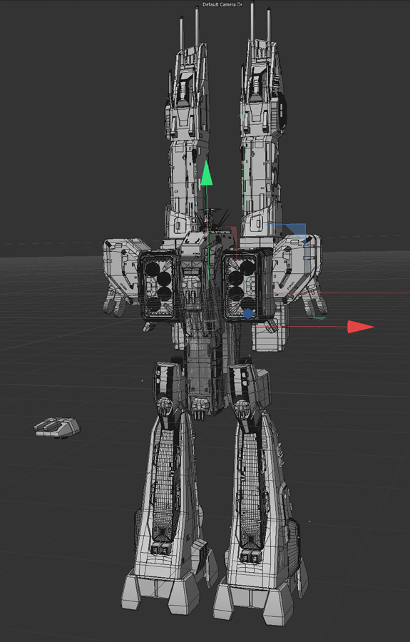

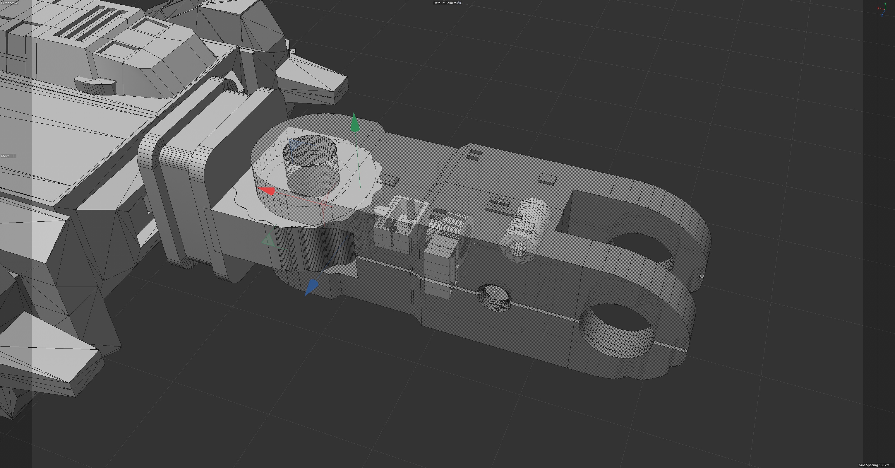

bzwacks Posted February 9, 2023 Posted February 9, 2023 Hello All, I'm a newbie to the forums, but a long time lurker. I have been printing 3D stuff for a while, but have been gearing that hobby towards my Macross obsession for about the last year. This is my latest build project ( and the biggest as well ). I will use this thread to post updates as often as I can ( which may not be super often, but I'll try ). This is based on the Yamato 1/3000 toy with modifications for size and engineering. It is being modeled in Cinema4D and printed with PLA on Ender and Prusa printers. I haven't figured out scale yet, but I'll place other macross toys next to the images to give a sense of scale. I started the project about 3 weeks ago. I started with a 3D mesh from another modeler, but that was for loose reference. It is now 95% scratch modeled, with only a portion of the torso being left over from that original mesh. This is the current state of the 3D mesh. The arms and joints are still being worked out. Quote

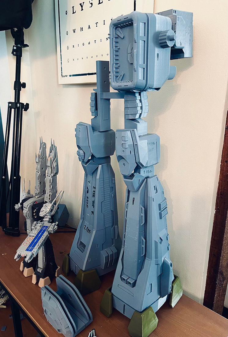

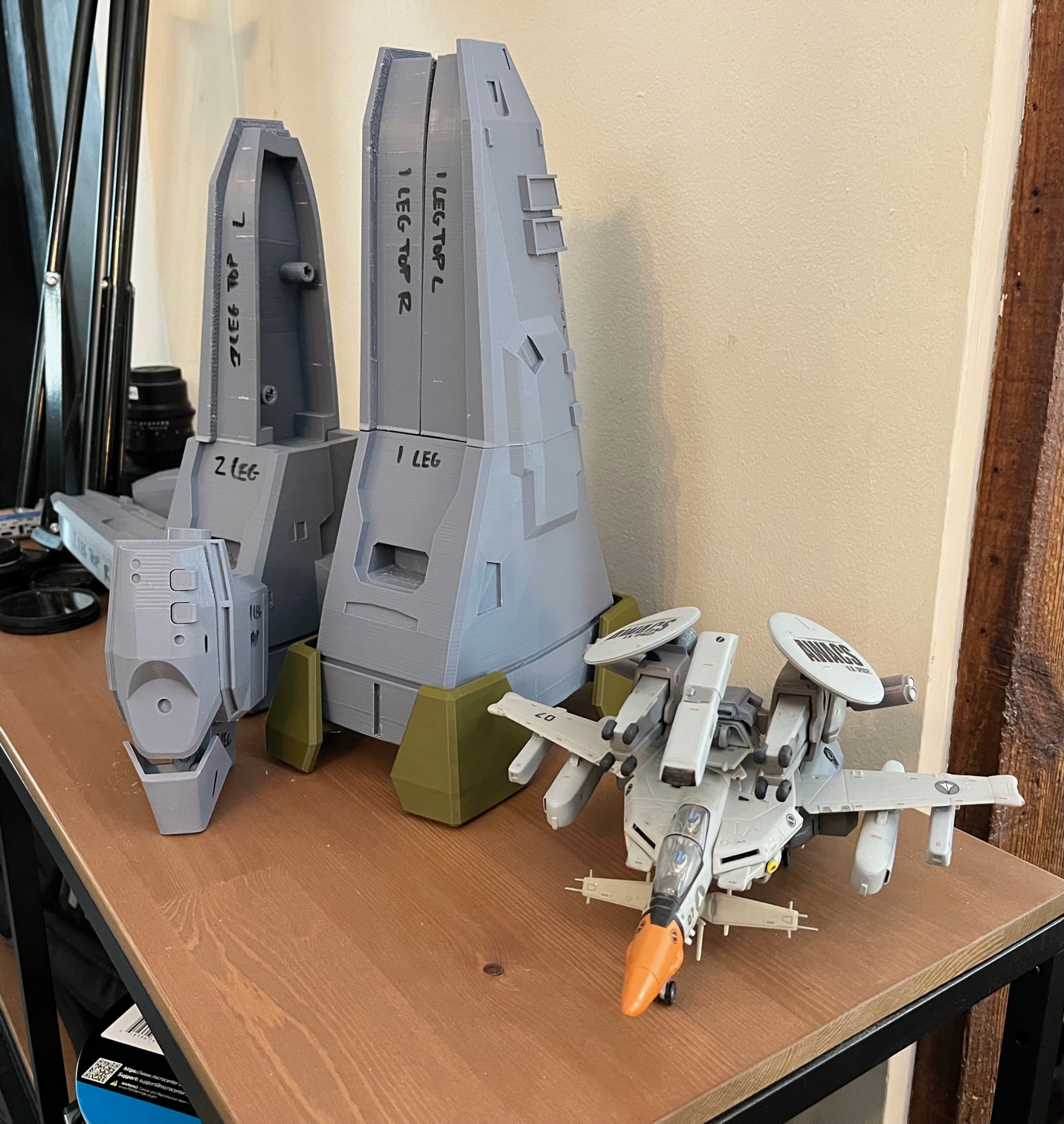

bzwacks Posted February 9, 2023 Author Posted February 9, 2023 In progress raw 3D prints of the legs components/ 1/60 Yamato VE-1 Elintseeker for scale. Quote

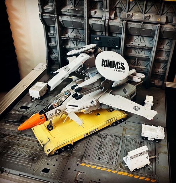

bzwacks Posted February 9, 2023 Author Posted February 9, 2023 (edited) That VE-1 custom was one of my first Macross projects. New booster and twin radar dishes. Later I added JDAM pods for that extra jamming LOL. Edited February 9, 2023 by bzwacks Quote
Bolt Posted February 9, 2023 Posted February 9, 2023 That's BOMBA 🔥 So were those extras a print job, then ? Sorry I'm off topic a bit..🤷 Quote
jenius Posted February 9, 2023 Posted February 9, 2023 I'm ignorant when it comes to 3D printing but it seems like some things are being upscaled that don't need to be and might cost you a lot of time and resources. Like, up around the knee, it looks like the plastic there is like an inch thick. At this scale, I fear you'll end up with a toy so massive and heavy, you won't be able to move it! Quote

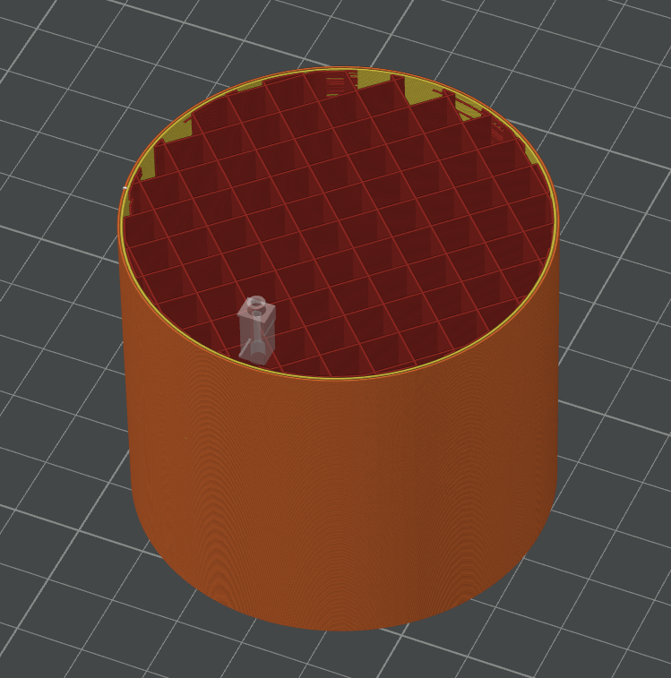

Anasazi37 Posted February 10, 2023 Posted February 10, 2023 42 minutes ago, jenius said: I'm ignorant when it comes to 3D printing but it seems like some things are being upscaled that don't need to be and might cost you a lot of time and resources. Like, up around the knee, it looks like the plastic there is like an inch thick. At this scale, I fear you'll end up with a toy so massive and heavy, you won't be able to move it! I'm guessing that they're using one of the standard hollow printing methods, where it looks solid from the outside, but has something like a 15% infill with a grid pattern to give the pieces strength but keep them very light and not waste a bunch of printing time and material. I see that all the time with large starship builds and use the method a lot myself. Slicing software handles that for you automatically, but you have to set the infill density and the pattern to use. Quote
Anasazi37 Posted February 10, 2023 Posted February 10, 2023 (edited) Something like this. I created a simple cylinder in my slicing program and then generated print instructions so that there would be a solid outer shell and a 15% infill grid pattern. What you're seeing is a peek inside the end result, part of the way through the print. You can basically "play" the print like a simulator and watch what it will do. That translucent grey thing is the virtual print head. Edited February 10, 2023 by Anasazi37 Quote

Anasazi37 Posted February 10, 2023 Posted February 10, 2023 8 hours ago, jenius said: Ah, I see! Lol, you still might end up needing a forklift to move it! Or at the very least, a trusted friend so you can each carry one side. It's going to be BIG. I'd be tempted to print this myself if the files are made available for purchase. It would be in line behind some large starship kits like the Aliens Dropship, Aliens Sulaco, Last Starfighter Gunstar, and Babylon 5 Omega Class Destroyer, but would be a fun project. The Omega Class, when printed, is more than a meter long and the central section rotates! I'm glad that folks like @bzwacks are putting their creations out there for us to admire. Quote

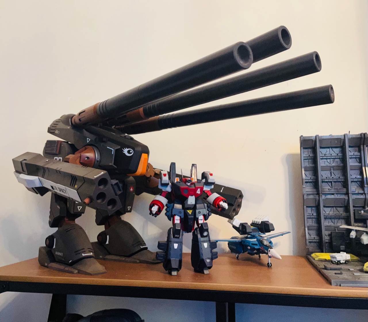

bzwacks Posted February 10, 2023 Author Posted February 10, 2023 The infill for the legs is around 20%. They need to be a little sturdier to bear the weight of the upper portions. Most parts are shell construction, so it reduces the overall weight. The one leg weighs 1lb 9oz. So, I will gander that the overall weight of the entire SDF-1 will clock in around 10-14lbs. Not too shabby. The upper guns are also shell constructions, so that reduces weight a lot. Screws and springs will add back a little weight, but it shouldn't be too bad. This bad boy ( 1/60 MKII Destroid Monster ) clocked in around 20lbs, but it also has counter weights in it's rear torso to balance out the length of the barrels. That's a 1/60 Yamato VF-1 Armor for scale. Quote
Anasazi37 Posted February 10, 2023 Posted February 10, 2023 3 hours ago, bzwacks said: The infill for the legs is around 20%. They need to be a little sturdier to bear the weight of the upper portions. Most parts are shell construction, so it reduces the overall weight. The one leg weighs 1lb 9oz. So, I will gander that the overall weight of the entire SDF-1 will clock in around 10-14lbs. Not too shabby. The upper guns are also shell constructions, so that reduces weight a lot. Screws and springs will add back a little weight, but it shouldn't be too bad. This bad boy ( 1/60 MKII Destroid Monster ) clocked in around 20lbs, but it also has counter weights in it's rear torso to balance out the length of the barrels. That's a 1/60 Yamato VF-1 Armor for scale. Is that a custom Monster design? Trying to decide if I should actually try to build the 1/72 Mike Salzo resin cast Monster that I've been hanging onto for 20 years or print this one. That is, assuming the files are available...somewhere.... Quote

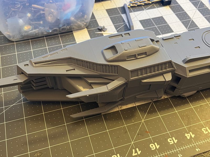

bzwacks Posted February 11, 2023 Author Posted February 11, 2023 Small, but important update for the SDF-1. I finished the main frame. It was printed with 4 layers of walling and 70% infill. It's VERY sturdy and will be the backbone of the over all build. Nothing special to look at, but it everything will be bolted to it. In the pic, some covers and the tops of the legs are attached to it for test fitting. Quote

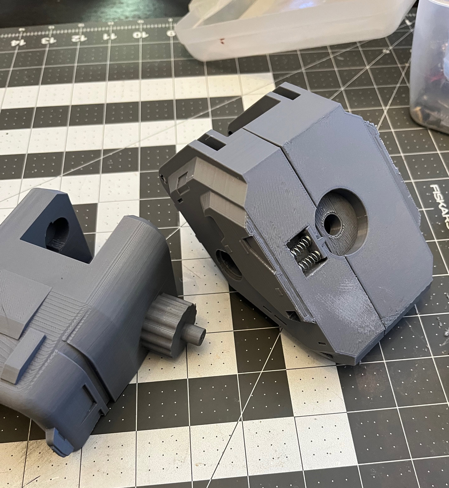

bzwacks Posted February 13, 2023 Author Posted February 13, 2023 Ratchet pin is working in the shoulder joints. The springs exert about 1.4lbs of force. May need to get beefier springs, but I won't know until the arm is built out and see how much downward force the extended assembly will put on the joint. Quote

bzwacks Posted February 17, 2023 Author Posted February 17, 2023 Finished up designing the arm joint...version 1. I'm 80% confident it will hold the weight of the ARM extended in place. Will probably require a couple of iterations to get it right. Quote

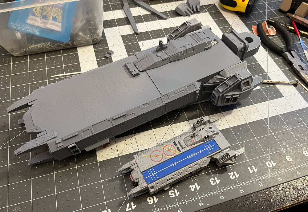

bzwacks Posted February 21, 2023 Author Posted February 21, 2023 Little brother and big brother together. As you can see, there is some misalignment between the front and back...The meshes line up exactly. One part was printed on an Ender and the other on a Prusa...may have had something to do with it. Quote
