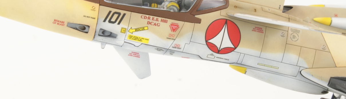

Goodman Models Posted February 1, 2023 Posted February 1, 2023 Hi All, Here's the completed build. It's the CAG bird of the (doubly) fictitious Sundowner squadron based out of the SDF-18. I went to great lengths to make the markings as authentic as possible as I could not find any decal sheets. I must thank Mark Wright for sending me an f-14 sheet, which sadly had deteriorated, but was very helpful in cutting my own masks and as guide for real decal placement! The serial number is the first part of the number and the '15' at the end represents the roll-out year, 2015. The weapons are in fact plumb and level to the plane although they look a little off kilter due to the angle is some of the pics, lol. The asymmetrical loadout is out of the Master File. There's also a couple of silvered decals I couldn't quite melt despite poking and soaking several times! Anyone have any other tricks? The kit really did have thick panel lines, but whatcha gonna do. I initially wanted to scratch build the VF-4 gunpod but then I didn't bother; I do enjoy the look of the GU-11 and I added brass barrels to it. The AN/ALQ-184 (Short) ECM Pod is a resin one from Brassin. I made up the pylon for it and the GU-11 from the spares bin. Someday I'll learn how to photoshop out the brass mounting rod, but pretty happy to have this one done as it has been a 'grail' design for me. Thanks for looking. Quote

Big s Posted February 1, 2023 Posted February 1, 2023 5 hours ago, Goodman Models said: There's also a couple of silvered decals I couldn't quite melt despite poking and soaking several times! Anyone have any other tricks? I haven’t had that problem since I started using gloss coat before the application. When I had a slightly dull surface though, I used to either scrap the decal by sanding it down and replacing it. But I did find that mixing the base color with clear and spraying it over the decal sometimes worked pretty well at hiding the silvering. There’s also the difficult method of masking the decal and just spraying the color over it or if you have super steady hands, there the xacto method where you lightly follow the outline of the markings and carefully peel away the bit that’s damaged, but I’ve never really been successful at that one. Hopefully, you find a method that works for you. Either way they are tiny blemishes on a fantastic build. Great job and can’t wait to see your next project Quote

Goodman Models Posted February 1, 2023 Author Posted February 1, 2023 15 hours ago, Big s said: I haven’t had that problem since I started using gloss coat before the application. When I had a slightly dull surface though, I used to either scrap the decal by sanding it down and replacing it. But I did find that mixing the base color with clear and spraying it over the decal sometimes worked pretty well at hiding the silvering. There’s also the difficult method of masking the decal and just spraying the color over it or if you have super steady hands, there the xacto method where you lightly follow the outline of the markings and carefully peel away the bit that’s damaged, but I’ve never really been successful at that one. Hopefully, you find a method that works for you. Either way they are tiny blemishes on a fantastic build. Great job and can’t wait to see your next project Thanks Big S! That's a good idea, I forgot about that - I will spray a bit of base coat + clear over them. I may try soaking the trouble markings one more time! Quote

Goodman Models Posted February 7, 2023 Author Posted February 7, 2023 On 1/31/2023 at 8:28 PM, Bolt said: You really did a beautiful job @Goodman Models I really love your finish and load out. The paint scheme and decals are awesome. Something I've noticed, looking at VF-4 examples all over, decal markings are minimal. You really brought this bird to life with ample markings! It looks Awesome! My hats off to you Thanks again Bolt! The markings are based on the placement guide in the VF 4 Master File and some additional information from modern fighters I have in various refs. I had to use a mix of navy, Gundam, kit and other macross sheets to get it right. Quote
