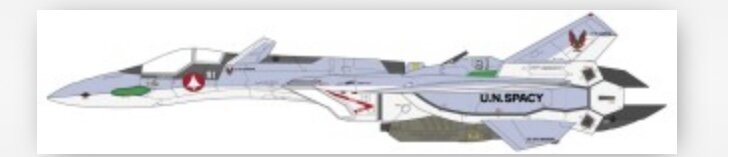

Can anyone clarify if the green accents on the shoulders/legs were supposed to match the clear green lens details on the accents to the sides of the cockpit? Hase just includes decals for them which contrast the clear parts. Trying to figure out if it needs to be corrected.

I see many examples where they do match.A97B582D-981C-4CD3-BD76-7463B717724A.jpeg.3f4de7dd6d64806db53801a3210eaaed.jpegAB4F889A-3D14-43A2-8534-8AF68AECB3EE.jpeg.f56cc24dd5ea7af4a7a571c949307b4a.jpeg
I think they should match in tone, hue and saturation; of course, they should not in refractivity and reflectivity... so, same but different?...
