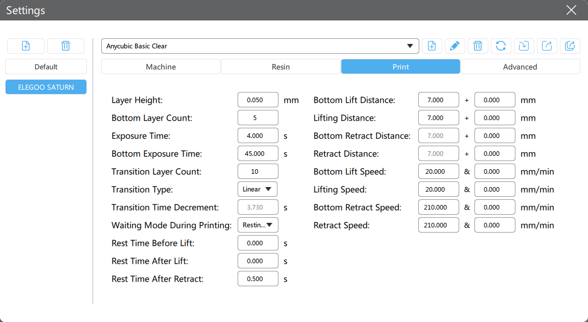

Anasazi37 Posted August 13, 2022 Posted August 13, 2022 1 hour ago, oshanmacross said: It's the clear parts that are an issue, I've seen printing clear parts with industrial grade printers and its a friggan crap shoot. I spent several weeks getting my consumer grade resin printer dialed in for handling clear parts, It was a big headache, but in the end worth the effort. My biggest issue was wavy lines of small "champagne bubbles" running vertically through printed parts. Took a lot of work to get that resolved. Result for a printed canopy after some progressive wet sanding and a quick dip in Future: I've since printed a lot of large clear parts of varying shapes and sizes and they came out well. All will need progressive wet sanding and dips in Future to make them look great, but that's to be expected. Just took a quick look at all the glass parts for the SDF-2. Most are pretty flat and those will be easier to print. I think the domes will be the most annoying because you'll have to use a bunch of supports and then do a lot of sanding to get rid of the small pock marks they leave behind after removal, but the sanding will work. Quote

Anasazi37 Posted August 16, 2022 Posted August 16, 2022 5 hours ago, Jasonc said: I do include the blue alcohol dye because I also add 10-20% Saraya Tech Tenacious. It has a clear but slightly yellow tint, which doesn't affect the blu clear v.2 too much, but I like being a bit cautious. Tenacious mix adds strength, but also flexibility, which is a property that is needed in some parts like a canopy. Those setting looks quite good. I've noticed that I have had to use a longer exposure time going from the Anycubi Mono X 4K to the Elegoo Saturn 2. I am still waiting on the Elegoo Jupiter, but I may end up biting the bullet and getting Anycubic's Photon M3 Max, which has about a 7K resolution. What I do like about Anycubic, is that their build plate doesn't use a ball joint to level, but 4 screws, which secures it extremely well, and doesn't require leveling all the time. I know I'm going off topic, but I will probably try these settings on the Saturn 2 to see how the canopies come out on my end using the same resin you are. Hope the experiment goes well! Quote

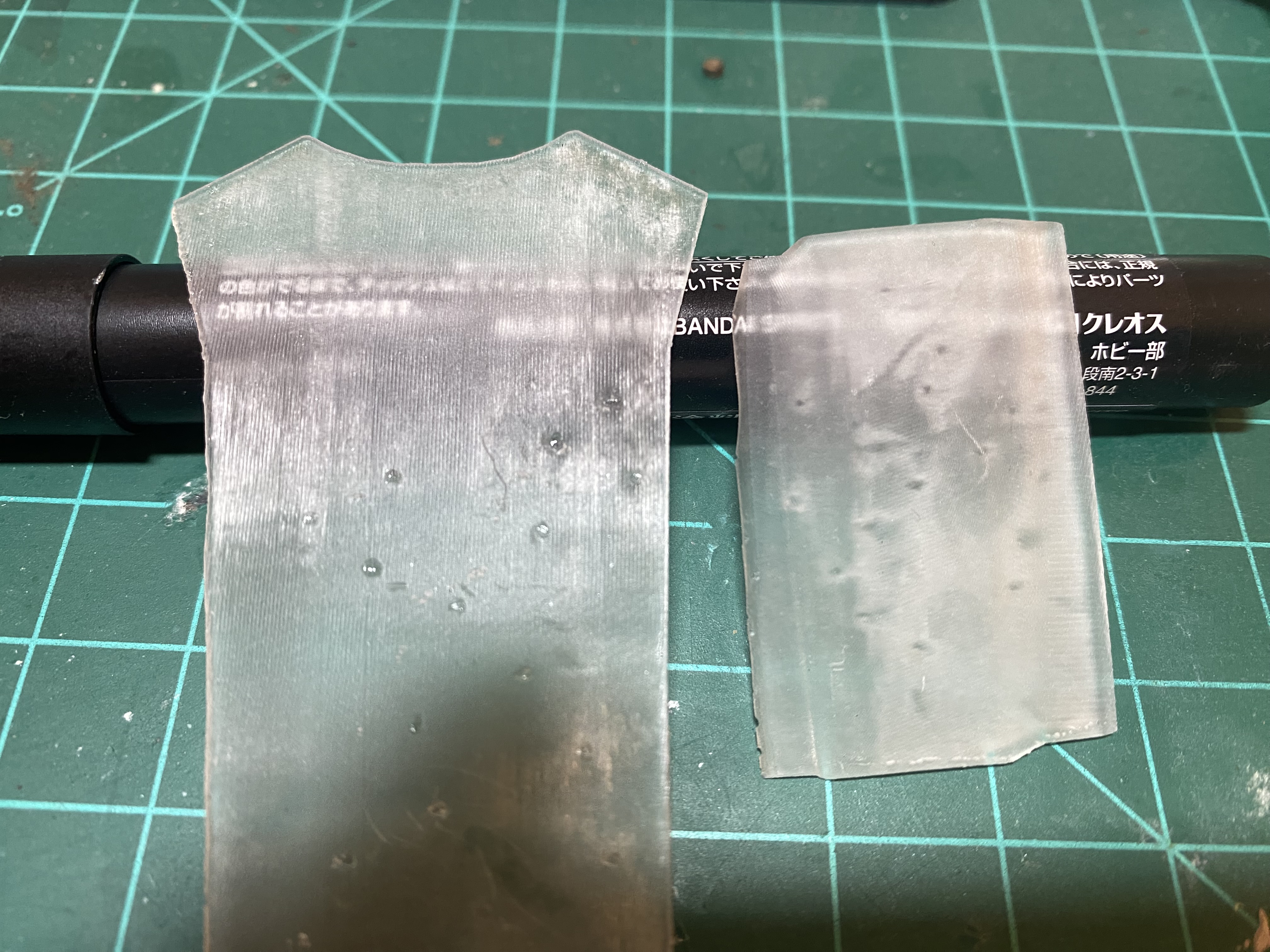

oshanmacross Posted November 29, 2022 Posted November 29, 2022 Anyone doing a build dairy for this beast perhaps on another site? I just got mine over the holiday and still figuring out methods for the clear parts. Quote
nightmareB4macross Posted November 29, 2022 Posted November 29, 2022 Post a picture of the parts. Are they really foggy? Or do they require a lot of filling of print lines? Quote

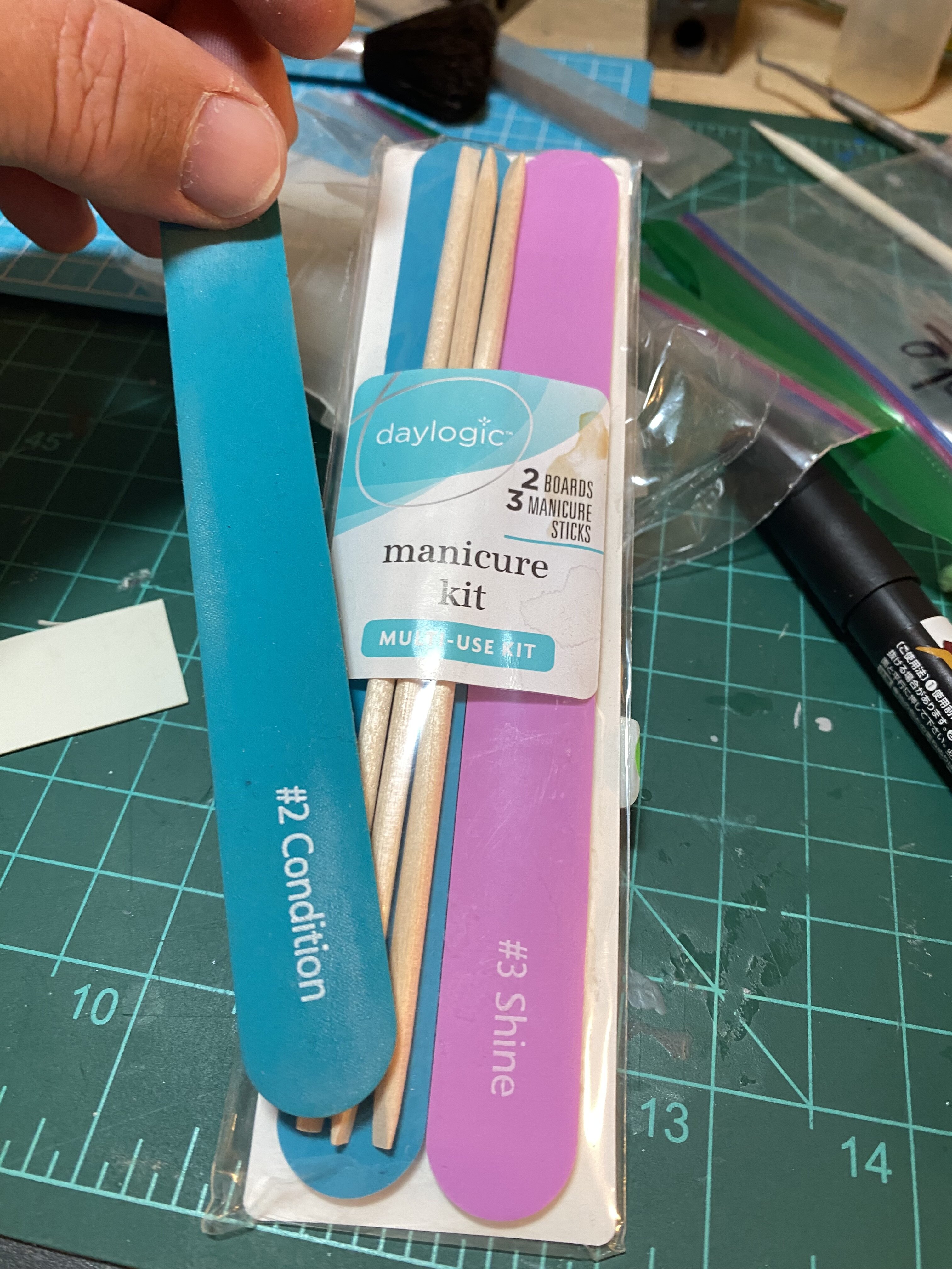

oshanmacross Posted November 30, 2022 Posted November 30, 2022 Here are the parts, In the past working with traditional resin parts I've had realy good luck finishing with nail manicure polishing boards. Then finishing off with NOVUS Plastic Polish. Quote
