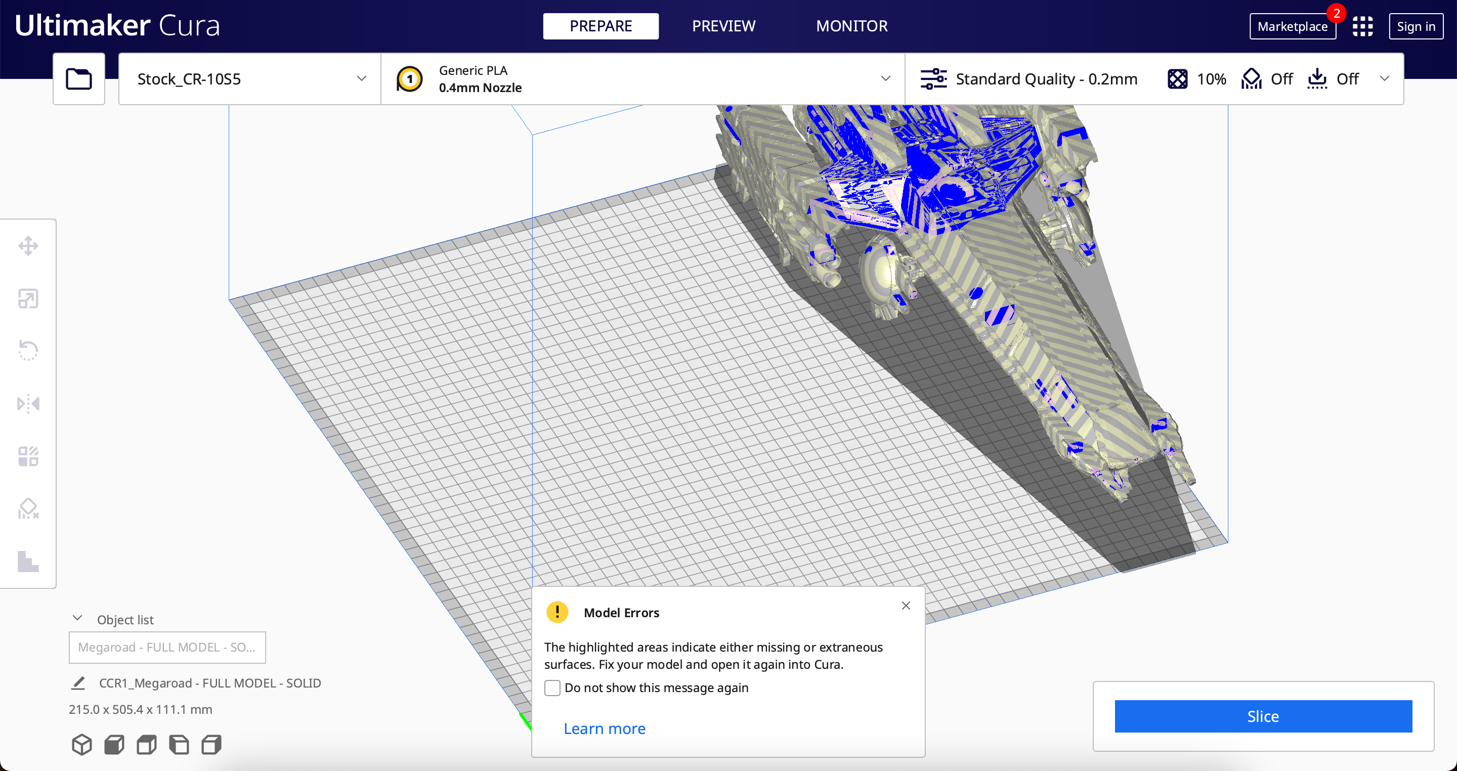

Hikuro Posted July 23, 2022 Posted July 23, 2022 (edited) I figured out what the problem was, so I take back what I had said about the scaling. It was entirely Cura's fault. With that being said there does seem to be issues in getting it to work properly, This is coming from the solid variation full model that you uploaded. This could lead to a total print failure I believe. Edited July 24, 2022 by Hikuro Quote
arbit Posted July 24, 2022 Author Posted July 24, 2022 (edited) 10 hours ago, Hikuro said: I figured out what the problem was, so I take back what I had said about the scaling. It was entirely Cura's fault. With that being said there does seem to be issues in getting it to work properly, This is coming from the solid variation full model that you uploaded. This could lead to a total print failure I believe. You are right, there are issues with the model. Senovis is working on a V2. Hold off on printing. Edited July 24, 2022 by arbit Quote
Hikuro Posted July 26, 2022 Posted July 26, 2022 Looks like Senovis already got the new version 2 uploaded and I'm no longer detecting errors. I'm gonna give this a shot since I'm not picking up any errors at this time. I did a little math with help from a scale calculator so if anyone else wants to follow along with the same idea, I'll be basing this on the old Yamato 1/3000 SDF-1 to match the original Macross. According to my math the model at 1/3000 scale should be 590mm in length, so gotta upscale it to 132.45%, that's easy. I'll post some progress pictures if everything turns out well by the end of the week. Quote

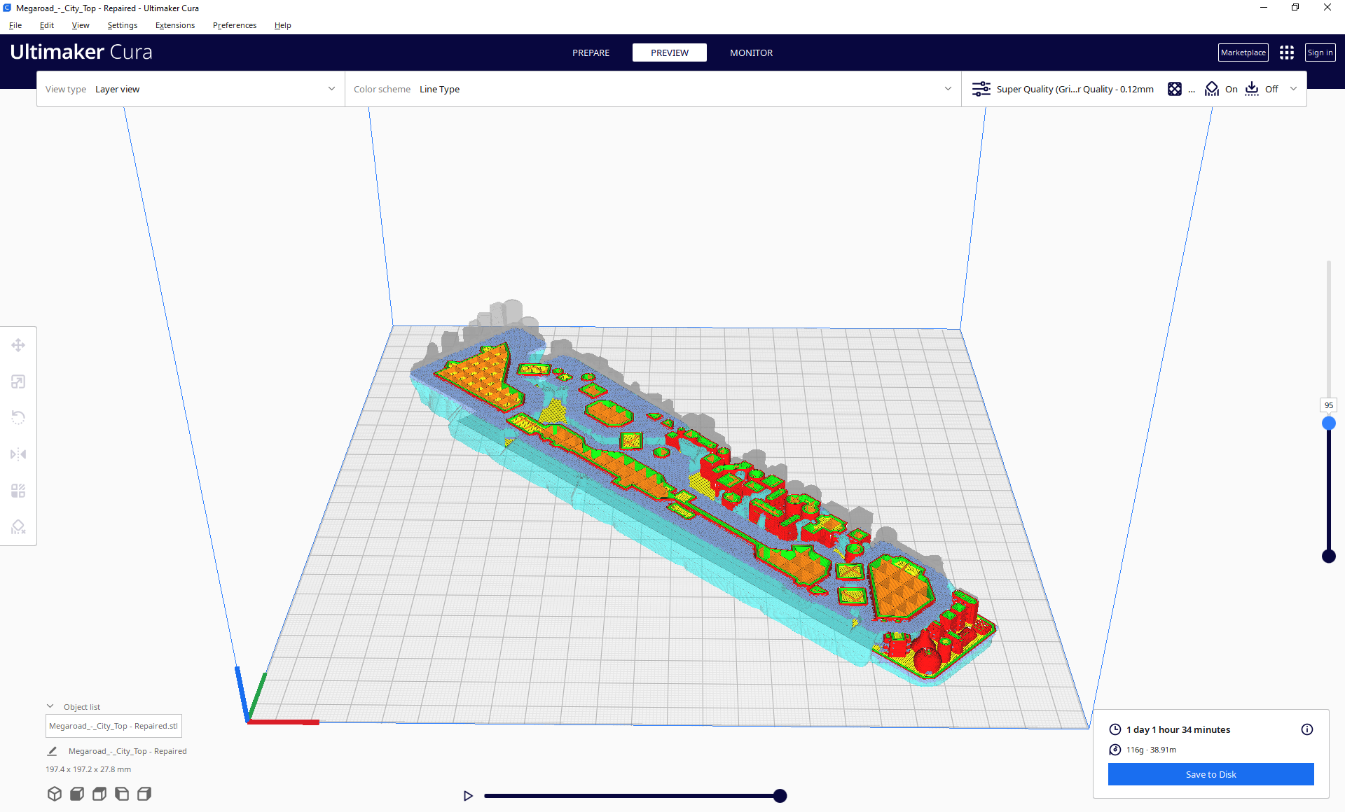

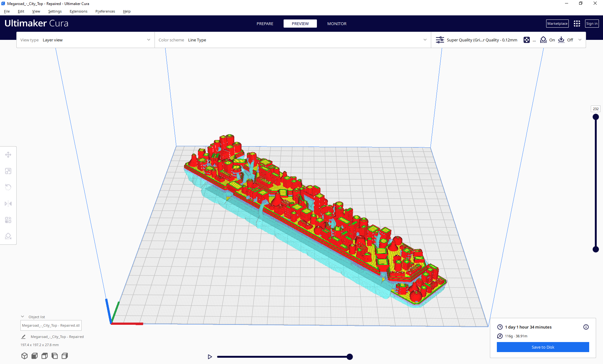

Anasazi37 Posted July 30, 2022 Posted July 30, 2022 (edited) Out of curiosity I pulled the top half of the city into Cura and sliced it for my Creality CR-6 SE using best print quality and lots of tree supports to help with all of the floating sections. Looks decent, but there will definitely be some cleanup after support removal. A 24hr print job doesn't scare me. Multiple sections of the 1/35 Gunstar I printed earlier this year required two days each (worth the wait). Edited July 30, 2022 by Anasazi37 Quote
