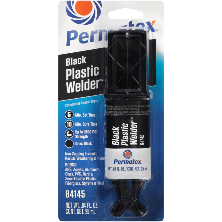

Permatex Plastic Welder; despite the name, it will bond metal quite strongly and very well, and it comes in black:
I use it all the time on various metals, and it holds very well.

Thanks a lot for the tip, however, i need to glue the plastic piece that wraps the metal one, functions like a hinge.

If it’s the plastic on plastic, you could try an abs glue like plastruct

Okay, I gotcha; the "metal build" part threw me a bit. What I would do then is glue the plastic piece, then coat the metal pin with vaseline or chap-stick and insert it in there to form the pin hole without adhering the pin. Then when it cures, remove the pin, file the part to the original dimensions, then reassemble the piece.

That's also a good idea; just use caution when doing this, as I've found it can change the dimensions slightly due to it melting a tiny bit of material and potentially shrinking the pinhole. You may need to re-drill the pinhole if that happens.
