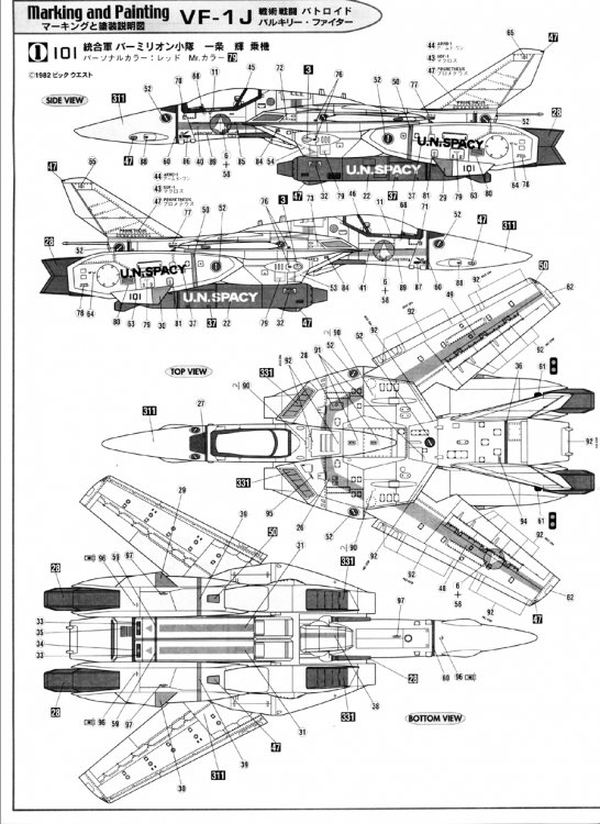

pandaren Posted September 26, 2004 Posted September 26, 2004 PANDAREN, Welcome! Have fun! the answer to your question is: HASEGAWA. I'm sure you can find the prints somewhere. Let me know and I'll hook you up if you can't. :Dat Thanx, man~~!! but i looking at website i also can't get it....or i really need 2 buy a model ?? n take as reference from it?
DatterBoy Posted September 28, 2004 Posted September 28, 2004 Well, my English isn't good enough to explain this the panel lines are "cuted" on the surface by using boolean operations. I create very thin cubes that match de panel lines, then I made a new copy of the leg for instance, resize it just a little, substract it to the cube and then substract the cube to the original leg. Holy Crap... I tried that once too and decided to leave it to bump mapping in the end, much for the same reason you're seeing. It warped my poly model so badly I coudn't and wouldn't have it. Still haven't figured out how to use bumps effectively to simulate it yet, seems to me I need to use a really big bitmap file to get the crispness of the lines. :Dat

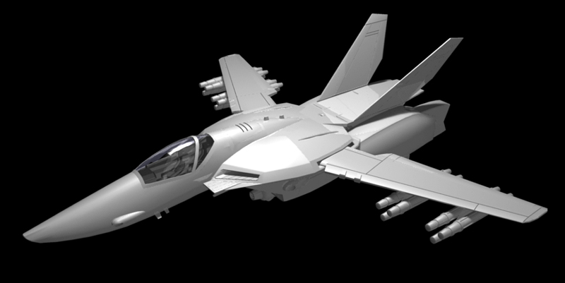

DatterBoy Posted September 28, 2004 Posted September 28, 2004 (edited) Thanx, man~~!! but i looking at website i also can't get it....or i really need 2 buy a model ?? n take as reference from it? I'm kinda surprised this isn't in tehthread so everyone can build their own! Let me know if you need a higher res picture. :Dat Edited September 28, 2004 by DatterBoy

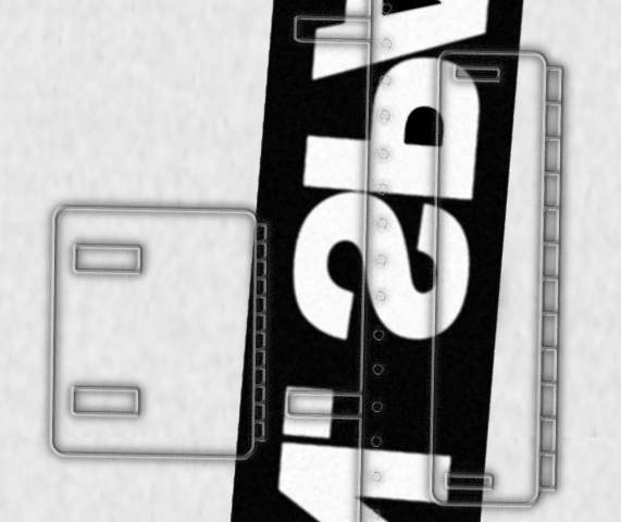

Aztek Posted September 28, 2004 Author Posted September 28, 2004 Dat, I don't know if this is what your looking for, but here is a clip from my leg texture. I had black panel lines I drew in Illustrator. I copied them and pasted them as a path in Photoshop, rasterized, embossed, and then inverted the image. Copy that new "inverted embossed panel line" on to your generic white "base coat" and you should get a similar result. My weathering isn't as accurate as I'd like it, so all I did was gaussian blur my panel lines to simulate wear. All my textures are in this resolution, so it makes rendering a bear. After I get all my texs finished and have my details the way I like, I'll resize them down to a processor friendly size.

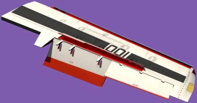

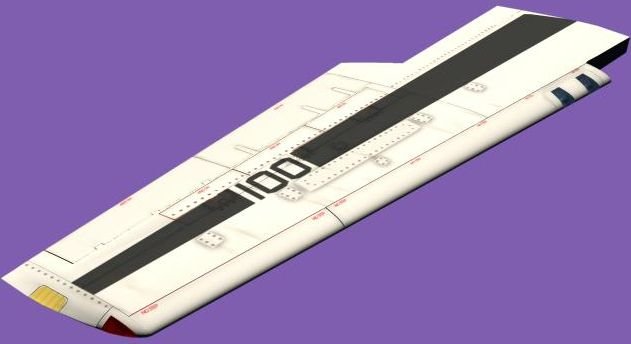

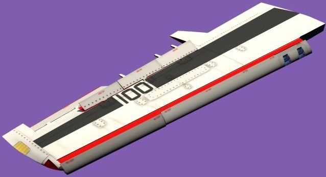

The_WOZ Posted October 10, 2004 Posted October 10, 2004 After some more BOOLEAN craziness there is my new remodelled wing

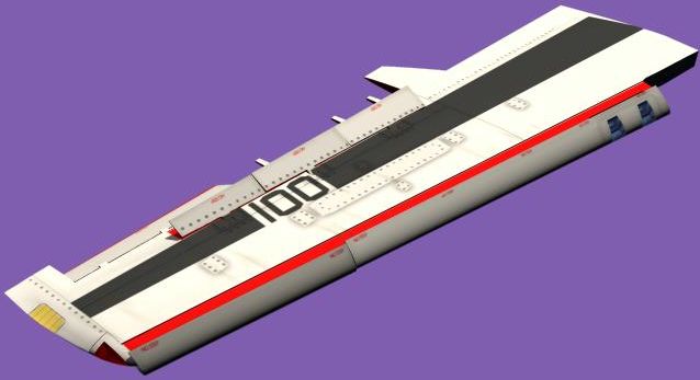

The_WOZ Posted October 10, 2004 Posted October 10, 2004 See? Booleans are my friends, since there is no draw tool in TS3.2
The_WOZ Posted October 10, 2004 Posted October 10, 2004 more BTW: The panels lines are modelled, and not rendered on the texture. Smaller riveting would look better isn't it?
Knight26 Posted October 10, 2004 Posted October 10, 2004 Nice woz, but the flaps are wrong, the VF-1's flaps don't simpyl fold down they are slotted flaps, will try to find some pics of this later.
Aztek Posted October 11, 2004 Author Posted October 11, 2004 The riveting isn't normally visible in the CG renders we've seen dealing with the valk. The "dots" you textured are screws and their size is relatively close to real world after you figure in the wear around the paint surrounding the screw. Rivets are usually so small, flush and numerous, that the factory paint usually conceals them. As individual rivets loosen over time due to stress and failure, they protrude through the paint and begin to emit fuel,lube or hydro stains and streaks. This usually happens in onezies and twozies, not completely along a panel or wing spar. If it did, there would be a major failure along a spar or rib, usually the result of cracking, and repair would be necessary. What you've got is good. I have the same style texture on mine. What I wanted to do in the future is lighten and blend about 40-50 percent of the visible screws into the base paint scheme of the valk. During panel removal not ALL of the screws are messed up so bad that they give off the signs of weathering that we have on our textures. Alot go back in so well that they blend back in to the structure, and when doing a preflight or post flight inspection, would not even be visible as a fastener unless you were specifically looking for it. Sorry I went on a tangent with this rivet detail, but I can appreciate the work you are putting in to your valk, so I wanted you to have this to use if you though it would enhance the realism. Also, When removing/replacing panels and the panel is a bitch coming off, we usually replace the screws rather than putting half rounded out screws back in. The panel is not repainted, nor are the screws. This ends up with zinc plated screws only being visible around the panel. It would be a cool effect to add to the valk on certain high maintenance panels. Maybe on one of the leg panels for engine maintenance. And some wing panels near the flaps, where the flap actuators would be. The zinc plated hardware is an aviation standard. It's a very light gold/yellow color. Again, just an idea I have and no time on my part to implement yet.

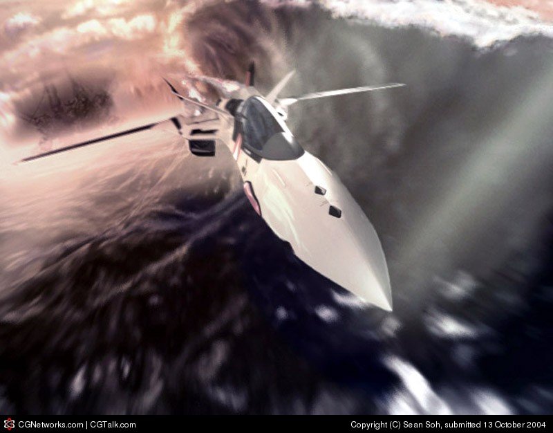

DatterBoy Posted October 14, 2004 Posted October 14, 2004 Saw this on CGTalk. Really nice model, thought you all would want to check it out http://cgtalk.com/showthread.php?t=177156
mcpaz Posted October 14, 2004 Posted October 14, 2004 Saw this on CGTalk. Really nice model, thought you all would want to check it outhttp://cgtalk.com/showthread.php?t=177156 Speechless. You have just left me speechless. This is the best yf-19 CGI I've ever seen. Definitely.
chrono Posted October 14, 2004 Posted October 14, 2004 I don't know HOW I missed that over at CGtalk!!! That render is hella sweet and it looks very well made. I'm just wondering if it's transformable.
Mr March Posted October 15, 2004 Posted October 15, 2004 Bloody hell! That's a great YF-19 model. I'd like to see some more shots when it's done.
Chronocidal Posted October 15, 2004 Posted October 15, 2004 If that thing does transform, it's probably a duplicate of that transforming Hasegawa kit that's been seen around.. that thing looks like a part-by-part duplicate of the Hasegawa -19 judging by some of the part seams and the overall shape.

assaultor Posted October 16, 2004 Posted October 16, 2004 Hi guys... thanks for inviting. By the way that's the YF19 Hasegawa non-transformable kit which is sold at 2400 yen. Is there a transformable version around? i din know that. :/
Doktor Gonzo Posted October 16, 2004 Posted October 16, 2004 Hi guys... thanks for inviting. By the way that's the YF19 Hasegawa non-transformable kit which is sold at 2400 yen. Is there a transformable version around? i din know that. :/ Hi Assaultor! Are you the Sean Soh who did the VF-19 model posted at CG Talk? If so, beautiful work!
AlphaHX Posted October 16, 2004 Posted October 16, 2004 Hi Assaultor! Are you the Sean Soh who did the VF-19 model posted at CG Talk?If so, beautiful work! i agree!!! absolutely stunning!!! welcome to macross world!!!! Hi guys... thanks for inviting. By the way that's the YF19 Hasegawa non-transformable kit which is sold at 2400 yen. Is there a transformable version around? i din know that. :/ There is a transformable one around but its really expensive and a bit harder to find now. heres a link: Studio HalfEye YF-19
The_WOZ Posted October 17, 2004 Posted October 17, 2004 Nice woz, but the flaps are wrong, the VF-1's flaps don't simpyl fold down they are slotted flaps, will try to find some pics of this later. I know I know, but I model de flaps before looking for references. See F-111.net Slotted Fowler flaps are really complex things.

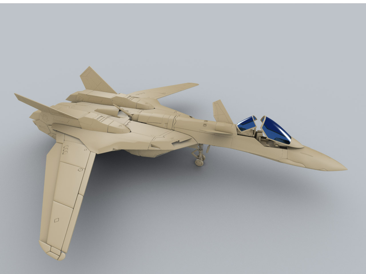

DatterBoy Posted October 20, 2004 Posted October 20, 2004 imagine a realistic looking valk that looked perfect in all three modes. ( 8^( L) droooool I think YAMATO is pretty damn close with their 1/48... :Dat

DatterBoy Posted October 21, 2004 Posted October 21, 2004 WOZ, Can I see a wire to see how you approached the modelling of the wing? Been trying to make a decent wing but can't fugure the best way to go about it. :Dat
