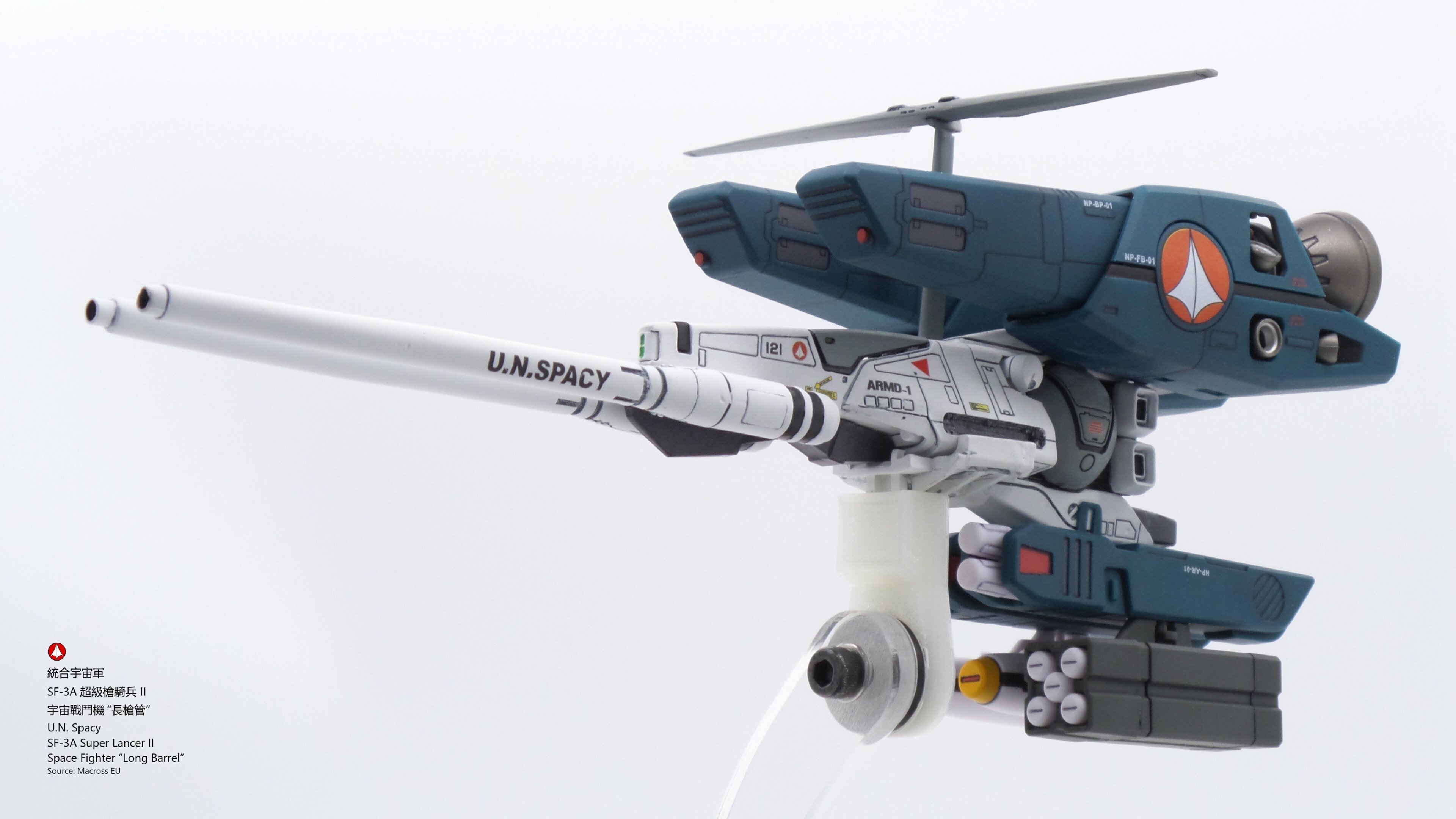

Mintox Posted February 16, 2022 Posted February 16, 2022 Now the Commanchero is finished, its on to the next commission job, a 1/72 Lancer with Super Packs or Super Lancer II. Ive stolen the image below for reference. Quote
Goodman Models Posted February 16, 2022 Posted February 16, 2022 Awesome subject! Looks great with the super pack. Quote
Bolt Posted February 16, 2022 Posted February 16, 2022 Very cool. I'm working on that very model as well, and doing the super lancer too. Very much looking forward to seeing your work 👍🏼 Quote

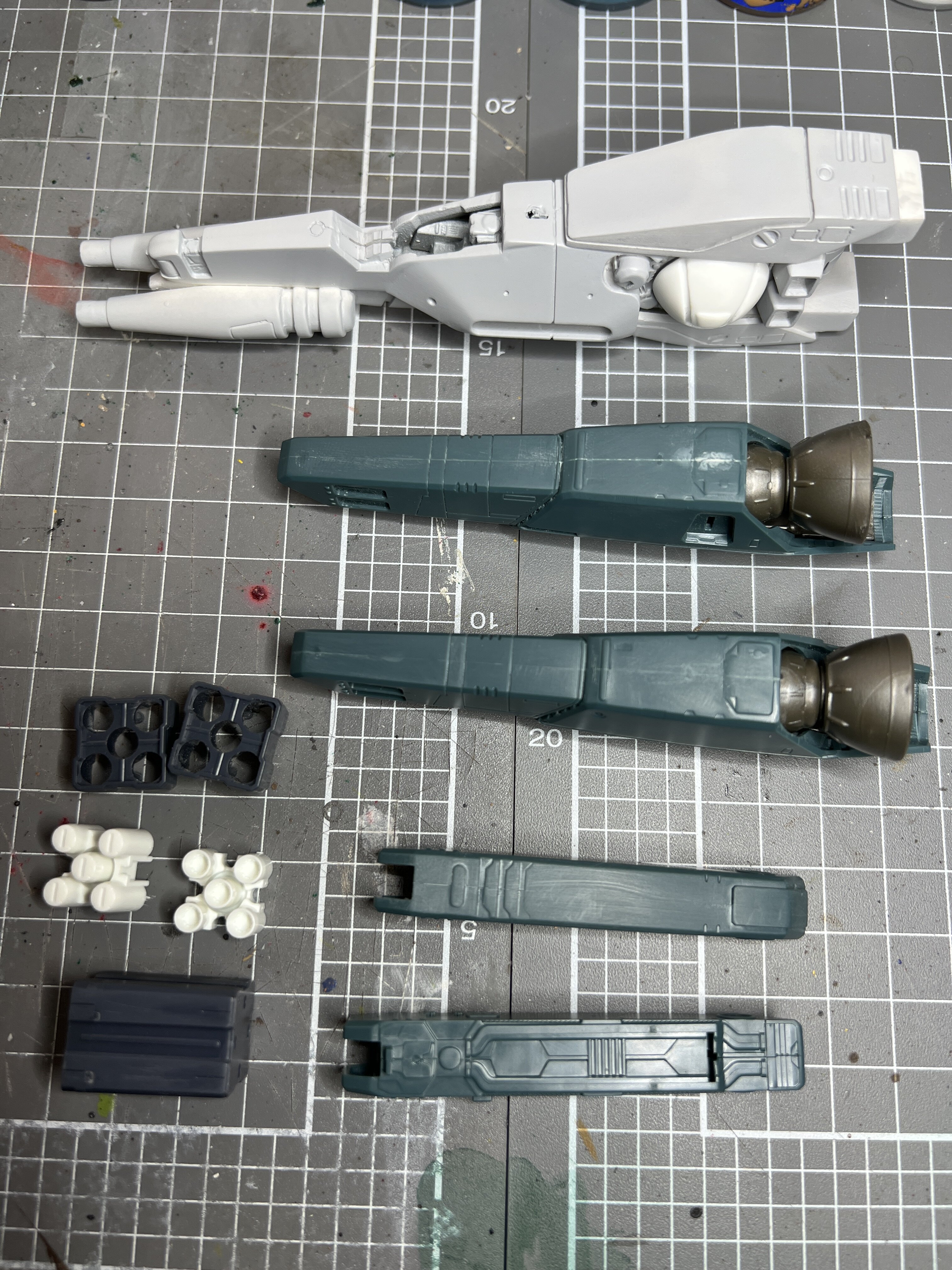

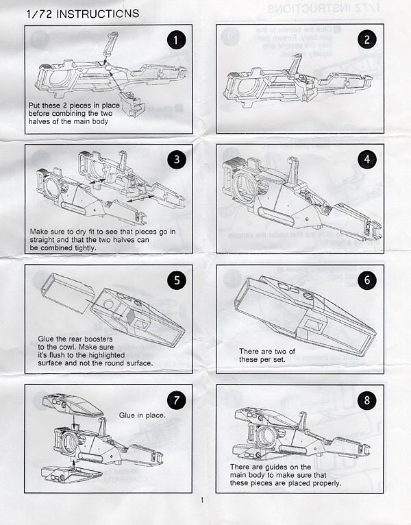

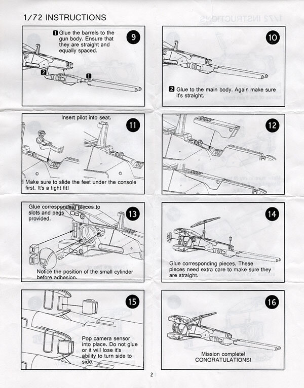

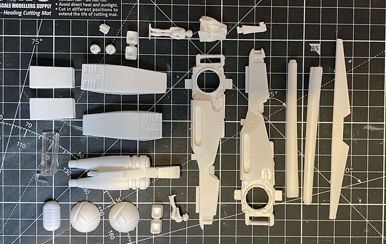

Mintox Posted March 6, 2022 Author Posted March 6, 2022 (edited) Parts breakdown for the Lancer and instructions Edited March 6, 2022 by Mintox Quote
Mintox Posted March 6, 2022 Author Posted March 6, 2022 4 hours ago, Bolt said: Nice! How are the long barrels? Any bowing ? Surprisingly they are straight. Quote

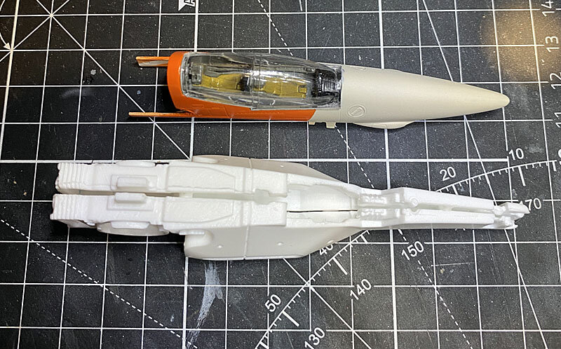

Mintox Posted March 11, 2022 Author Posted March 11, 2022 So Ive begun the Lancer build. Im still cleaning up the two main body halves but thought it interesting to compare sizes. Here it is next to a VT-1 Ostrich cockpit module. It really is a small vehicle without those big guns on the front. Quote
Big s Posted March 11, 2022 Posted March 11, 2022 That scale comparison really puts things into perspective. I always thought the lancers were a lot bigger than that. Quote
Bolt Posted March 11, 2022 Posted March 11, 2022 Once the rear thrusters are added and the long barrels, it looks better proportioned. Still, it's just a single pilot space gun.. Quote

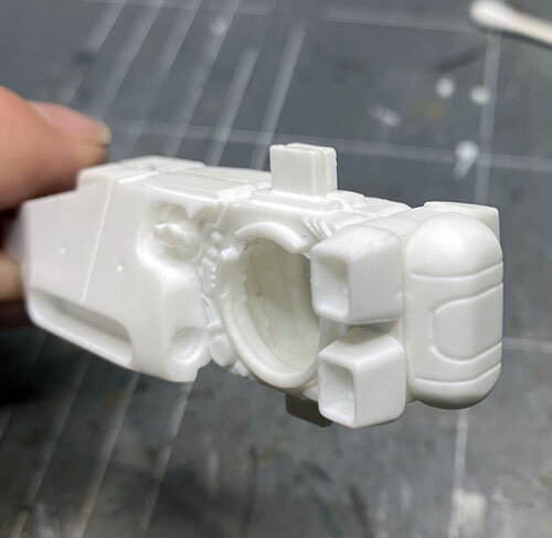

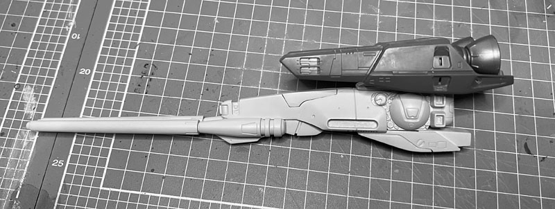

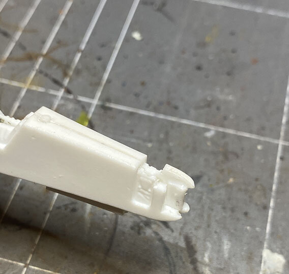

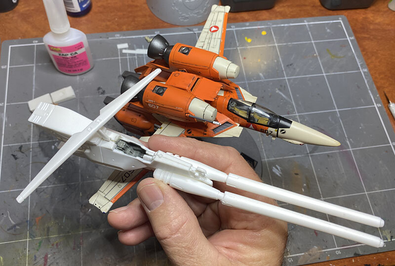

Mintox Posted May 11, 2022 Author Posted May 11, 2022 Ok Ive started back on the Super Lancer. Two shots here, one showing the relative long and skinny profile of the Lancer compared to the Ostrich, and a nasty mold defect on the nose which will need patching up. Part fit isnt bad. There is a lot of cleanup required though. The resin is that soapy, plasticee resin which is a bitch to glue even with good quality super glue. Quote
Bolt Posted May 11, 2022 Posted May 11, 2022 Wow. I didn't realize how long that baby is , compared to a VF 🤔. Ooo nasty indeed ! Looking forward to more. Quote
Knight26 Posted May 11, 2022 Posted May 11, 2022 Seeing it with the super packs, and then next to the VT-1 helps to make it clear that Strike Pack is basically the evolution of the craft. It might be cool to see a stripped-down Lancer being used as a proto-strike pack. Quote

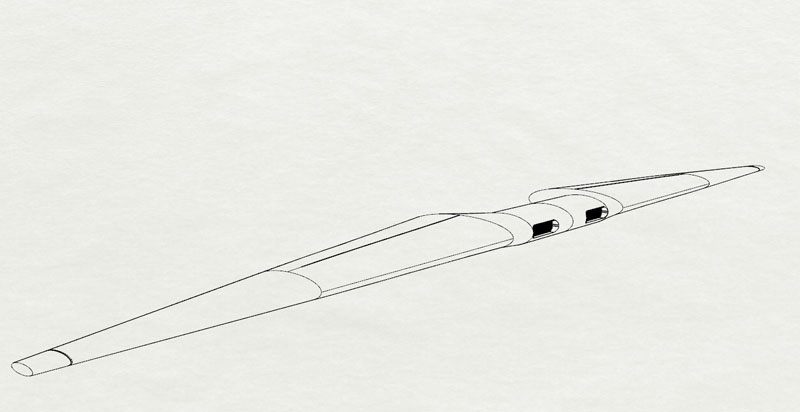

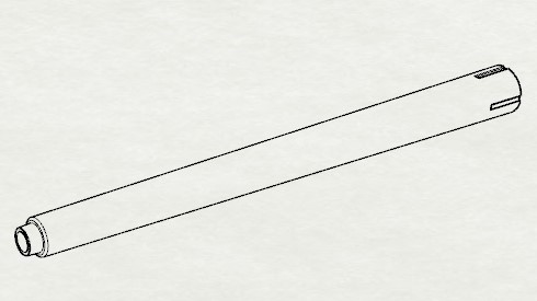

Mintox Posted December 20, 2022 Author Posted December 20, 2022 Long time no post. Apologies. I have been working on the Super Lancer. Most of the major parts are completed. Issues with the main body have been sorted and it is looking good. Im now waiting for my new resin printer to arrive so I can print some additional parts and print some parts Ive redesigned for it - the sensor mast needs to be taller to clear the booster pods and the canopy that comes with the kit is such a poor fit I've designed my own along with replacing the gun barrels which were too warped for my OCD to use. I designed my own fittings/mounts for the additional super pack needs to be printed out. Ive also included a pict of the replacement barrels. Quote
Bolt Posted December 20, 2022 Posted December 20, 2022 Looks great! That's awesome you're printing parts for it. Including the sensor mast. I used a piece of model sprue and some putty for mine, but it warped. Back to square one.. Looking forward to seeing this come along Quote

Goodman Models Posted December 25, 2022 Posted December 25, 2022 Very cool. You should be well on your way with having done the 72nd version. Which fast packs are you using here? Quote
Mintox Posted December 27, 2022 Author Posted December 27, 2022 On 12/26/2022 at 12:28 AM, Goodman Models said: Very cool. You should be well on your way with having done the 72nd version. Which fast packs are you using here? These are the Bandai ones. Very nice and better in than the Hasegawa ones. Quote

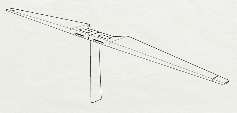

Mintox Posted January 4, 2023 Author Posted January 4, 2023 While Im (still) waiting for resin to arrive, here is a shot of the replacement sensor wing for the Lancer. Way better than the lump in the kit and much closer to the line art. Quote

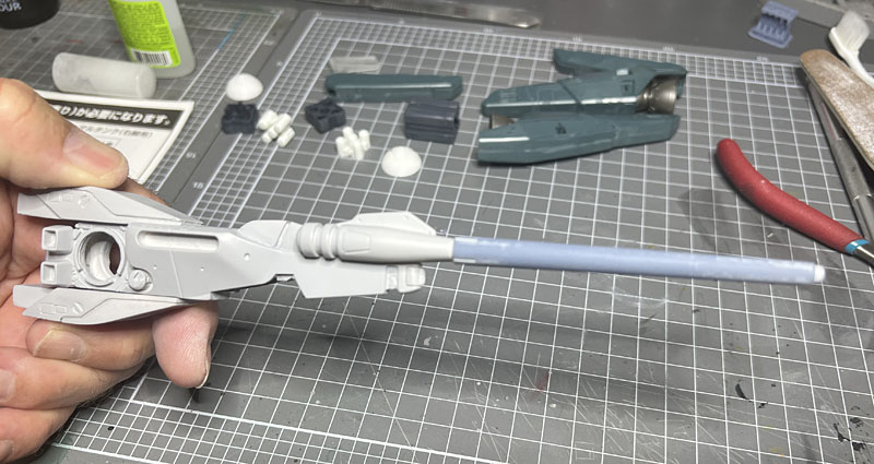

Mintox Posted February 18, 2023 Author Posted February 18, 2023 Quick update. Resin printed replacement guns in place. Quote
Mintox Posted February 25, 2023 Author Posted February 25, 2023 Super packs added. These are on temporarily for now. Quote
Mintox Posted February 27, 2023 Author Posted February 27, 2023 I designed a new scanner and mast to clear the booster packs. Now to print it out. Quote
