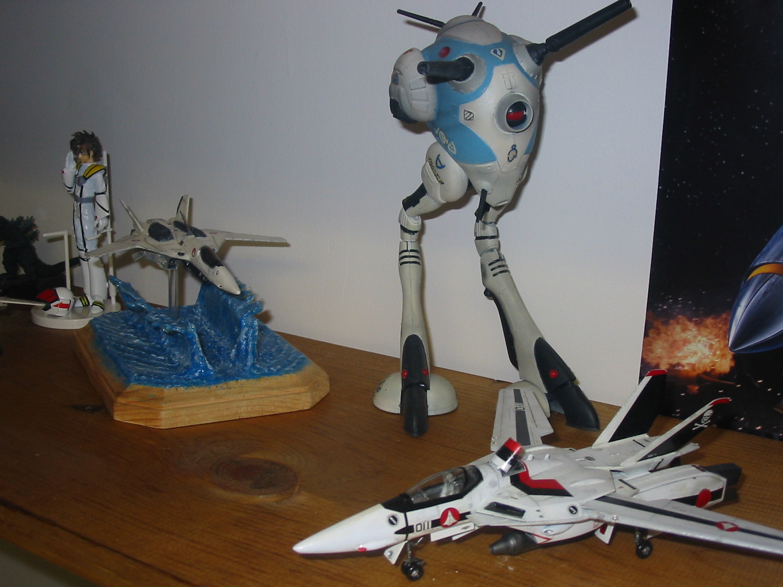

Mechleader Posted January 28, 2004 Posted January 28, 2004 Hi there! I have a problem with the oil wash. I built a hase VF and gave it an oil wash as per WM Change's technique. It worked with no problems. Six months later I noticed that parts of the model are now yellowing where I did the oil wash. I sealed it with the gloss before the wahs and whiped it away with mineral spirits afterwords. The model was fine when I was done with the kit. Now...yellow. . What did I do wrong with the oil wash???? Any help would be greatful. Thanks. Quote
kanata67 Posted January 28, 2004 Posted January 28, 2004 well... this goes back to the standard yellowing of toys type thing. Depending on what you did before the wash and how thick the covering of the plastic was... Washes are dilute [i use water based acrylic myself but oil should be no different I would think] and as such don't provide complete protection of what you washed, especially depending on the color of the wash and the paints applied before the wash. There is also the possiblity that the wash itself caused a slow yellowing reaction... Is the wash itself still visible? Is it more, or less, yellowed where the wash was thickest? was it exposed to direct sunlight? any pics? Quote
Mechleader Posted January 28, 2004 Author Posted January 28, 2004 Hi, Yes the yellow is stonger where the wash is. I did a prime of black the used Tamiya water based acrylic for two coats of white. Then sealed it with Semi-gloss. The wash is visible where it should be...i.e. Pannel lines. Not exposed to direct sunlight. Pic coming soon. Waiting for friends camera. Quote

wm cheng Posted January 29, 2004 Posted January 29, 2004 Sorry to hear about the yellow Mechleader, Any closeup photos for me to see? My models are in a pretty bright room and sometimes even gets direct sunlight in the winter! and they are still fine after 2 years with this technique. I am wondering, did you let the oils dry before sealing them in with the clear coat (I let mine dry at least 24 hrs) Did you wipe away all the excess? What kind of solvent did you use to thin the oil paints - was it low odour varsol? Maybe you should try a different thinner - get a scrap or cheap kit and re-do the panel wash and let it sit to see if it does it again. How long did it take for the yellowing to appear? I have heard somewhere that Future could yellow slightly over time with direct exposure to sunlight. Becareful when you thin the oils down, if you thin too much the colour might break up into little particles (cheaper oils do this) you don't want to go that far. Quote
Mechleader Posted January 30, 2004 Author Posted January 30, 2004 Hi, wm cheng. No sunlight. Infact it was in a plastic box in a cool enviorment for six months. I let the oil dry for a couple of hours. Yes I used low order varsol. I never applied the future though. I'm going to try that with this new one I'm doing. Quote
Mechleader Posted January 30, 2004 Author Posted January 30, 2004 (edited) Can't see too much of it except in the middle of the nose and the back fins. Edited January 30, 2004 by Mechleader Quote
