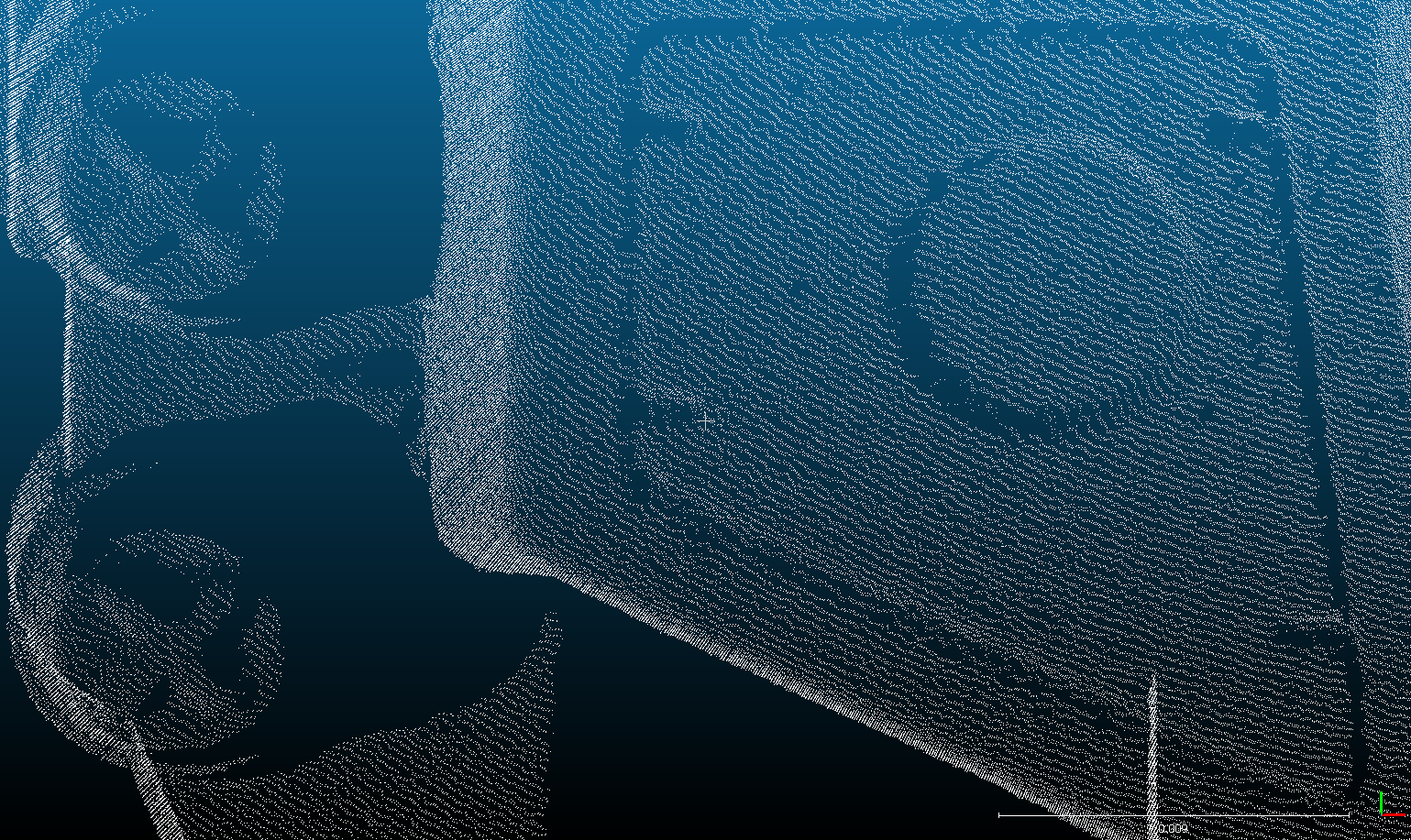

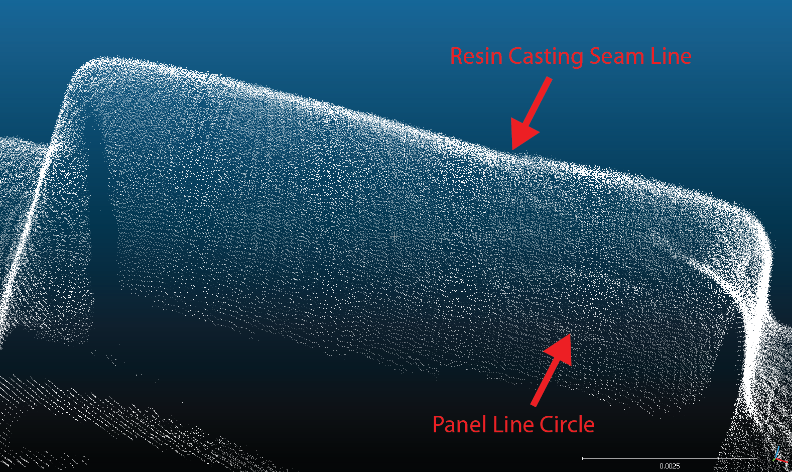

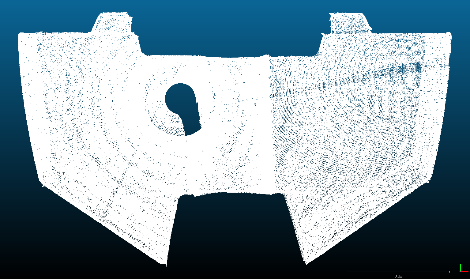

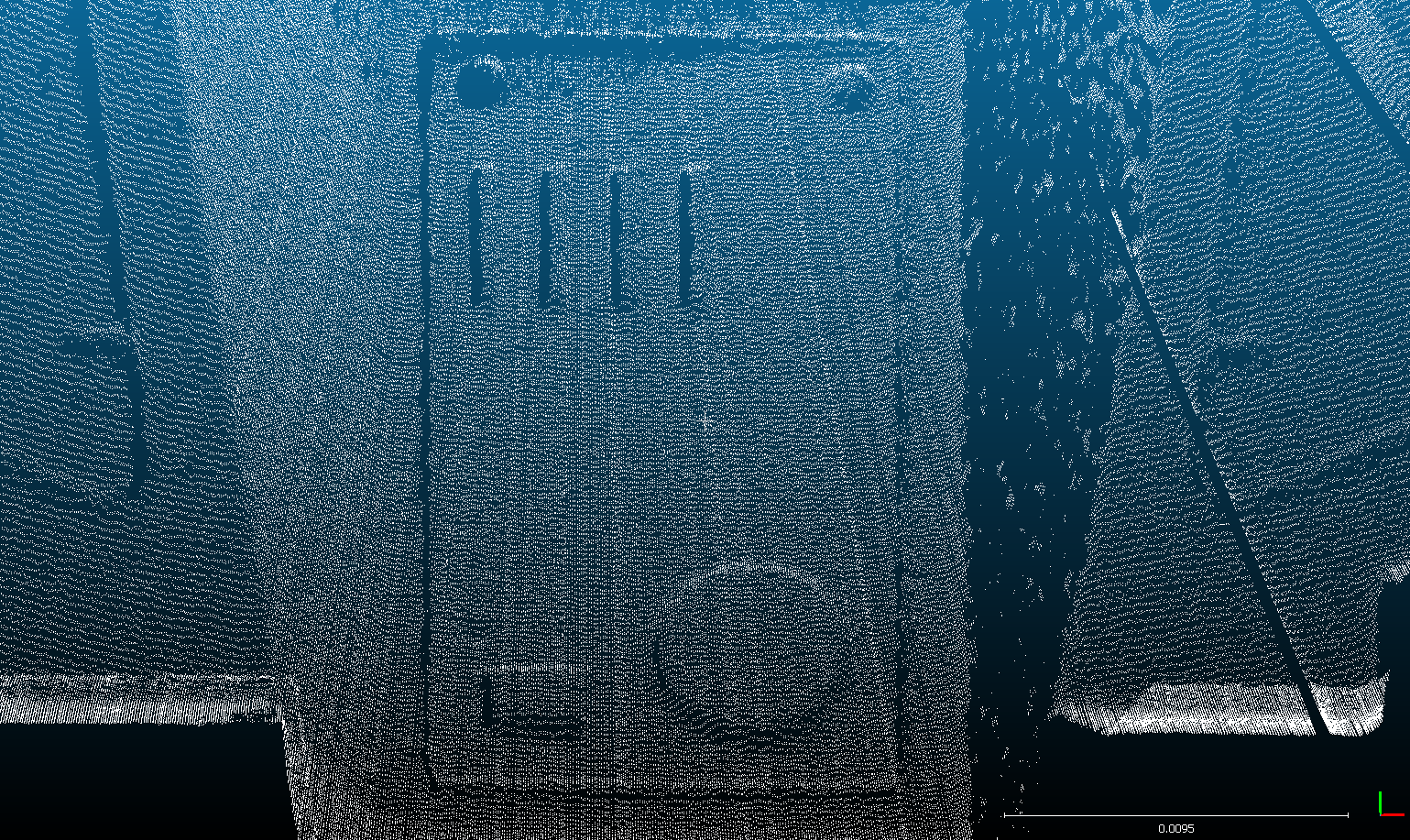

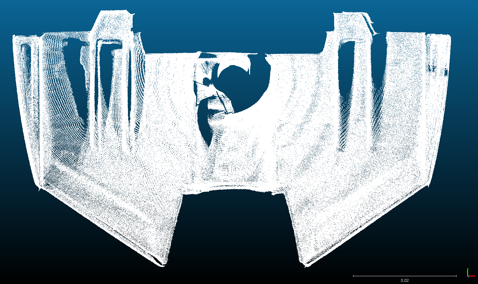

Anasazi37 Posted July 11, 2021 Posted July 11, 2021 (edited) I've been working on this project on and off since last November, but it's finally nearing completion! My original goal was to purchase a scanner so I could create a digital archive of ultra-rare 1/55 resin cast parts (e.g., heads, heatshields, nosecones, armor...) before I used them on customs, but the affordable ones (less than $1000) sucked and the less affordable ones didn't give me the amount of control and accuracy I expected for the high price tag, so I decided to build my own from the ground up. I designed the system, sourced all of the components, fabricated what I needed to, and wrote all of the software from scratch. All told, this cost less than the affordable systems and is far more capable than the less affordable ones. This weekend I started collecting and processing data in order to get the system dialed in and I wanted to share my first "test shot," which contains a very familiar 1/55 object. What you see below (click on the images to embiggen) represents only a fraction of the system's accuracy, as I don't want to dial it up to 11 until I know everything is working correctly. And it's only one scan. Normally you combine multiple scans before producing a 3D model. This is the raw data, comprised of millions of 3D points, which is fun to look at because you can see exactly what the system was able to scan. The "shadowed" areas weren't visible to the sensor because the part was lying flat on the turntable. Hence why you do multiple scans with the object in different orientations to build up a composite. Even in this reduced resolution test scanning mode, the system is capturing a remarkable amount of detail. Stay tuned for updates. Getting the system dialed in could take me a few more weeks.... Edited July 11, 2021 by Anasazi37 Quote
Sanity is Optional Posted July 12, 2021 Posted July 12, 2021 Very impressive, are you going to try and add in a smoothing function to the generated mesh? Or handle that in a CAD program separately? Quote

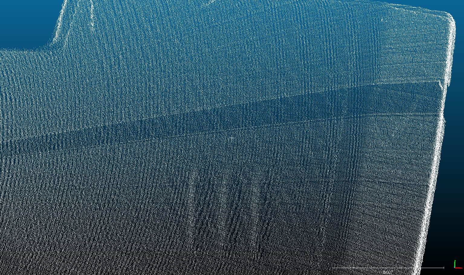

Anasazi37 Posted July 12, 2021 Author Posted July 12, 2021 On 7/11/2021 at 11:24 PM, Bolt said: Wow..! Simply wow @Anasazi37 this is genius!! Expand Thanks, Bolt! This has been a massive labor of love. It's nice to be close to finishing the project so I can start doing some actual scanning of Macross stuff. On 7/12/2021 at 5:35 AM, Sanity is Optional said: Very impressive, are you going to try and add in a smoothing function to the generated mesh? Or handle that in a CAD program separately? Expand That's one of the things I'm working on now, in addition to refining the calibration process. Plan is to do some initial cleaning of each scan to get rid of the inevitable noise, do scan-to-scan registration to build the final composite point cloud, generate an initial mesh to define the general surface characteristics, then clean that up. I definitely don't want to get too aggressive with the smoothing, though, since that might wipe out all of the fine detail I'm trying to capture. It's a balancing act, but one that I hope is helped by how I designed the system (there's very little noise to begin with). I'm also, out of principle, doing everything using open source software libraries or, at the very least, off-the-shelf open source applications that specialize in working with this kind of data. One my biggest gripes with the commercially-available systems, even the expensive ones, is how "closed" they all are. You either can't get to the raw scan data, can't adjust how the system collects and processes the raw data, or both. There's a "push this button and wait for results" mindset, which I'm sure is driven in large part by consumers who just want a pretty 3D model and don't care how that happens, but that's not me. Ultimately, the end user should be able to put the individual scans and composite cloud into a CAD program and do what they want with it, but to meet my own needs, I'll definitely be doing some sophisticated surface reconstruction. Quote
Sanity is Optional Posted July 12, 2021 Posted July 12, 2021 Well, if all else fails you can try to de-noise by just running multiple scans and averaging the results. The 0.2um resolution x-ray microscope I built for my previous company averaged 10 images per viewing angle to get better SNR. Honestly your mesh already looks great. What did you use for an initial sample to set up the alignment? Quote
Anasazi37 Posted July 13, 2021 Author Posted July 13, 2021 On 7/12/2021 at 10:28 PM, Sanity is Optional said: Well, if all else fails you can try to de-noise by just running multiple scans and averaging the results. The 0.2um resolution x-ray microscope I built for my previous company averaged 10 images per viewing angle to get better SNR. Honestly your mesh already looks great. What did you use for an initial sample to set up the alignment? Expand Yep, increasing the dwell time will definitely drive up the SNR. Lots of options to explore! Yeah, I was floored by how good the initial data looked. I was expecting more noise, but I really tried to eliminate as many sources as I could and it seems to have paid off. The system, which has both passive and active sensing components, self-calibrates using a target pattern of unique black and white shapes that are laid out on a flat panel in a very specific way. Allows me to know the exact 3D orientation of the target panel with respect to the system at all times, as it moves around during the calibration process, and since I know the exact spatial characteristics of the pattern, I can back out necessary corrections to allow for fast and accurate determination of 3D coordinates based on scanner "hits." And since the system self-calibrates, I can reposition everything for different kinds of scans. The current setup has the sensor package pulled way back, for larger objects. I can move it in pretty close. Imagine a scan of a 1/55 head comprised of millions of points. I'm eager to try that. I think the biggest limiting factor to resolution will be how well I know the performance of the active sensing portion of the system. Right now that's kinda iffy, but the results so far are encouraging. Quote

Anasazi37 Posted July 14, 2021 Author Posted July 14, 2021 On 7/13/2021 at 5:30 AM, Sanity is Optional said: Sounds really cool, definitely interested to see what you can do with it. Also let me know if you want to open-source it, or set up a kickstarter 😅 I've been looking for a decent 3D scanner that isn't business pricing. Expand The process of getting the system dialed in looks like it will take several weeks, if I'm being realistic. There's some weird stuff happening during calibration that I don't fully understand yet. Need to run a lot of diagnostics. I'll try to post some more test scans of Macross items soon, even if they are just initial versions. I'm thinking of scanning a Chris Barretta 1/55 VF-1S custom resin head next, just to see what this system can do. I'd love to make the design and software open source, and maybe get some community backing to make kits that people can assemble on their own, but first I need to sort some stuff out with the intellectual property lawyers at work. This Covid hobby project is *just* close enough to what I do for a living that I'll have to talk to them. That is going to be so much fun. Quote

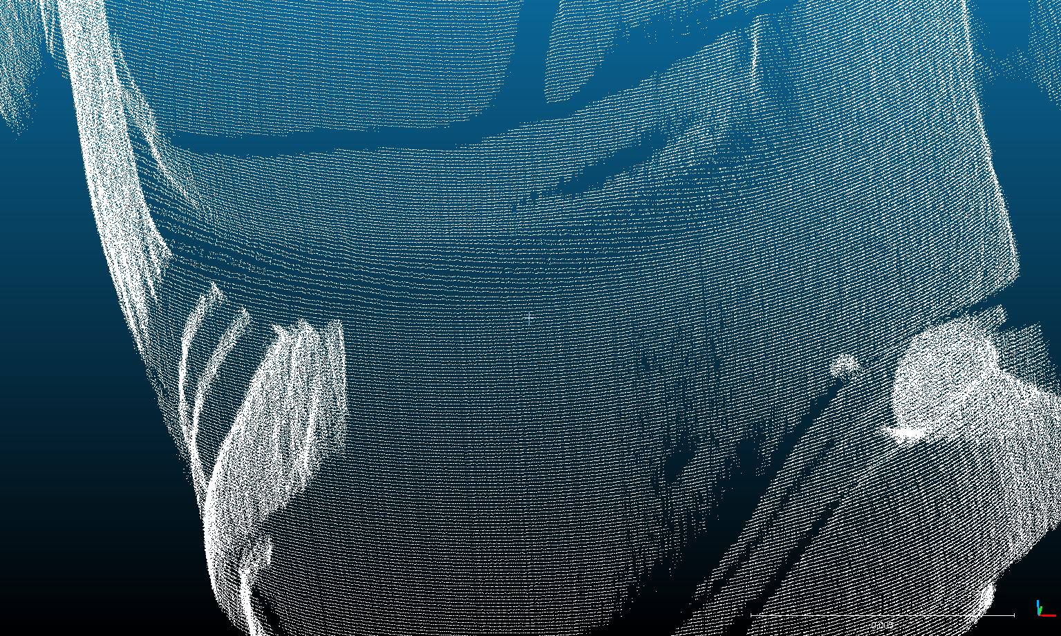

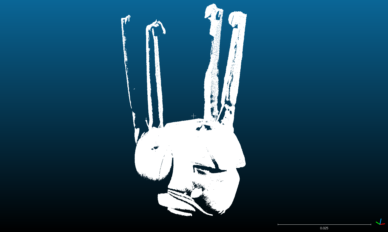

Anasazi37 Posted July 18, 2021 Author Posted July 18, 2021 Still fighting with the calibration process, but here's a quick single scan of a Chris Barretta 1/55 VF-1S head. I'm not zoomed in at all, so should hopefully be able to quadruple the resolution when the system is ready. I'll definitely have to combine multiple scans from different angles to create a good surface model. Quote
Sanity is Optional Posted July 18, 2021 Posted July 18, 2021 Dang, that's a nice mesh there. ...Which means you're going to have so much fun removing tiny pits and scratches 🤪 Quote
sqidd Posted July 18, 2021 Posted July 18, 2021 On 7/18/2021 at 6:50 AM, Sanity is Optional said: Dang, that's a nice mesh there. ...Which means you're going to have so much fun removing tiny pits and scratches 🤪 Expand I've never had to do that in a CAD program. How is it done? Quote
Anasazi37 Posted July 18, 2021 Author Posted July 18, 2021 (edited) On 7/18/2021 at 6:50 AM, Sanity is Optional said: Dang, that's a nice mesh there. ...Which means you're going to have so much fun removing tiny pits and scratches 🤪 Expand On 7/18/2021 at 11:48 AM, sqidd said: I've never had to do that in a CAD program. How is it done? Expand Automation to the rescue for most of that, thank goodness. Since the scanner's raw output is a point cloud, I can run it through some pretty sophisticated open source software that builds a mesh, looks at the results to see how "smooth" things are in a local region around each point (which become the vertices of the mesh), and makes adjustments. It's not perfect, though, and you risk losing fine detail if you let the software be aggressive about making adjustments. So yeah, there will be some hand-tuning of meshes in traditional CAD software as well. I think most of those programs have "mesh cleanup" options, too. I know you can draw a polygon around a section and ask it to simplify the geometry, which usually means "make this smoother." Even in the current test/calibration setup, the scanner is picking up the very subtle resin casting seam line on the top of the VF-1S head and the little panel line circle right at the front, just above the visor. Edited July 18, 2021 by Anasazi37 Quote
