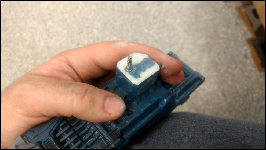

Issue 2: The SDF-1's right side giant shoulder cannon barrel does not light up. From my tested I know that the barrel's male 3mm jack does receive power correctly and the LEDs do light up when I use an extension wire. And I know that the main body's female 3mm jack is outputting power correctly. So it would seem that there was an issue with the fitment or molding such that it is not possible to push the cannon far enough into the main body so that the tip of the 3mm male jack properly contacts its target on the female end. I was wondering if there was a way to simply extend the tip slightly - maybe simply by adding a dot of solder?

My thought about adding solder to the male end stemmed from noticing that it's only a 2-part jack and that the barrel is very long compared to the tip. So if I added a mm or so of solder to the tip, the rear barrel portion could still make contact anywhere along its (appx.) 4mm length.

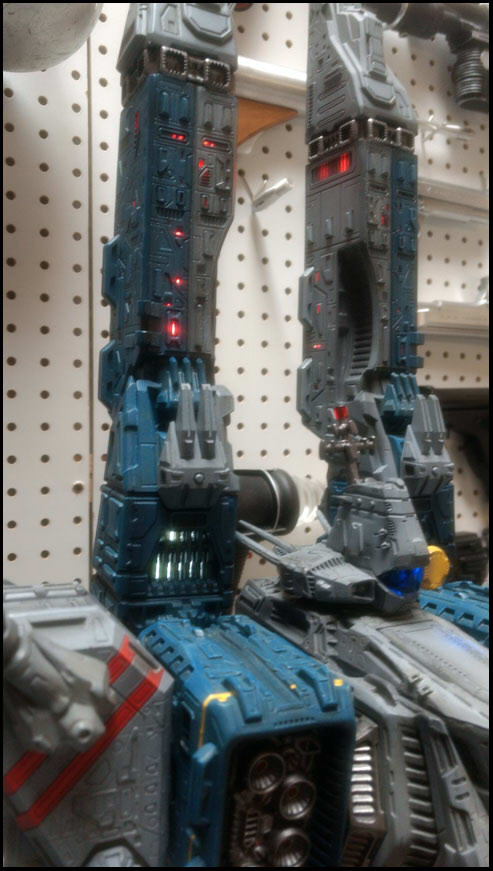

So good news...I fixed it!
After some careful measuring and testing with my 3mm jack extension cable I concluded that the male end was appropriately fixed but the female inside the SDF-1's body was either recessed slightly too far and/or not secure enough to make a positive connection. So I took a large flat file to the indexing stud the male jack sticks out of, shaving off around a mm. In doing so I noticed that the deck of that stud was far from level. The attached pic is at about the halfway point of the filing, when I was done there was still a small bit of the original paint visible. After shaving it the male jack was able to go into the female far enough that the lights turned on!
