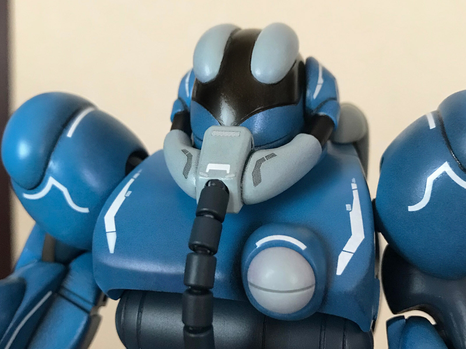

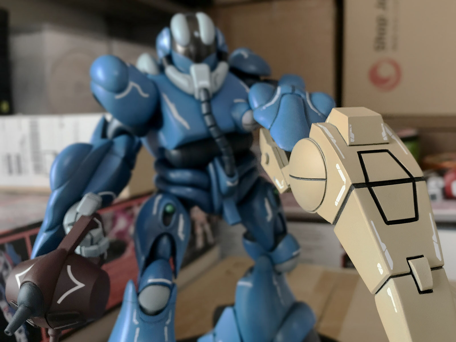

BlueBoi has proven the most challenging to paint, particularly the head...
...but he's finally starting to look the part. ^_^

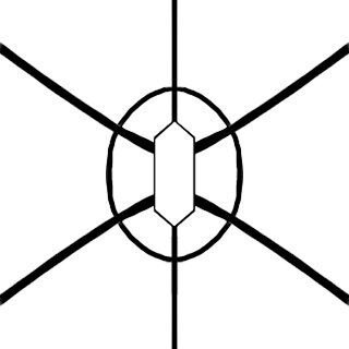

If I can refine the production process, I'd like to make multiples (for the upcoming Biopsychers, at the very least)...
I'm printing these patterns on clear decal film, so I can make several identical cockpit modules:
I still have to figure out what to use for the cockpit cradle, however.  That will require a great deal more effort.
Polyester putty, maybe...? 🤔

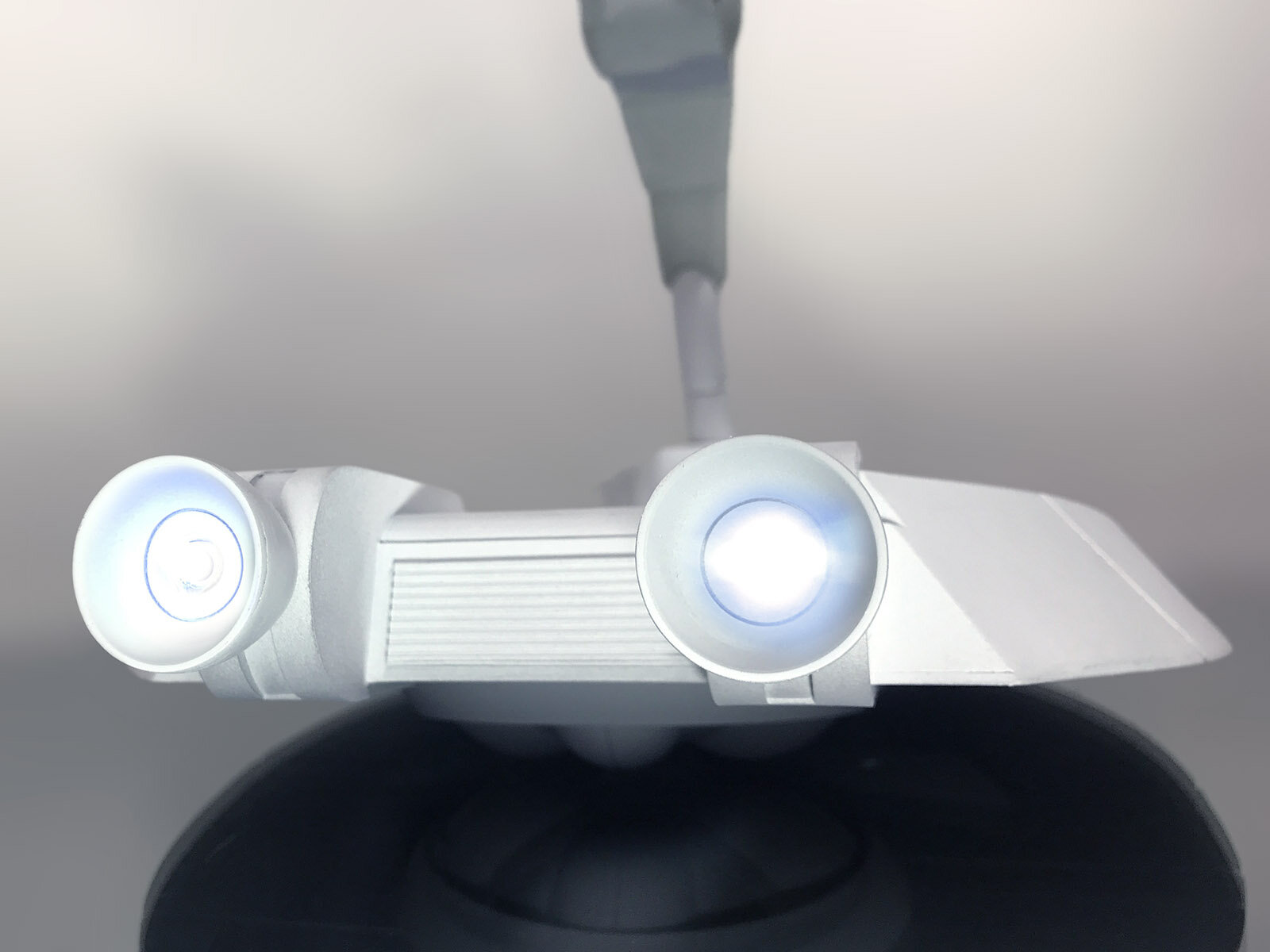

Engine bells are always an open invitation to install LEDs... 😎
...but damn, these hover sleds are huge.  I'm already burned through two cans of primer on this one, and the surfaces still need work... :unsure:

I was planning on doing the same thing but hadn't decided how to run the wires to keep them out of sight. I figured that I would have to dremel out a channel on the underside and then putty over them. How did you solve it?

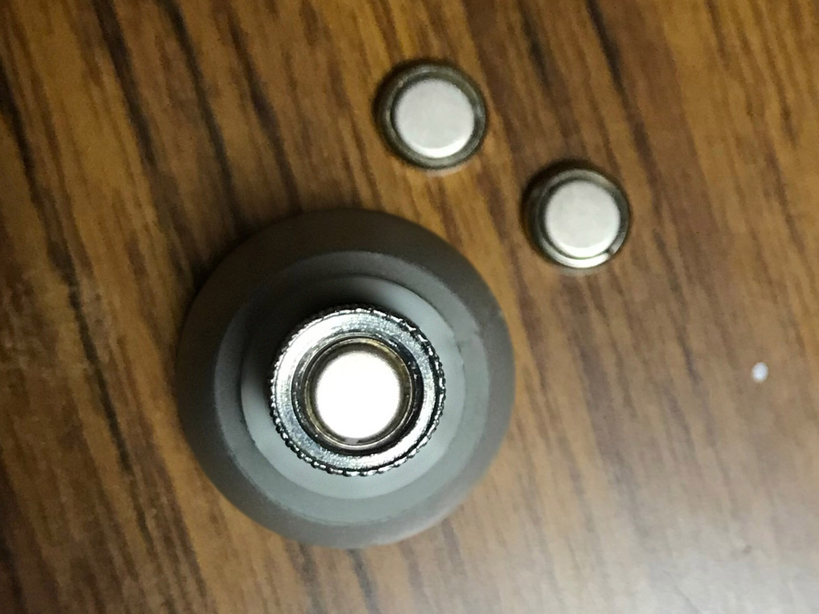

No wires necessary, man.  I have the LED and battery housing installed in the thruster bells themselves:
Screw them in tightly enough, and the batteries will come in contact with the LEDs and light up the thrusters.  ^_^

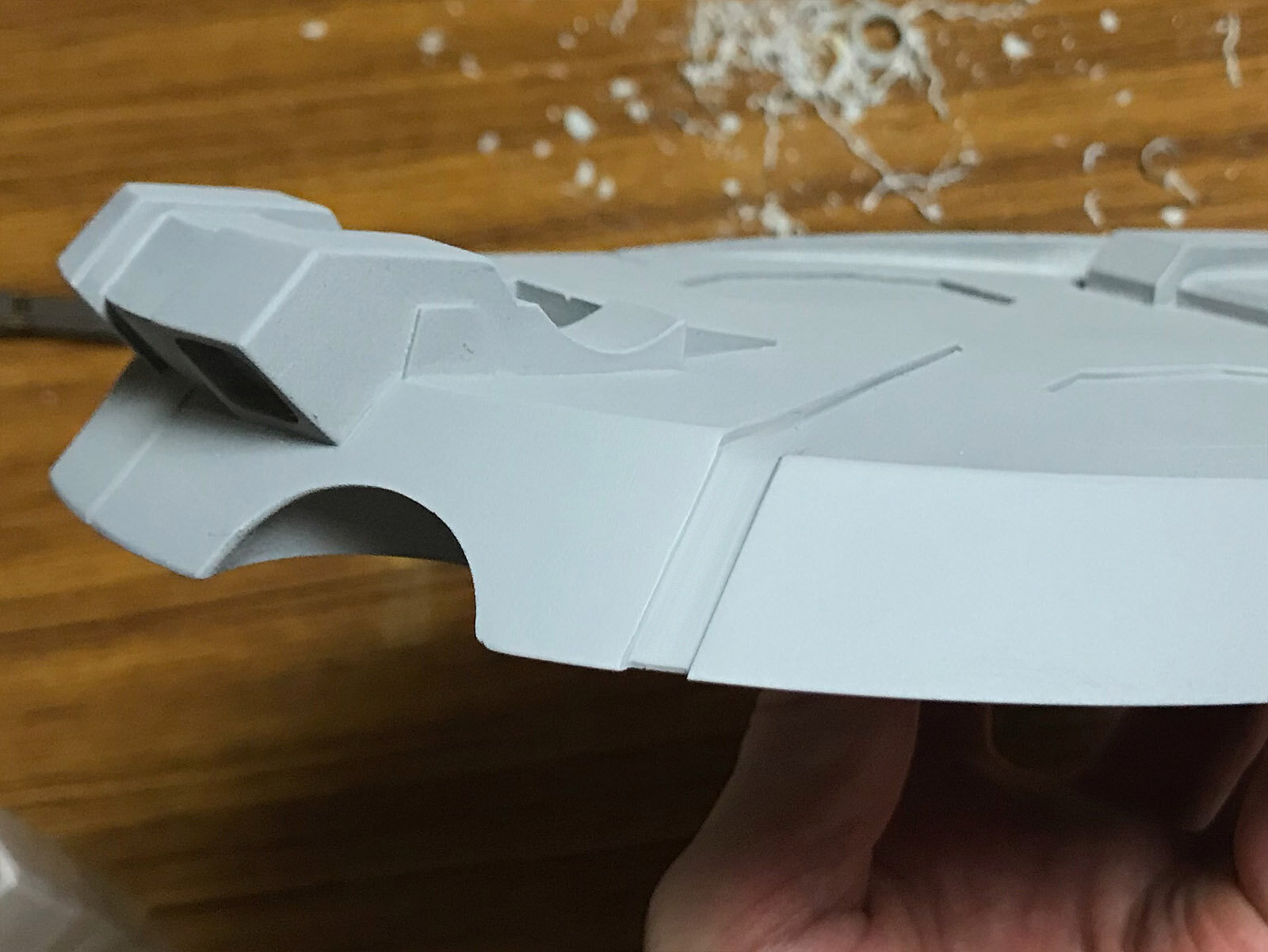

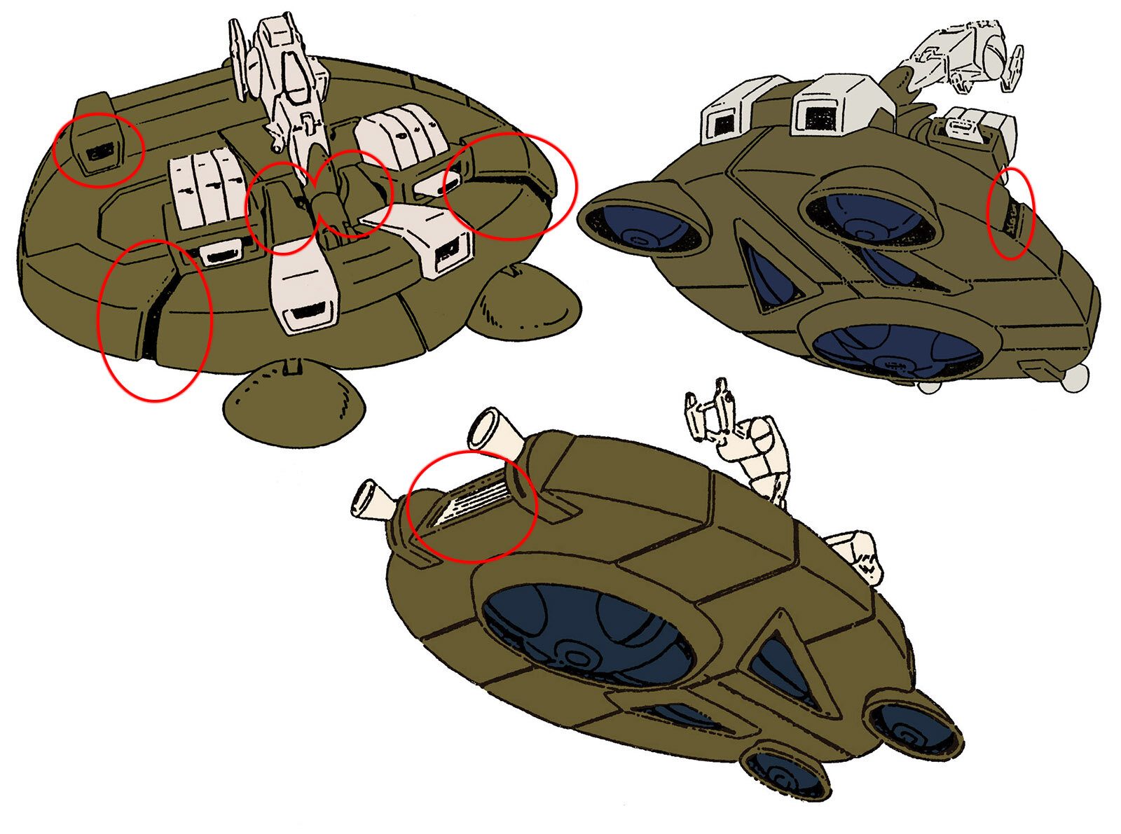

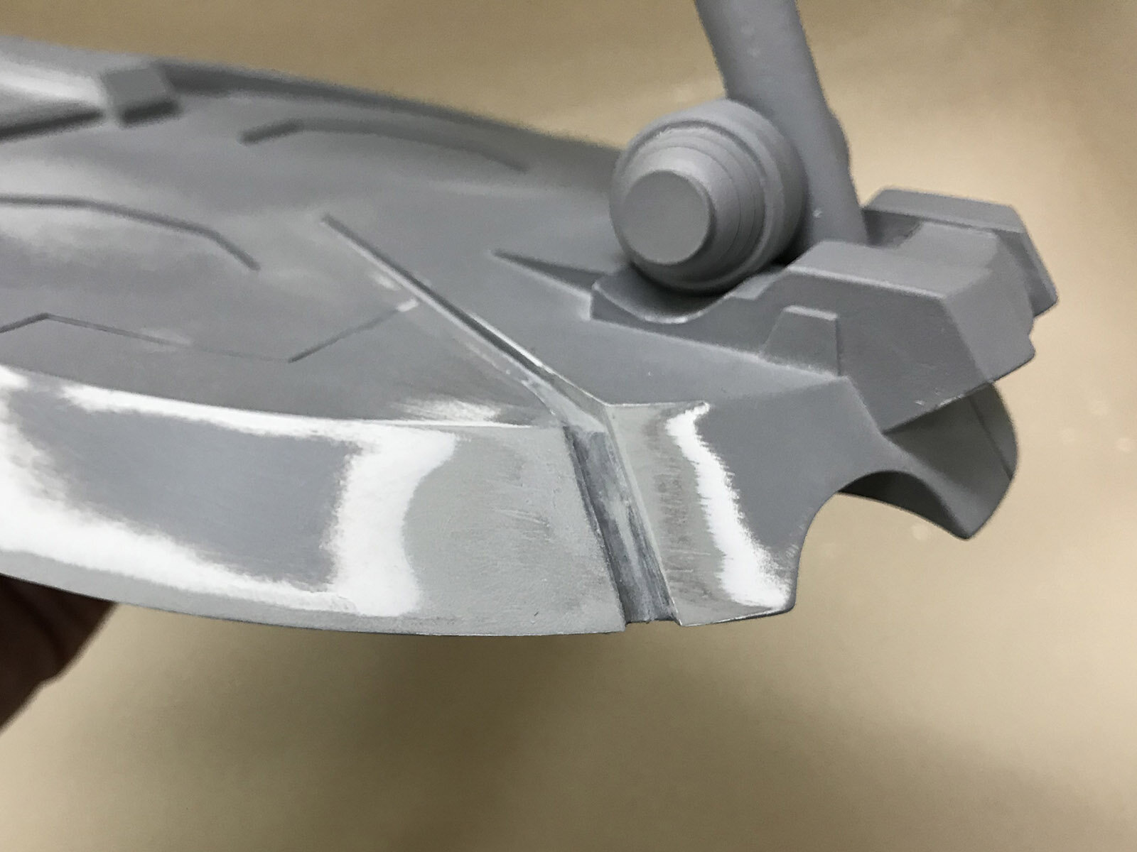

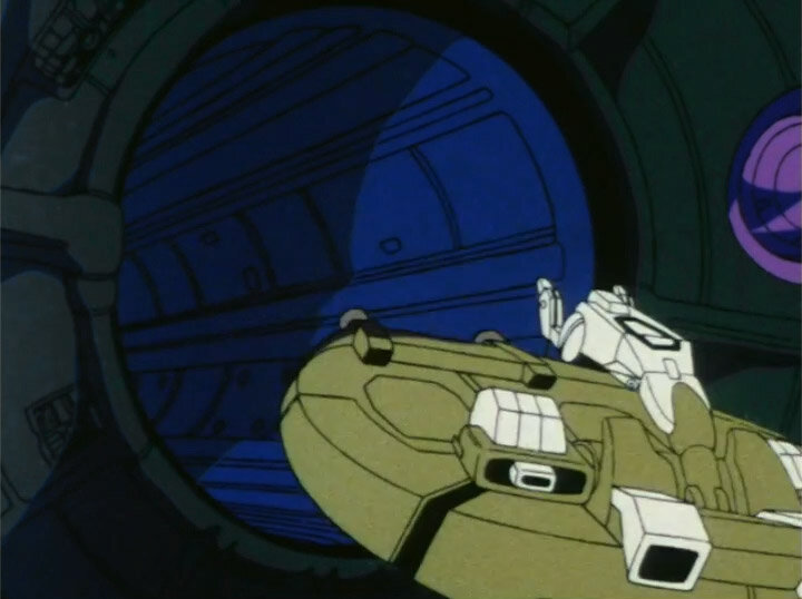

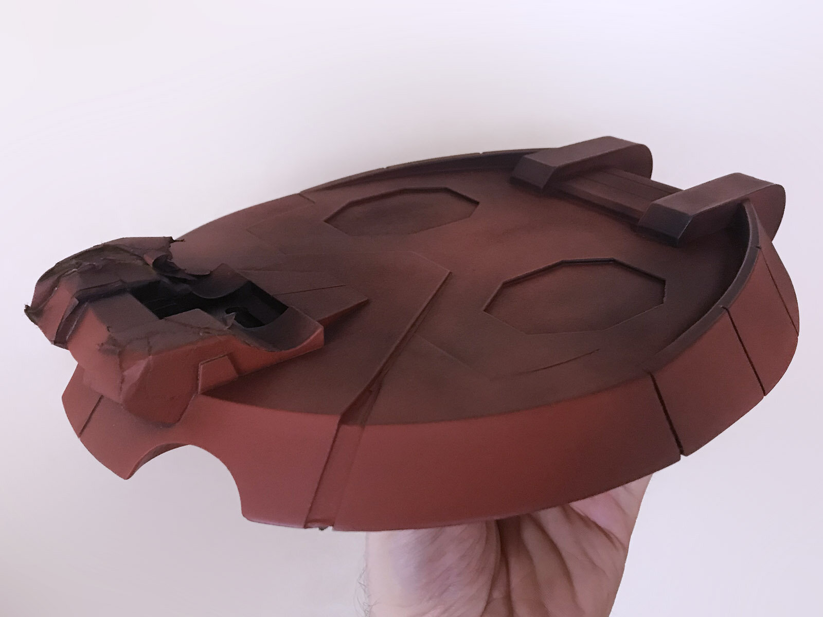

Actually, it's not the existing surfaces that need finishing, so much as all the accurizing work I've done that requires clean-up.
The more I study the animation (and the model sheets it's based on), the more discrepancies I find with the resin kit:
The most prominent (and consistently depicted in the show) is the wide gap in the front that extends out from under the blasters and down the sides of the craft.
The corresponding groove on the kit's fore platform is only as wide as all the other grooves:
Thus, I needed to carve a much wider channel.
It took many layers of putty, sanding, primer, more sanding, more primer (and often more putty) to finally match Moscato's clean line work.

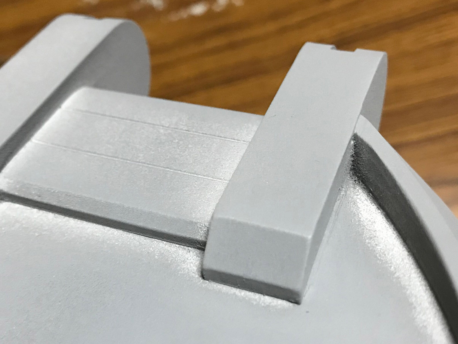

The yoke guards are supposed to be thinner at the top, with oval-shaped cutouts on either side of the lower steering column:
The Moscato kit doesn't even try to emulate that shape.
Easily modified, however. :good:

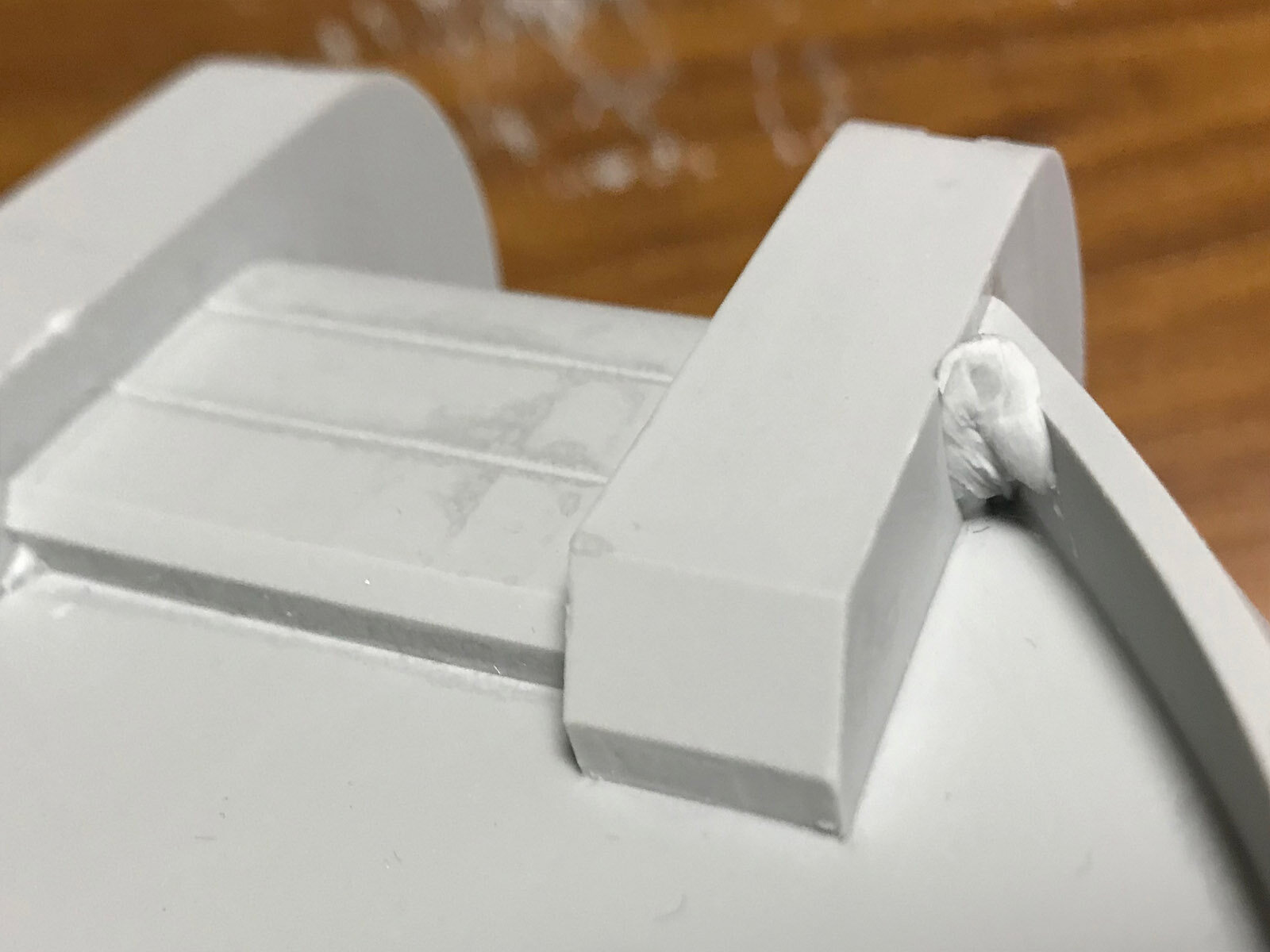

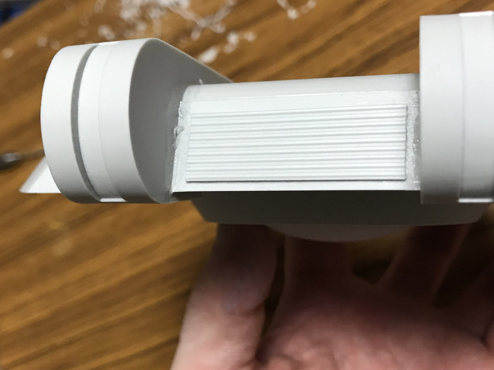

Easier still to fix is the engine grill at the back (which is supposed to be recessed, not protruding).
This will only require a styrene frame to be built up around it.  A few millimeters deep should suffice.
This gunk clogged in the starboard aft corner proved much more difficult to clean up...
...but not impossible, with the right tools (and sufficient putty).

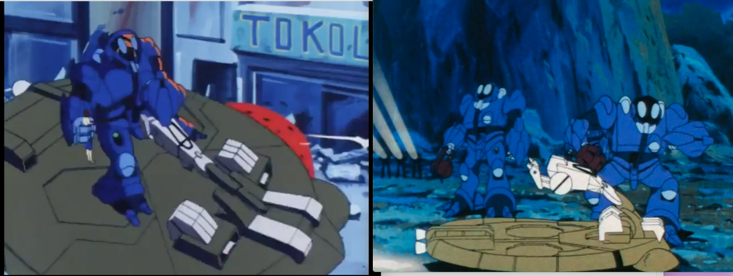

The last issue to address is the fore blasters, whose placement must've been a cause of great consternation for the Cap'n.
His instructions suggested they should be positioned over the edge of the deck, which is how they're depicted in battle:
...but the line art and animation often depicted them recessed aft of the control yoke, particularly when not engaged in combat.
Was this merely the result of inconsistent design work, or were these blasters supposed to be retractable?
Either way, I'm going to make sure they can be mounted in either position. 😎

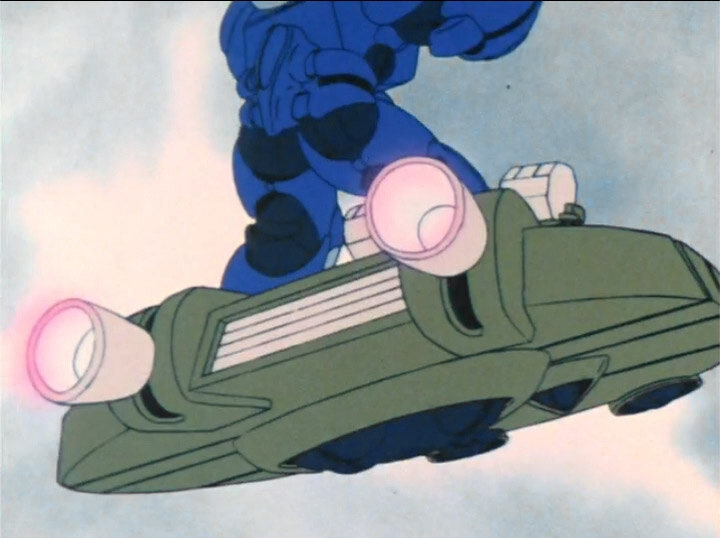

Sunnuva... where were these pictures when I was doing my work? I can't even tell you how much time, putty, and primer I spent removing the joint line on the top and making the surface between them level. Now I see that it was supposed to be there :bigshok:!
I guess I'll glue a piece of styrene to the top to emulate this picture where it appears that it should be curved and raised.
One error I am going to have to live with is the end caps on the handle bar drum. Every image I found had the line on the caps parallel with the connecting handle bar (like the upper right sled in your first image). Now I see it should be more like a forward slash. I'd have to destroy the drum to reangle those at this point.
You've made a grown man weep today. Good job. :lol:
In all seriousness I do appreciate the images. They and your work have inspired me to make some other changes. Back to the drawing board (or hobby mat in this case). I guess dremeling and filling in a channel for the LED wires doesn't seem like such a task now. I prefer to do wires so that I can plug them in and turn them on with a switch or remote.
Hey Ted,

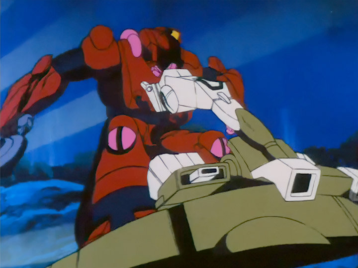

Excellent work on the kits, by the way! FWIW, there were a lot of design elements with the design that had me scratching my head, like that wider gap/partition on either side of the front of the sled. I figured it may have been an animation error (one of many) so I just made them all consistent. The yoke guards I can alter without too much trouble, that's my bad.
Sled blasters: once again, I think this is just due to horrible animation (and design) inconsistency. You'll notice that the animation also shows the control column in a very reclined position, but for that, the whole sled would have to be *pauses* significantly larger than it already is, to say nothing of the size of the control column itself.
If I take one of the screen caps you posted above, and compare it to one I took during the build, you can see a huge discrepancy in the size of the sled, as well as how the sled parts/details are deformed from one view to the next. As such, the rendering of some details I just chalk-up to personal preference.
When in doubt, always go back to the source: the animation model sheets. 😎

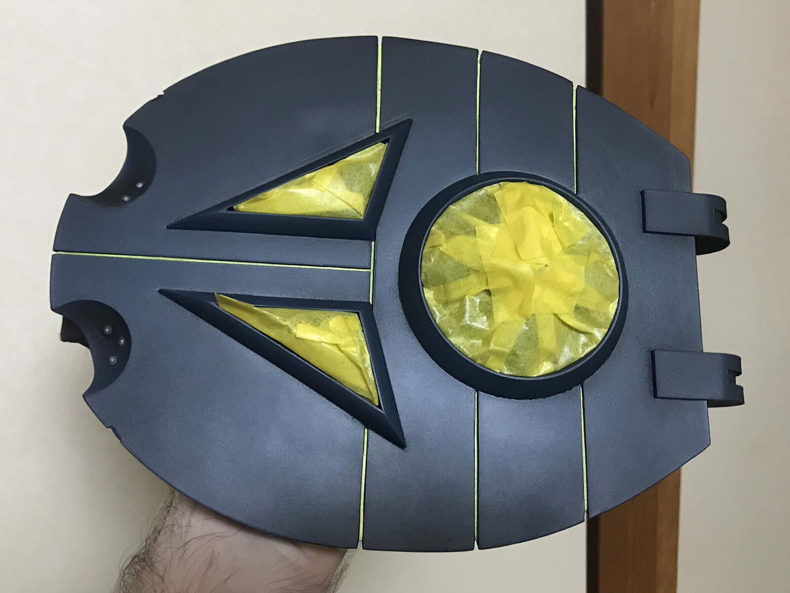

Painting is going smoothly.  Barring any unexpected setbacks, I should be done within a week. ^_^
I wasn't planning on hyper-detailing the hover sled like I had the 'Lloyds, but the control yoke was looking kind of plain without decals... :unknw:

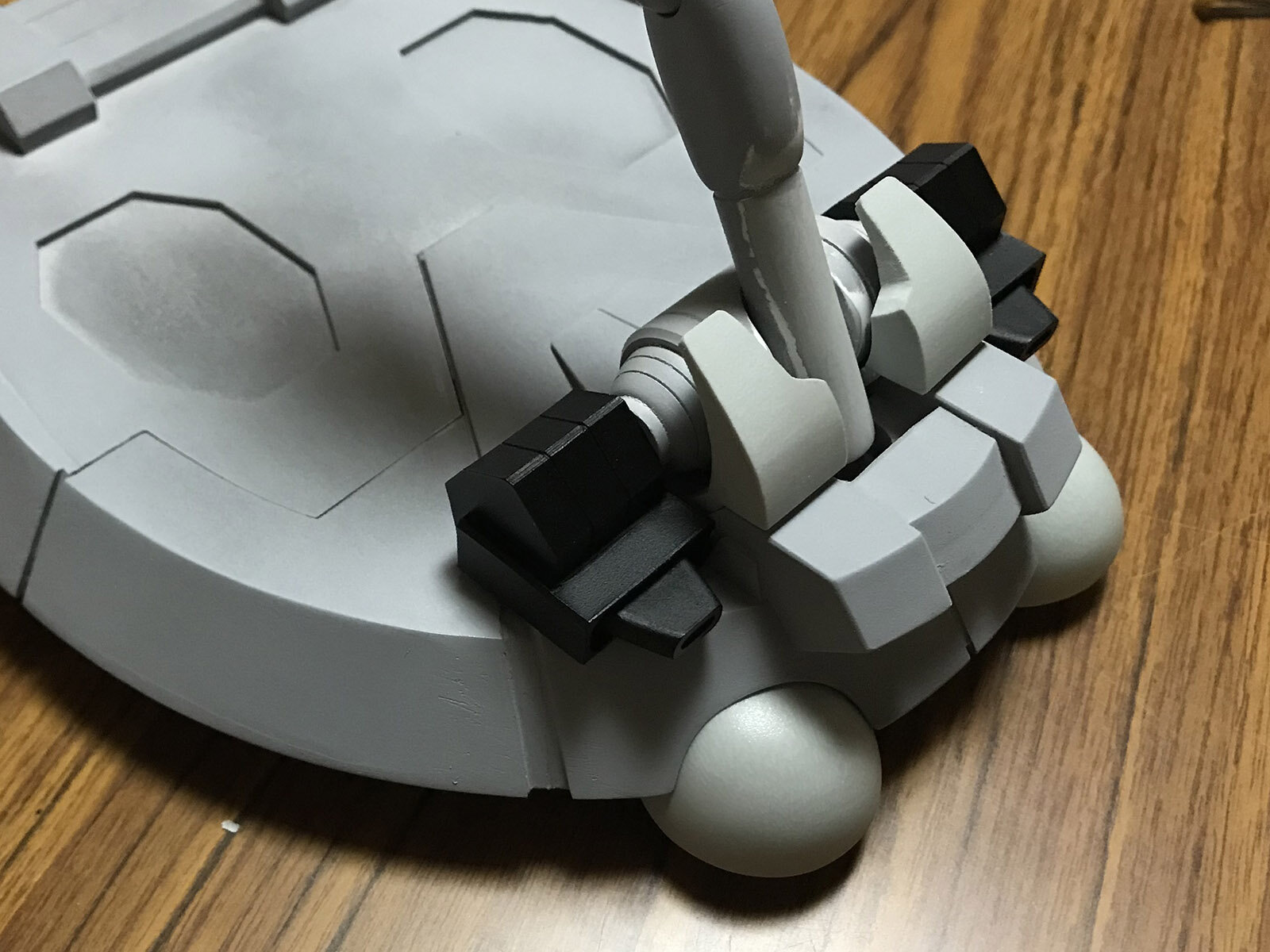

Here's a look at my pre-shading technique with the surfacer, before the primary color is applied:
At Cap's suggestion, I'm going with a "slightly less well-maintained" look for the biovers. 😅

Looking good. Subtle but eye catching. I would say that the heaviest areas of shading should be where there is the most foot traffic along with engine and exhaust/thruster areas. In my opinion I would put less around the yoke area and more in between the foot pads. The front is also a little too clean.

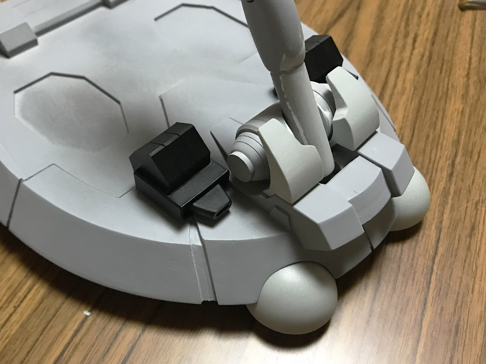

For my progress I've managed to complete the following:
I've wired some LED's to the thrusters. I plan to have it mounted on an acrylic rod and a custom built base replicating the surface of the mothership. If you happen to have close up pictures of the mothership surface which you could share Ted it would be most appreciated ;).
Based on Ted's images and pointing out some areas that could be improved I've made some modifications.
I built a frame for the rear exhaust to make it look recessed.
I carved out notches in the fairings. I added 1mm plate to the left and right front top to give a raised appearance for that outline rather than just the joint line (which I had erroneously removed). I also added plates to the inside rear sides to create recessed lines like those on the outside.
For the figure I am satisfied enough with the base colors so that I can move on to washes and weathering. Some of the lines aren't as crisp as I would like them (my Tamiya tape was giving me all kinds of issues with this project) but I am expecting that the next steps will hide any of those faults. The red I chose is darker and not as saturated as it looks in the pictures.

Out of curiosity, does it bug anyone rlse that the blue and green sensors on the bioroid domes look like googly-eyes? I can barely ever unsee it, so I was thinking of coloring them a darker shade of their base colors... :unsure:

Not me, their too high up on the head. I always thought it added an alien insectoid look, like something out of some 80's comic.
