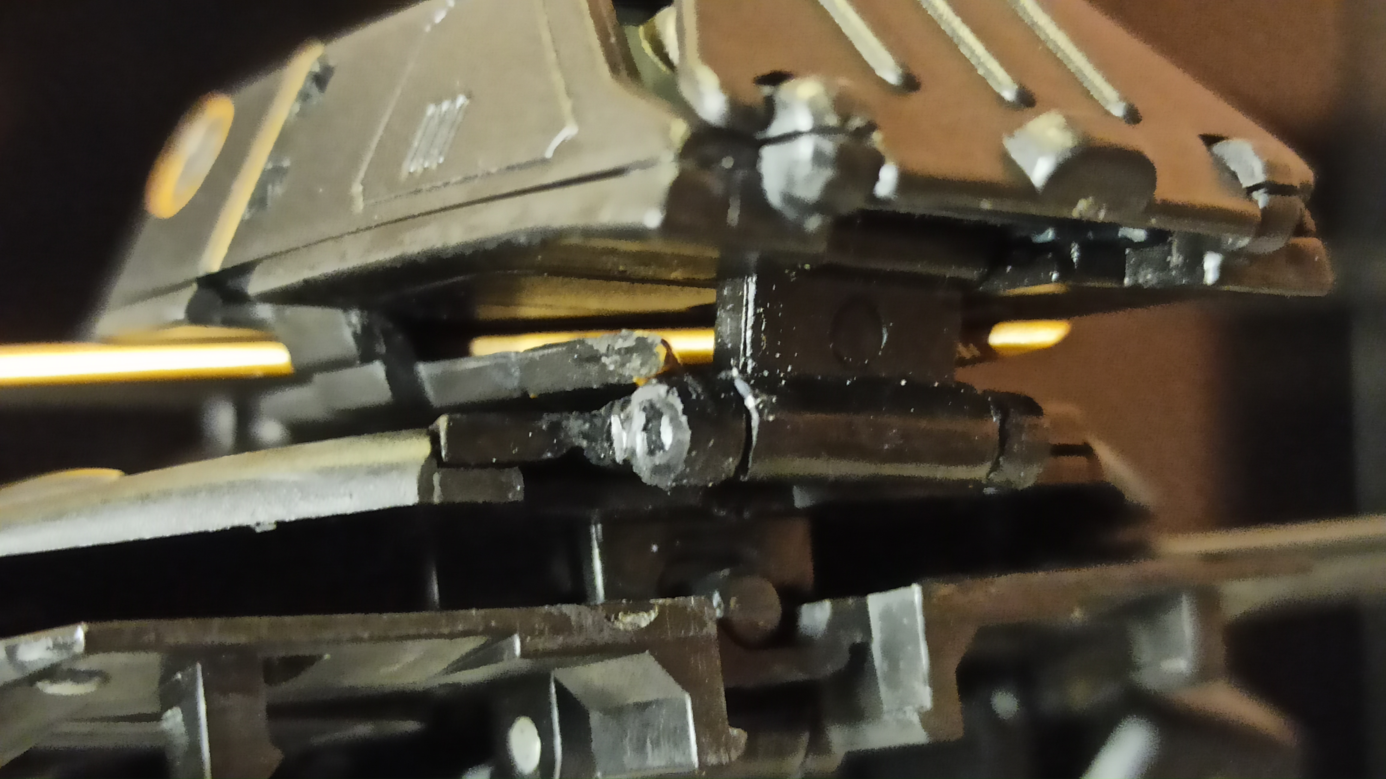

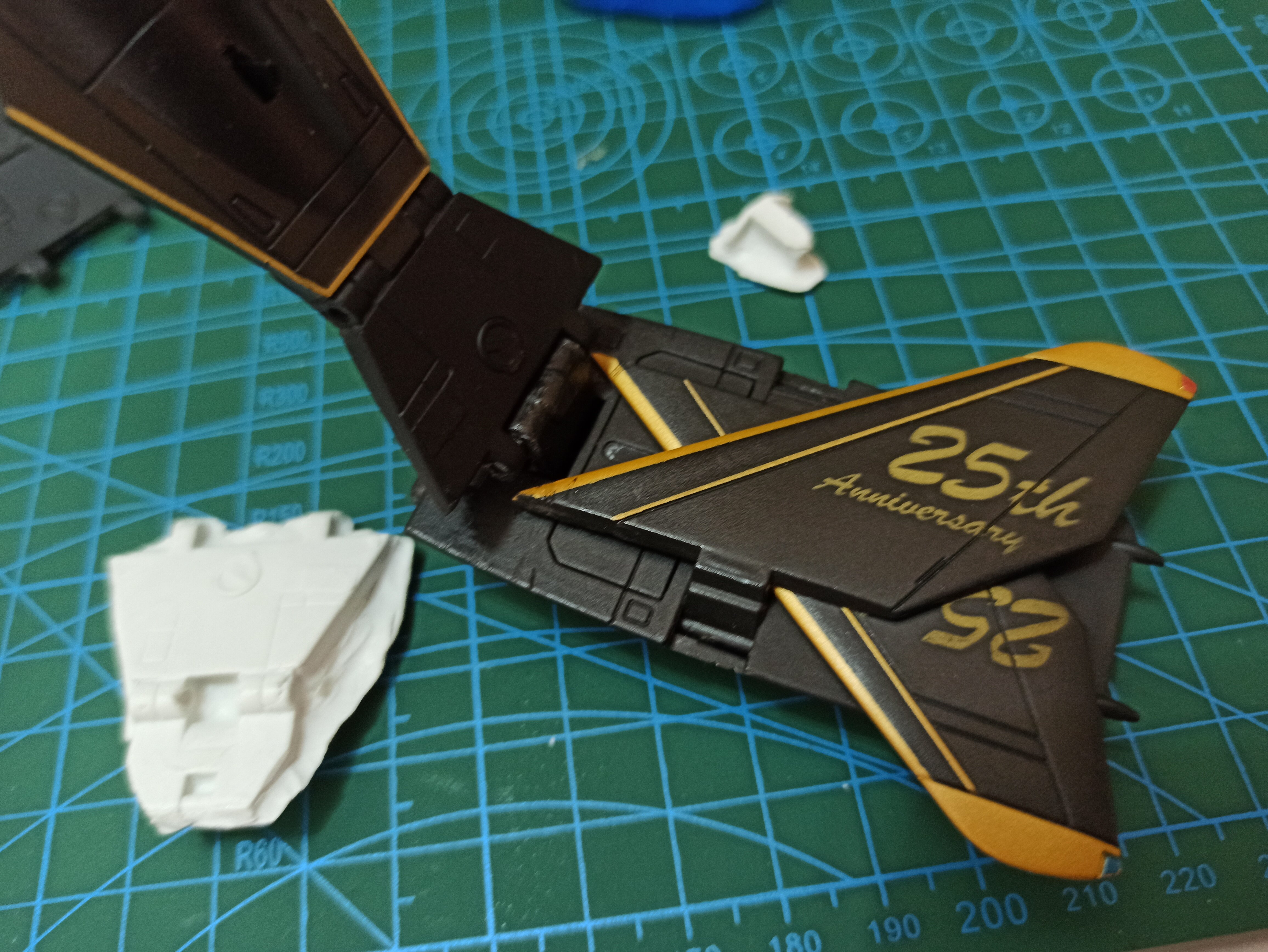

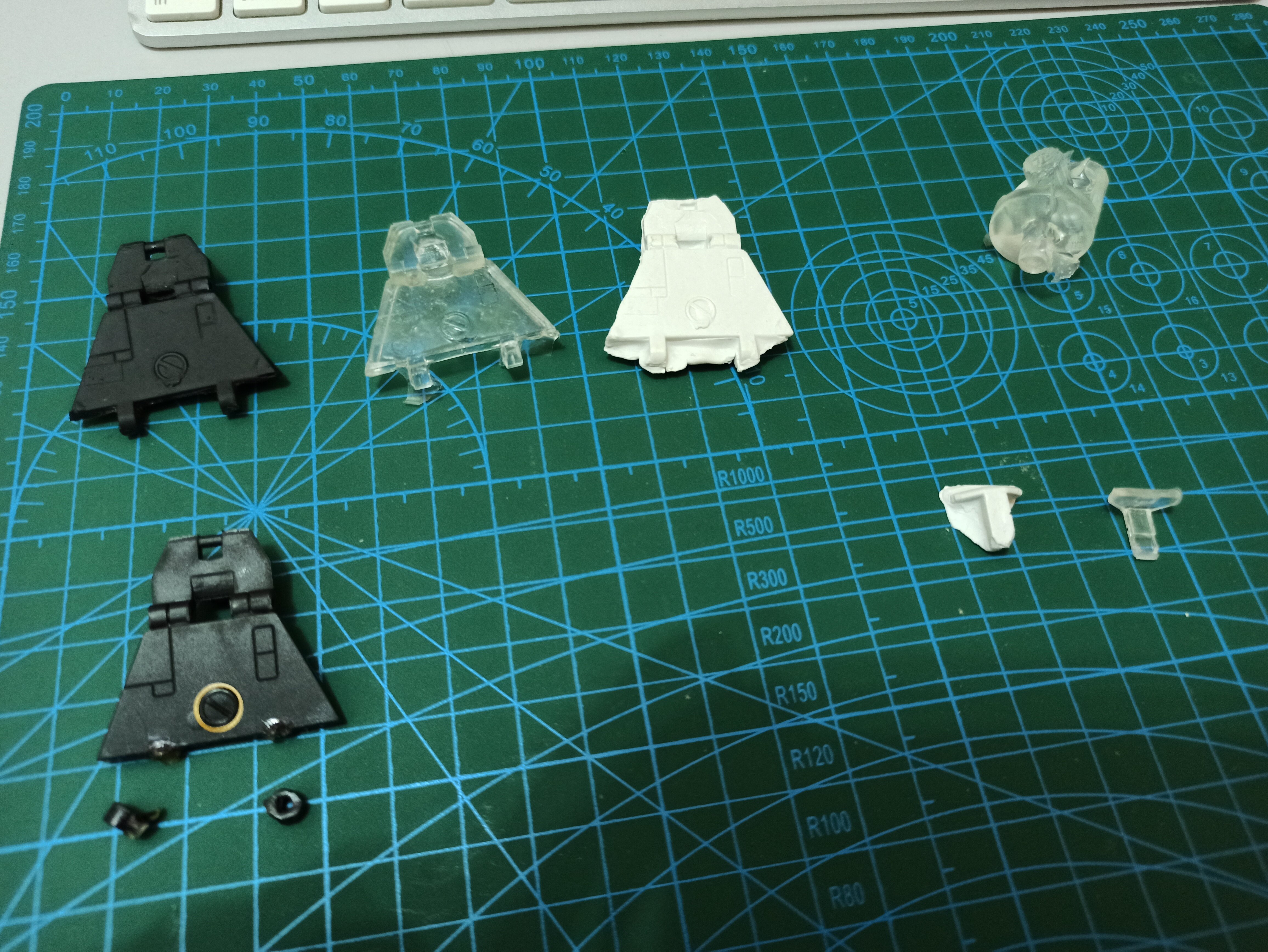

Sokeijon Posted December 18, 2020 Posted December 18, 2020 Hello there, I hope I posted at correct category. My 25th Anniversary VF-1S is broken. Is there anyone encountered similar issue? What's the best way to fix? 3D Pen printing? Quote
jenius Posted December 18, 2020 Posted December 18, 2020 This was a very common break (BP8 IIRC). There were resin replacement parts eons ago but I can't recall the last time I saw one floating around and I don't think I ever saw black ones. 3D printing sounds promising but I can't recall seeing anyone tackle it. Sorry I don't have happier tidings.. that's a tough one to fix. Quote
Sokeijon Posted December 18, 2020 Author Posted December 18, 2020 Sob sob...thank you for your replying. I'm trying to use epoxy glue. Still working on it. Quote
pengbuzz Posted December 18, 2020 Posted December 18, 2020 1 hour ago, Sokeijon said: Sob sob...thank you for your replying. I'm trying to use epoxy glue. Still working on it. No, you do not want epoxy on that; it is too brittle. What you are going to want is Devcon Plastic Welder. it is a two-part adhesive with far better bonding power and durability. If you live in the US, they have the black version at Home Depot in their Automotive aisle. Trust me; I use this stuff all the time and it's far better for these kinds of repairs. Clean the break and the part that broke off with 91 percent rubbing alcohol, them mix up the material, apply and place the snapped hinge part. Once cured, it should be as good as new. Quote
Sokeijon Posted December 18, 2020 Author Posted December 18, 2020 46 minutes ago, pengbuzz said: No, you do not want epoxy on that; it is too brittle. What you are going to want is Devcon Plastic Welder. it is a two-part adhesive with far better bonding power and durability. If you live in the US, they have the black version at Home Depot in their Automotive aisle. Trust me; I use this stuff all the time and it's far better for these kinds of repairs. Clean the break and the part that broke off with 91 percent rubbing alcohol, them mix up the material, apply and place the snapped hinge part. Once cured, it should be as good as new. Thanks for the tips. Will try that out. Really appreciate it. Quote
Sokeijon Posted December 18, 2020 Author Posted December 18, 2020 50 minutes ago, pengbuzz said: No, you do not want epoxy on that; it is too brittle. What you are going to want is Devcon Plastic Welder. it is a two-part adhesive with far better bonding power and durability. If you live in the US, they have the black version at Home Depot in their Automotive aisle. Trust me; I use this stuff all the time and it's far better for these kinds of repairs. Clean the break and the part that broke off with 91 percent rubbing alcohol, them mix up the material, apply and place the snapped hinge part. Once cured, it should be as good as new. Thanks for the tips. Will try that out. Really appreciate it. My next worry is putting back the hinges pin. It was so difficult to pull it out. Quote

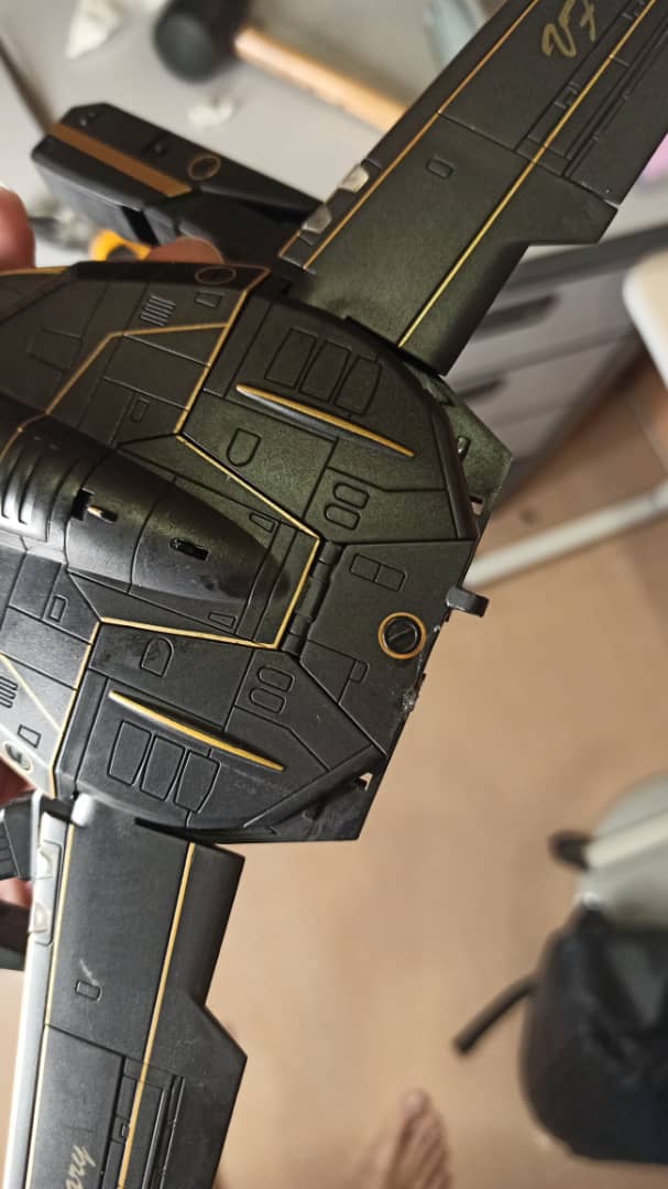

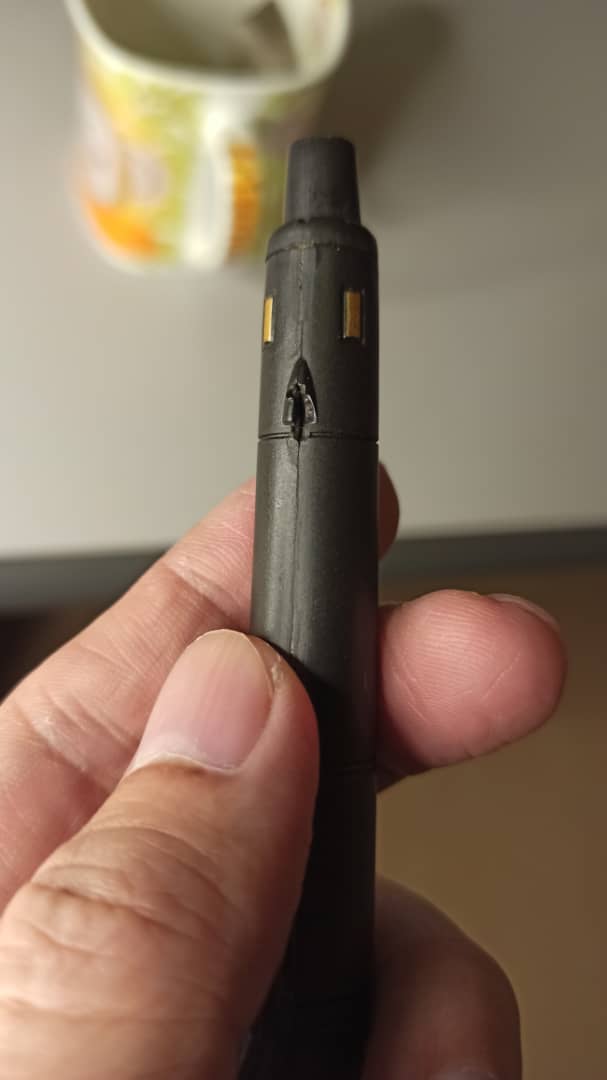

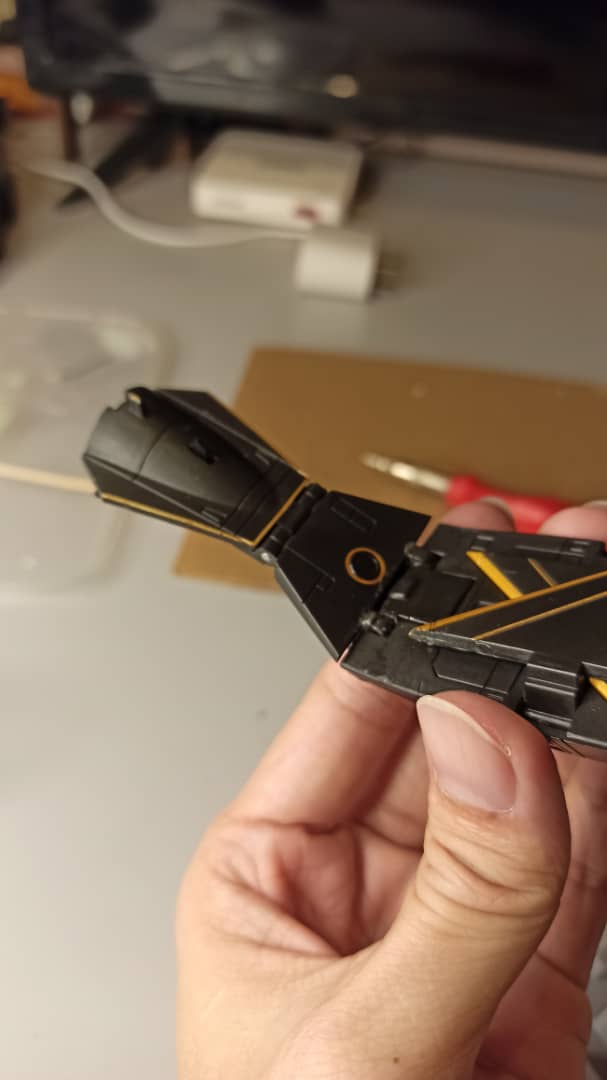

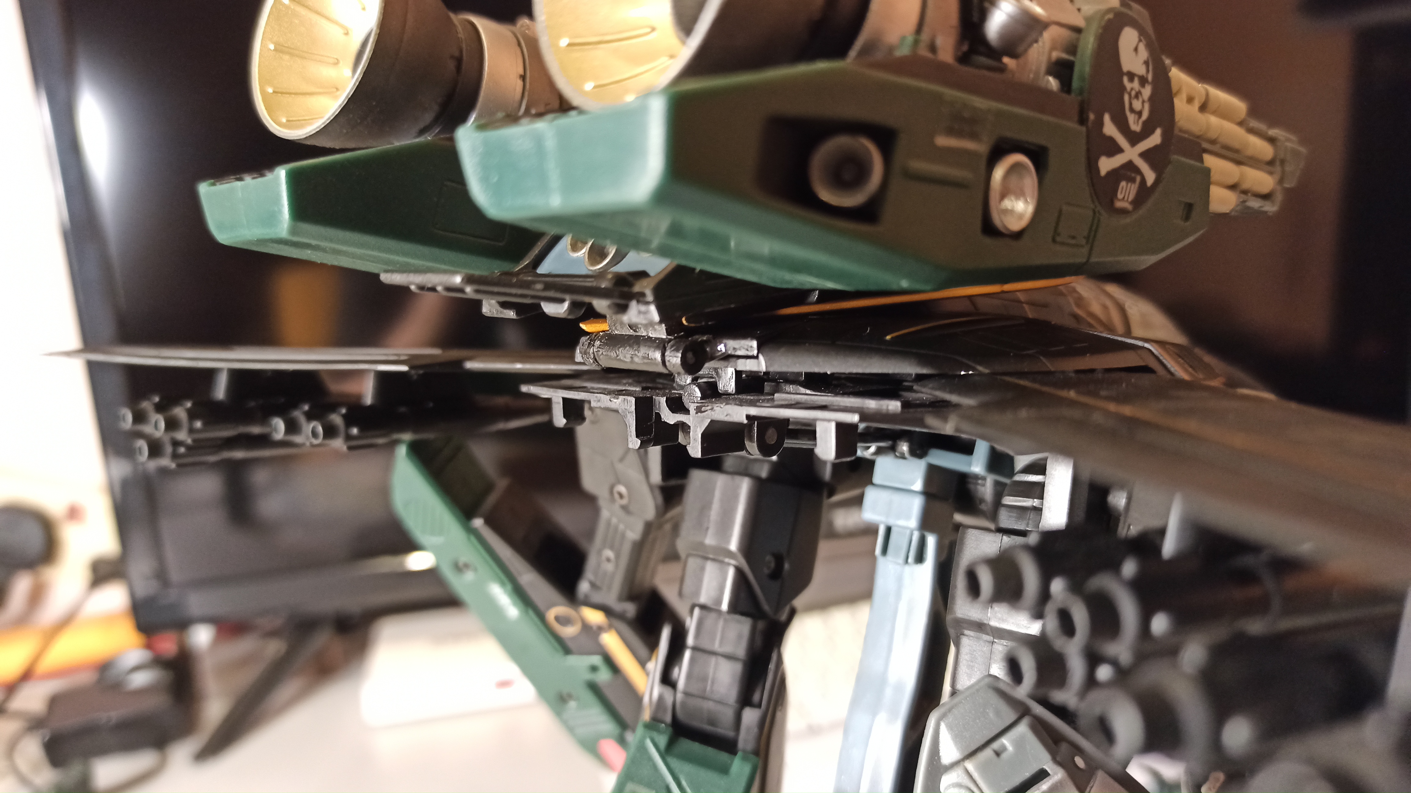

Sokeijon Posted December 21, 2020 Author Posted December 21, 2020 An update. I have tried using Araldite Epoxy Mixed. Failed to fix at the first time, then managed to "fixed" it. Not perfect, but still can transform between fighter mode to Gerwalk mode with a lot of extra care. The hinges are missed align and I have to trim to make it work. There are more and more breaking parts. For instance, super strike parts cracked when it's removed, a crack behind the feet, the gun pod holding the belt chain cracked too. VID-20201221-WA0044.mp4 Quote
Sokeijon Posted December 21, 2020 Author Posted December 21, 2020 (edited) Edited December 21, 2020 by Sokeijon Quote
MechTech Posted December 22, 2020 Posted December 22, 2020 Sorry about your breaks! If that is ABS plastic, the best glue is simple Acetone. It will melt the plastic like model cement. It will also mess up paint and markings so surgically apply it with a tiny brush or similar tool. Then let it cure a couple of days to solidify. - MT Quote
Sokeijon Posted December 23, 2020 Author Posted December 23, 2020 21 hours ago, MechTech said: Sorry about your breaks! If that is ABS plastic, the best glue is simple Acetone. It will melt the plastic like model cement. It will also mess up paint and markings so surgically apply it with a tiny brush or similar tool. Then let it cure a couple of days to solidify. - MT It's okay Brother MT. It's due to mishandling. It was in fighter mode earlier and my wife lifted up and lost balance (it is heavy with super strike parts) and cracked it. Quote

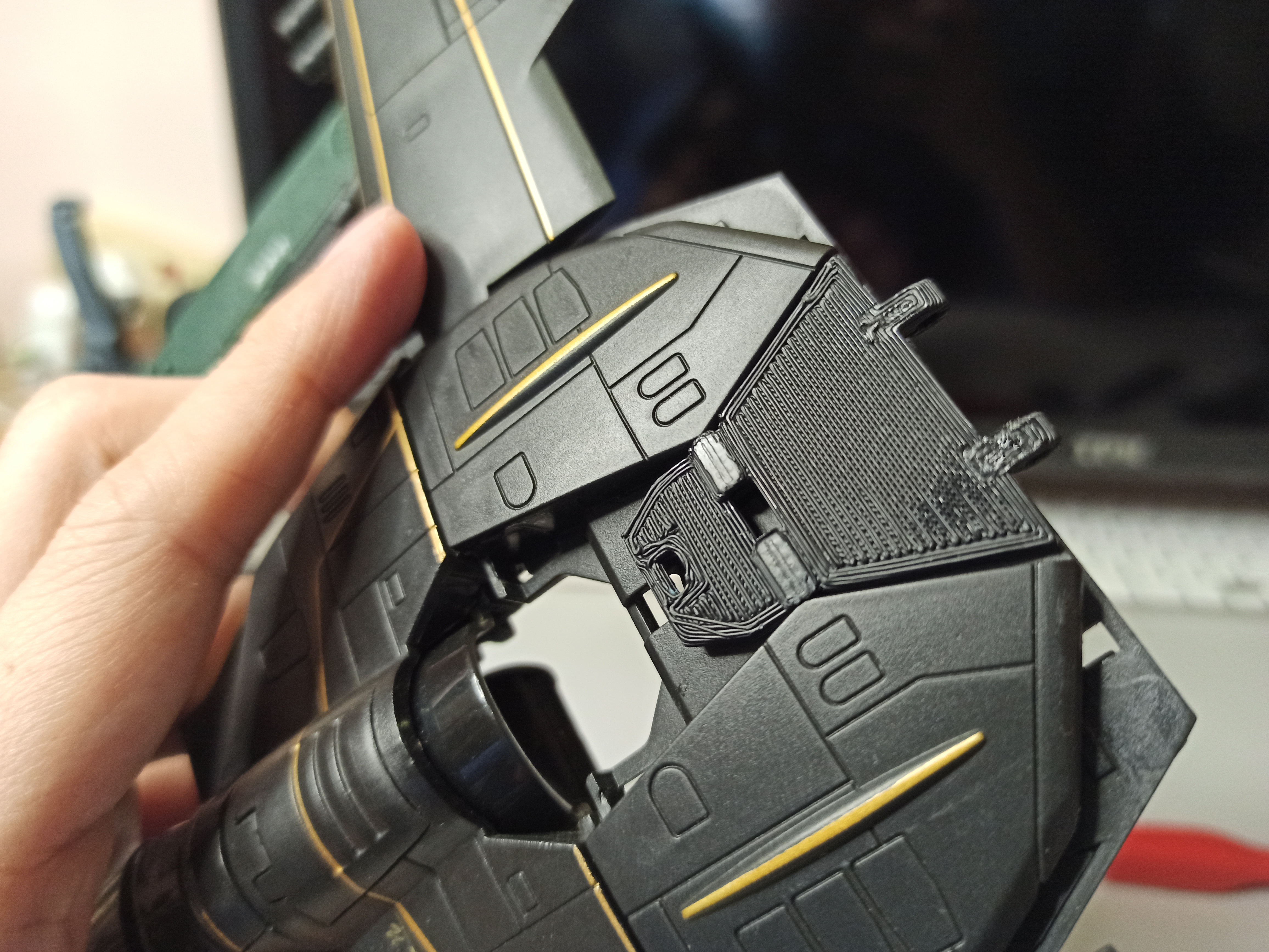

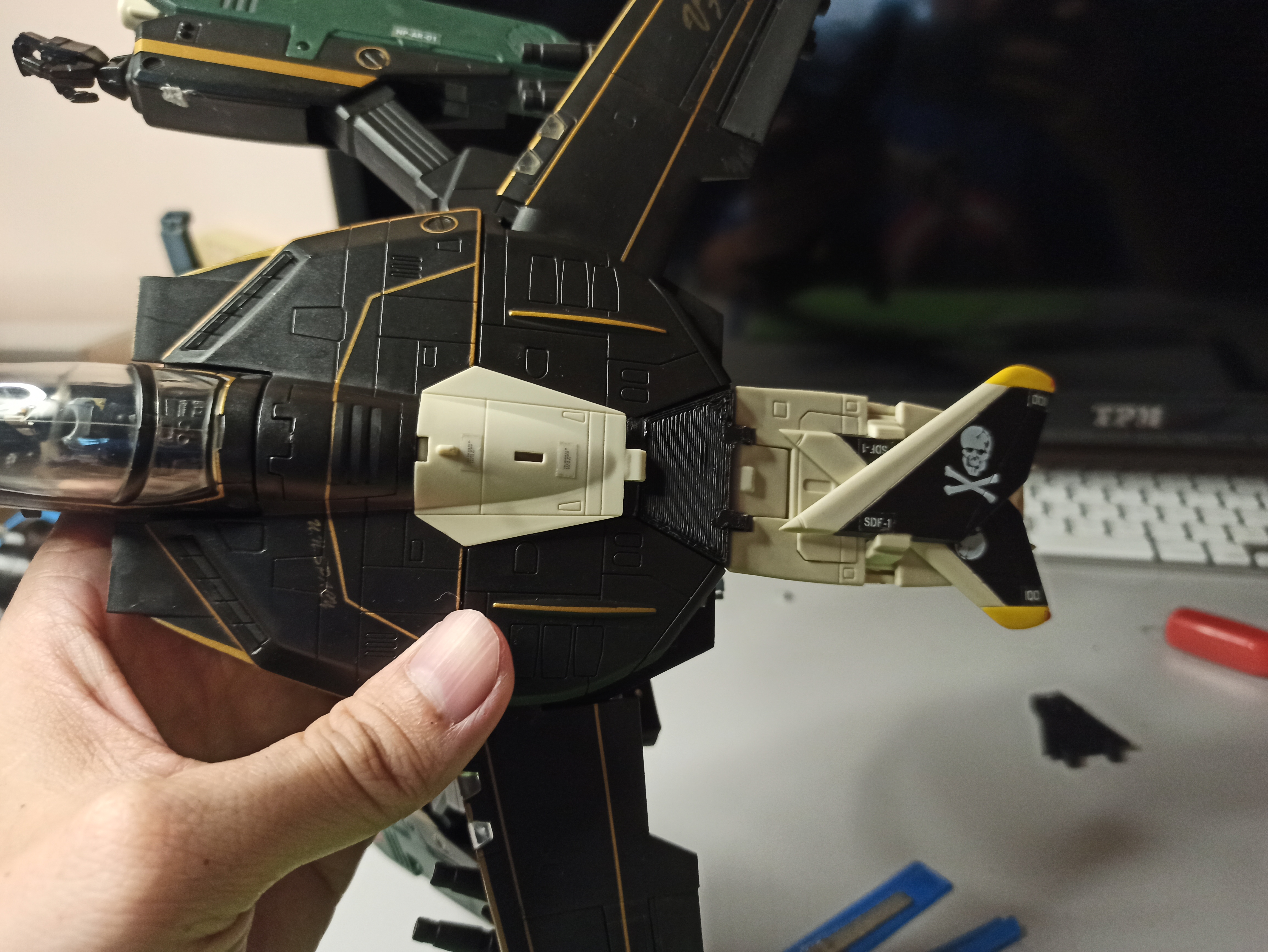

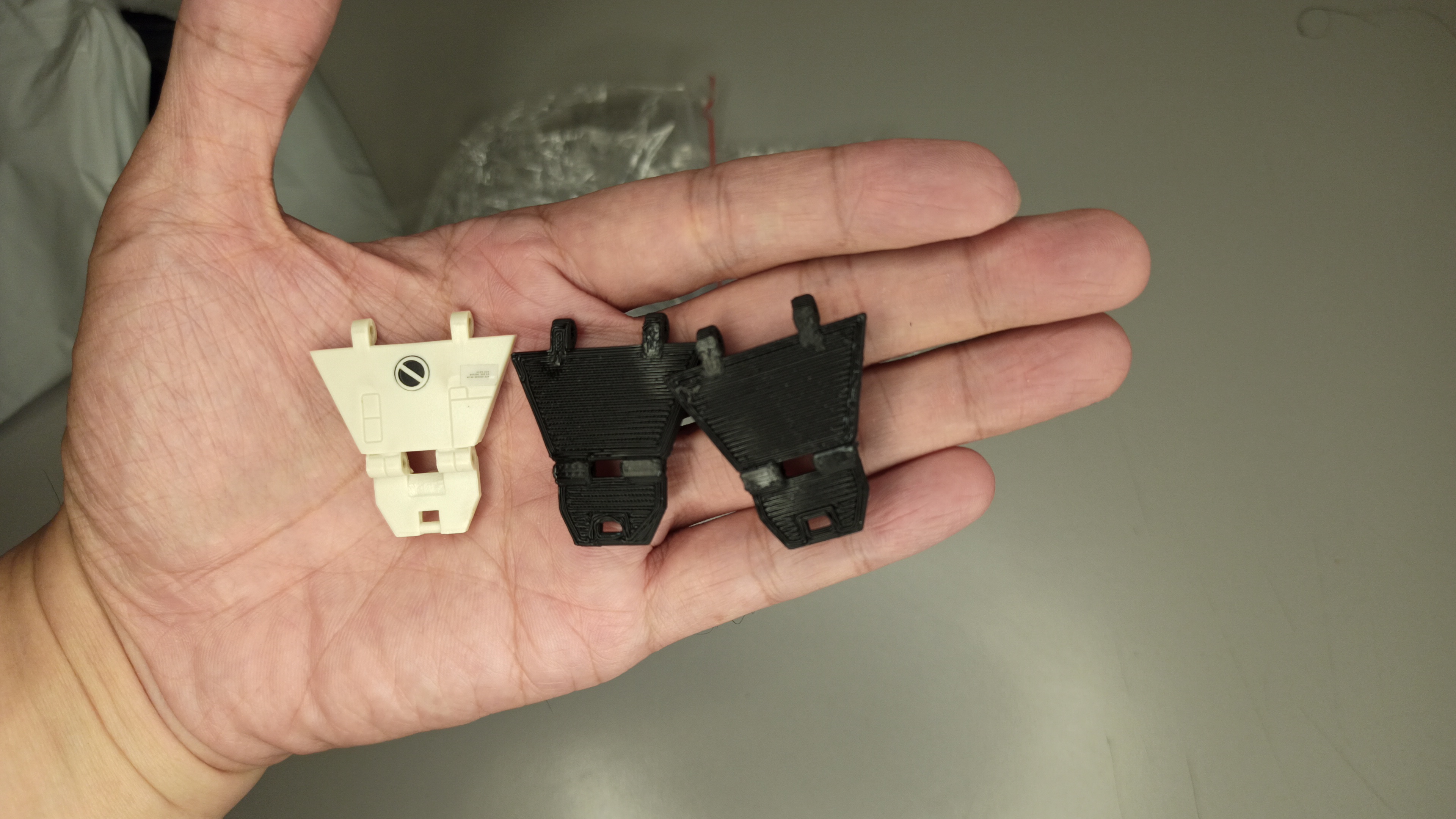

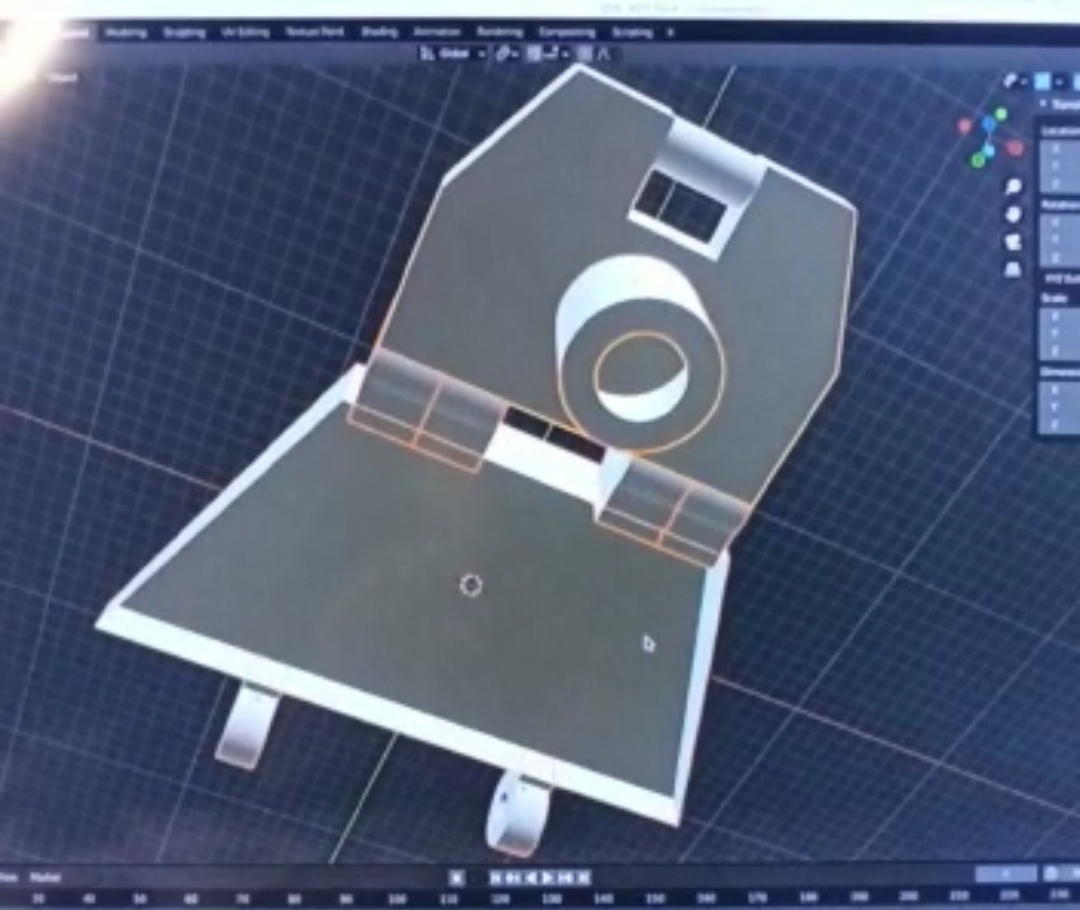

Sokeijon Posted January 1, 2021 Author Posted January 1, 2021 My first attempt designing the BP8 and printed out. Not perfect and need further improvement. Quote
505thAirborne Posted January 1, 2021 Posted January 1, 2021 https://www.shapeways.com/product/XXCVQ7FEG/ps-mac-001-macross-robotech-bp-8-backpack-hinge?optionId=123454316&li=shops Saw these posted a few days ago, I'm tempted to order a few and see if they work. Quote
Sokeijon Posted January 2, 2021 Author Posted January 2, 2021 4 hours ago, 505thAirborne said: https://www.shapeways.com/product/XXCVQ7FEG/ps-mac-001-macross-robotech-bp-8-backpack-hinge?optionId=123454316&li=shops Saw these posted a few days ago, I'm tempted to order a few and see if they work. Ya man. Saw it too. But it is too expensive to ship to my country. Quote
505thAirborne Posted January 2, 2021 Posted January 2, 2021 40 minutes ago, Sokeijon said: Ya man. Saw it too. But it is too expensive to ship to my country. Yeah, overseas shipping is a royal pain right now & more expensive than it used to be. Quote

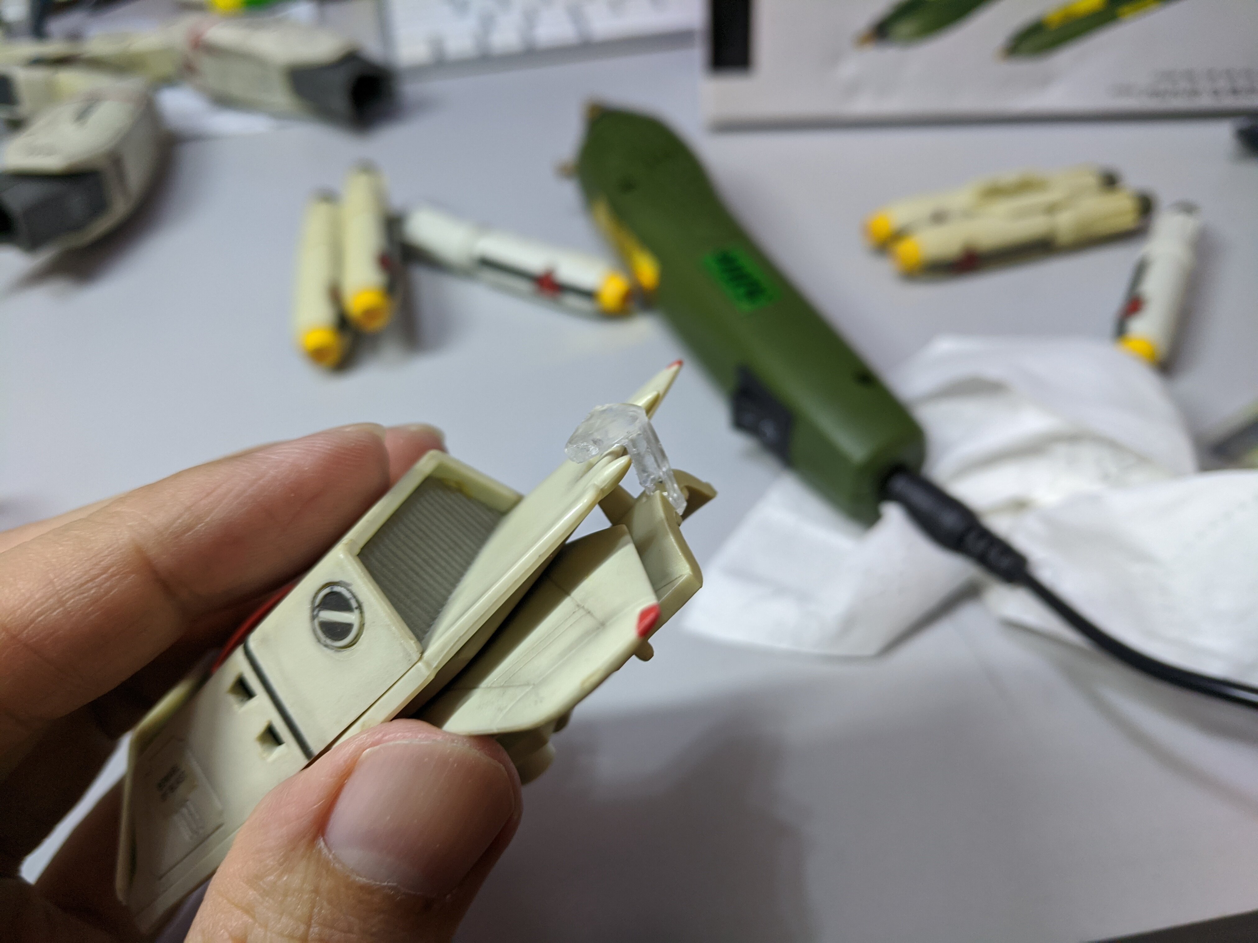

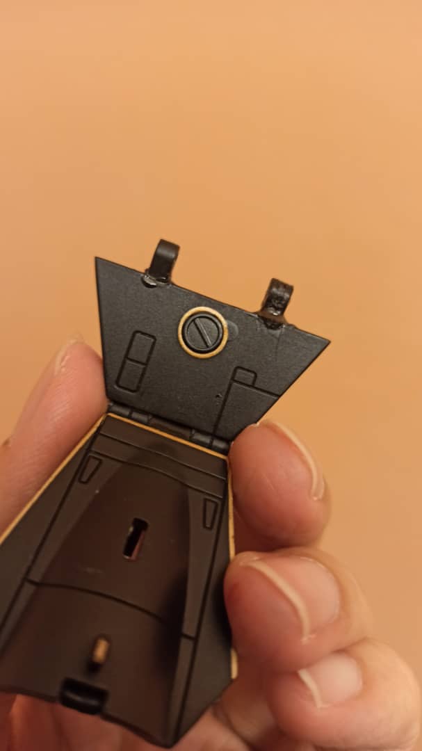

Sokeijon Posted September 2, 2021 Author Posted September 2, 2021 Hello guys, just to share the latest update since the last post. Lost my job during this pandemic and with extra time, I have casted the BP8, BP9's hook (I lost it from my VF-1J) and SV-51's stand's connector. I feel that using the AB Resin is much better than AB Putty. Quote
MechTech Posted September 6, 2021 Posted September 6, 2021 I'm sorry about your job, but you made great fixes for your valk! - MT Quote
Sokeijon Posted September 8, 2021 Author Posted September 8, 2021 On 9/7/2021 at 4:31 AM, MechTech said: I'm sorry about your job, but you made great fixes for your valk! - MT That's alright. Life is unpredictable. Thank you for your message. Quote
pengbuzz Posted September 12, 2021 Posted September 12, 2021 On 9/2/2021 at 2:12 AM, Sokeijon said: Hello guys, just to share the latest update since the last post. Lost my job during this pandemic and with extra time, I have casted the BP8, BP9's hook (I lost it from my VF-1J) and SV-51's stand's connector. I feel that using the AB Resin is much better than AB Putty. Nice save on the joint! Quote
