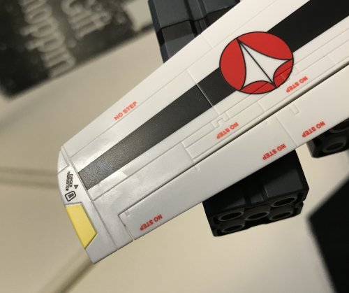

Angesdad Posted October 31, 2020 Posted October 31, 2020 (edited) I am also into restoring and refinishing unsatisfactory mass-produced factory paint jobs myself, and just want to share my utterly unpleasant finding that what appears to be unpainted surface on Bandai DX VF-1, the main body in particular, is in fact finished with clear sealing coat.. The red marker on the wing tip on my copy was scuffed from factory,(thanks Bandai) so I decided to remove and repaint all together. In the process some red paint smudged onto the surrounding area. No big deal, simply clean with some Mr. Hobby thinner right? because it isn’t painted..wait, what the @#$&. The thinner reacted with the finish and left some kind of smudge which does not go away. It only expands and gets worse if you use more thinner. Tried enamel thinner too but no luck. I suspect it isn’t bare plastic and they must be finishing with sealer coat at the factory. Sorry I just needed to vent and share so that it don’t happen to others. I suppose a hit of clear coat will fix it? I hope so. *Update - The affected panels were refinished with semi-gloss clear coat and it is now restored to factory finish. Thought it was matte first but semi-gloss coat is actually much closer to original finish.* Edited November 11, 2020 by Angesdad Quote
